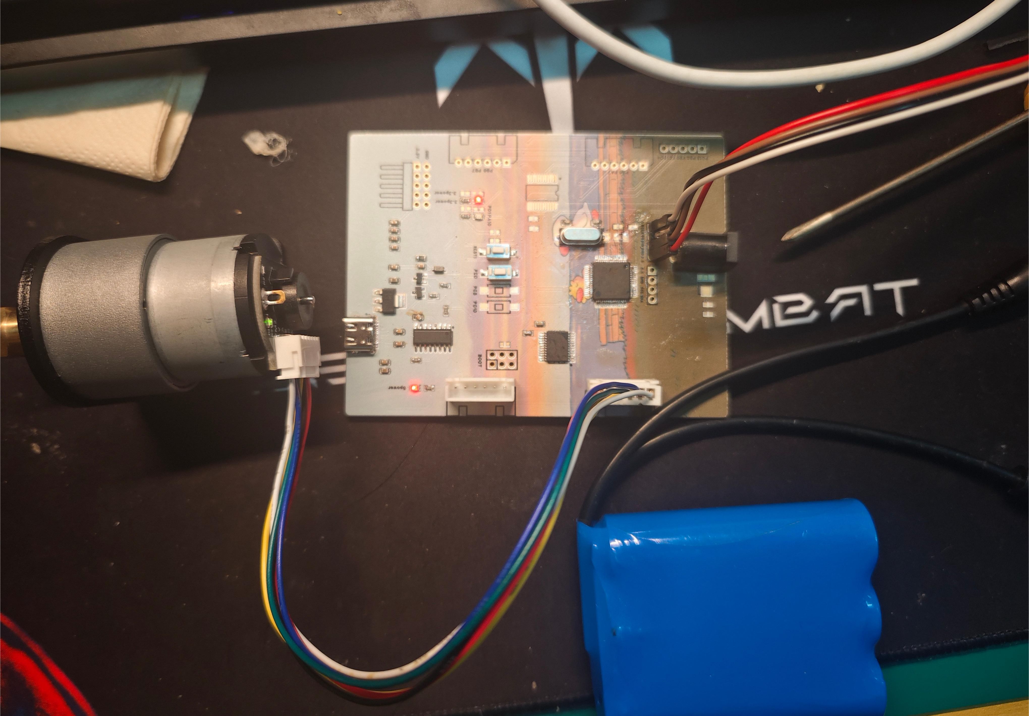

This project is a brushed motor driver board based on the STM32RCT6.

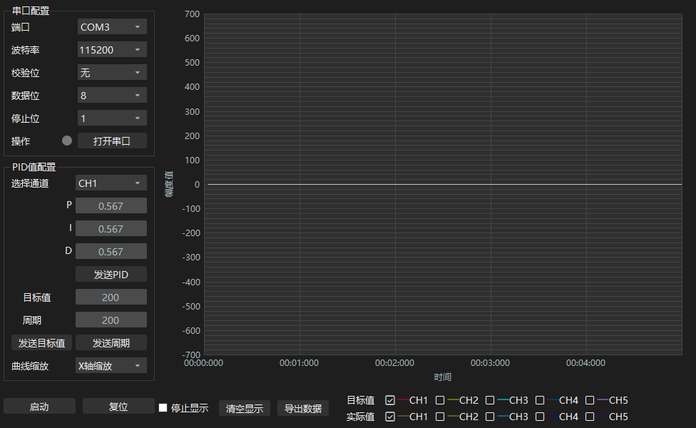

It utilizes the pin resources of the STM32RCT6 as much as possible, using two TB6612 driver chips to drive four servos, achieving their control. It also includes button and other functional modules for PID debugging. Interested readers can add a serial port to view the PID status using the Wildfire debugger.
This PID debugging tool is quite useful, providing a clear and intuitive display of various physical quantities.
