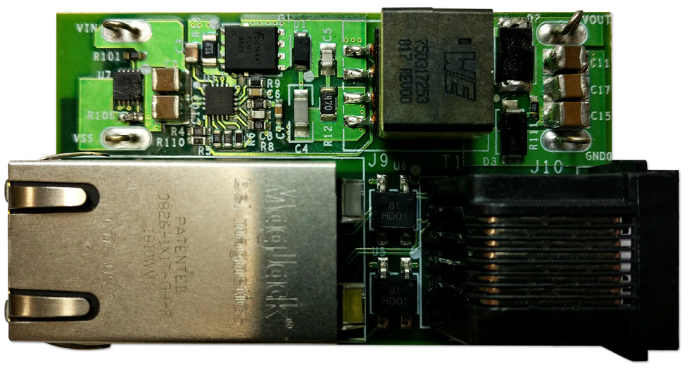

This board is not available for purchase.
Designed, Built, Tested
This document describes the hardware shown in the photo above. It provides a detailed technical guide to designing a complete interface for a PD to comply with the IEEE® 802.3af/at standard in a PoE, class 3 system and an isolated no-opto flyback DC-DC converter using Maxim’s MAX17690 controller. The power supply has been built and tested.
