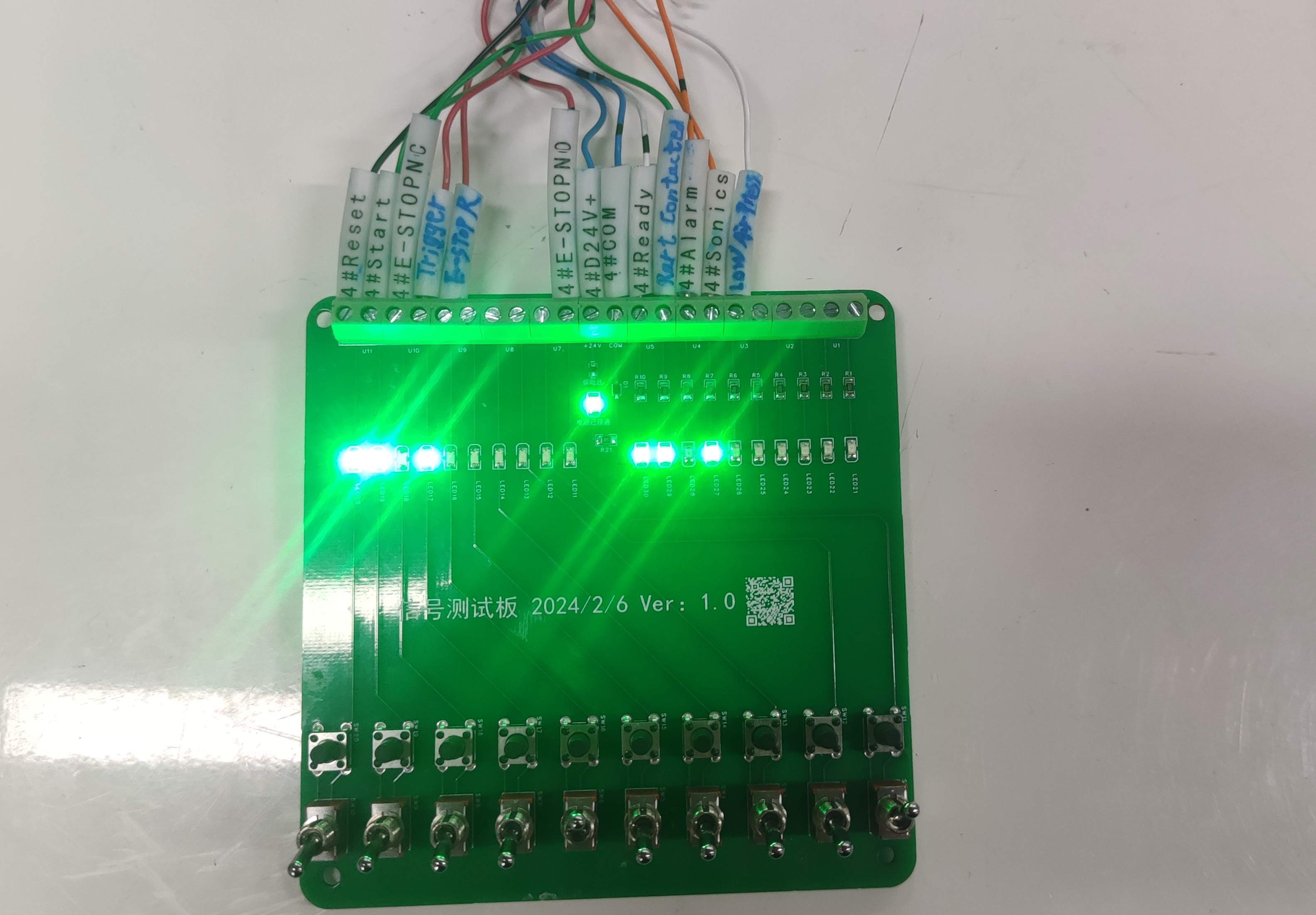

Signal test PCB
*2024.2.6*
Ver: 1.0 Updated compared to the original version
+ 10-in-10-out signal cable
+ toggle switch
+ micro switch (undetermined)
- 8-in-8-out signal cable
- DIP switch
- micro switch
※Supports 10*10 free PCB layout
*2024.3.5*
Ver: 2.0 Updated compared to Ver: 1.0
, changed the upper layer wiring through the center hole to the lower layer
adjusting the silkscreen position
※No longer supports 10*10 free PCB layout
