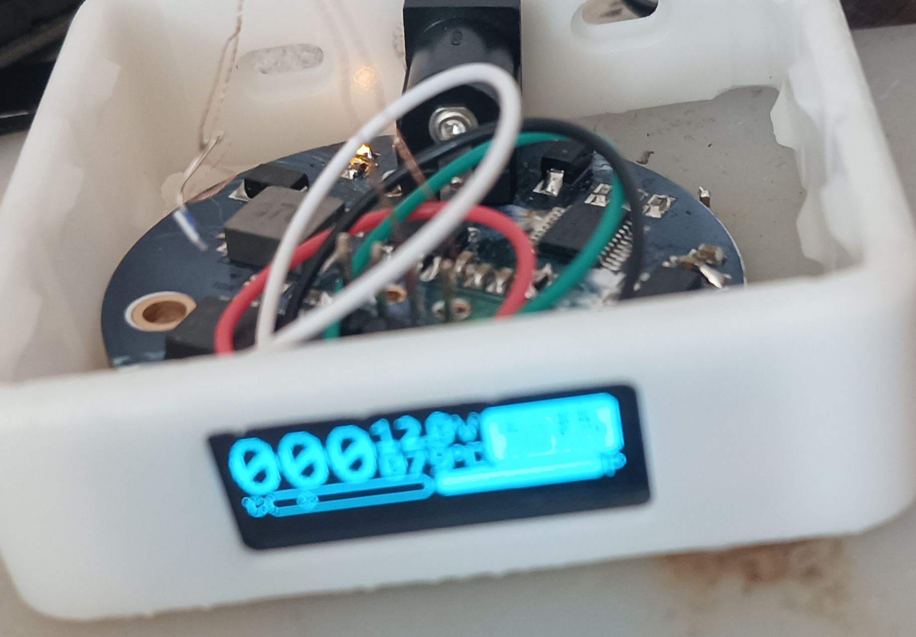

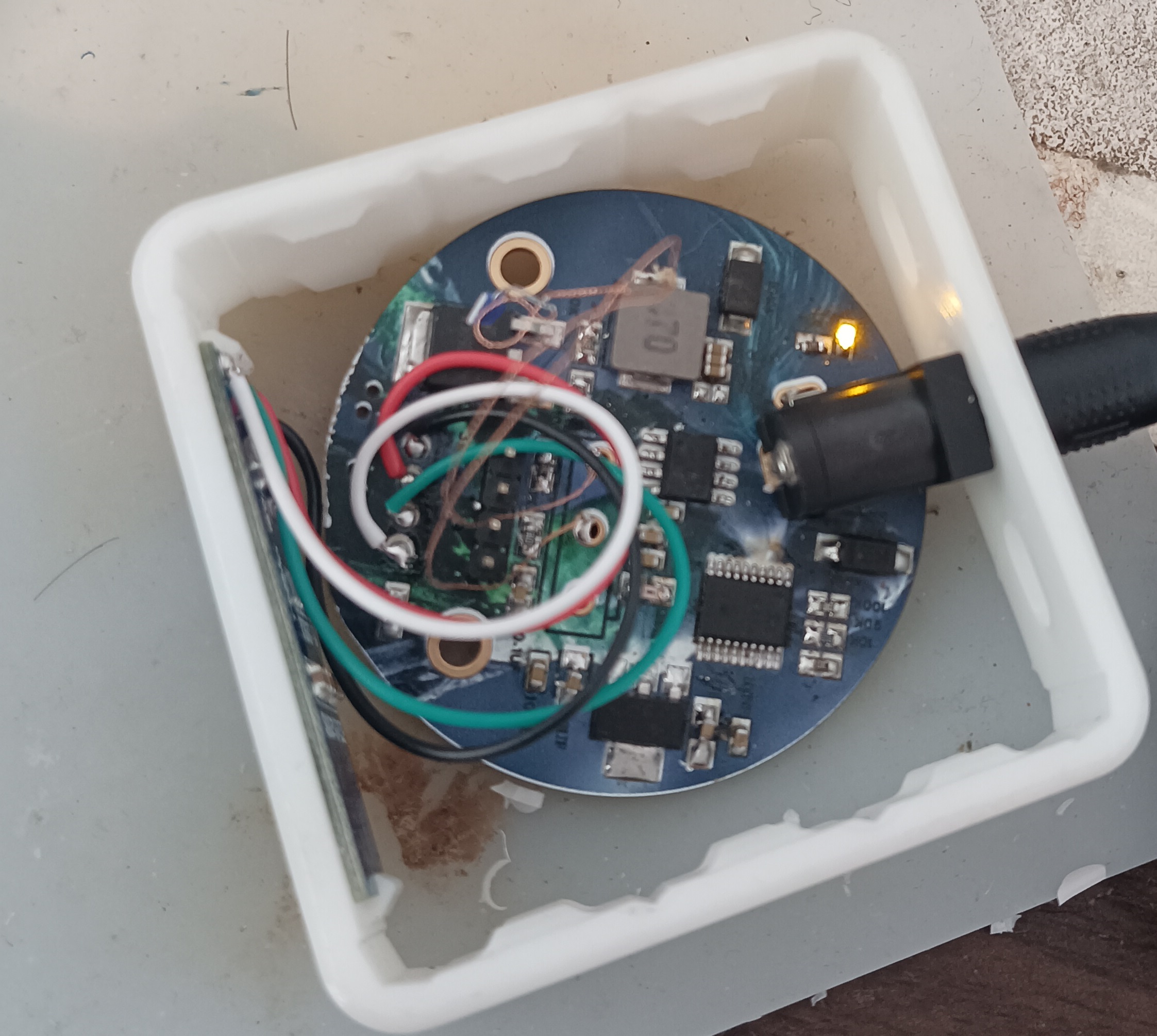

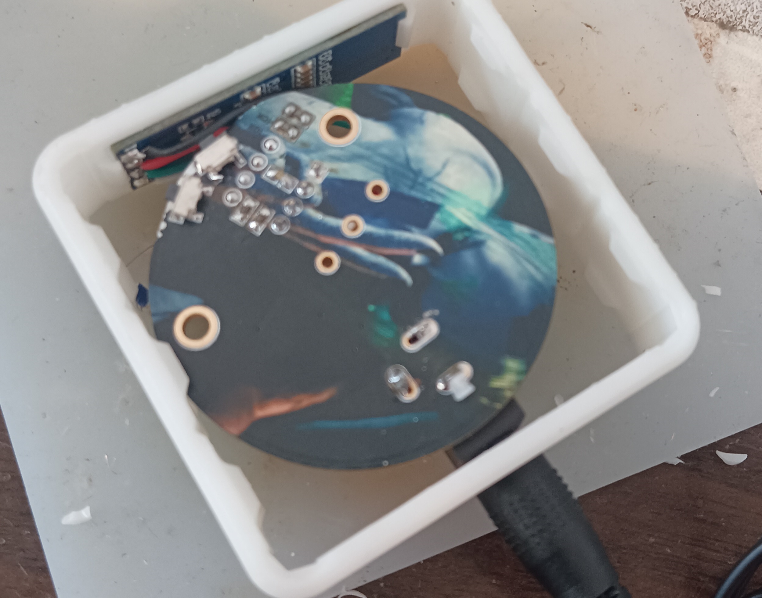

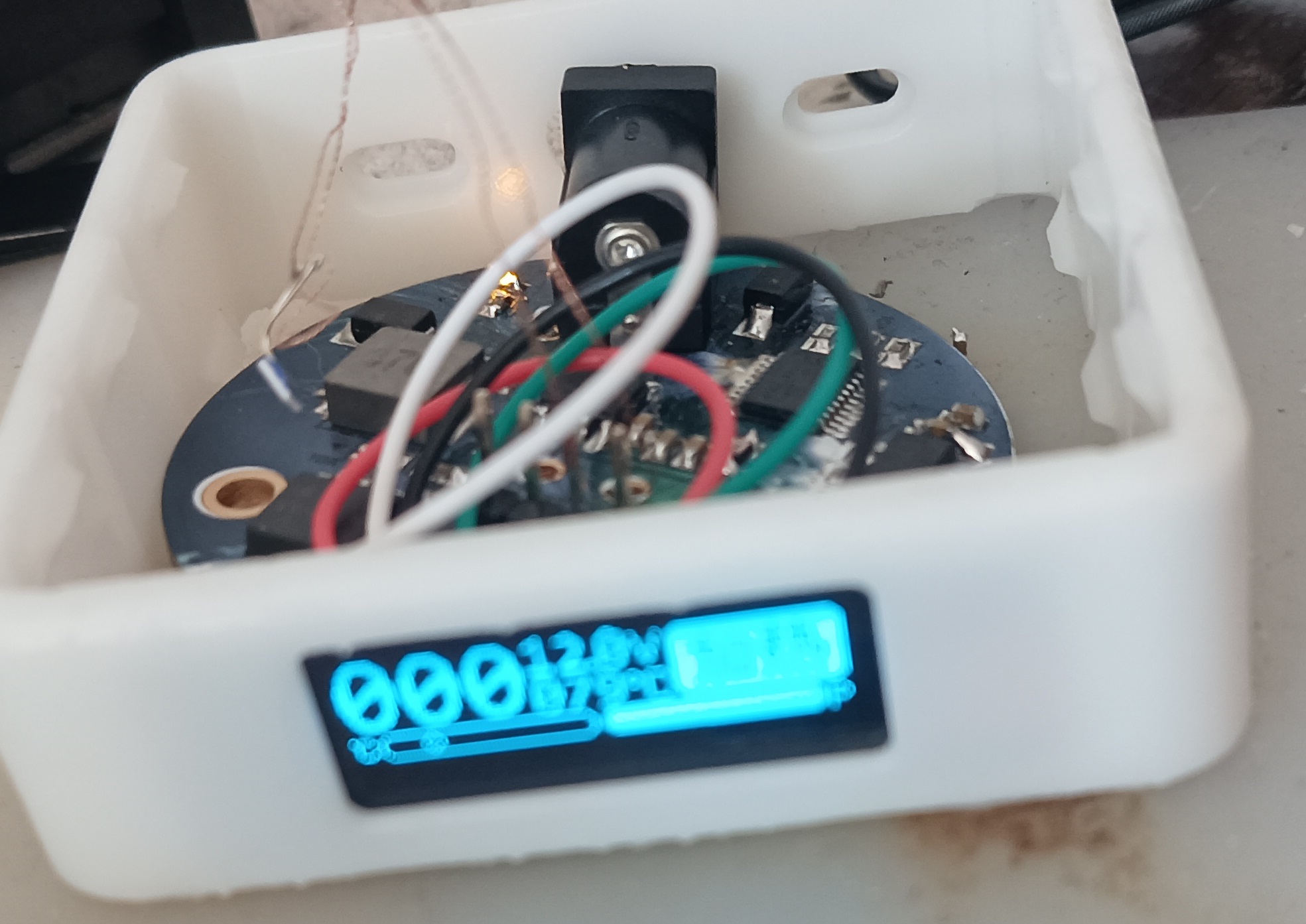

Warm water cup v1
The aluminum substrate is heated by controlling the on/off state of a MOSFET using a microcontroller, with temperature detection and constant temperature control. The outer casing can use the casing of a portable electric heating cup, and the heating plate can also use its compatible design. A cheaper alternative to the main control unit is used. It features DC power
supply, reverse connection protection, and two-way step-down protection devices.
参考设计图片
