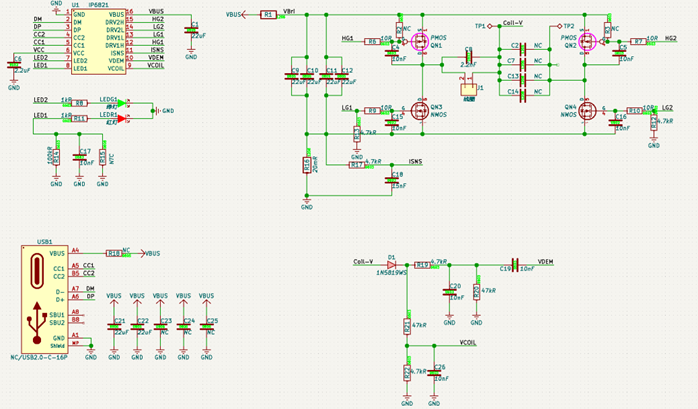

15W Wireless Charger (TX): IP6821
1. The IP6821 is a highly integrated wireless charging transmitter control chip compliant with the WPC qi standard. Internally, it integrates an H-bridge driver module, an ASK communication demodulation module, and the adapter fast charging sink protocol, among other essential wireless charging resources.
2. It supports foreign object detection; if a metal object is detected in the coil, operation will stop to prevent overheating.
3. The WX15W-6821-0 represents the most cost-effective version of the IP6821 solution. It supports
wireless protocol standards
such as BPP, PPDE, and EPP. Compliant with WPC Qi standard
, wireless output power
5~15W,
input USB protocol
DP&DM, PD3.0,
input power
≤20W,
rated input voltage
5V/9V/12V,
standby power consumption
≤10mA,
charging height
≤5mm,
charging efficiency
70%~85% (including DC-DC conversion efficiency)
, charging area
10mm*10mm,
number of coils
1 ,
supports charging
one device at a time,
product certification
overcurrent protection
2.2A±10%,
overvoltage protection
none,
overtemperature protection
60℃~70℃,
supported
. Note:

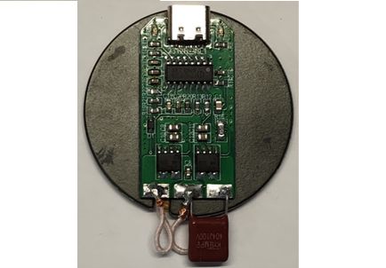

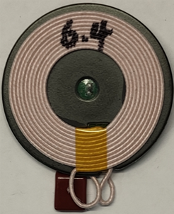

1. When the TX coil deviates significantly from the resonant point of the RX coil of the device being charged, the wireless charging efficiency will decrease, which is normal.
After the charging efficiency decreases, the temperature of the MOS will rise. Therefore, the wireless charging coil needs to be attached and fixed to the PCB board so that the PCB board can dissipate heat through the coil. Furthermore, the NTC resistor can effectively collect the overall temperature of the board and coil.
参考设计图片
