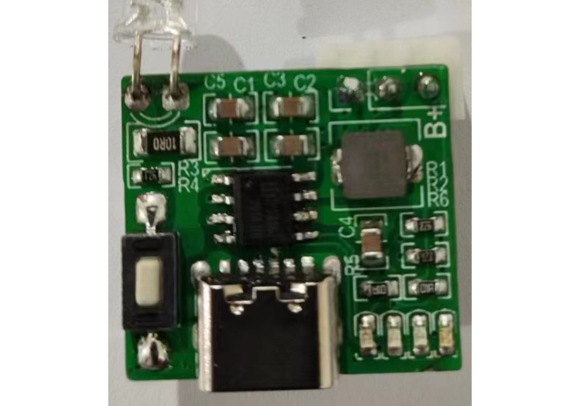

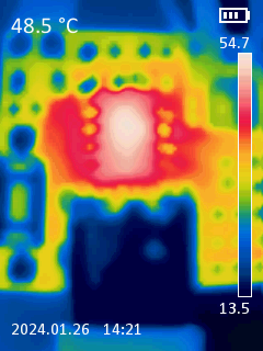

Charging (left), Discharging (right) Temperature

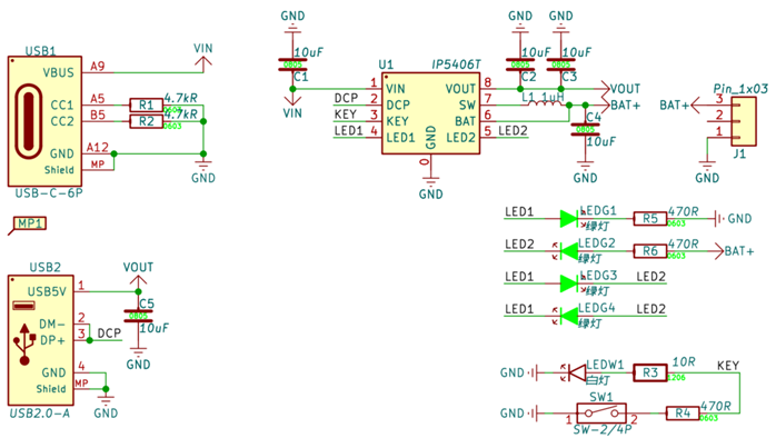

Schematic Diagram

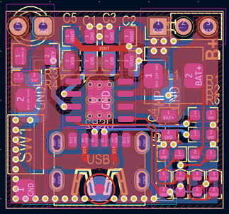

PCB Layout Diagram

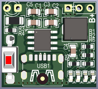

PCB 3D Preview

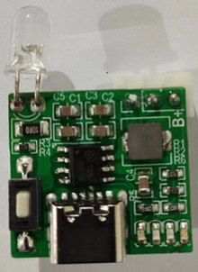

PCB Physical Image
