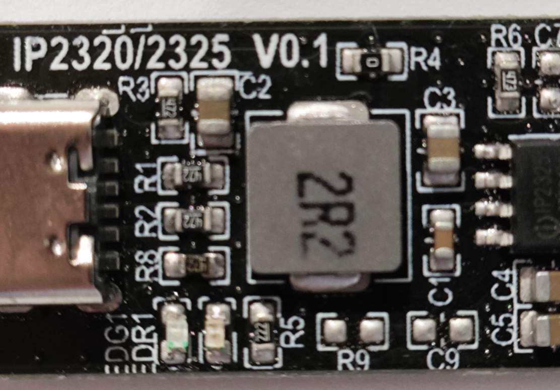

2-3 series battery charging IP2320 2325_V0.1
Function Description:
USB 5V input, synchronous boost, charges 3-cell batteries, battery terminal current approximately 1A, charging power approximately 14W.
Input voltage
4.5~5.5V. 20V Max. 4.5V triggers undervoltage protection, automatically reducing charging power.
Output voltage
3*(4.2/4.15/4.1/4.05V±0.05V) (other specifications can be customized) .
Trickle charging
threshold 3*(3.0V±0.05V), trickle current 100mA±50mA,
full charge cutoff
200mA±100mA. (When the chip output reaches 12.6V but the battery voltage does not, the charging process switches from constant current to constant voltage. The higher the internal resistance of the battery cell and wires, the longer the constant voltage charging time.)
The LED
output is high during charging and low when fully charged; it will flash in case of an abnormality.
NTC
does not support
chip over-temperature
protection; it has built-in over-temperature protection up to 135℃.
USB voltage,
USB current, battery voltage ,
battery current , charging power, charging efficiency: 4.80V 2.31A , 9.97V 1.04A , 11.09W , 93.51%; 4.75V 2.96A , 12.39V 1.03A, 14.06W , 90.77%. Charging temperature . Schematic diagram , PCB layout, PCB 3D preview, PCB physical image.
