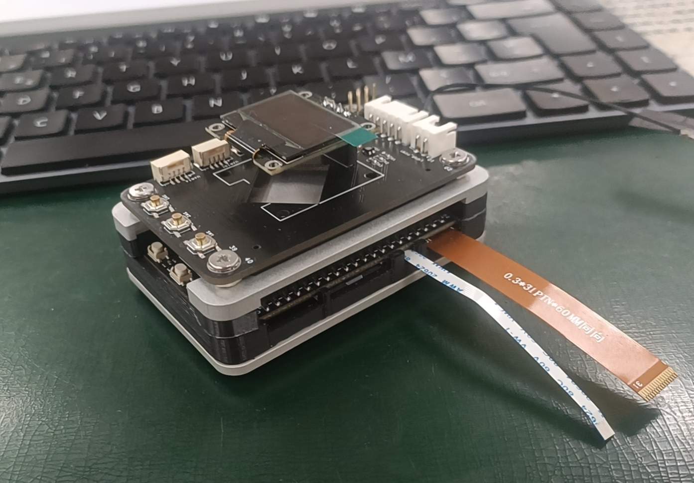

Taishanpai serial port expansion board + casing
The casing is made using 3D printing and CNC machining, while also considering heat dissipation and portability (this model is applicable to JLCPCB's one-yuan CNC rules).
Serial port 3 and the RPLIDAR communication interface are shared.
If you want to enable these serial ports (Linux), please enable them in the device tree of the source code.
The I2C2 interface and
UART are UART3, UART4, UART5, UART7, and UART9.
The LED colors and I/O ports correspond as follows:
GPIO3_A1-B ,
GPIO3_A2-G,
GPIO3_A3-R.
The buttons (numbered 321 from left to right) correspond to the following I/O ports:
GPIO0_B7-SW3,
GPIO3_B3-SW2,
GPIO3_B4-SW1.
