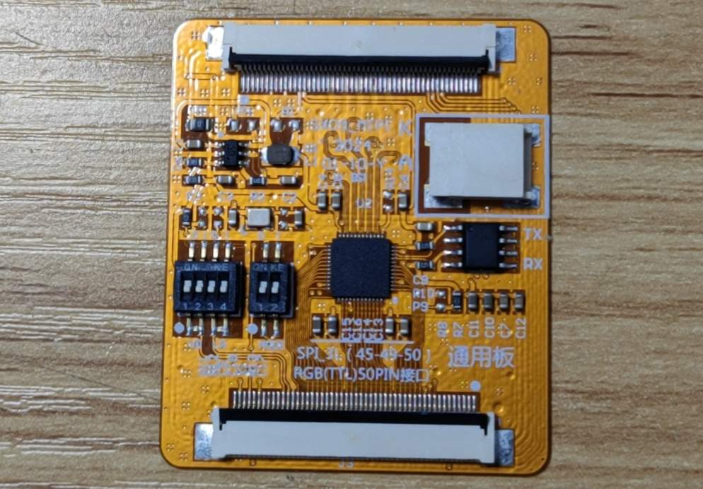

MIPI to RGB (TTL)
This software enables MIPI to RGB conversion to meet various needs.
The ICN6211 chip's internal structure includes a MIPI input port, an RGB output port, control logic, and an IIC interface. When a MIPI signal is input to the ICN6211 input port, the control logic processes and converts the signal, then outputs the converted RGB signal through the RGB output port. During this process, the chip communicates with the ICN6211 chip via register/IIC communication to control and configure the chip's operating parameters, including resolution, refresh rate, and color mode.
The ICN6211 chip supports a wide range of resolutions to meet the needs of different devices. By configuring resolution parameters through register/IIC communication, we can adapt the image signal to different displays. Furthermore, the ICN6211 chip supports conversion of various color modes, including RGB888, RGB666, and RGB565. By configuring the control registers, we can select the appropriate color mode to ensure the image displays optimally on the screen.

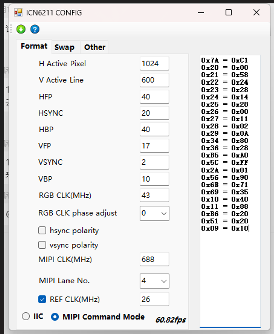

Parameter configuration:
I've completed this myself, but you can also refer to the following link from an expert on this site: https://oshwhub.com/okll/tspi-mipidsi-to-rgb-adapter
