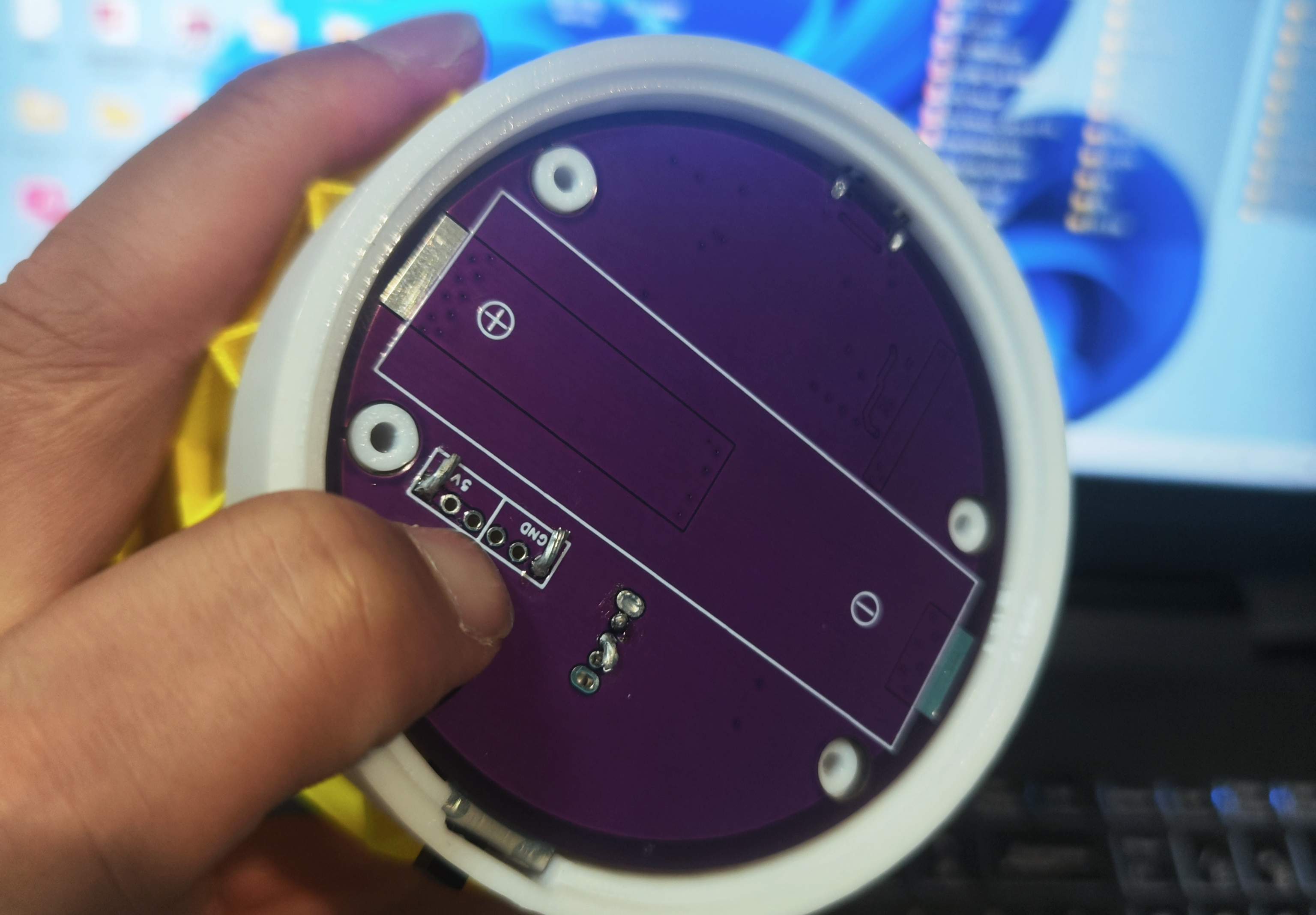

Tuozhu LED light base charging board
This printed circuit board is designed for Tuozhu LED lights and includes a 3D model STL file.
Functions: The Tuozhu LED light base charging module provides charging, protection, and voltage boosting functions.
The positive and negative terminals of the battery icon on the PCB are connected to the positive and negative terminals of the battery. The 5V and GND outputs are silkscreened; only 5V is output, which can be connected to the positive and negative terminals of the LED. The Type-C port is the charging interface. When Type-C is connected, it powers the battery and provides power; when Type-C is not connected, the battery powers the battery.
The unsilkscreened pin headers (pins 2 and 3 of the five-pin header, i.e., the pins with copper contacts) are connected to the switch or directly short-circuited (a direct short circuit disables the switch function).
