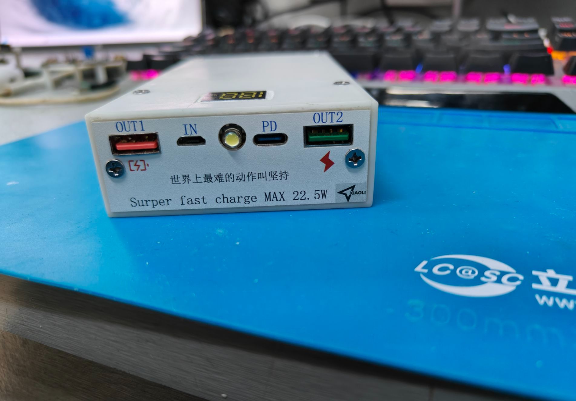

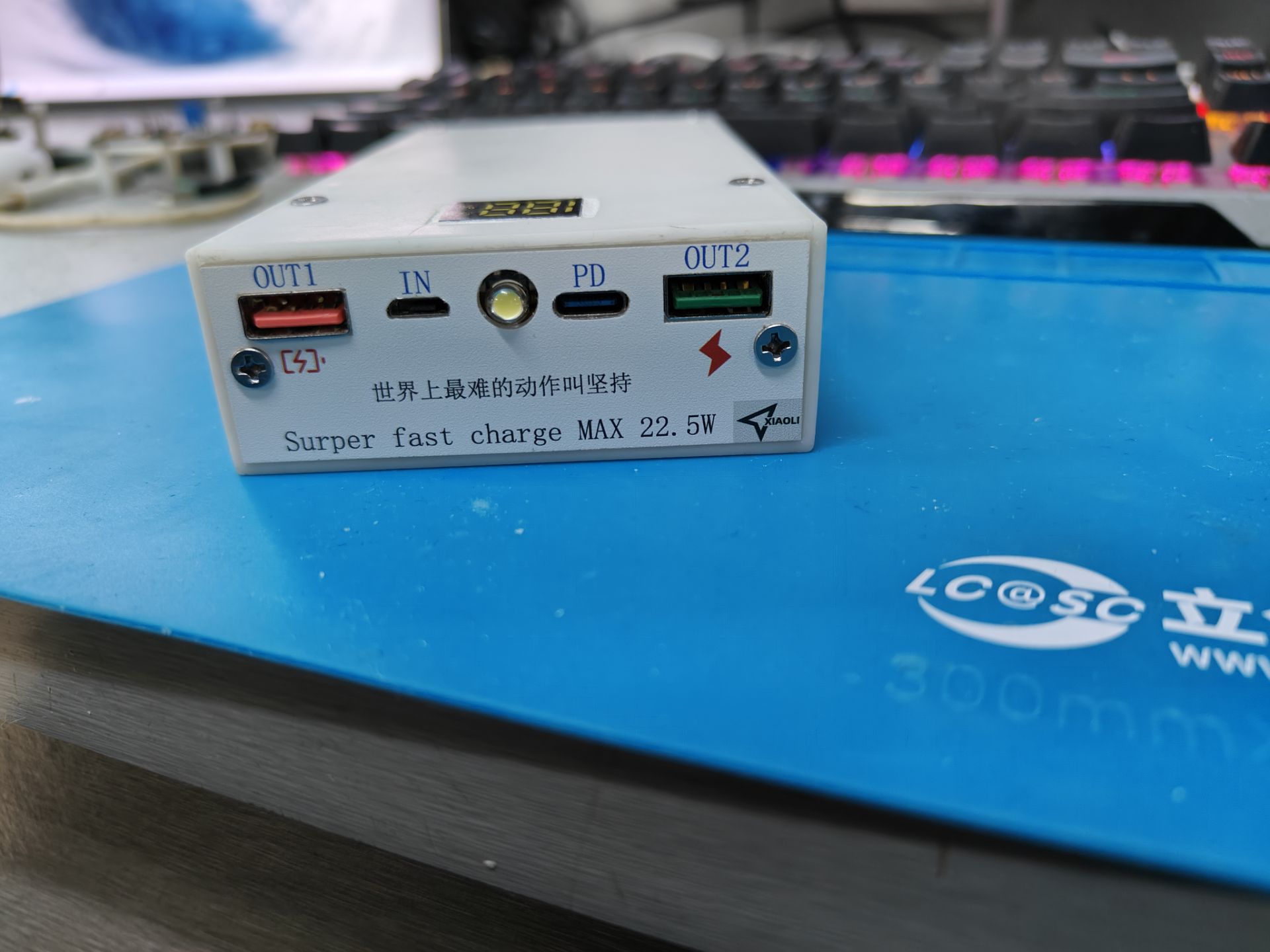

As a dedicated electronics DIY enthusiast, how could I not want a fast-charging power bank?
This power bank uses the SW6208 motherboard solution; it features two USB-A outputs and either a micro-USB or Type-C input; the Type-C input supports PD output; it supports 4.2/4.35/4.4/4.5V battery types; it supports JEITA specifications; it supports temperature loop control
; and its output power reaches up to 22.5W. It also features automatic load detection/light load detection
. 22.5W flash charging + fast charging function parameters:
--Output fast charging protocol
supports PPS/PD3.0/PD2.0
, QC4+/QC4/QC3.0/QC2.0
, AFC ,
FCP
, SCP
, PE2.0/PE1.1
, and SFCP,
and supports low-voltage direct charging
.--Input fast charging protocol
supports PD3.0/PD2.0
, AFC
, FCP
, SCP
, and PE1.1.
Note:
1. After installing the battery, a complete charge-discharge equalization process must be performed for the digital battery level display to be accurate! Specific method: 1. First, discharge the battery by charging the phone until the battery is completely depleted and the phone shuts down. Then, charge the power bank until it shows fully charged. Then it can be used normally. (Remember! If you remove and replace the battery after equalization, you need to do the equalization again.)
2. I used two 10000mAh lithium-ion batteries in parallel. However, these batteries are prone to bulging. Poor power management will almost always cause bulging, even with high-end power banks from brands like Xiaomi and Maxx. I used these batteries because I had them on hand and was too lazy to replace them. If you want to use them, I recommend 18650 batteries from reputable brands like Panasonic; they are of excellent quality and safe to use.
3. If you plan to store the phone unused for a long time, I suggest discharging it to 80% and recharging it every three months. Although I designed a low-voltage protection circuit, it's still possible for the battery to fail.
The PCB uses JLCPCB color silkscreen printing technology; the panel was designed using CAD + LCPCB Professional Edition, and I am very satisfied with the results. Highly recommended! The casing is also printed using 3D printing technology, which has high precision. Highly recommended!

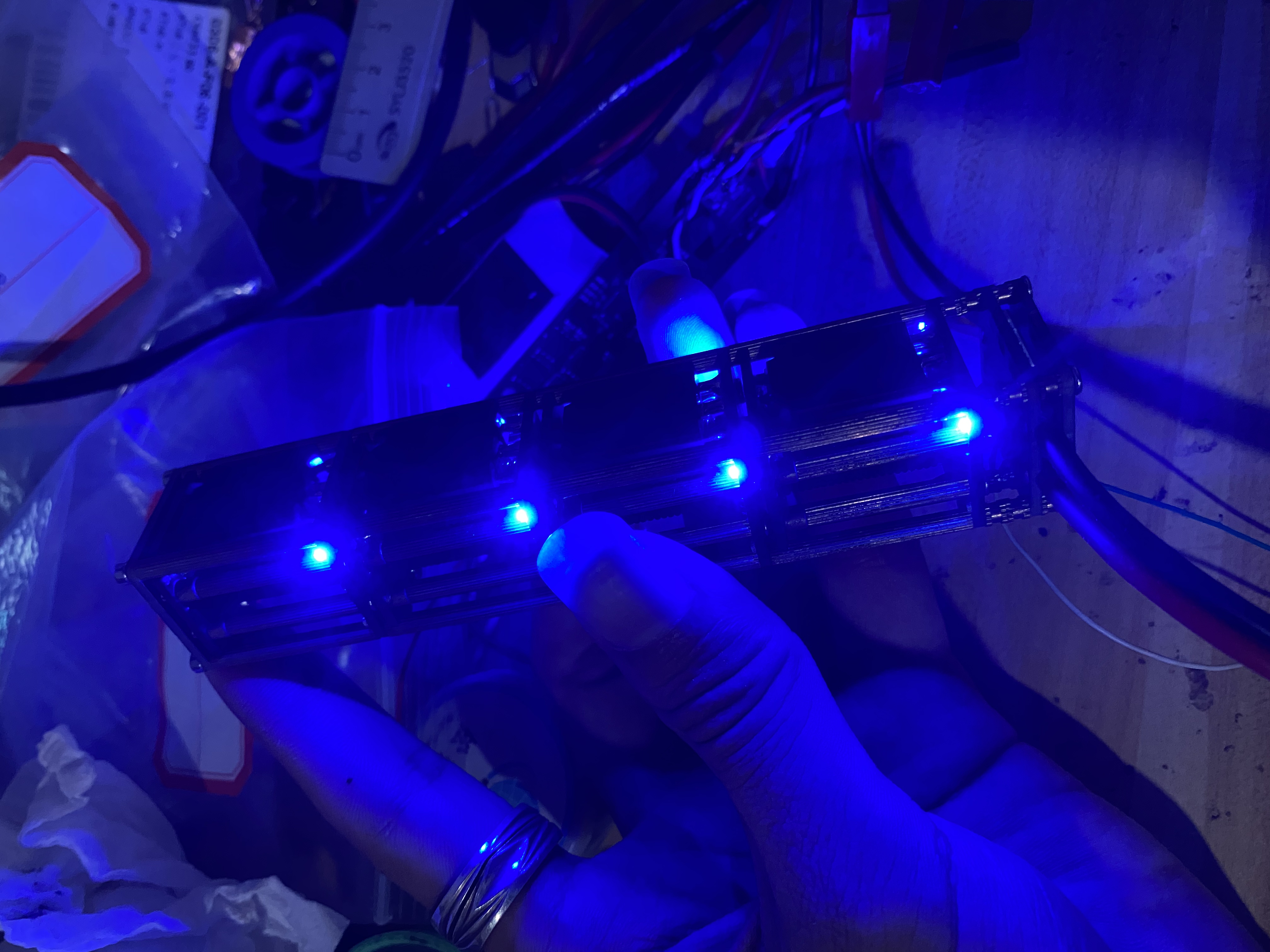

Modular low-pressure electromagnetic railgun
Made in 2022, it has a compact structure but a rather complicated manufacturing process. It measures 24x24mm, with each stage measuring 30mm in length. It uses an 8S+3S lithium battery for power and incorporates many nut pillars. Some components do not match the schematic.
