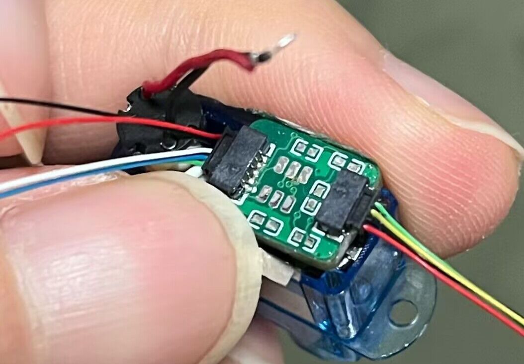

This description
is based on the servo drive PCB board of the open-source project Electronbot by Zhihui Jun. The wiring on both sides has been modified to use 4-pin and 5-pin connectors. Testing has shown it works correctly. This eliminates the need for soldering wires, making programming, assembly, and disposal easier. It has been verified as feasible. Compared to the original PCB, it is more compact during assembly, with better internal space for wire management, making assembly simpler and more convenient. Several other boards will be updated later to further simplify assembly.
Since the original and various modified versions still use soldering, programming and replacement are extremely inconvenient. Therefore, this modification facilitates subsequent programming and disposal. It has been verified as usable and is shared to help others build their own boards. A ready-made Gerb file is also uploaded as an attachment.

I've collected several videos sharing my experiences and pitfalls, which should solve most problems during the production process. Parts
List:
In addition to the original parts, you need to purchase the following two types of connector
cables. Don't forget to buy
the spacing:
Pin count:
Single/Double
0.6mm
1*4,
Double
0.6mm
1*5. Here's a bare P-
type dual-ended
board
: (Forgive me for being a newbie; the board uses a pseudo-four-layer design). Welcome to continue optimizing and sharing!
This is the modified outline (mainly the wiring scheme at both ends).
I really revised it several times just for these two small terminals (^▽^).
This is a suggested placement scheme after the modification.
Looking at the comments on several related posts on Bilibili and forums, many people get stuck on the assembly.
The wiring at both ends of the modified board is more elegant and saves more space.
I suggest using heat-shrink
tubing although it's longer, the thin wires take up almost no space and won't increase the assembly difficulty
. This is the final result after discussion and practice:
finally achieving "modularization"!
