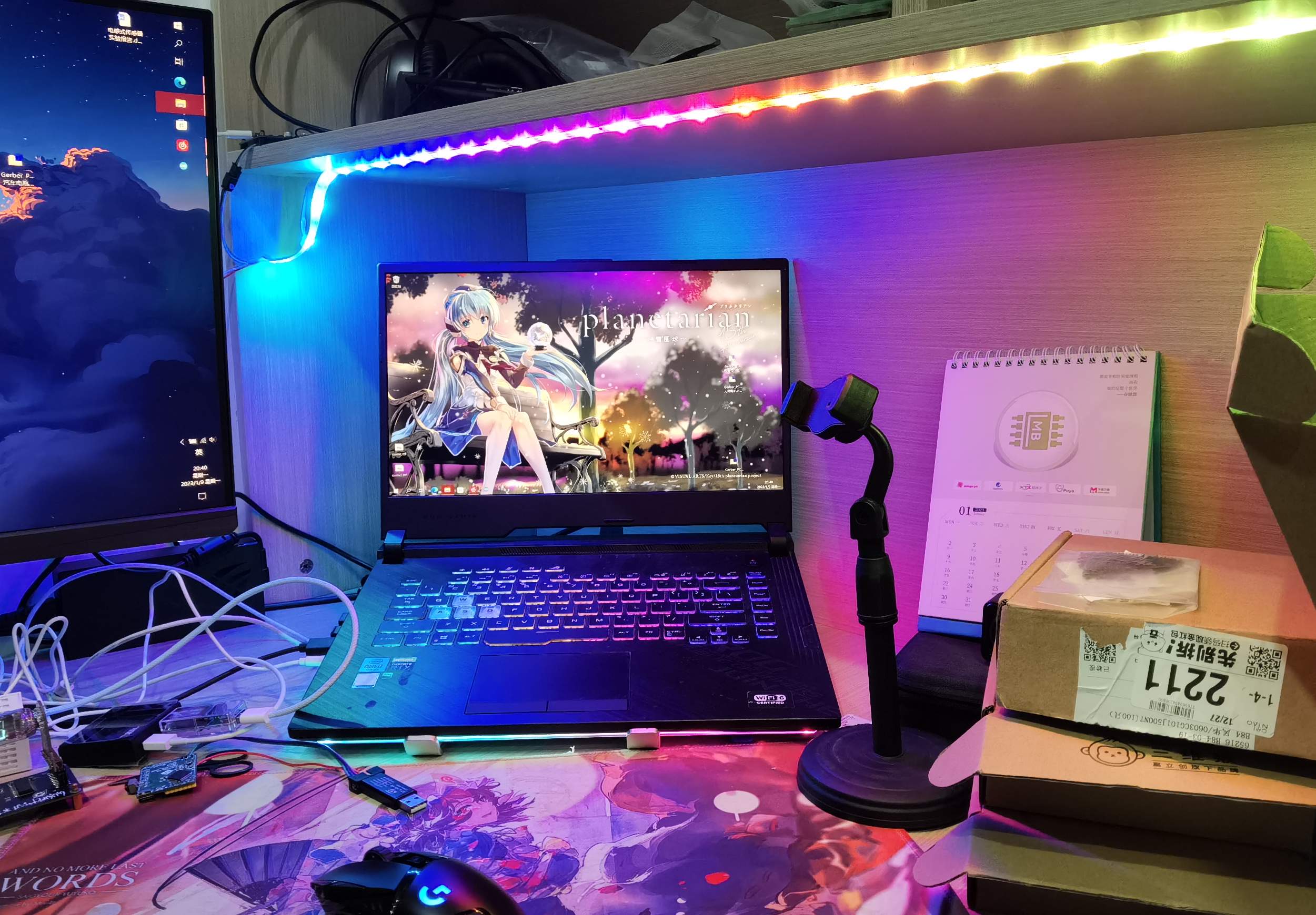

1. The WS2812 light strip is 5V, and the voltage must be supplemented if there are more lamp beads. Generally, the voltage must be supplemented if there are more than 120
lamp beads. 2. The power of the lamp beads is actually smaller than the nominal value. I used a power meter to measure the power of the whole board with a total of 120 lamp beads in two light strips, and the current was only more than 5W, and the current was about 1A (the brightness was set to 4/5 of the maximum).
3. Bring an acrylic board for simple protection.
4. It is not realistic to put light strips everywhere in the house. The most practical scenario is to put them behind the computer
