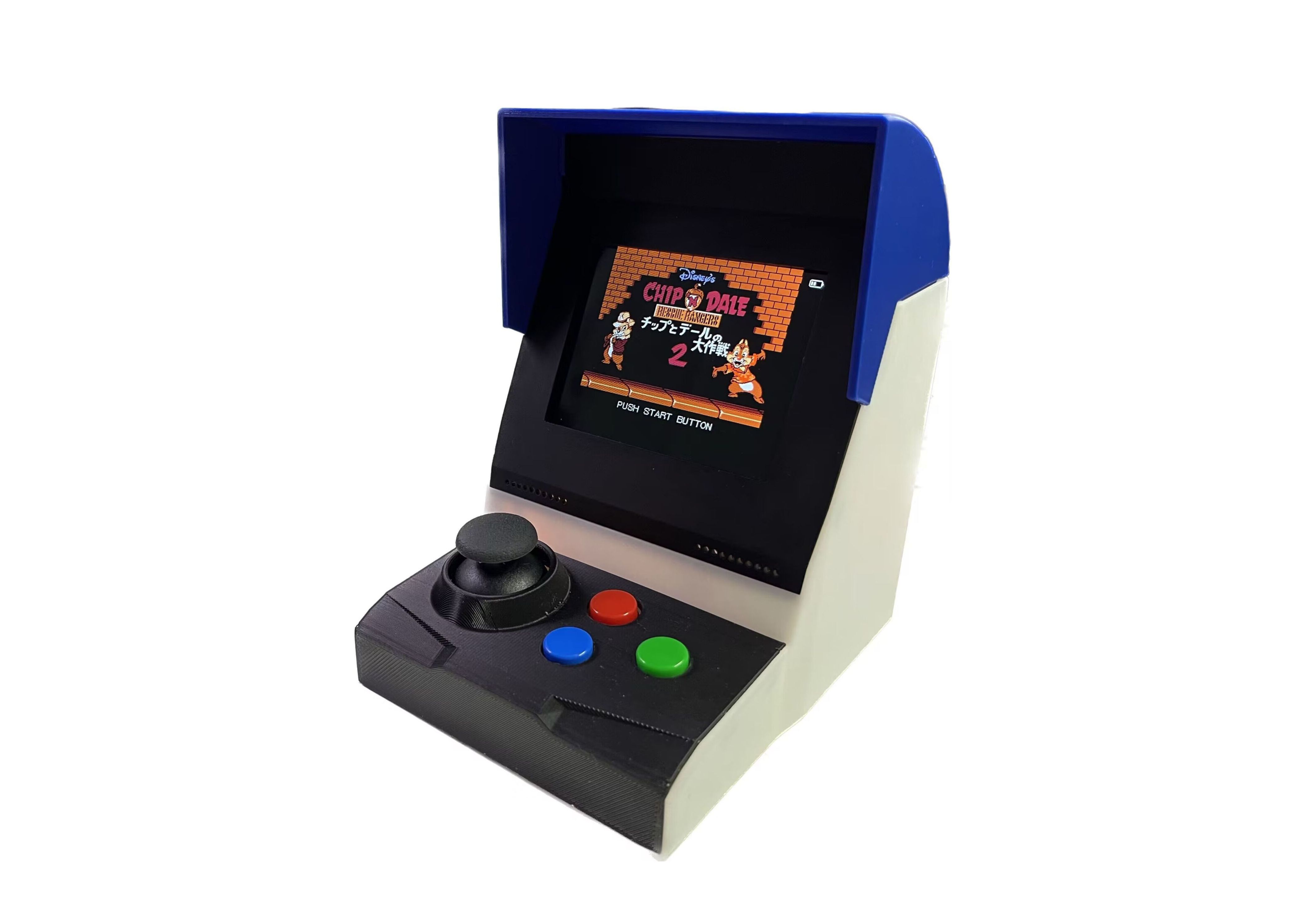

This is a game console accessory
based on the ESP32-S3, capable of playing NES games and supporting ROMs up to 1MB in size.
Games support onboard controllers, WeChat mini-program controllers, HID controllers, and HID keyboards (two-player mode supported).
XBOX and PS4 controllers require additional modules for support. Already compatible.
Additional features: MJPEG video playback/computer status monitoring, etc.

After two months of tinkering, I tried all the NES emulators on GitHub. They were either too slow, had too many bugs, or were IDF versions. I encountered countless pitfalls, all tears.
The final main emulator code framework was reorganized and repaired using the GitHub NESCat project, ported to the S3, and many processes were moved to PSRAM, resulting in loading and running speeds that are more than ten times faster. After all, we're using the N16R8 module, which has 8MB of PSRAM. Furthermore, the number of ROMs that can be emulated has been increased to 1MB. Currently, except for some very large ROMs and some heavily modified ROMs that cannot run, most ROM games can be emulated smoothly.
Functionality Overview
: 1. As an NES game emulator, after parsing the game, it displays the game on a 3.2-inch color screen, outputs sound signals via I2S, and uses a super powerful speaker; the sound combined with the vibration feels fantastic! 1. **Mute Functionality:
** Can be set to automatically launch an application or a specific game upon startup. [As a decorative piece, it runs a game demo upon startup, which is quite cool.]
2. **Secondary Functionality:** MJPEG player for playing MJPEG video files. [Applications can be set to automatically launch upon startup.]
3. **Secondary Functionality:** Secondary computer monitoring screen, used with AIDA64 to display real-time CPU/memory usage status. [Applications can be set to automatically launch upon startup.]

For those who want to expand their PS4 or Xbox controller usage, this expansion board is needed. It plugs into the dual-row expansion pins of the core board, and resistors R27 and R28 are removed to expand the USB-A female connector, allowing for compatibility with more USB HID devices. The
casing
is designed separately; you can see how detailed it is when you print it yourself. The QQ group also provides more building materials, including BOM recommendations, component links, etc., and you can also build it with other like-minded friends. Keep going, build your own game console and give yourself a proper ending to your childhood!
