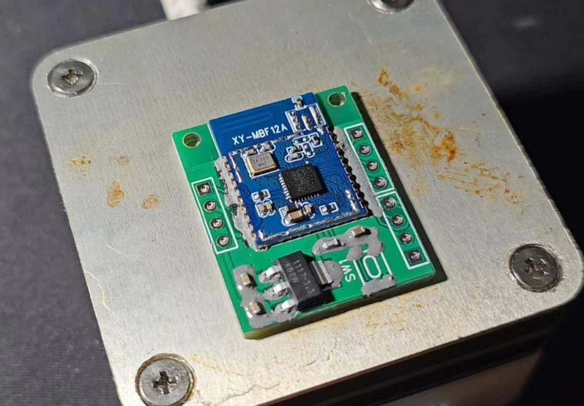

I. Shenzhen XinYi Information Technology's XY-MBF12 Bluetooth proximity switch baseboard features an exposed power supply, serial port, and special pins. These pins
  allow for configuration via a serial port assistant, enabling seamless connection. For example, when a person approaches a door, their mobile phone automatically connects to the module via Bluetooth, triggering a special pin to open the door without contact. The initial Bluetooth connection password can be configured via the serial port assistant, and connections from unknown mobile devices can be prevented, significantly enhancing security.

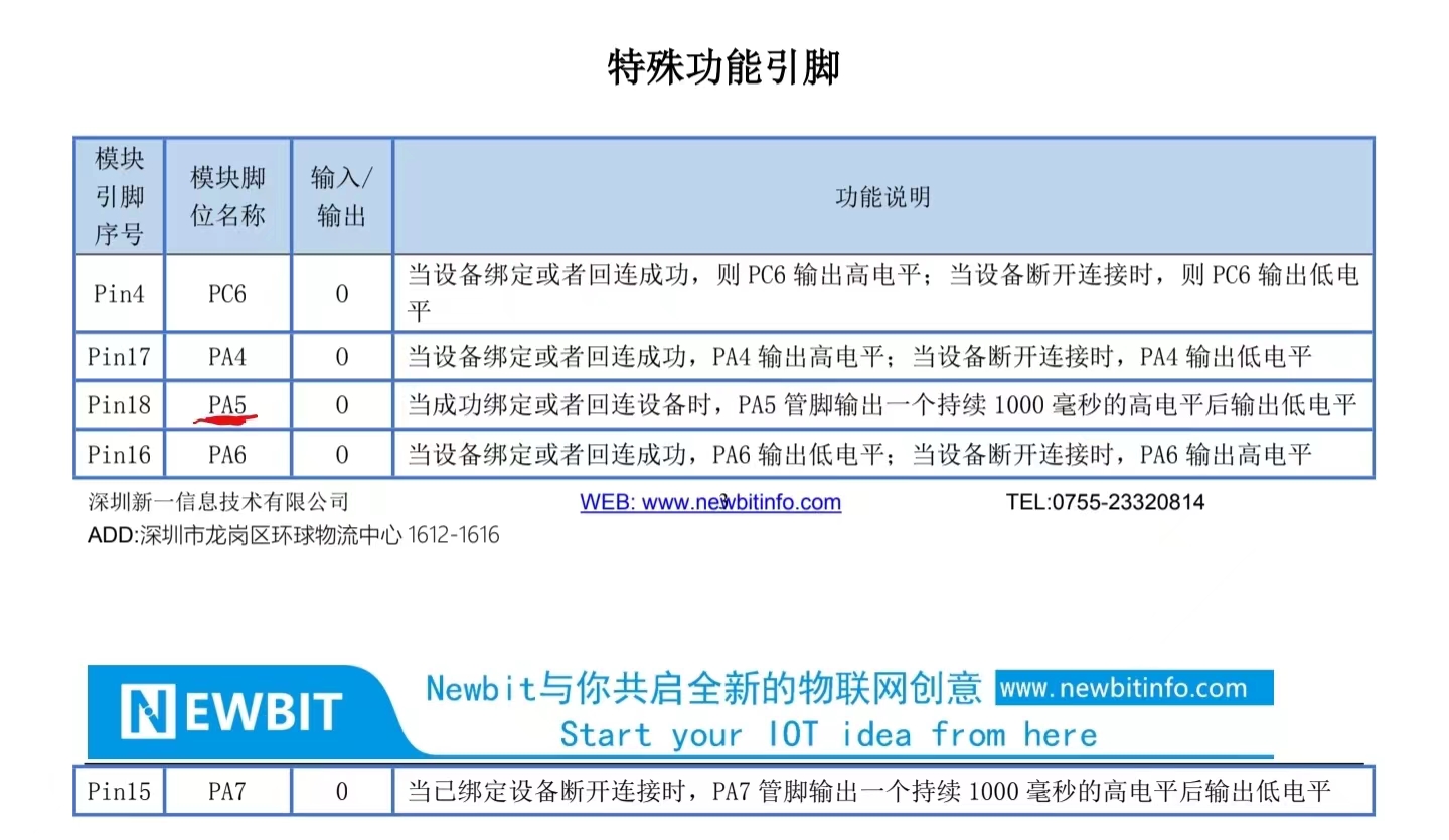

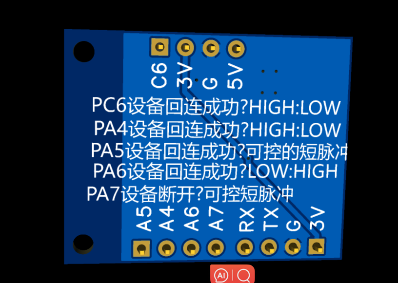

 III. When a mobile phone connects to this module via Bluetooth, a special pin on the module will activate; the activation timing can be configured via the serial port command sending instructions in the module's datasheet.

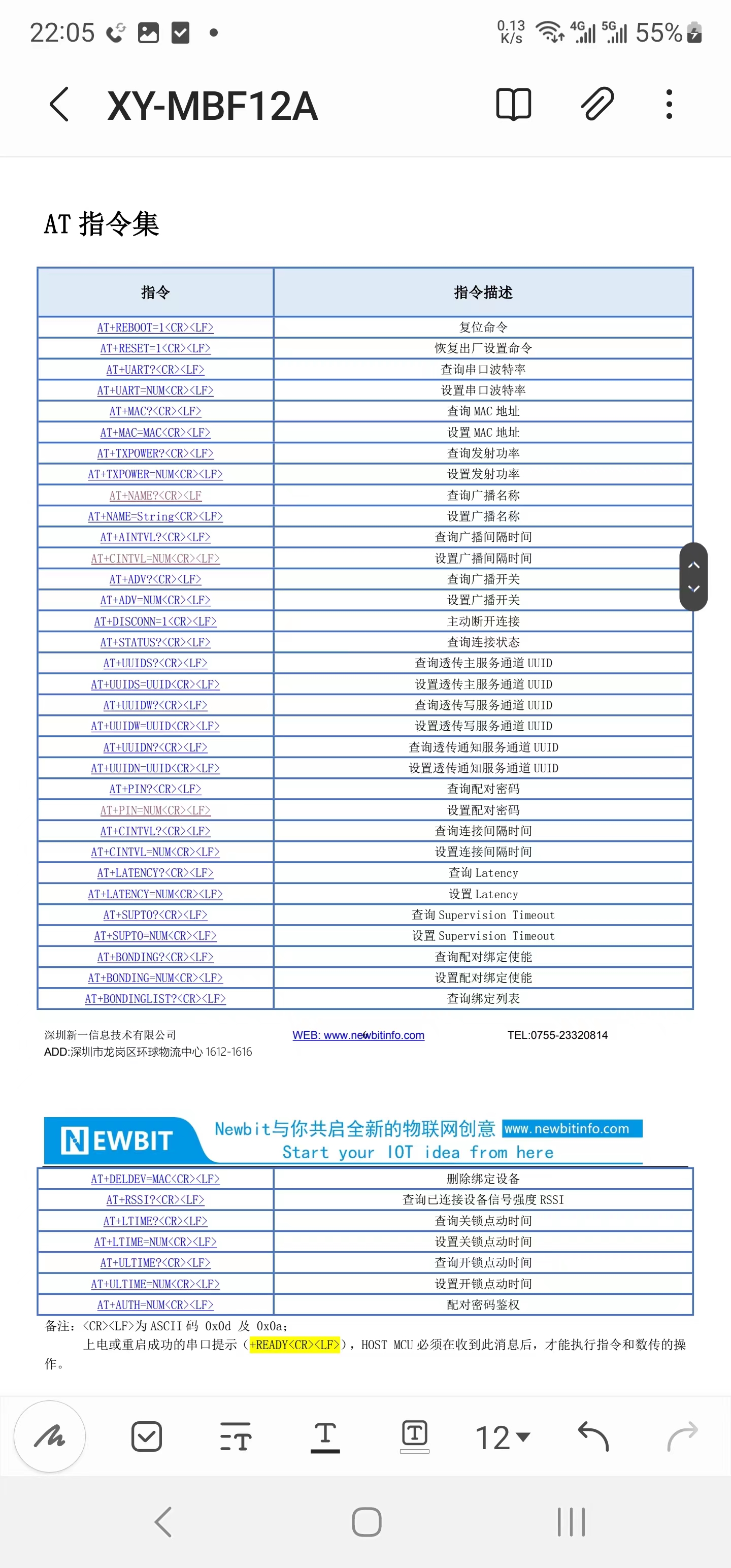

IV. AT command set
