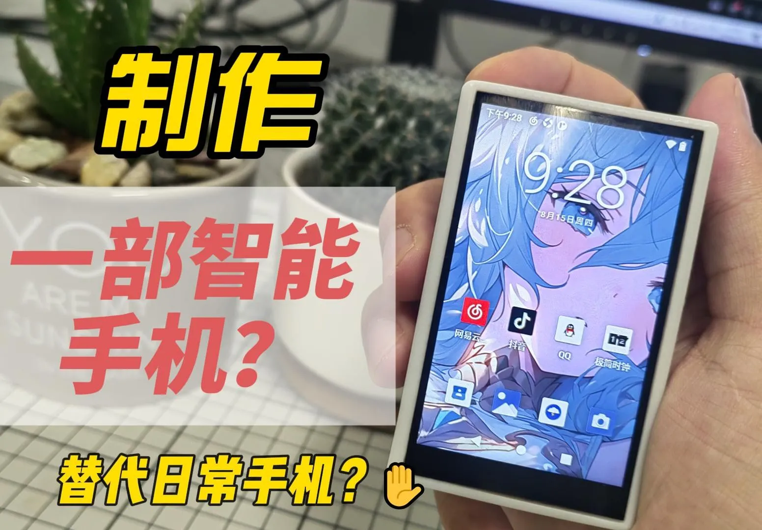

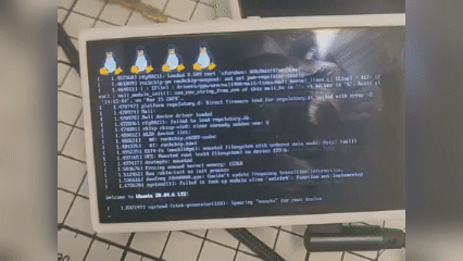

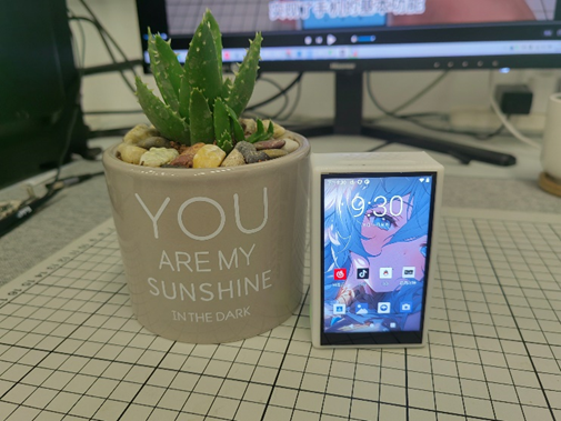

This is a "Little Dolphin" smartphone based on the LCSC Taishanpai Development Board and Android 11/Ubuntu 20.04.
V4 version demonstration video [Bilibili] I made a smartphone!!! Meeting daily needs?
V3 version demonstration video [Bilibili] I made a budget "phone" that can shoot videos? Play Genshin Impact?

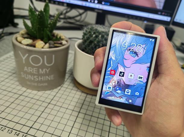

2. Project Overview
This
project is a smartphone based on the LCSC Taishanpai Development Board, adapted for Android 11 and Ubuntu 20.04. It features built-in lithium battery management, 4G baseband, 3.1-inch touchscreen, camera, power amplifier, voice input, accelerometer, angular velocity sensor, magnetometer, and touch buttons. It can achieve lithium battery power supply, GNSS positioning, try out motion-sensing games, make calls, send text messages, take photos, videos, play music, and all common Android apps. Smartphones represent the pinnacle of embedded development, yet there are very few open-source smartphones currently available. DIY smartphones are the best project for learning and practicing circuit design, PCB layout, and soldering, enabling customized operating systems and drivers, and developing or modifying application software.

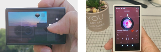

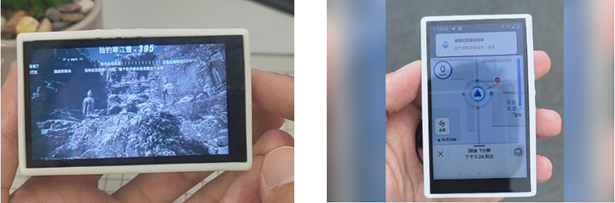

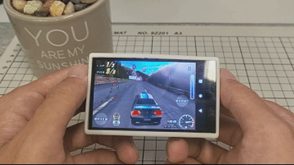

Motion-sensing game demo
(a) Photography (b) Navigation and positioning
(c) Video playback (d) Music playback
Overall project display
Project link
This project involves BGA package soldering, which is quite difficult for beginners. You can first learn about previous versions of this project. Link: [Little Dolphin Mobile Phone] Taishanpai 4G Internet Mini Phone - LCSC Open Source Hardware Platform (oshwhub.com)

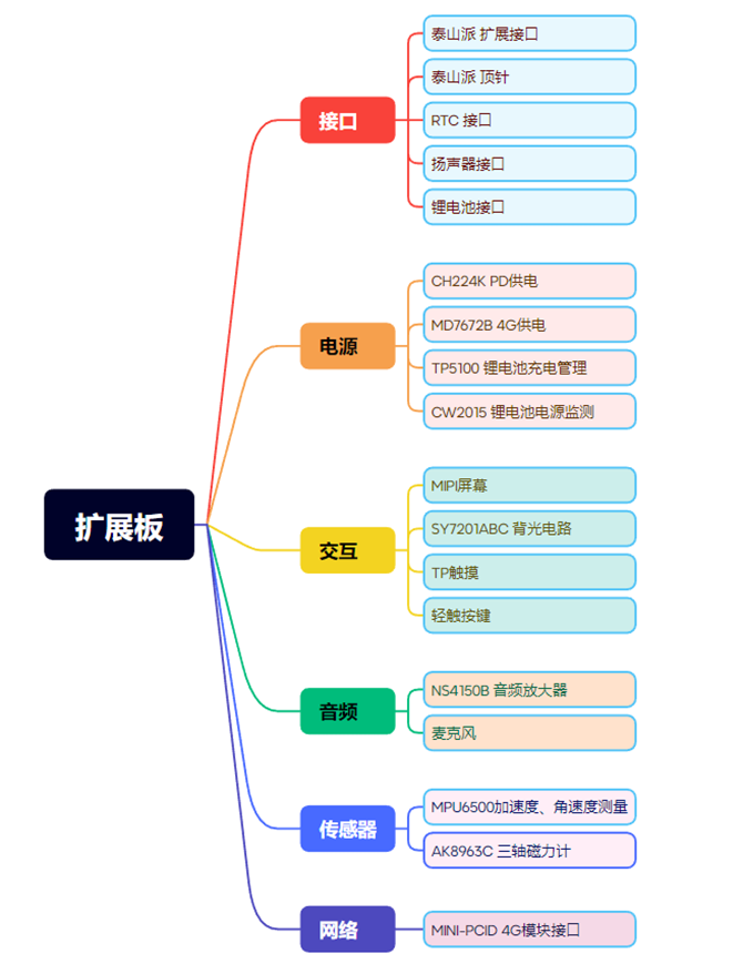

3 Design Scheme
System Composition
Hardware Label
Hardware Design Details
EC20 Module
The EC20 module consumes a lot of power, and the 4G module has an independent power supply output. The 4G module power supply switch is controlled by the 4G_PWREN_H pin, i.e., GPIO0 PA1. When 4G is not needed, this pin can be set to low level to save power.
Lithium battery charging and discharging
The TP5100 lithium battery charging management chip is fragile. If the hardware design is not good, it is easy to burn out. Please strictly refer to its official design manual when designing! 4G
module
has its own voice output. After testing, the microphone can be used with Taishanpai, but the speaker cannot. If you need to use the function, please solder FPC7 and remove R41 and R42. And pull GPIO0 PA0 high within the device tree.

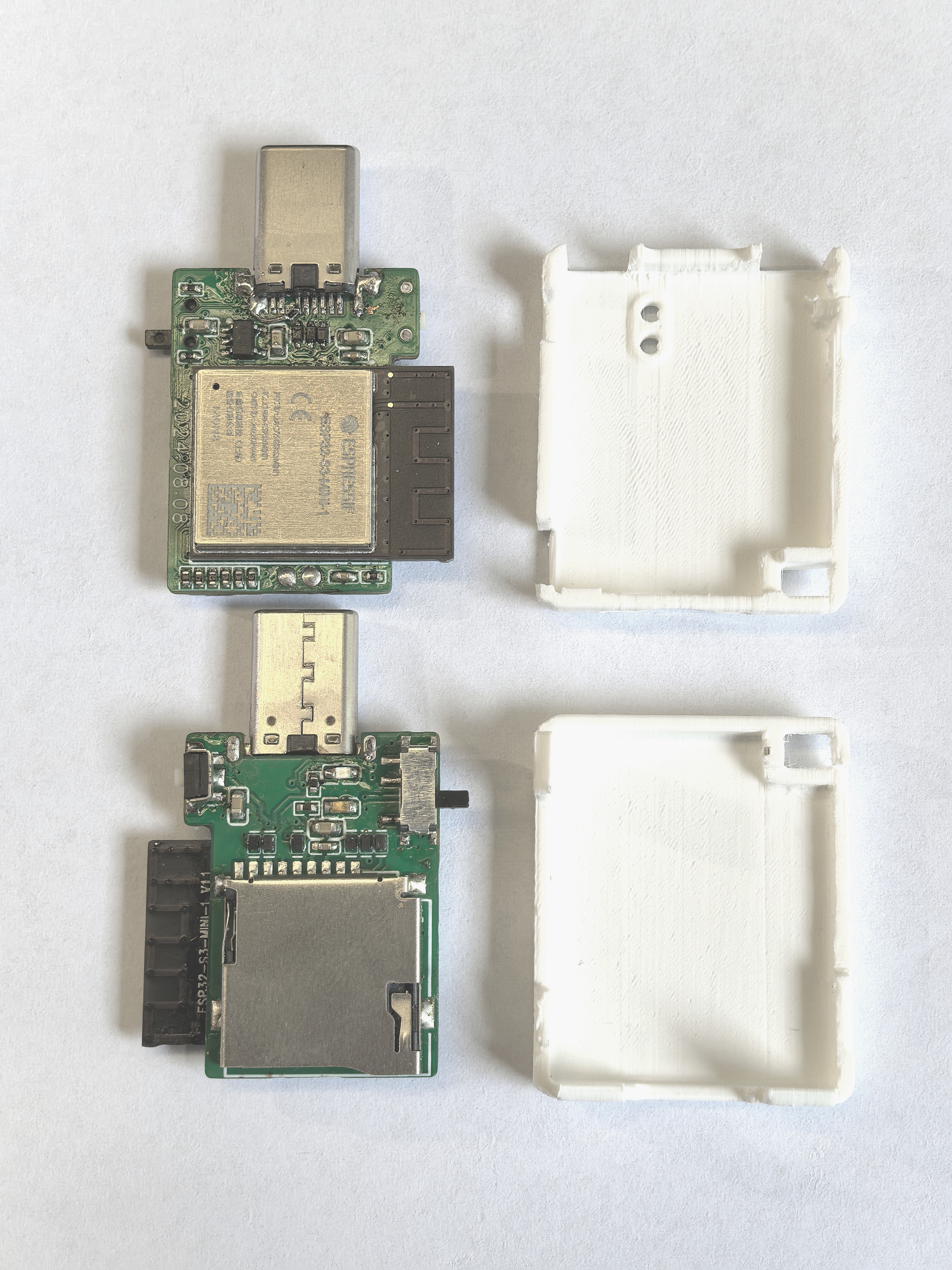

Physical Product Demonstration:
The physical product image
is shown below.
The 3D file of the casing can be downloaded from the attachment!

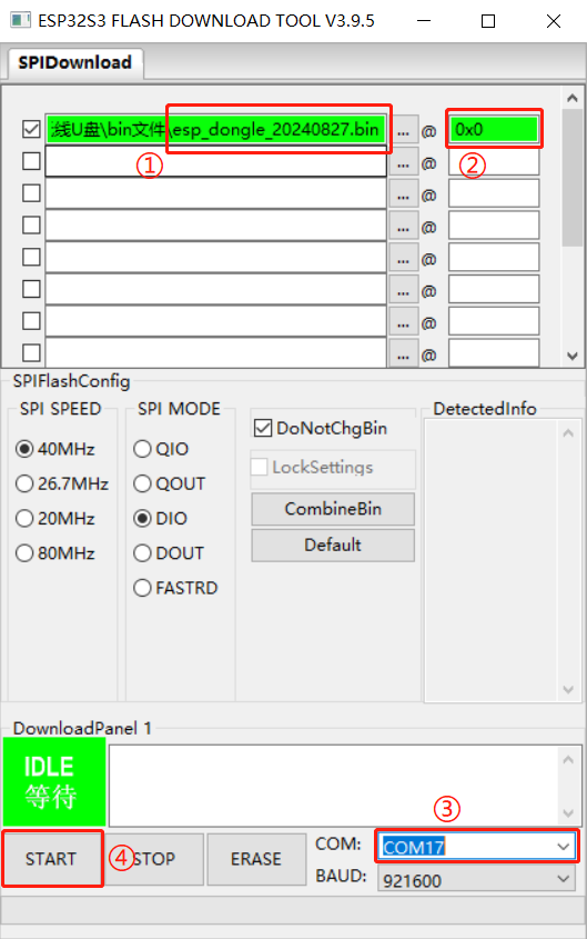

Programming Instructions:
Download the programming software: Espressif Systems official website - Support - Related Downloads - Tools - Flash Download Tool
. After downloading, extract the file and find flash_download_tool_3.9.7.exe. Double-click it. Then select ESP32-S3 and USB, and click OK.
4. Open the software and directly burn the esp_dongle_20240827.bin file from the attachment into address 0x0. The steps are as follows.

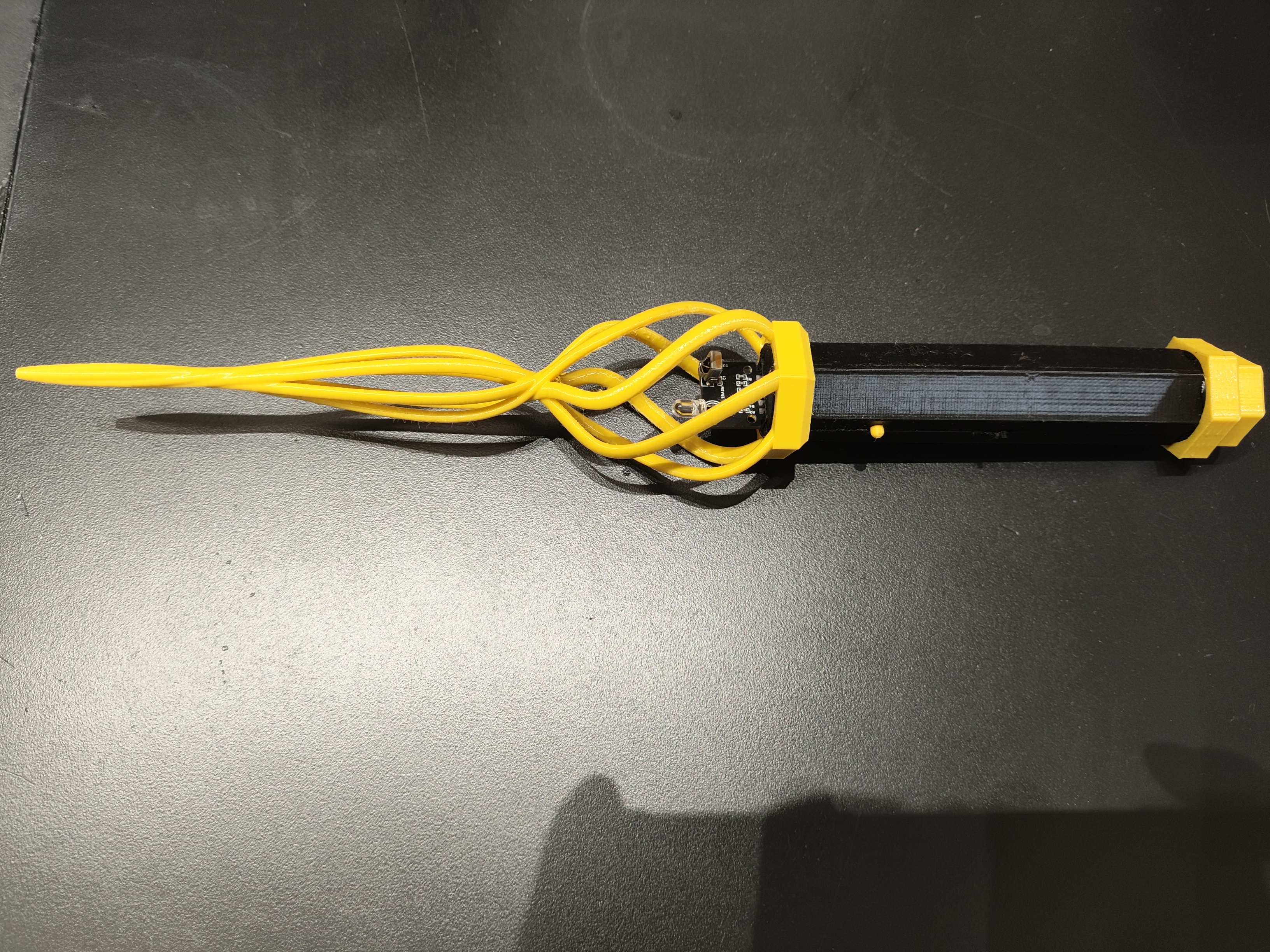

This project is the Cyberry Potter Electromagic Wand, which uses convolutional neural networks for action recognition and adopts a modular design with high scalability. You can use the files in this project to create a cybernetic wand. If you have sufficient skills, you can also modify the wand's spells (functions). The wand adopts a modular design, with different modules corresponding to different execution functions. You can create new modules and add new functions according to your needs. You can also modify the action of activating spells; you only need to recollect data and train the model.

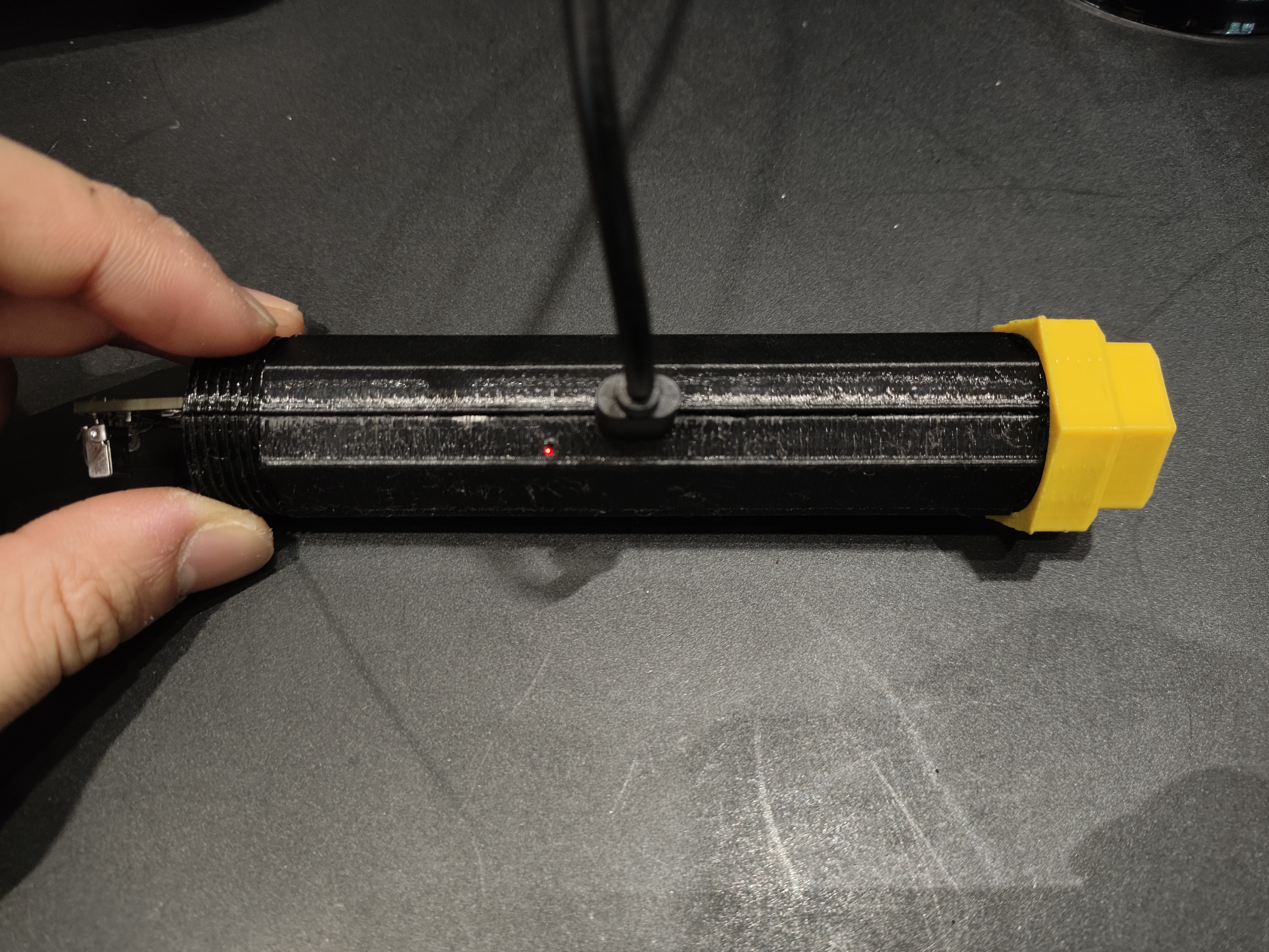

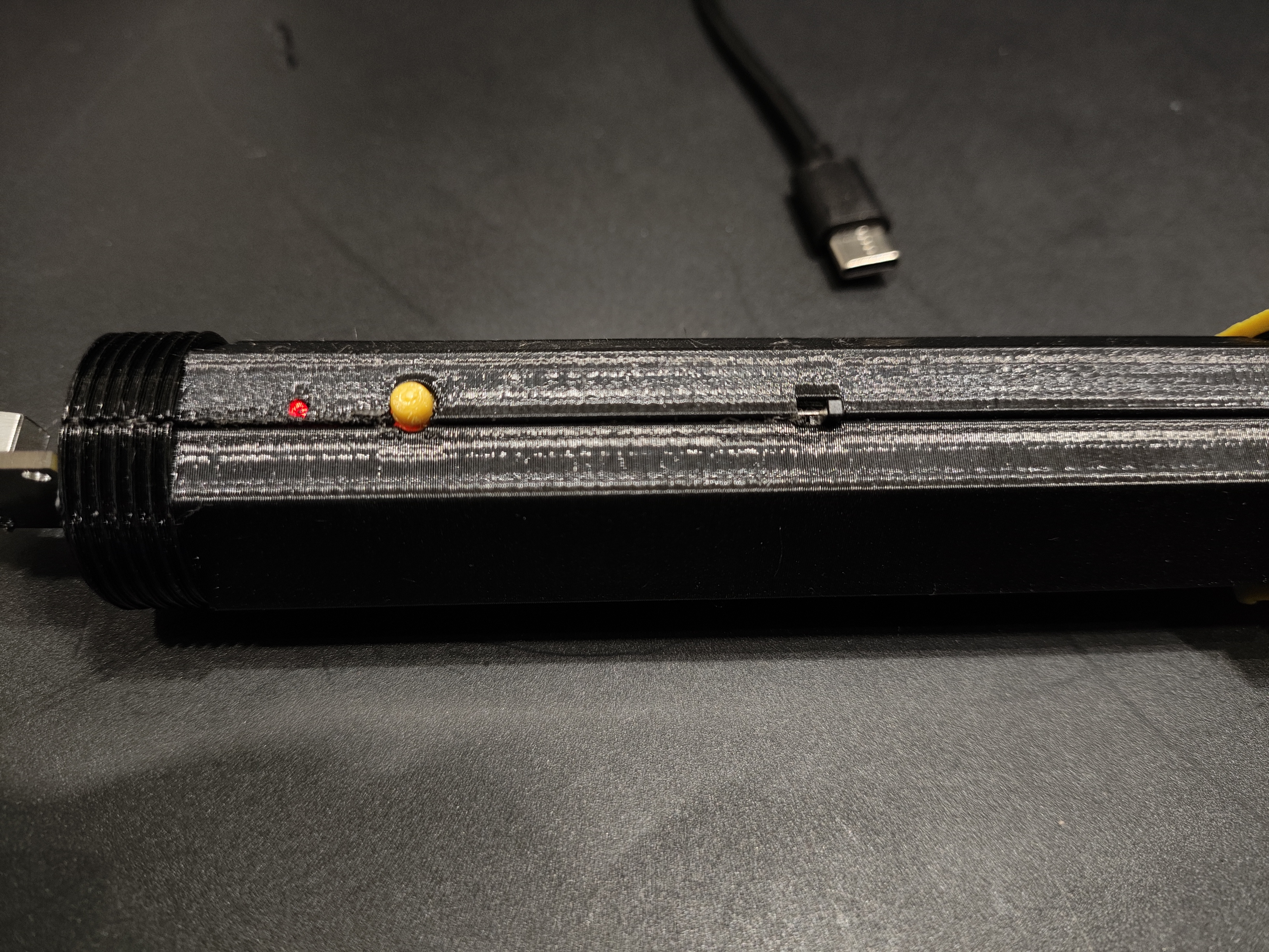

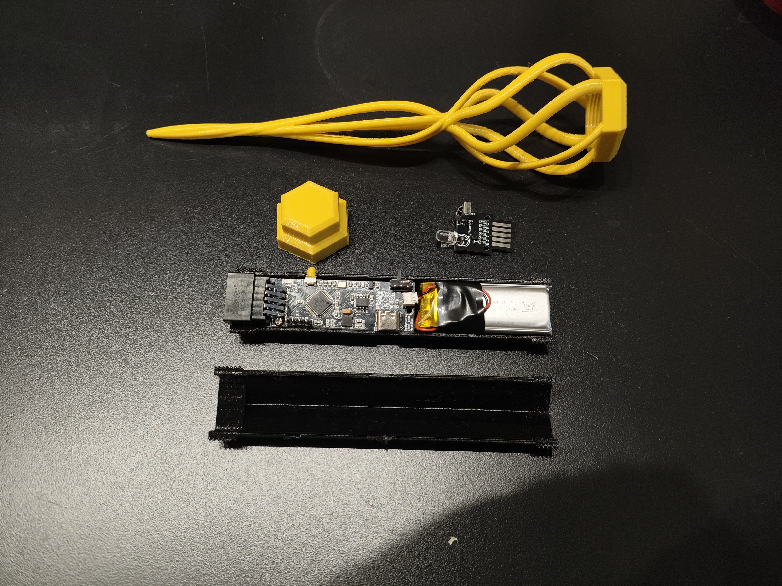

Physical Demonstration
Assembled Status
Disassembly Status
Module Insertion Direction: Front Face Down
The Type-C port can be used for charging and serial port debugging. The red light is on when charging, and the green light is on when fully charged
. From left to right: status indicator, interactive button, power switch
