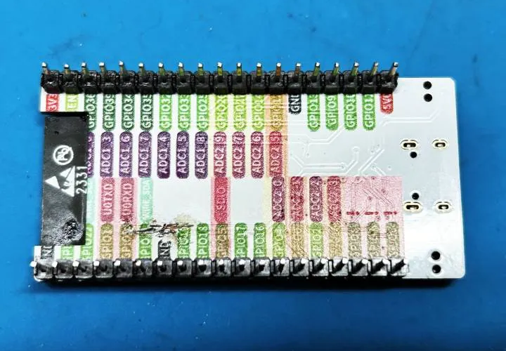

ESP32-DevKitC Core Development Board
This is an ESP32-Devkitc core development board using a Type-C interface. The CH340C supports automatic downloading, and the pin header width is 25.36mm.
Because this specification is hard to find online or is expensive, this project was created to make it easier for everyone to use this module.
To facilitate manual construction, components are placed on the top layer, and most surface-mount components are 0603 specification.
Finished product demonstration (verified).
There is a small issue here: RX and TX were reversed in the schematic design. The above diagram temporarily solves this with a jumper wire. The schematic has been updated. Please see the attached
verification video .
