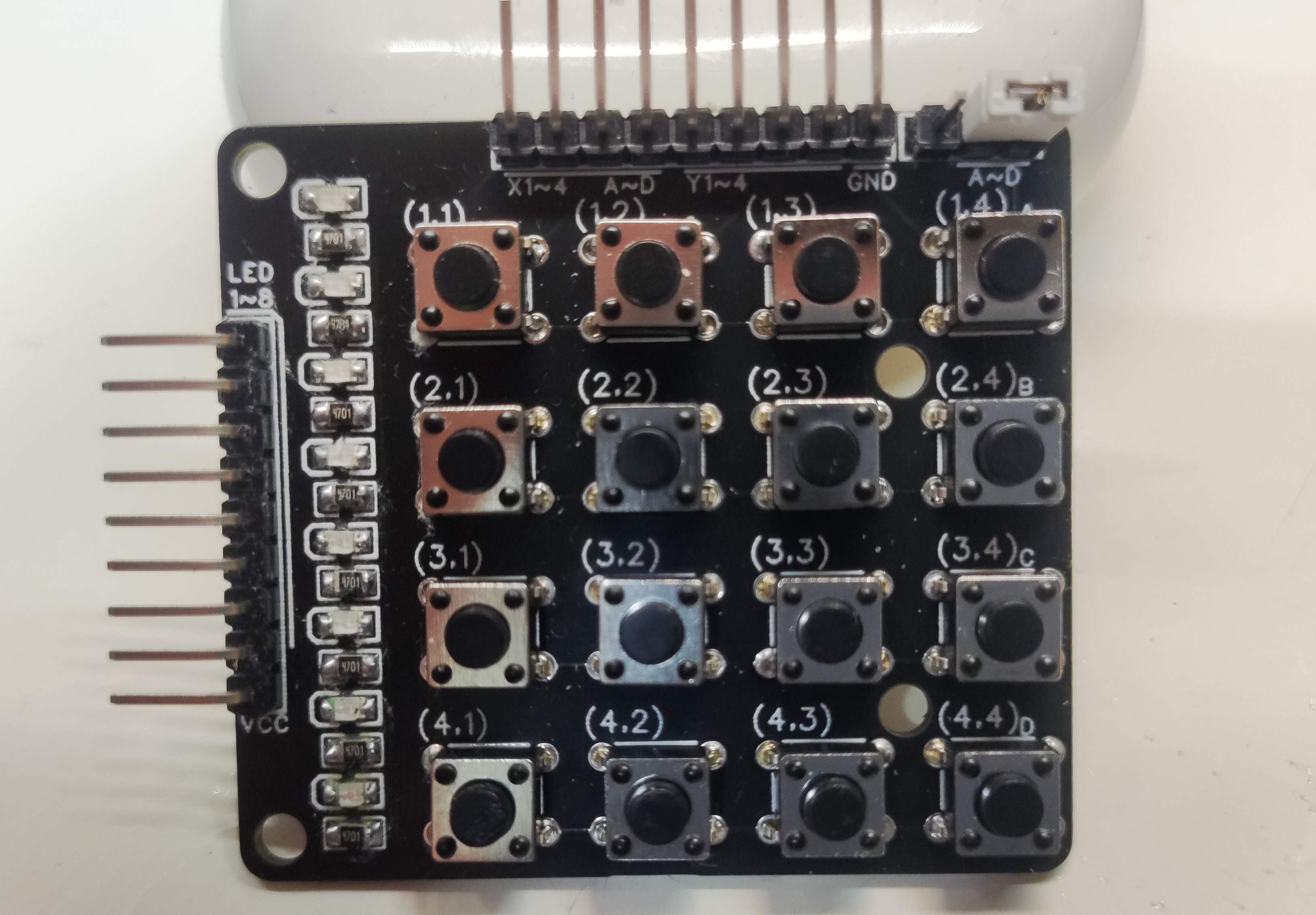

Matrix keyboard and 4-key independent keyboard module switchable via jumper
This 4x4 matrix keyboard module can also be switched to a 4-key independent keyboard via a jumper cap.
It also features 8 onboard LEDs driven by a low level.
In the matrix keyboard interface, X represents the row and Y represents the column, with corresponding keys represented by (X,Y) coordinates.

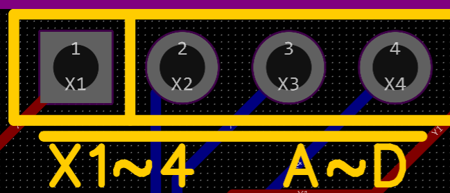

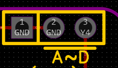

The image below shows the jumper position. Shorting pin 2.3 switches to an independent keyboard; keys A-D are in the fourth column and are marked on the key silkscreen.
![image.png] When using the independent keyboard, GND needs to be connected to the microcontroller. When a key is pressed, the corresponding A-D lines (as shown in the image, shared with X1-4 of the matrix keyboard) are low.
