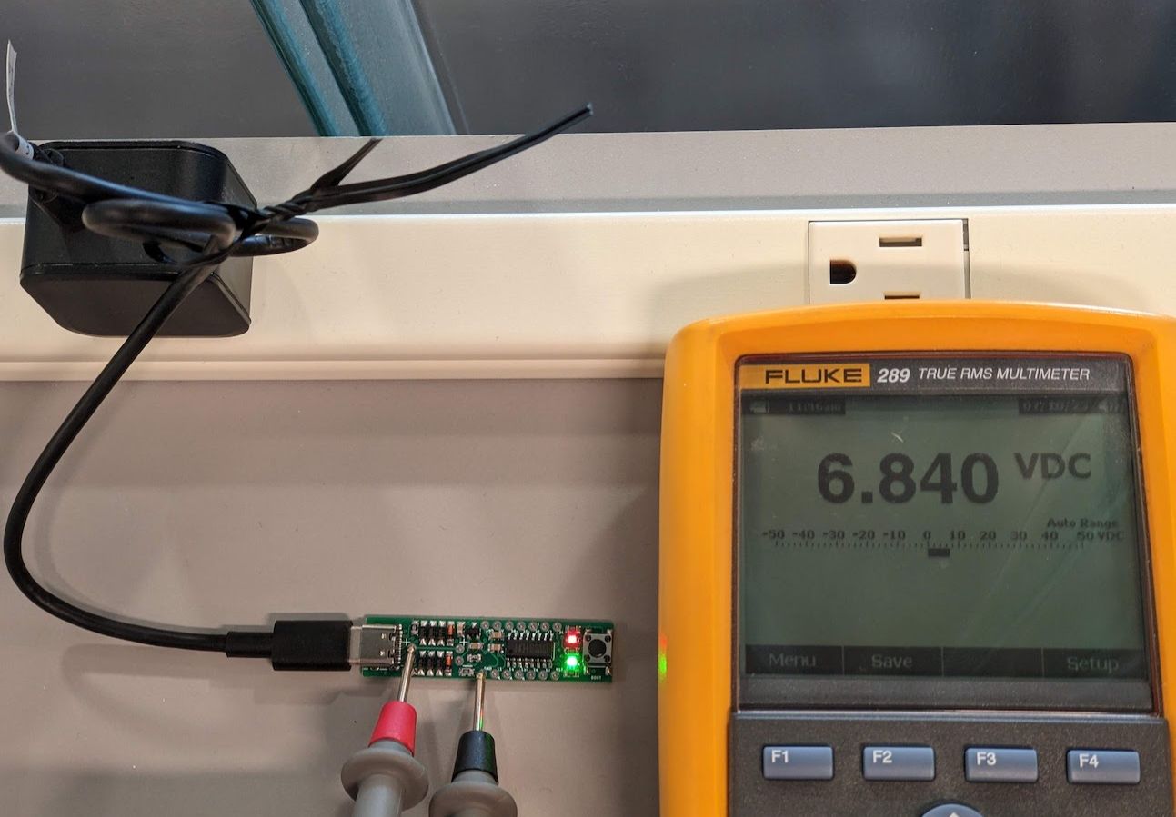

This project uses a general-purpose microcontroller (CH552) to receive and send USB PD signals via the CC line, without any peripherals. Only an analog comparator and a timer are used to receive signals. GPIOs with clamping diodes are used to send signals. The example code makes the CH552 act as a USB PD SINK controller and requests a programmable voltage from the PD/PPS charger.

参考设计图片
