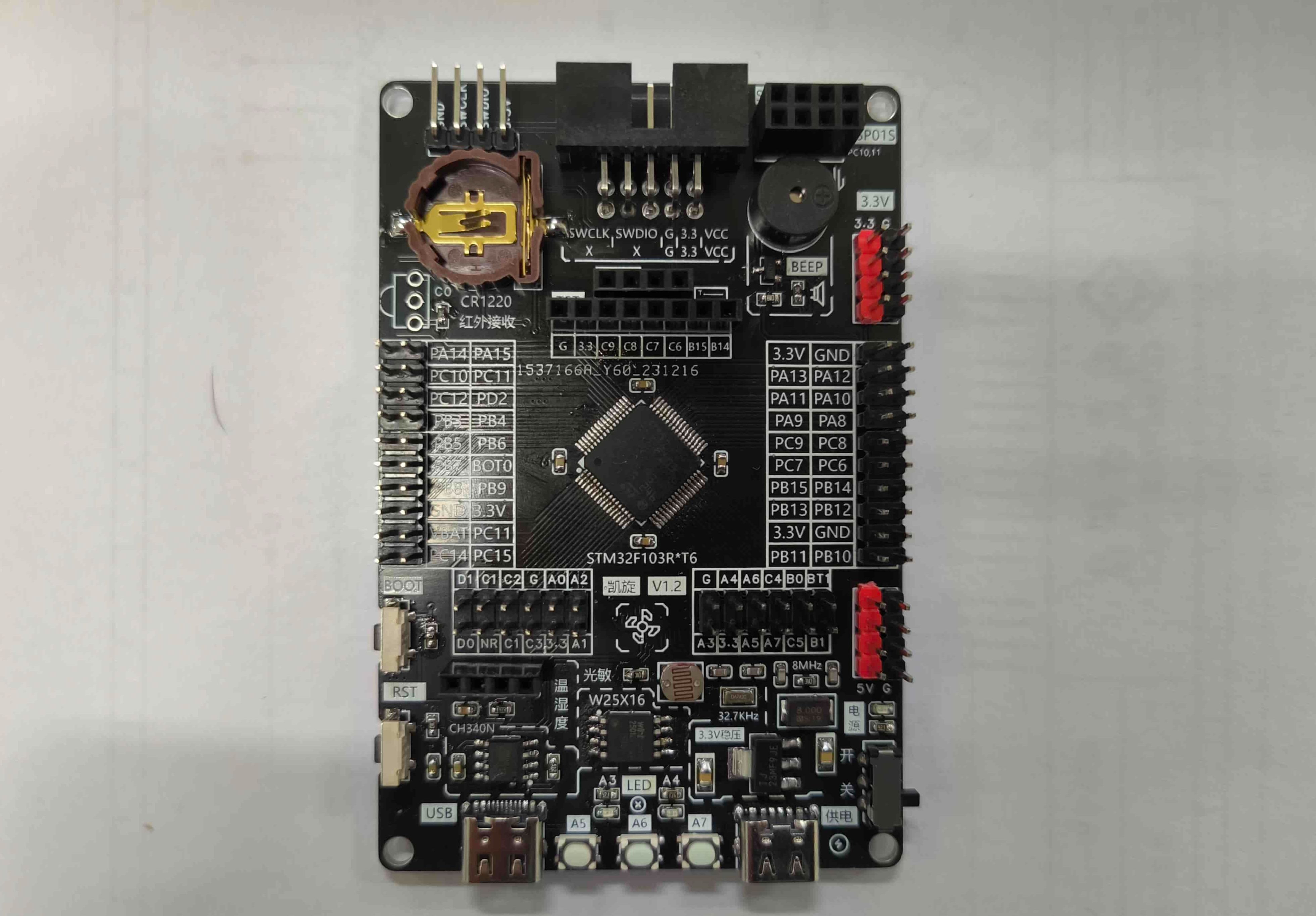

Preface:
  A while ago, I suddenly noticed that the price of common STM32 chips on Taobao had dropped significantly compared to last year, so I thought about building a small development board for the STM32F1. After comparing various options, I chose the RxT6 series. 64 pins is just the right amount; I initially chose the RET6. With 512KB of Flash and 64KB of RAM, it's more than enough for casual use, running FreeRTOS and U8G2 graphics. I named it "Triumph."
Features include:
all GPIO pins are exposed;
dedicated external power supply modules (3.3V4, 5V4);
commonly used onboard modules: buttons, LEDs, buzzer, W25X16, and photoresistor;
commonly used onboard module interfaces: OLED (4P), TFT (8P), ESP01S, and temperature and humidity module (4P).
For the commonly used ST-LINK connectors, a horn-shaped connector is used for direct connection to this development board, eliminating the need for individual wires at the download port.
The download mode can be switched after power-on via the side-mounted button, such as the serial download mode, which can be done via the onboard USB.
note here: the pinouts of the purchased ST-LINK chips may not be identical; I encountered this problem and it confused me. The PCB connection configuration is drawn according to the ST-LINK below.
Verification
is currently at V1.2, verifying that downloading works.
Previous modification: For
the 3D
model, the 10P horn-shaped connector couldn't be found with a bent one, so a physical one was used instead. The chip soldered to
the physical chip is an STM32F103RET6.
Download_OK.mp4
PDF_STM32F103RxT6 Development Board--Kaisheng.zip
Altium_STM32F103RxT6 Development Board - Triumph.zip
PADS_STM32F103RxT6 Development Board - Triumph.zip
BOM_STM32F103RxT6 Development Board--Triumph.xlsx

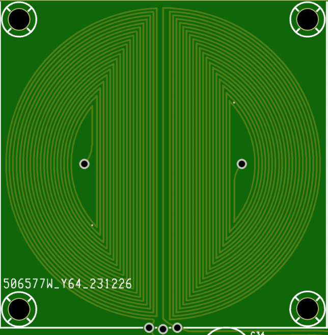

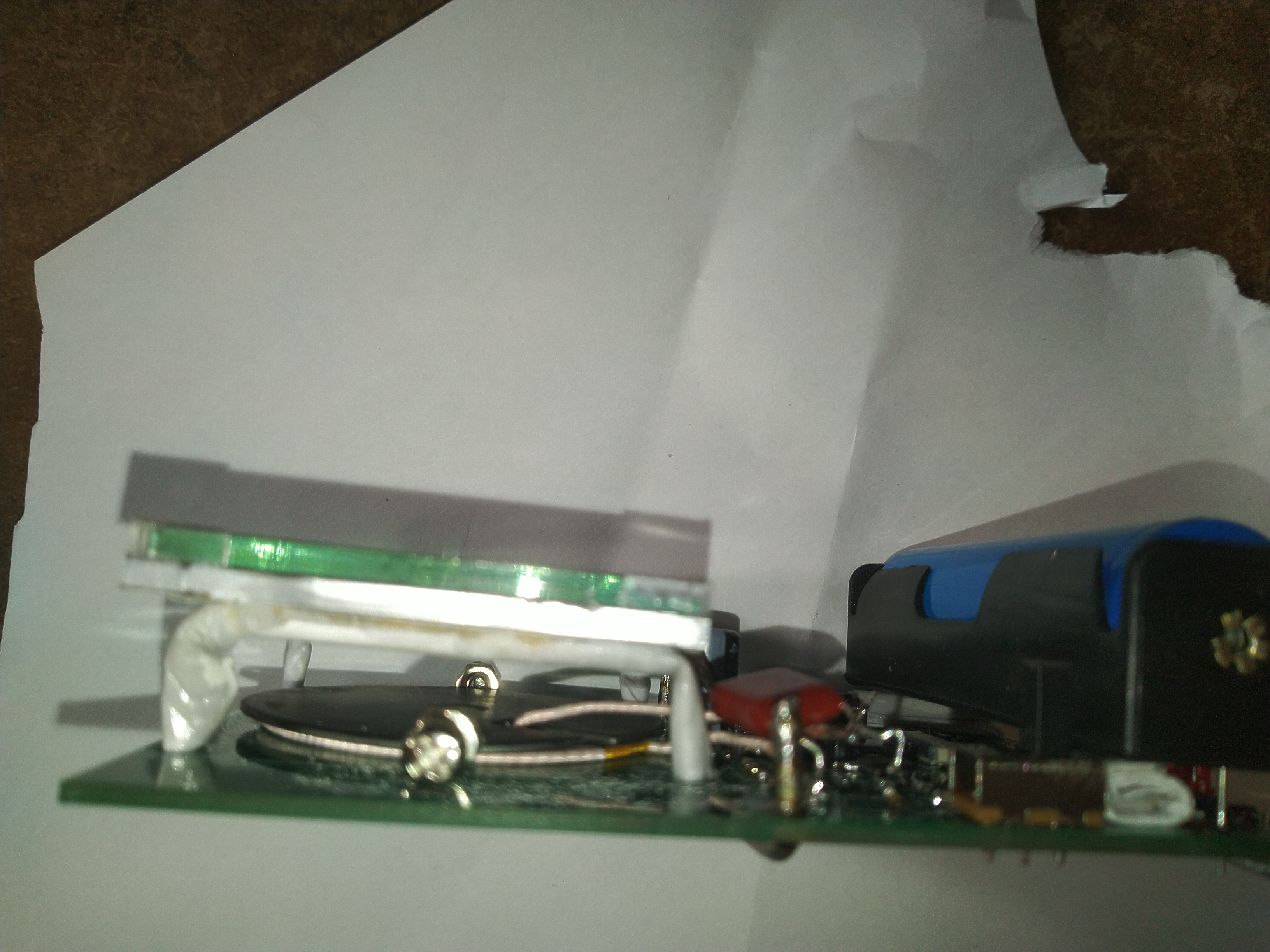

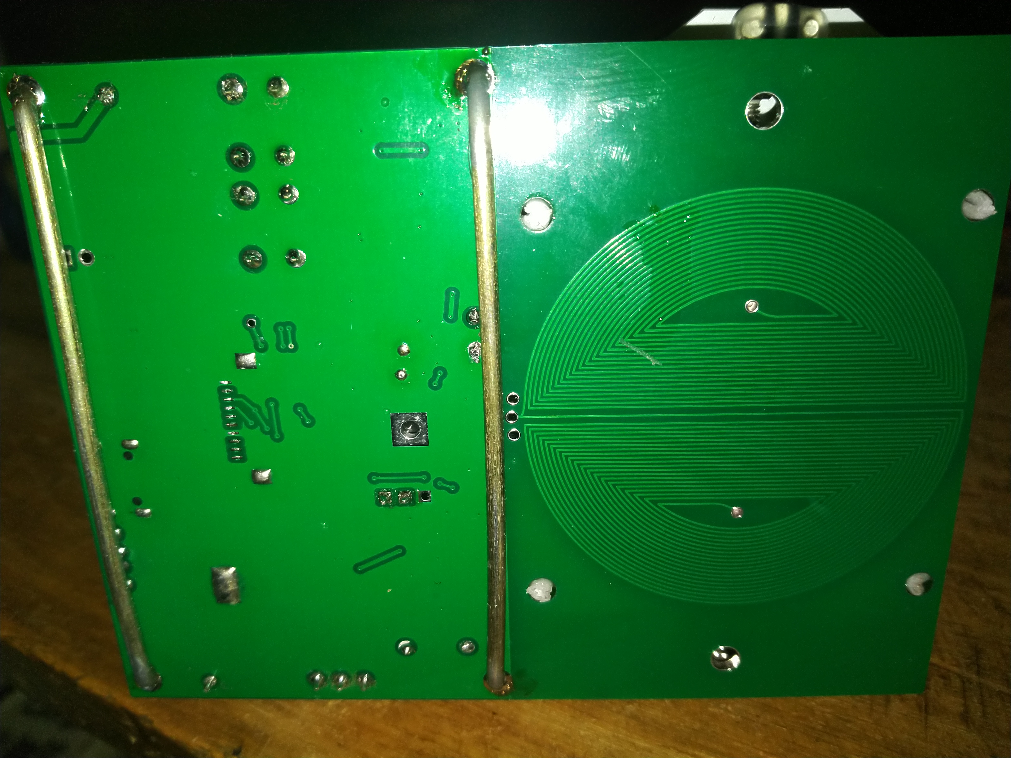

This simple wall detector was built using a CW32 microcontroller. It uses a 100kHz sine wave driven by a wireless charging coil for a mobile phone. Two semi-circular coils were drawn on the circuit board for differential input, enabling relatively accurate positioning. The maximum detection depth is 3cm with 4 square millimeter copper wire and 5cm for steel reinforcement. It is powered by a single lithium battery, resulting in low power consumption.
The zero point is the center of the indicator bar; crossing this point indicates the position of the wire.
Circuit principle:
A CW32F030C8T6 microcontroller is used as the main control
unit
. L1 is the wireless charging coil for the mobile phone, using a 400NF CBB capacitor specifically for wireless charging. Screws are needed on both sides of the wireless charging coil for balance and fixation.
L2 is the coil excitation circuit drawn on the PCB
. The microcontroller outputs a 100kHz PWM signal, which is filtered into a sine wave by an RC filter. One operational amplifier amplifies this in-phase signal, while the other inverts it. A 104 capacitor isolates and drives the wireless charging coil.
The signal amplification circuit uses a two-stage amplification. The first stage uses differential amplification. Sensitivity can be increased by adjusting R27 in the operational amplifier circuit before the ADC. Reducing the resistor can also improve sensitivity.
A single 18650 power supply is used.
The display uses a COG12864
program. The program principle is: a timer outputs one 100kHz PWM channel, the ADC sampling rate is 1MHz, 2000 points are collected, and DFT demodulation is performed. 1.S is the source code, 1.bin is the firmware, and the compiler is ARM-NONE-EABI.
Debugging method: After soldering the circuit, adjust the position of the wireless charging coil to minimize the LCD reading.
 The left button clears the display, and the right button restores the default settings. Press the right button first, then simultaneously press the left button to enter the speaker and progress bar sensitivity parameter settings. Press the right button to start setting, use both buttons to increase or decrease the reading, and press and hold both buttons simultaneously to save the settings. [
Image of the actual product ]

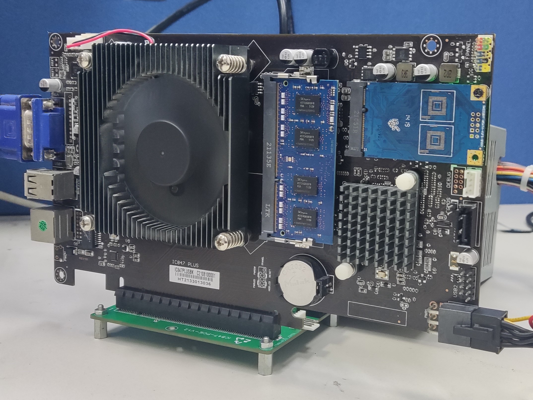

847 controller adapter board
The PCIe lanes used to bring out the 847 control board
are not supported by the gold finger power supply on my board, so the expansion board needs a separate power supply.
      I'm not a professional, and as a beginner in the mechanical industry, please be gentle with your criticism. The 847 I bought doesn't seem to support baseboard power supply, so the baseboard needs to be powered. So far, I haven't encountered any problems with the small network card I plugged into the 8111F.
