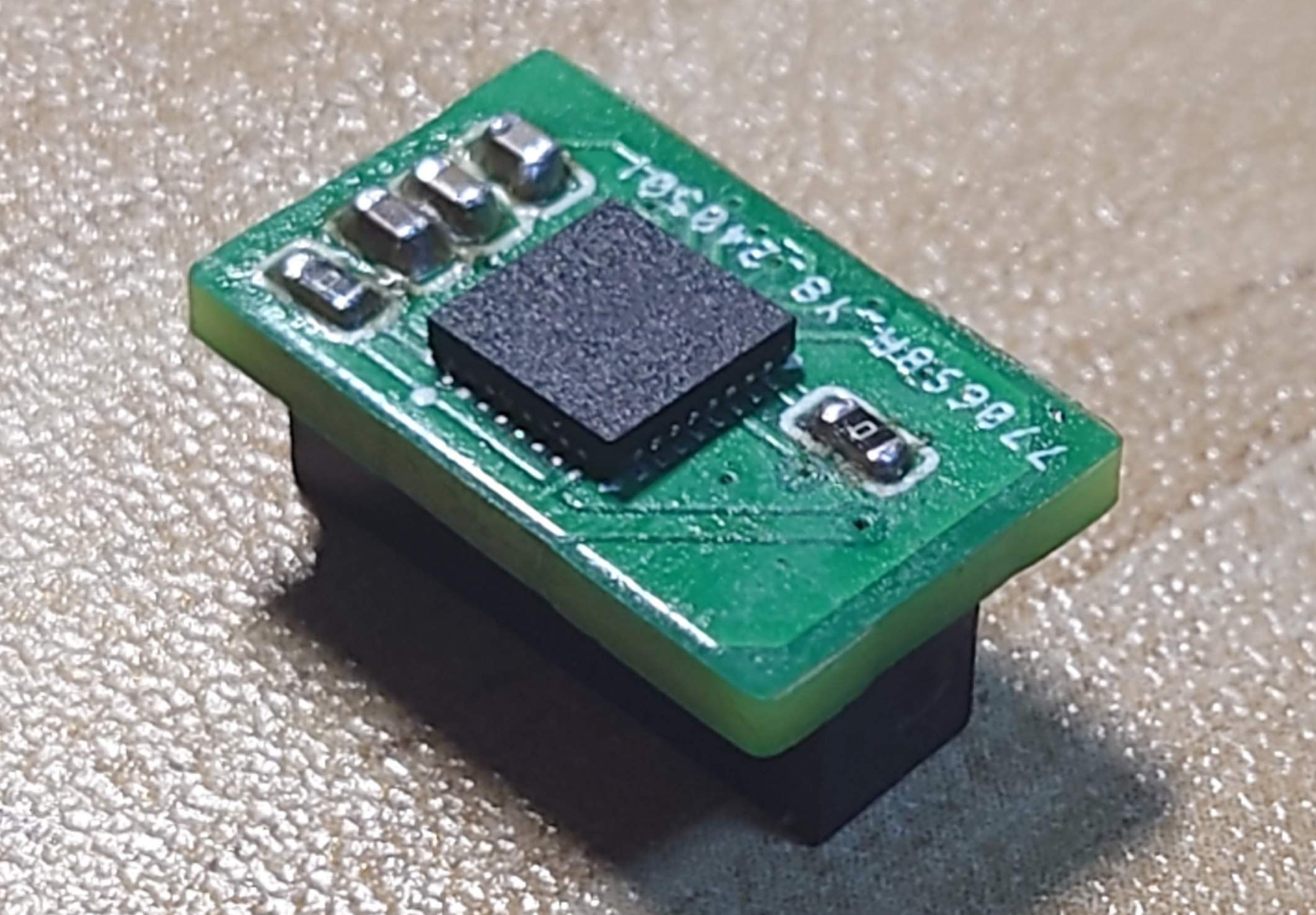

TPM_2.0_moudel
This module is for use with a 14-pin ASUS SPI TPM connector header. Please check the motherboard manual to confirm that the interface and the header header interface definition in the diagram below are consistent.
The size is 1.6cm x 1cm, and the height depends on the header header and the thickness of the board you purchase.
This module uses Infineon SLB 9670VQ2.0, QFN package. Discarded chips from Taobao cost 5 yuan each. The header
header has a 2mm spacing. For the 2*7-pin surface mount header header,
you will also need one 1uF and two 100nF 0603 package surface mount capacitors.
The top left and bottom right are two 0Ω 0603 package resistors, as specified in the chip datasheet. They can be connected together with a lump of solder.
I used an ASUS TUF GAMING B550M-PLUS motherboard, and it worked.
Note that if the chip model is different, please refer to the specific chip datasheet to check if it can be used on this board
. Regarding soldering, I connected the ground to the middle heatsink pad, and drilled four holes in the heatsink pad to connect to the 14-pin connector on the back. I'm unsure if it's a manufacturing issue or a design flaw on my part, but with QFN-packaged chips, the solder mask between the chip pin interface pads and the heatsink pads is easily burned off by the soldering iron, causing solder to flow onto the heatsink pads and preventing the chip pins from receiving solder. Therefore, I recommend using solder paste and a hot air gun to solder the chips, ideally achieving a successful solder joint on the first attempt to avoid solder mask detachment.
Regarding the 14-pin female header, if your purchased header doesn't have keyed connectors, please carefully insert it into the motherboard according to the motherboard manual. I am not responsible for any damage caused by incorrect insertion that results in chip burnout or even motherboard damage.

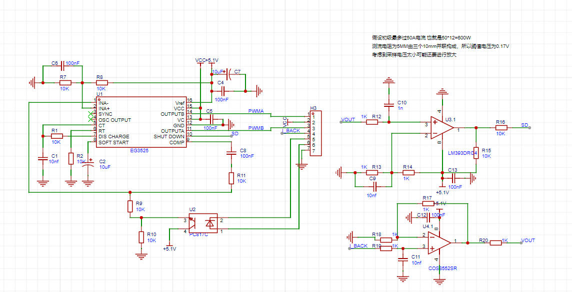

1. Principle of the Pre-amplifier SG3525 Driver Board The DC-DC driver chip used is SG3525. I will not go into details about the specifics of this chip. Its peripheral circuit can be built according to the typical application in the PDF. When the oscillation element Rt=15k and Ct=222,
the oscillation frequency is about 26.6KHz. I prefer to use a frequency of about 20KHz, which has low switching losses and low pressure on the rectifier tube, which is conducive to improving efficiency. However, the low frequency is not conducive to the miniaturization of devices, and
the high-voltage DC ripple is slightly larger, but this is not a major issue. The protection circuits are all conventional circuits built with comparators. Optical isolation is used, and the input and output of the front stage are electrically isolated. This design is also for safety.
I_BACK is an overcurrent protection circuit. The SG3525 has a built-in dead-time control and soft-start protection.

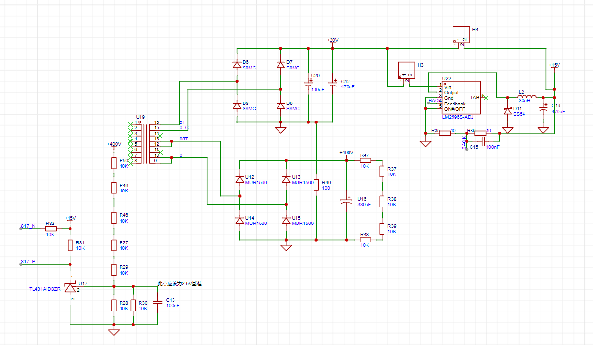

Below is the schematic diagram of the DC-DC drive circuit.

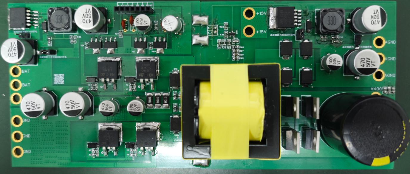

2. Schematic diagram of the front stage DC-DC power main board The DC-DC power main board uses a conventional push-pull design. Each of the four power transistors has its own gate drive resistor, and each of the four power transistors is driven by a totem. The secondary high-voltage winding of the transformer is rectified and filtered to obtain a DC high voltage. The auxiliary winding is rectified, filtered, and regulated to supply power to the 431 used for feedback in the subsequent stage.
As can be seen from the schematic diagram, a voltage conversion circuit is used to power the front stage drive board. When the input is 12V, in order to ensure that the switching transistors work normally when the power supply voltage is high, when the input is 24V, an LM2596 is used to reduce it to 15V. Regarding the selection of power transistors for the preamplifier driver transformer, the recommended voltage rating is 2.4 times the highest input voltage.
For example, for a 12V machine, the maximum input voltage is 14.5V, so 14.5V * 2.4 = 34.8V. Therefore, a 35V MOSFET can be selected for a 12V machine. However, this selection is conditional: the transformer winding process cannot be too poor, and the leakage inductance and distributed parameters cannot be too high; otherwise, the MOSFET will be damaged by the voltage spikes generated by the transformer.
If the transformer winding is good, a lower voltage transistor can be selected. Generally, for the same current, a higher voltage transistor has a larger input capacitance and higher internal resistance. But if the transformer winding is poor, choose a higher voltage MOSFET. The primary stage uses two pairs of STB15810s from STMicroelectronics, with a VDSS of 100V and an IDS of 110A, which is perfectly adequate.
The transistors I used are not the most suitable, but they are ones I have used and have had no problems. Below is the schematic diagram of the DC-DC boost converter preamplifier.
3. The DC-DC power mainboard schematic
is quite simple. You only need to pay attention to whether the diode's operating frequency meets the requirements, whether the filter capacitor's withstand voltage meets the requirements, and the selection of the 431 detection voltage. These will not be elaborated upon here.
Below is the schematic of the DC-DC boost board's power stage.
                                                       3. Regarding transformer selection and design : For
12V input, the primary winding is 2T+2T, with 14 strands of 1.0 enameled wire wound in parallel on one side, achieving a cross-sectional area of ​​11*2=22 square millimeters, which is sufficient for 100A current. The secondary winding is 60T wound with one strand of 1.0 enameled wire, and the auxiliary winding is 4T wound with 0.8 enameled wire. The transformer uses a sandwich winding method, i.e., secondary, primary, secondary, auxiliary. For 24V input, use an EE55 transformer, with a primary winding of 4T+4T, with 8 strands of 1.0 wire wound in parallel on one side. The secondary winding is 60T wound with one strand of 1.0 enameled wire, and the auxiliary winding is 4T wound with 0.8 enameled wire. For a 36V input, use an EE55 transformer. The primary winding is 6T+6T, with 8 strands of 1.0mm² wire wound in parallel on one side. The secondary winding is 60T wound with 2 strands of 0.9mm² enameled wire, and the auxiliary winding is 4T wound with 0.8mm² enameled wire. For a 48V input, use an EE55 transformer. The primary winding is 8T+8T, with 8 strands of 1.0mm² wire wound in parallel on one side. The secondary winding is 60T wound with 2 strands of 1.0mm² enameled wire, and the auxiliary winding is 4T wound with 0.8mm² enameled wire.
I don't have the winding equipment or tools; I bought a ready-made transformer from Taobao. If anyone wants one, please contact me for the link.
My transformer is the EC42-15; the parameters are provided below.

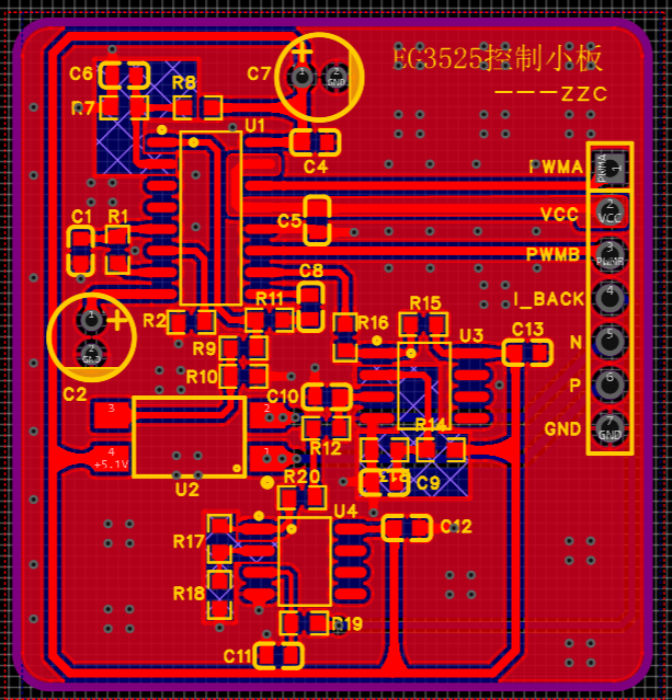

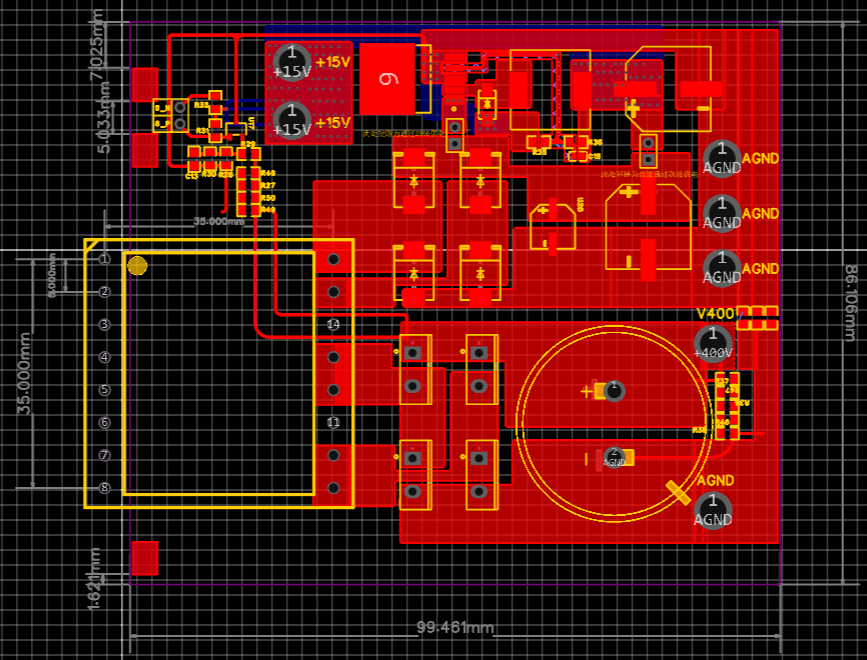

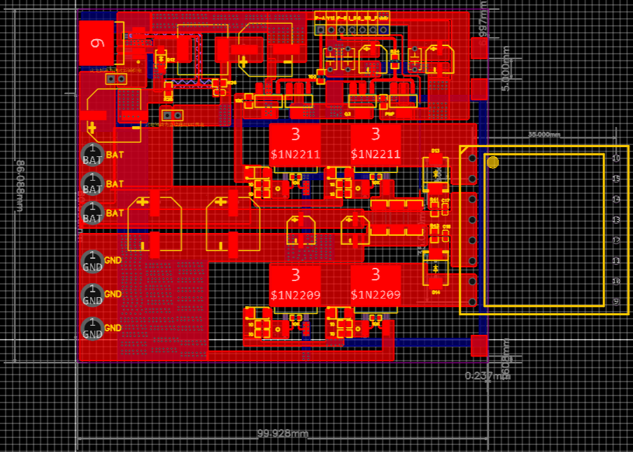

                                                       4. PCB Design:
1. When designing the SG3525 driver board PCB
, pay attention to the feedback resistor and place the filter capacitors nearby. The op-amp feedback
section can be designed as a restricted area to avoid oscillation. Finally, ensure the silkscreen is neatly arranged.
The SG3525 driver board PCB diagram is attached below.
3. For the preamplifier DC-DC power mainboard PCB
, pay attention to the main current path. The power path should be clean and unobstructed. Use large areas of copper on the main path. When two main return paths are connected, place more vias. Since LCSC supports a free board area of ​​10*10, we chose to board two boards here for free panelization, haha.
3. For the power amplifier DC-DC power mainboard PCB,
the PCB design concept is the same as the preamplifier. Pay attention to the main current path. The power path should be clean and unobstructed. Use large areas of copper on the main path. When two main return paths are connected, place more vias.

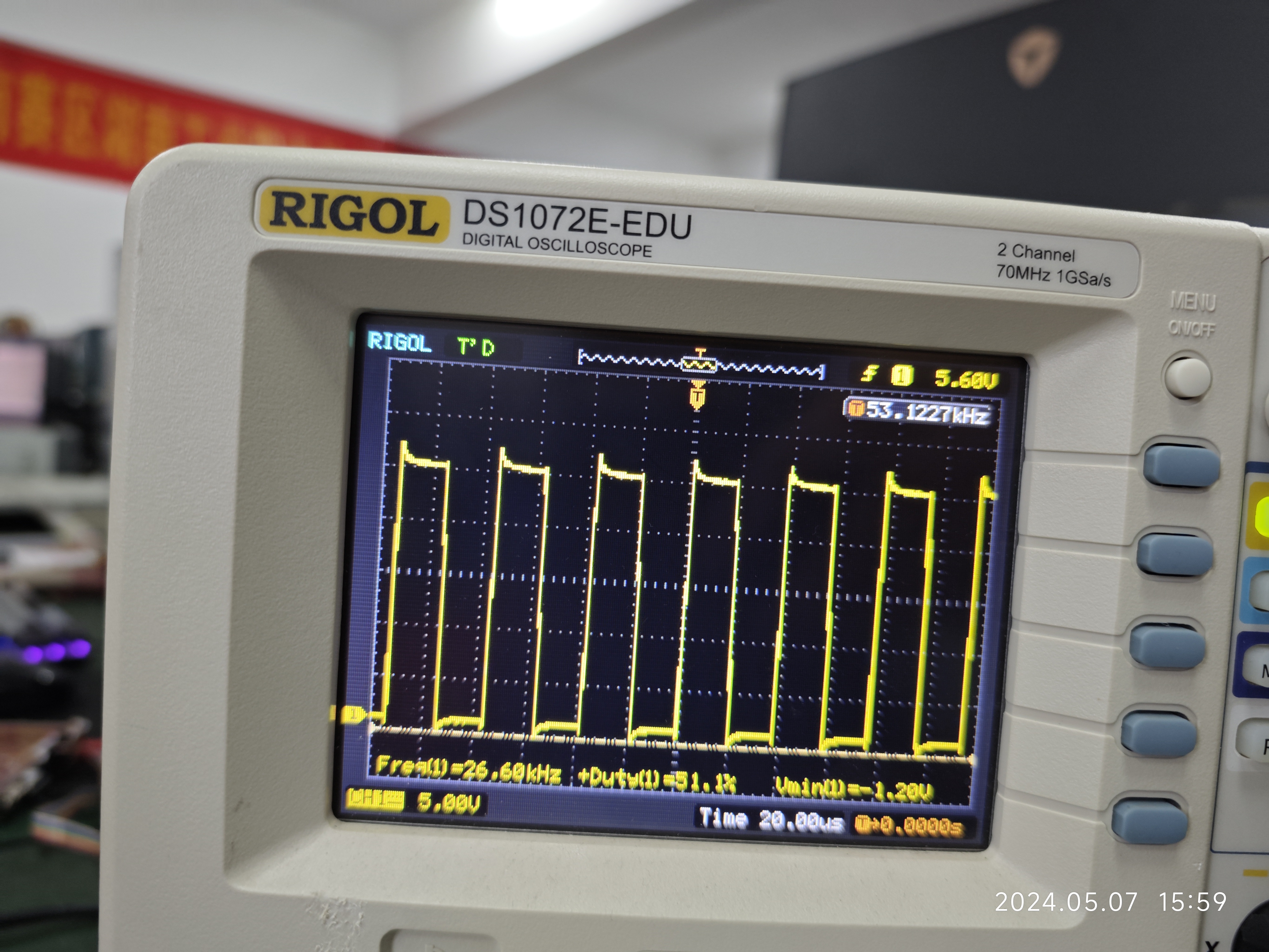

This is the gate (G) waveform of the MOSFET. This isn't how it appears on the PCB; it's the waveform emitted by the driver board, and it's not very clear. I think it can be corrected using a digital chip or comparator.
This is the source (S) waveform of the MOSFET.
The input voltage under no-load
conditions
, the output voltage of the main winding, and the output voltage of the auxiliary winding are shown here. This is the output voltage of the LM2596; the output voltage of the auxiliary winding is 19V.

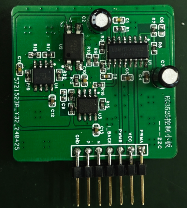

Finally, here are some PCB images of
boost converter,
                                                               along with a working video.

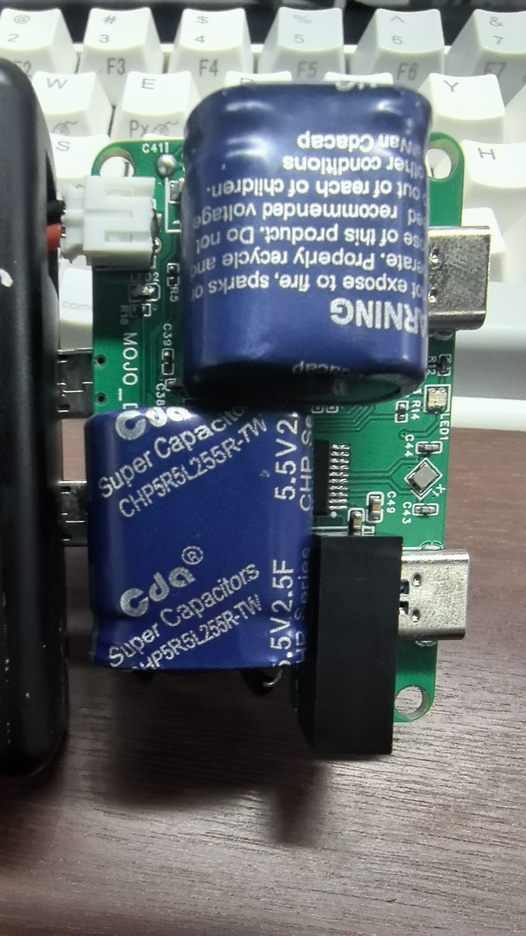

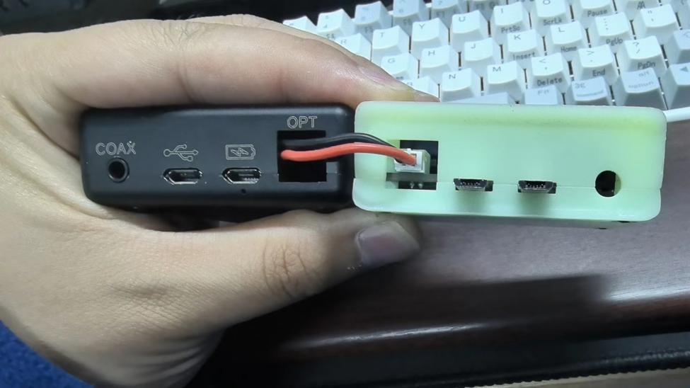

Connect the MOJO to PD power and discard the battery. Add USB isolation and power isolation.
  I've been dissatisfied with the battery life and charging speed of the MOJO since I got it. I modified the DC power supply. Later, I saw a solution posted by UP: 啊猫啊狗晒太阳 on Bilibili (video address: https://b23.tv/6zgnzuz), which inspired me. I added USB isolation, power isolation, and PD decoy to the original solution, changed the TYPE-C interface, and used an AT32 MCU based on what I had.
   So far, it's working fine. However, adding USB isolation doesn't completely solve the USB interference problem, which is probably an issue with the MOJO itself. At least the interference from the input source is gone now. Another issue is that the MOJO automatically powers on when the capacitor is charging after powering on. If the data USB cable is plugged in at this time, it will power off because the MOJO requires a large instantaneous current when powering on and connecting the USB driver, and the capacitor cannot provide enough current when it is not fully charged. Therefore, it is recommended to wait for the capacitor to fully charge before plugging in the data USB cable. (There is a solution: add a switch to the capacitor output terminal.) My MOJO's fiber optic port was removed because I previously modified the DC power supply, and it needs to be removed again for this modification.
  Soldering is generally not difficult; the main challenge is raising the microUSB connector to be level with the PCB. Also, be careful with the supercapacitor package; this package is only for display purposes, and you need to bend the leads when soldering the supercapacitor.

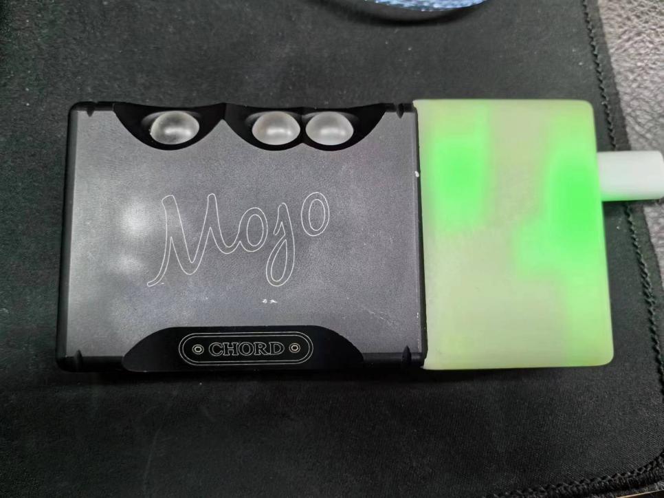

The casing is just a rough sketch; no holes are cut for the LEDs.
Main lighting effects:
LED1:
Red: Power-on input voltage error
; Yellow: Charging;
Green: Charging complete ; Yellow
-Blue: Input voltage less than 8V ; Red -Blue: Input
voltage greater than 20.5V ; Red- Green-Blue: Output voltage greater than 8.4V. LED2: Green: CH224K reaches set voltage.
