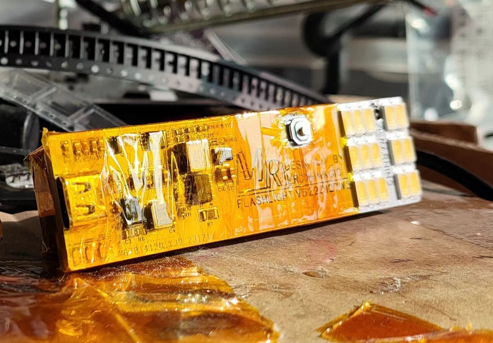

7.5W Simple High-Brightness Flashlight
IP5306 Overview:
The IP5306 is a multi-functional power management SoC integrating a boost converter, lithium battery charging management, and battery level indicator, providing a complete power solution for power banks. The IP5306's high integration and rich functionality require very few external components, effectively reducing the overall solution size and BOM cost. The IP5306 uses only one inductor to achieve both buck and boost functions, supporting low-cost inductors and capacitors. The IP5306's synchronous boost system provides a maximum output current of 2.4A with a conversion efficiency of up to 92%. Under no-load conditions, it automatically enters sleep mode, reducing the quiescent current to 100uA. The IP5306 employs switching charging technology, providing a maximum current of 2.1A with a charging efficiency of up to 91%. Built-in IC temperature and input voltage intelligently adjust the charging current. The IP5306 supports 1, 2, 3, or 4 LEDs for battery level display.
LGS63030 Overview:
The LGS63030 is a boost DC-DC LED driver chip with an integrated power switch and a wide input voltage range of 3V to 60V. It integrates soft-start, minimizing the need for external surge suppression components, making it ideal for driving LEDs with a wide input power range. The output current can be adjusted via an external resistor. The LGS6303X features an integrated 350mΩ power switch, providing at least 1.5A of input peak current capability with excellent load and line transient response. It features a SKIP control mode, combining low quiescent current with a high switching frequency for high efficiency over a wide load current range.
Additional features include: soft-start, adjustable output overvoltage protection, thermal shutdown, UVLO undervoltage lockout, and cycle-by-cycle peak current limiting protection. The LGS63030 allows for high-precision adjustment of the output current by selecting different values ​​of the sampling resistor RSence.
To enable this item
, click SW1; double-click SW1 to disable it.
