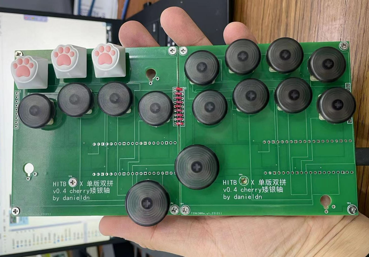

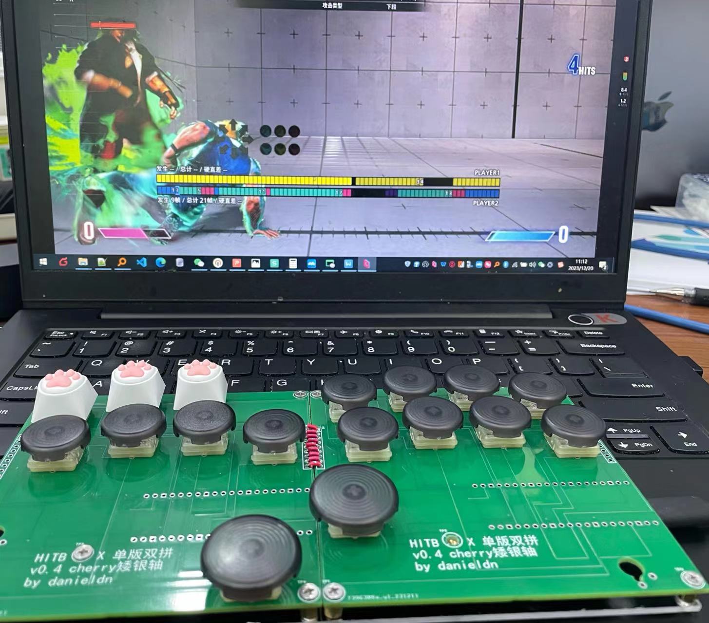

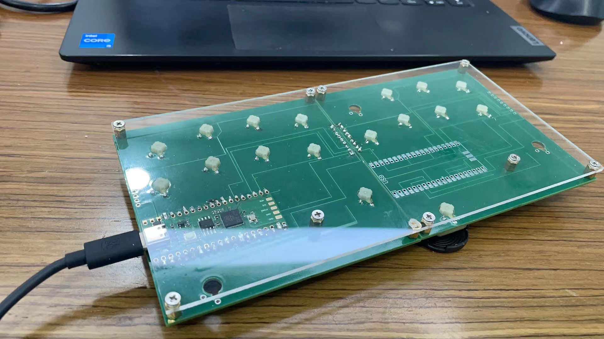

HITBOX single-board double-panel construction allows you to build a complete HITBOX set from a single 10*10cm board. Based on Pico.
Drill holes in the acrylic sheet yourself (M3 holes). For convenience, default pins
are used.
Accessories:
Keycaps ( 24mm*12 round keycaps, 30mm*2 round keycaps, 3 function keycaps) approx . 50 RMB ; Acrylic board (20cm*10cm) 2 RMB; Switches ( 17 Cherry low-profile silver switches) approx. 50 RMB ; Screws (M3-4mm screws , M3-5mm copper standoffs, several) less than 10 RMB ; Chip (RP2040) 10 RMB; USB-C cable ( self- provided) .
