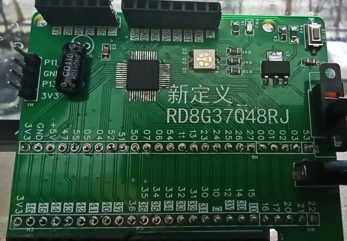

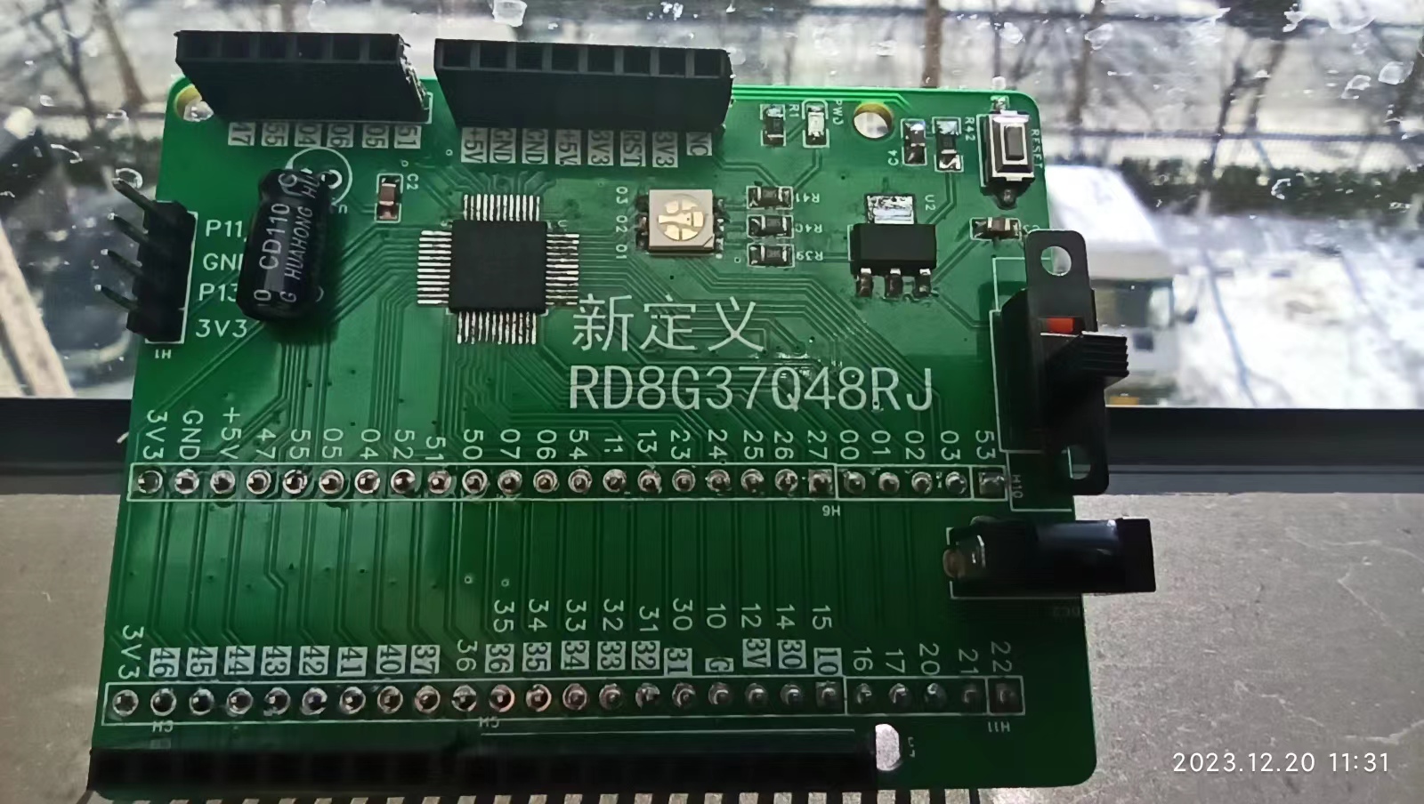

Newly defined RD8G37Q48RJ-QFN48 development board

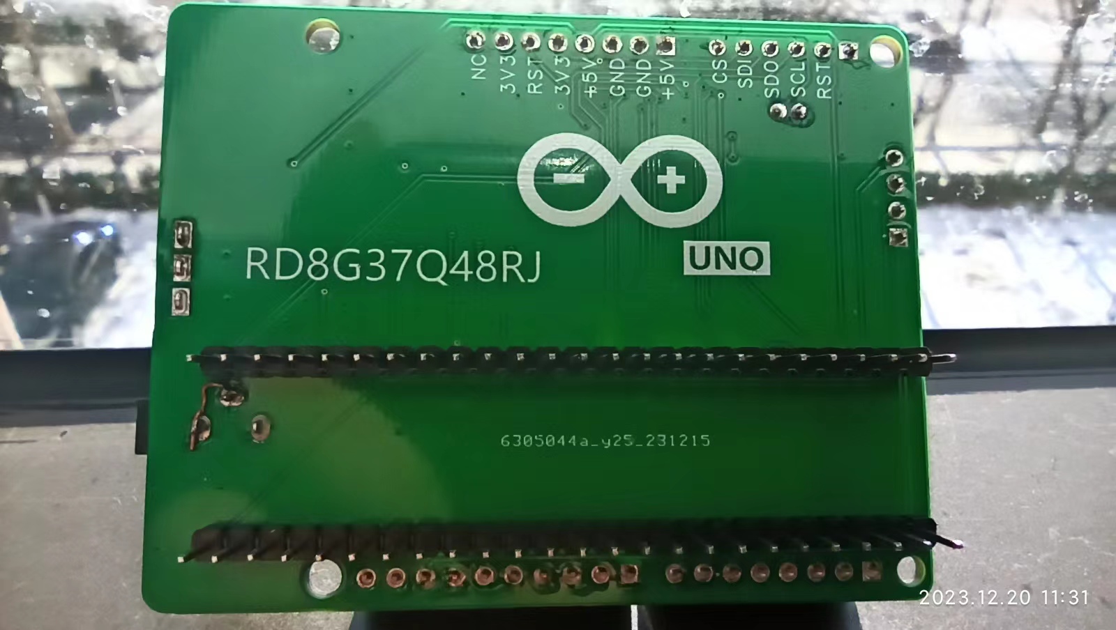

1. Can connect to Arduino expansion boards
. 2. Can connect to CW32 baseboards
. 3. The pin length of the RD8G37Q48RJ package has been changed to 3mm for easier soldering; 2mm would have been sufficient.
4. To utilize available components, discrete electrolytic capacitors were used, and the switch package was also modified.
5. The board design is based on Arduino, but development is unrelated to Arduino.

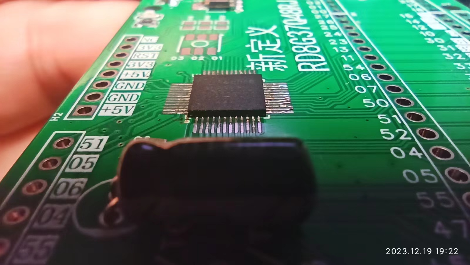

6. The QFN48 package on the experimental board was soldered using a pointed soldering iron, not a hot air gun or a hot plate. Anything is possible if you dare to imagine it.
7. The pinout is somewhat disorganized, mainly to adapt to the available screen and meet the hardware SPI pin layout requirements.
