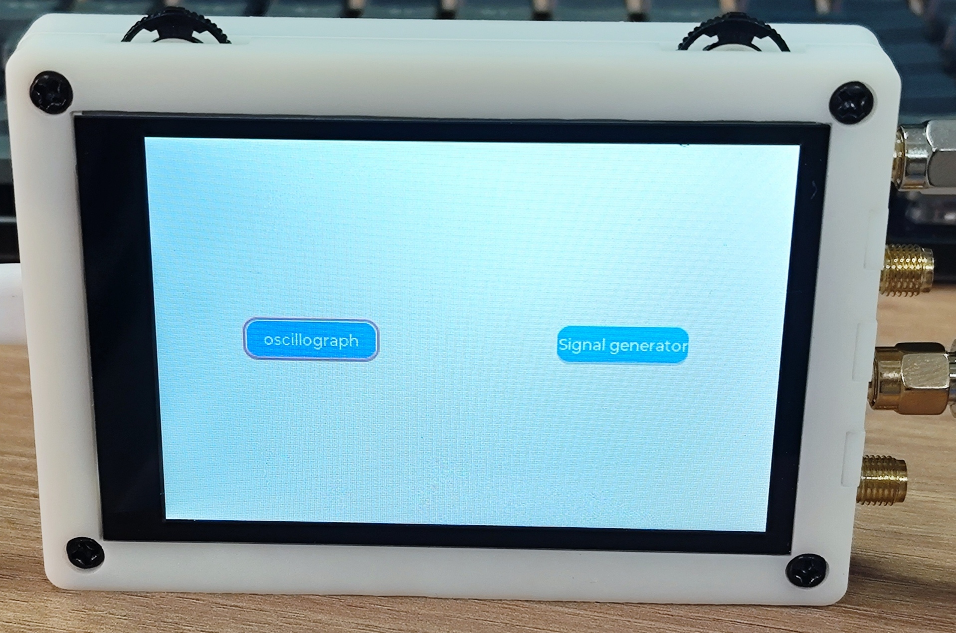

Figure 5.1 Main Interface

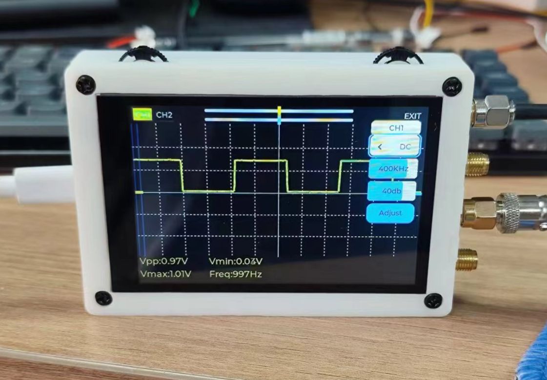

As shown in Figure 5.1 above, this is the first interface after powering on. The interface is relatively simple, with one button on each side. No icons are used to avoid copyright infringement. The left button enters the oscilloscope interface, and the right button is the signal generator interface. Control is achieved by toggling the three-way switch in the upper left corner.

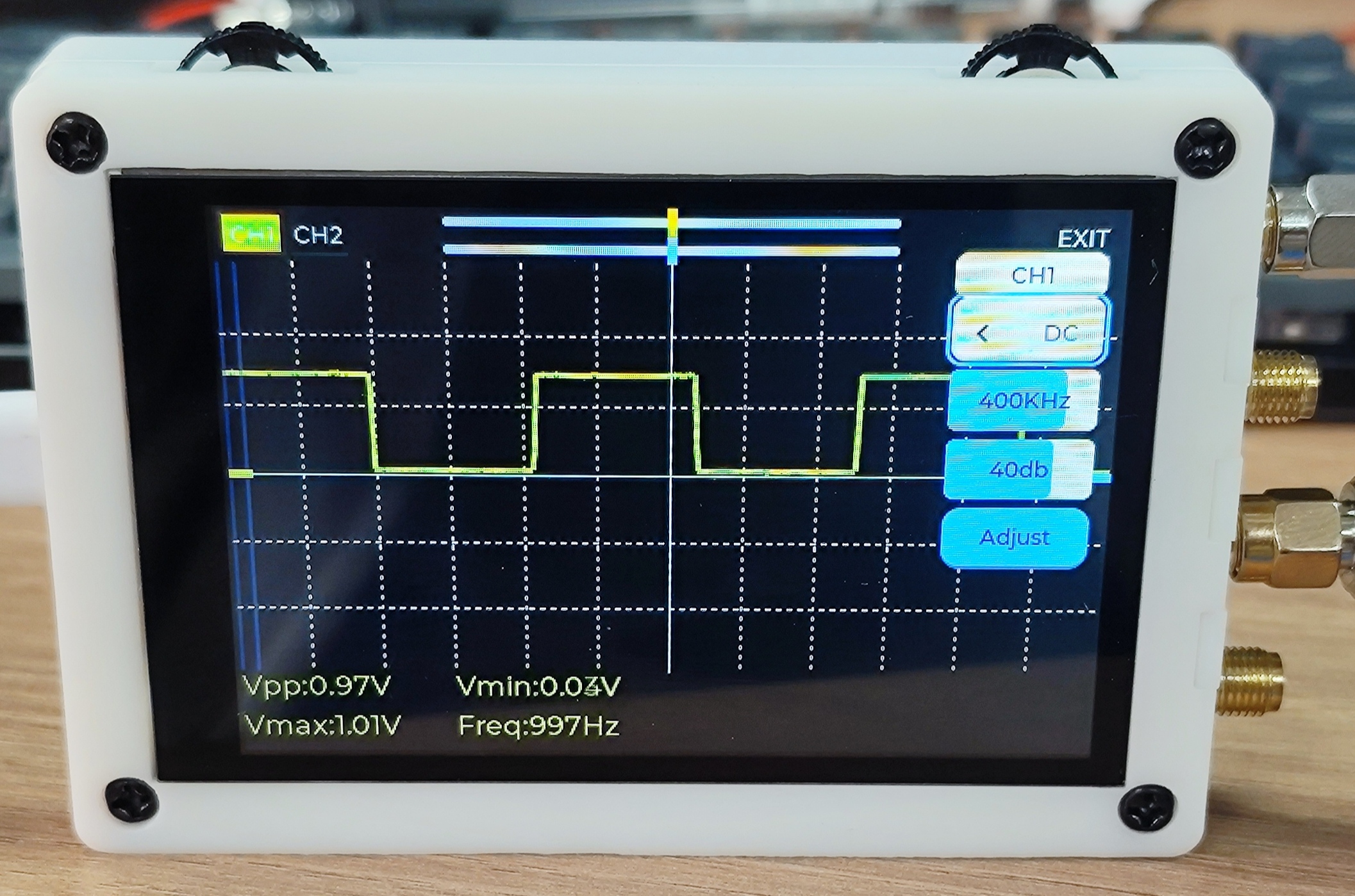

Figure 5.2 Oscilloscope Interface
        Press the left button in Figure 5.1 to enter the oscilloscope function. As shown in Figure 5.2, the oscilloscope interface is displayed. Toggling the three-way switch in the upper left corner allows you to focus on the CH1 button, CH2 button, yellow slider, blue slider, and EXTI button in sequence. A short press of the CH1 button turns channel 1 on or off, and the same applies to CH2. When focused on the slider, a short press enters edit mode. Toggling the three-way switch in the upper left corner controls the left and right offset of the waveform. A short press of EXTI exits the oscilloscope interface and returns to the main interface. Press and hold the CH1 button. A settings interface will pop up from the left. The top shows which channel the current setting corresponds to. Flip the three-way switch in the upper right corner to focus on the coupling method, sampling rate, preamplifier gain, and calibration. When the settings interface is not displayed, flipping the three-way switch in the upper right corner allows you to select the vertical offset of two channel waveforms. The bottom displays the peak-to-peak value, maximum value, minimum value, and frequency parameters of the waveform. Here, we'll focus on why calibration is necessary. The circuit will boost the acquired waveform by 1.65V. Due to resistor errors, this will cause some offset, so calibration is required. When the oscilloscope probe is shorted, if the line displayed on the screen is not centered (provided the vertical offset is adjusted to the center), focus on the Adjust button and then press and hold to start calibration. After calibration, the parameters will be saved to the AT24C02 and will be automatically read and applied upon the next power-on.

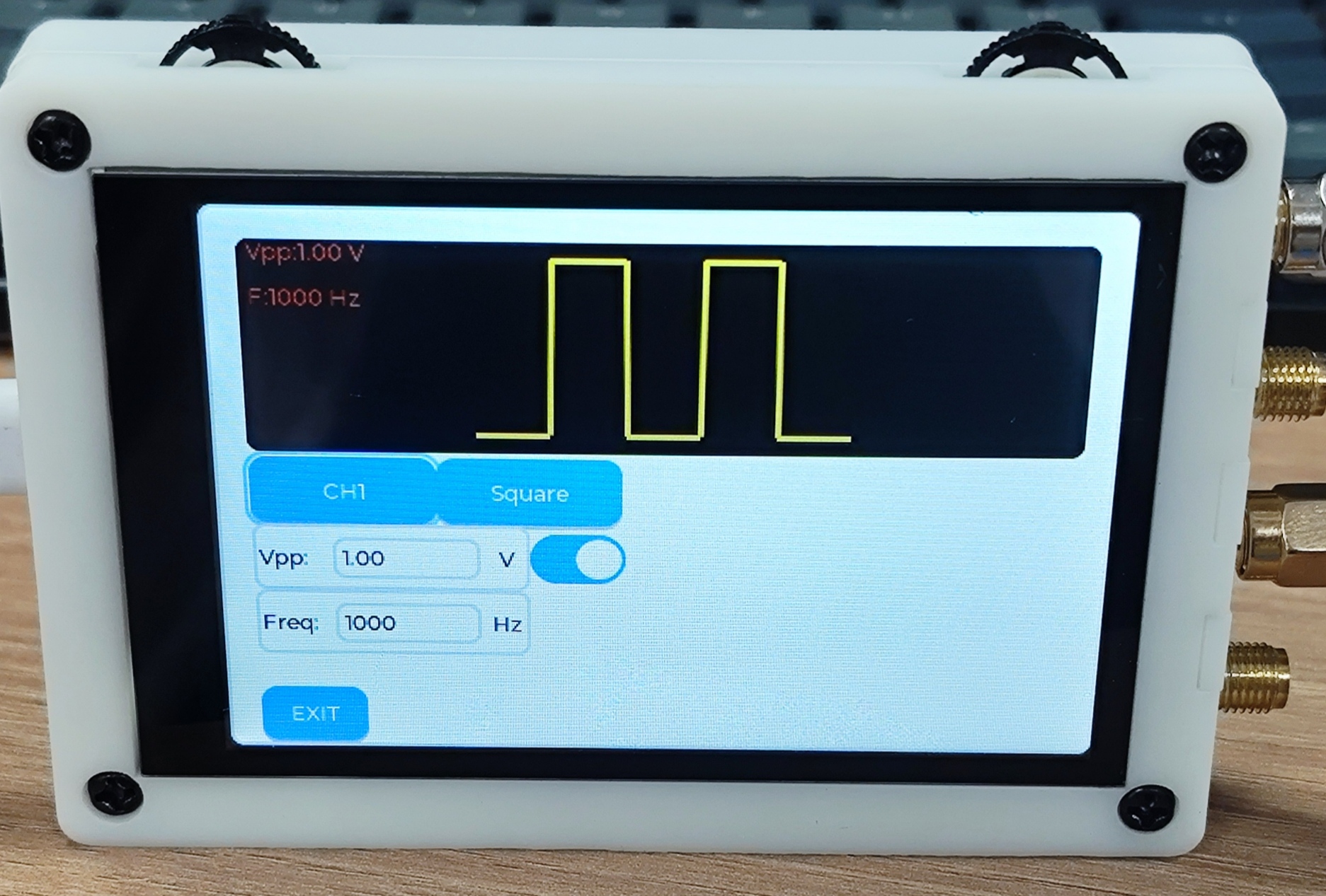

Figure 5.3 Signal Generator Interface.
       Press the button on the right of Figure 5.1 to enter the signal generator function. Flip the three-way switch in the upper left corner to sequentially focus on the channel switching button, waveform switching button, maximum value setting button (currently the minimum value is fixed at 0V), frequency setting button, output switch, and exit button. See the video for detailed operation instructions.
