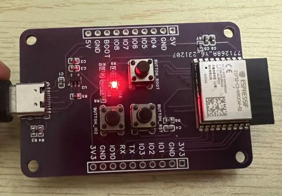

ESP32C3 Minimum System Board V1
The initial idea stemmed from
a software development perspective, favoring a streamlined approach with fewer pins and larger Flash memory.
The RP2040 required an external Flash IC, which was cumbersome, and I lacked the expertise to solder QFNs. I designed a 4-layer PCB, but discarded it before soldering.
The STM32G030's built-in Flash memory was insufficient. This issue was only discovered during debugging after soldering the board.
Therefore, the only viable option was the ESP32 with a C3 chip, offering the fewest pins and 4MB of Flash memory, allowing for flexible design.
The
company, which manufactures open-source hardware, already had an ESP32C3 + SSD1306 product, so the power supply section was directly reused.
The screen was removed; the company's board uses FPC cables soldered directly onto the PCB, which I didn't need.
The remaining task was arranging the button traces.
The board was relatively large for easier routing.
However, each button had four via pads, hindering routing; surface-mount buttons might be considered.

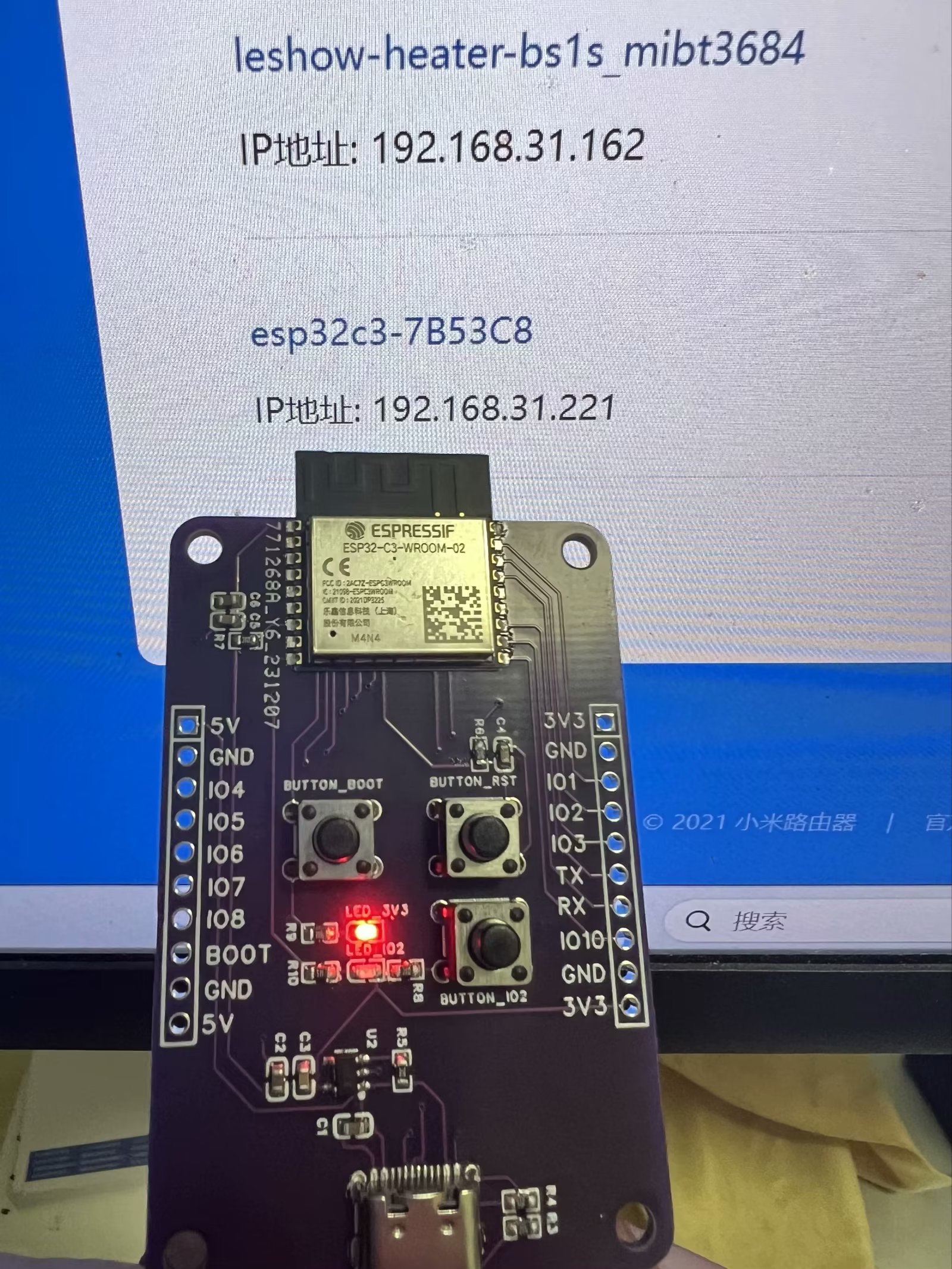

The board includes an LED and buttons connected to IO0 and IO2 respectively for easier debugging.
Additionally, note that the ESP32C3 ships with empty Flash memory; without pulling IO9 low, it will default to using external Flash.
This will cause continuous reboots and prevent downloading. Initially, a reset is required to pull IO9 low
, or perhaps a hardware serial port could be used, but I haven't tried it yet.

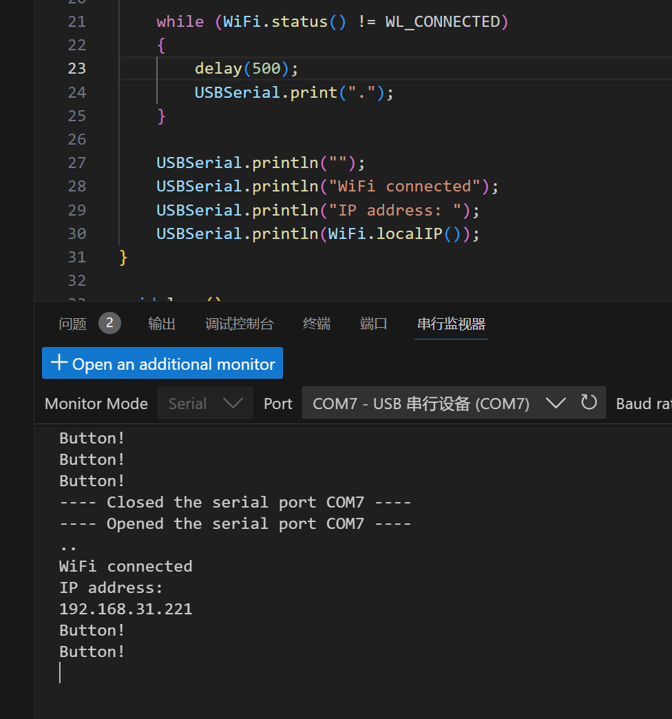

Testing showed that downloading, GPIO input/output, and WiFi connection all worked normally.
Project successful.

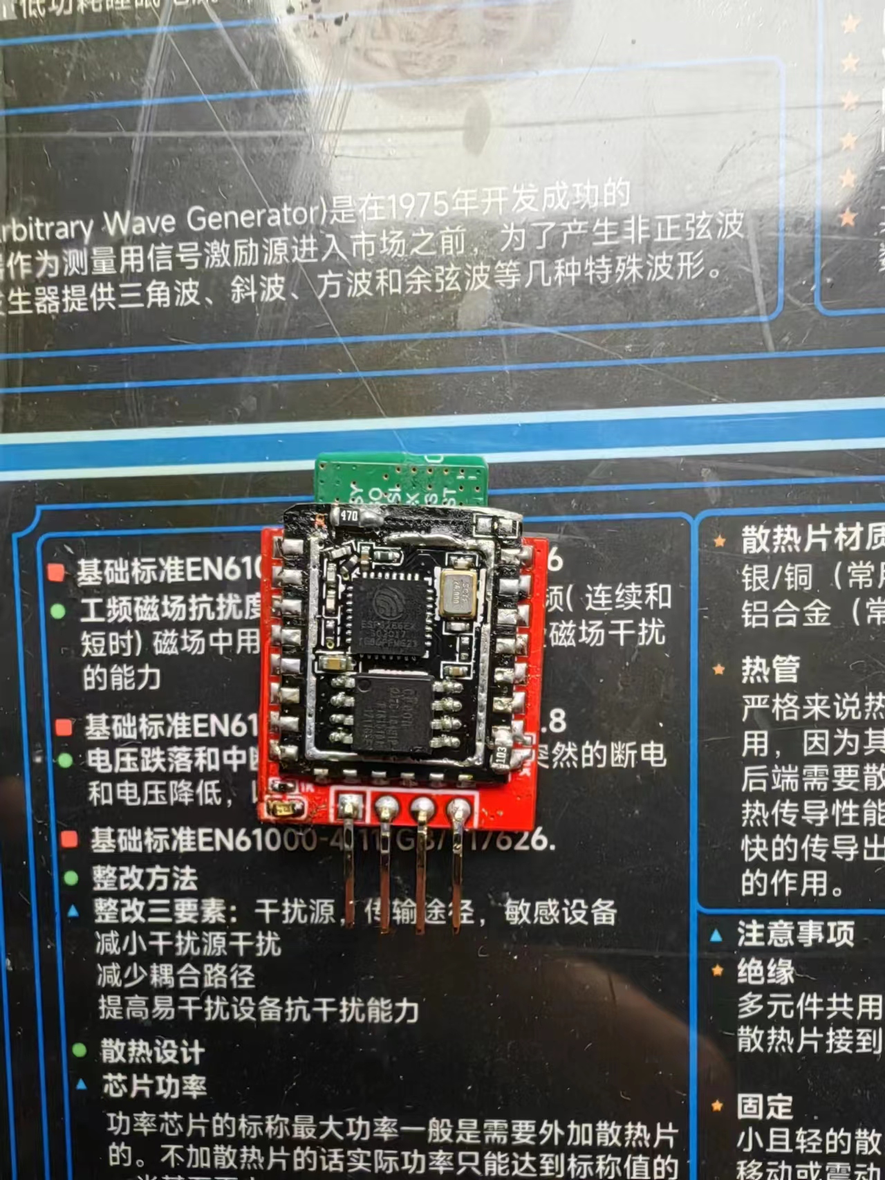

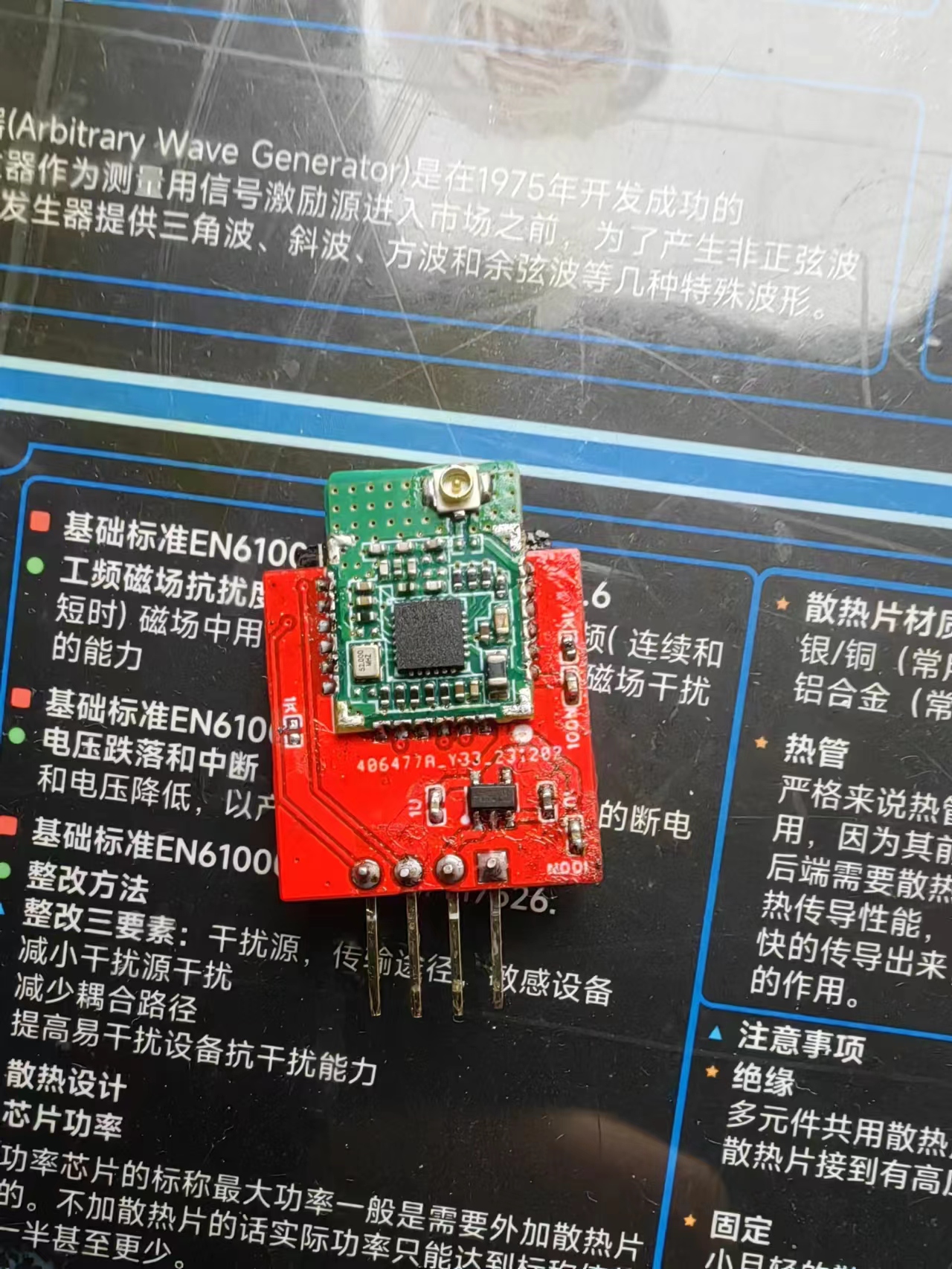

elrs_8266_rx_mini
Minimize the size of the ELRS receiver by using the A28+8266 solution.
ELRS, a low-cost receiver built using the A28 and ESP_12F.
Flashed with the official Betafpv Nano RX firmware.
See details: https://www.bilibili.com/video/BV1Uu4y1t7Fk/
Many people said the previous version was too large, so this is a smaller and lighter version.
