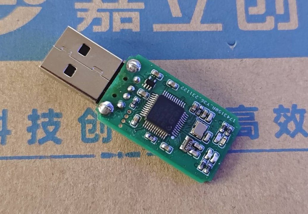

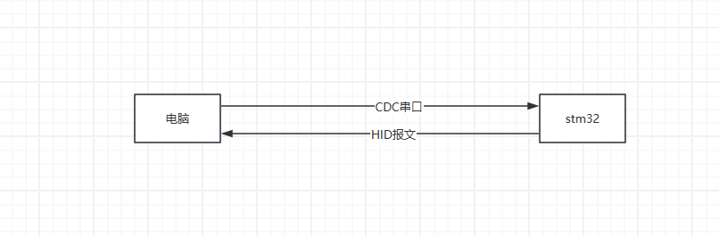

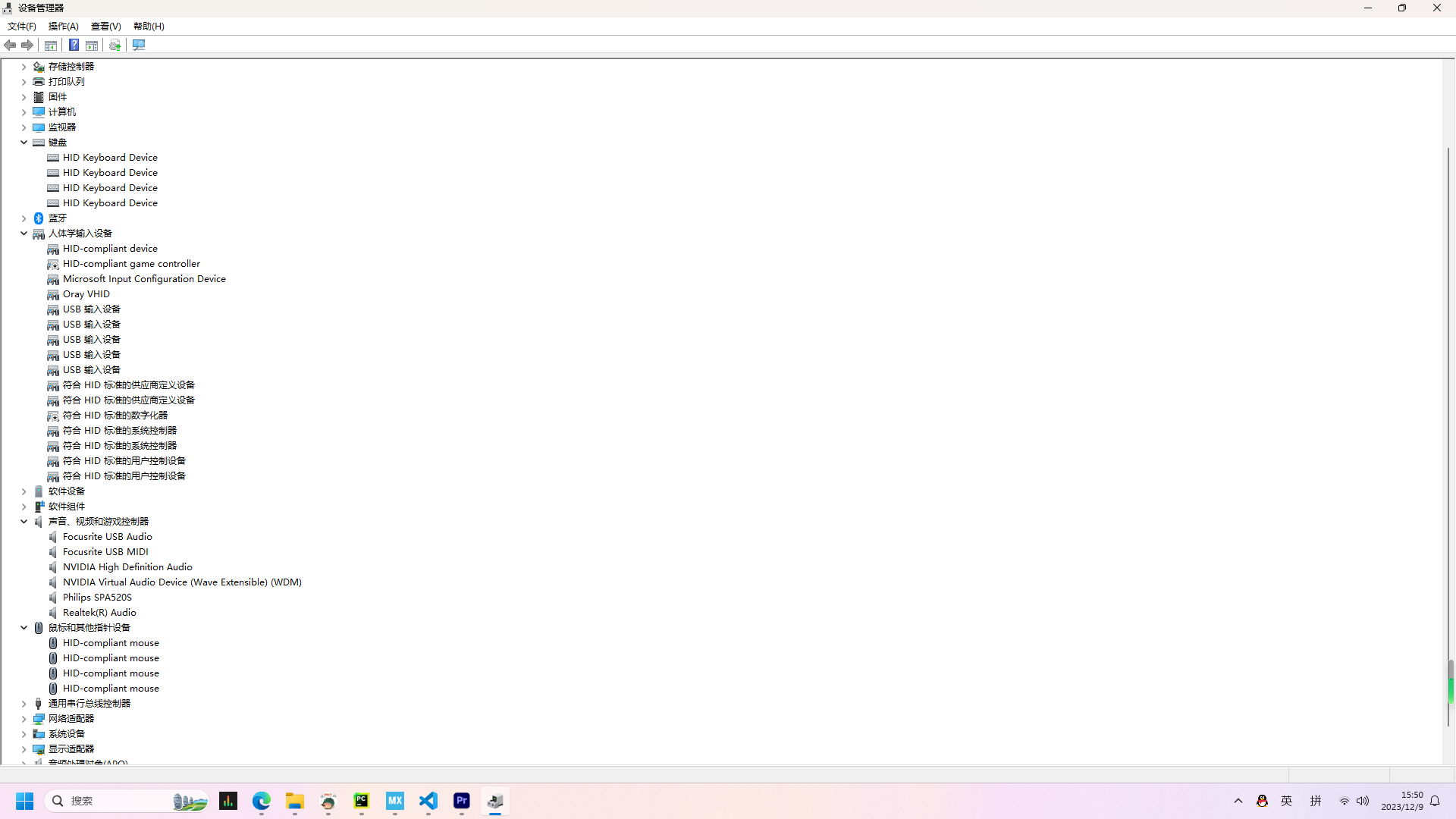

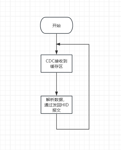

Hello everyone, this is a USB composite HID CDC device I created. In this project, the STM32 is configured as HID (keyboard, mouse, multimedia) and CDC (serial port), so serial communication with the keyboard can be achieved via USB.
This is the function I wanted to achieve.

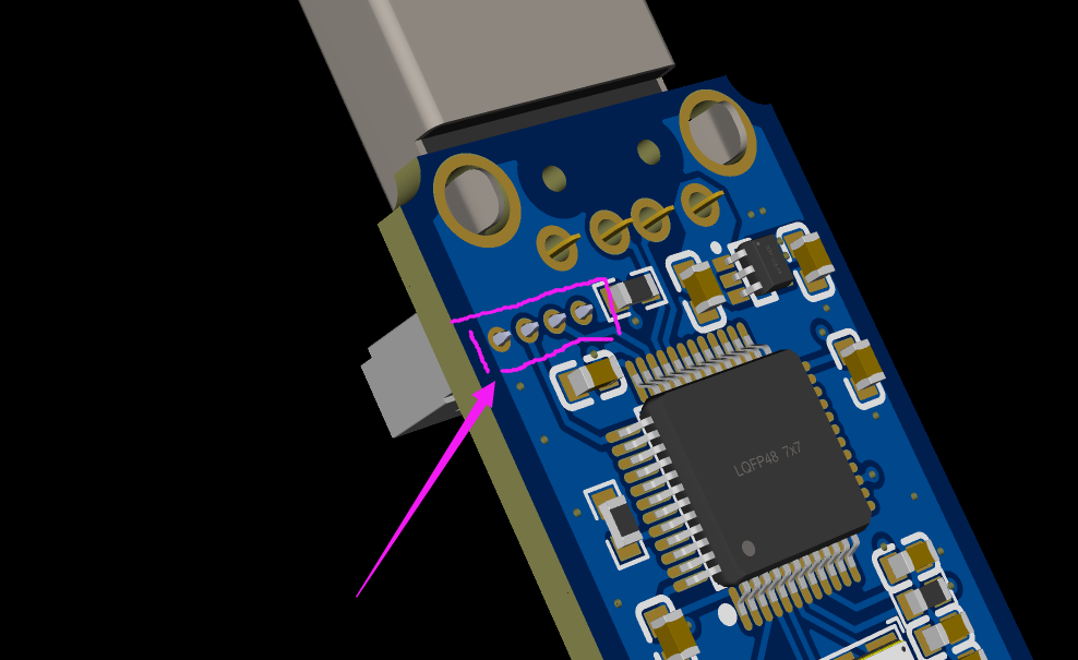

The USB circuit

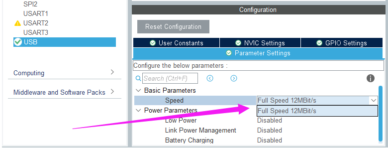

is configured as a full-speed device. A 1.5k pull-up resistor is needed on the D+ port (3.3V).
The reason for configuring it as a full-speed USB device is
that one full-speed device is sufficient;
also, the STM32F103C8T6 seems to only support full-speed devices.
Please refer to the manual for a more detailed explanation. The

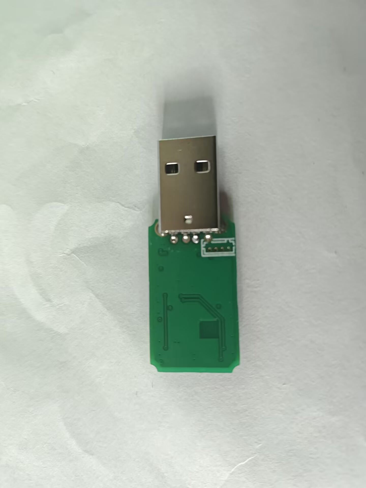

PCB design

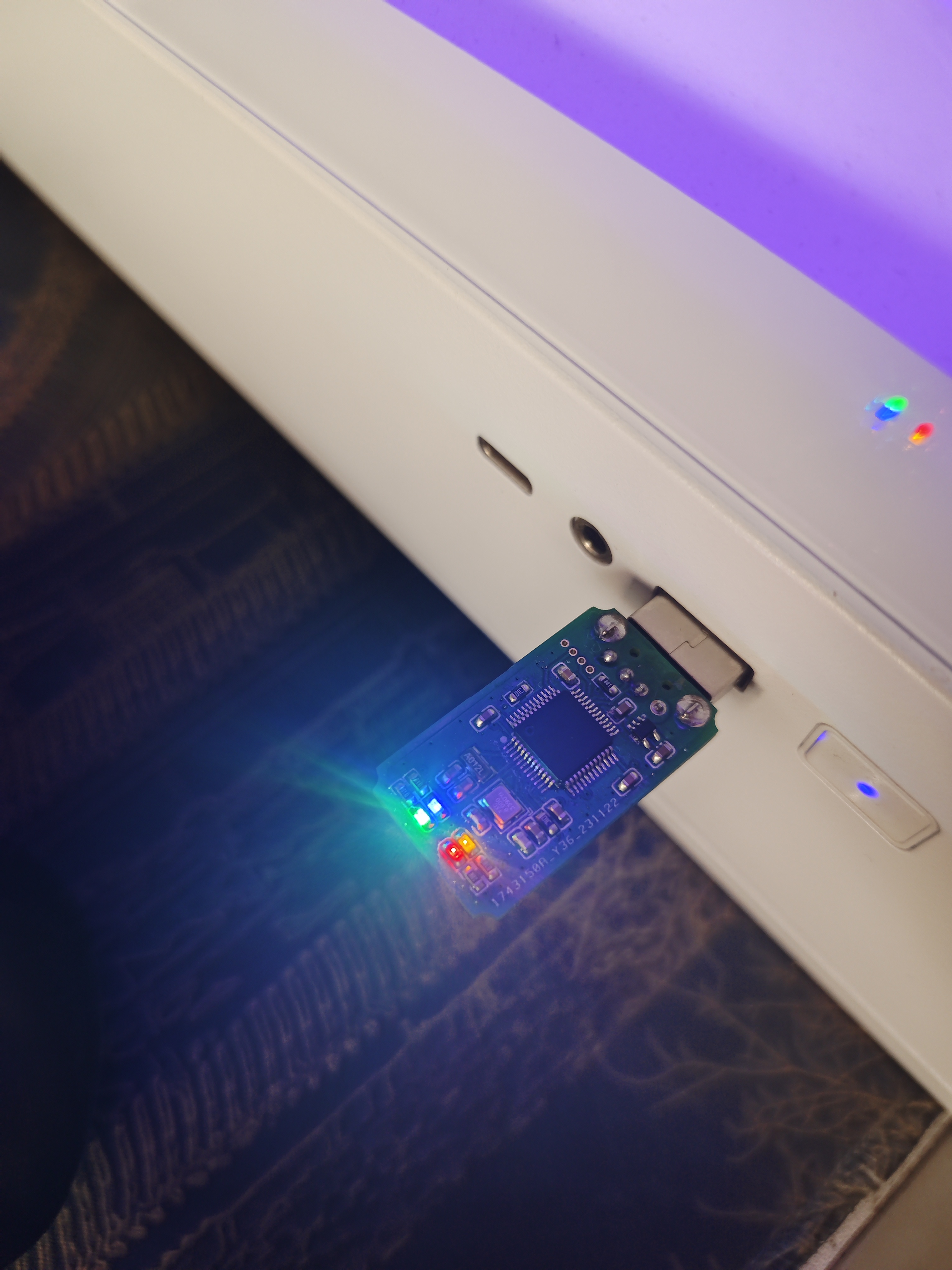

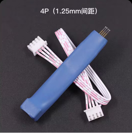

is not very complex; it could be done with a two-layer board. I used a four-layer board mainly for impedance matching calculations, hoping to achieve more stable operation. A simplified flowchart of the program: First, configure the USB device, modify the device descriptor, configure the descriptor, and report the descriptor. Then you can start writing the functions. I also configured several LEDs as Caps Lock and Num Lock indicators, which are written in the HID callback. (Three LEDs were left in total; feel free to modify them as needed.) For the SWD flashing interface, you might need to prepare something like this. This socket doesn't need to be soldered (I didn't either). Important evidence of successful configuration: STM32 USB HID CDC composite device_Bilibili_bilibili https://github.com/cnxft/composite_hid_cdc.git
