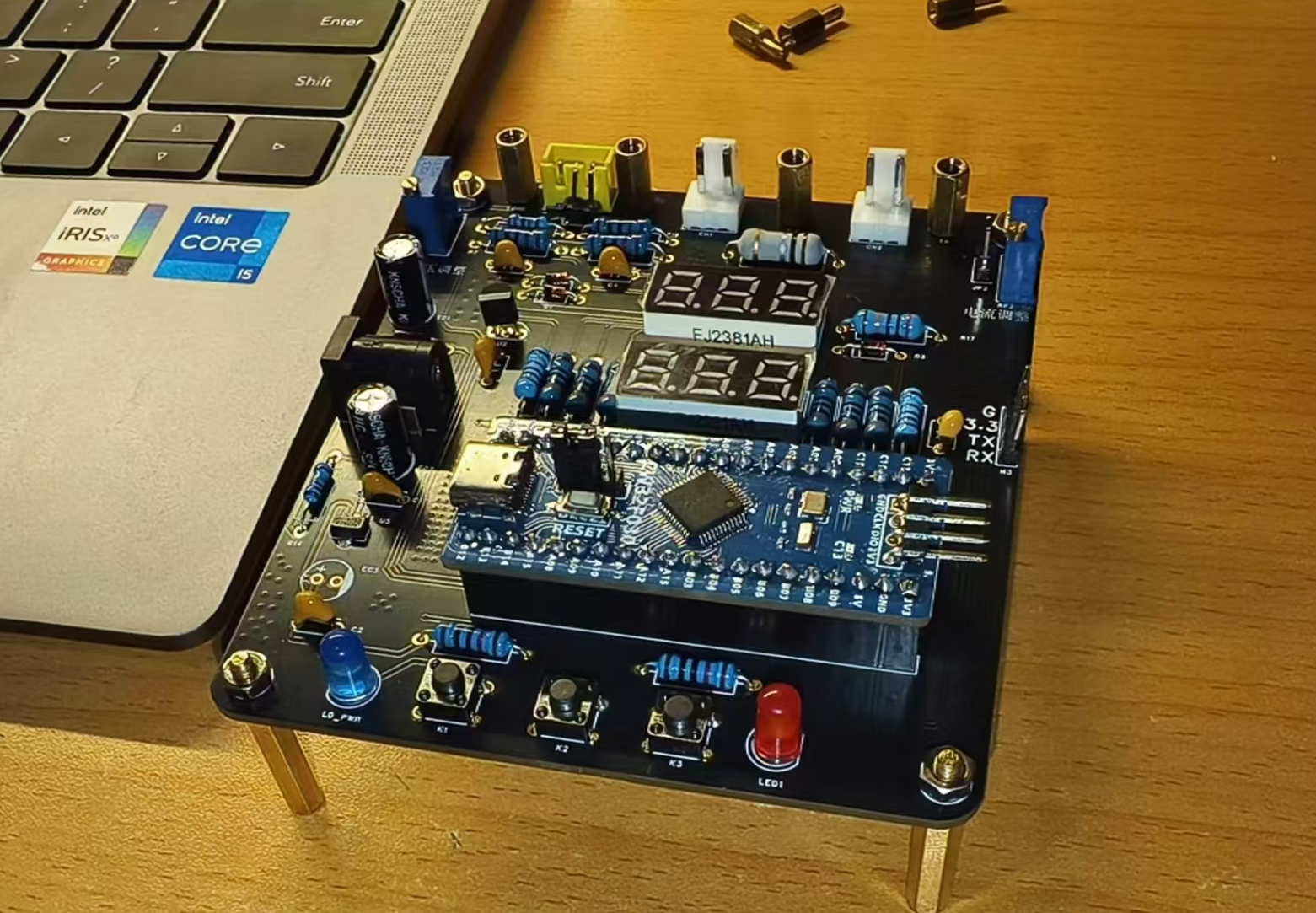

I. Hardware The
hardware part referenced the "CW32 Digital Voltmeter and Ammeter Training Camp Project Tutorial Document"; I changed the through-hole components to surface-mount components. Every step in the document is very detailed, making it easy for beginners to learn without having to search for tutorials everywhere. I really love it! LCSC is awesome!!!

3. Voltage Sampling Circuit:
The voltage divider resistors used in this circuit are 220K+10K.
Voltage Divider Resistor Selection
: 1. Maximum design measurement voltage: For safety reasons, this project uses 30V (actual maximum display can be 99.9V or 100V);
2. ADC reference voltage: This project uses 1.5V, which can be configured through the program;
3. Power consumption: To reduce the power consumption of the sampling circuit, the low-side resistor (R7) is usually selected as 10K based on experience;
then the high-side resistance of the voltage divider resistor can be calculated using the above parameters:
1. Calculate the required voltage division ratio: i.e., ADC reference voltage: design input voltage, which can be calculated using known parameters as 1.5V/30V=0.05
2. Calculate the high-side resistance: i.e., low-side resistance/voltage division ratio, which can be calculated using known parameters as 10K/0.05=200K
3. Select a standard resistor: Select a resistor slightly higher than the calculated value, which is 200K. We usually choose E24 series resistors, so in this project, we choose 220K, which is greater than 200K and closest to it.
4. Current Sampling Circuit:
The sampling current designed for this project is 3A, and the selected sampling resistor (R0) is 100mΩ.
The following aspects should be considered when selecting the sampling resistor:
1. The maximum value of the pre-designed measurement current, which is 3A in this project
. 2. The voltage difference caused by the current sensing resistor; it is generally not recommended to exceed 0.5V.
3. The power consumption of the current sensing resistor; a suitable package should be selected based on this parameter. Considering the power consumption (temperature) issue under high current, a 1W metal wire-wound resistor was selected in this project.
4. The voltage amplification factor across the current sensing resistor: No operational amplifier is used to build the amplification circuit in this project, so the factor is 1.
The current sensing resistor value can then be calculated using the above parameters.
1. Since this project does not use an amplifier circuit, a larger sampling resistor is needed to obtain a higher measured voltage for measurement.
2. Considering that a larger resistor will result in a larger voltage drop and higher power consumption, an unlimited selection of a larger resistor is not advisable.
3. This project uses a 1W package resistor, corresponding to a power consumption of 1W. Based on
the above data, a 100mΩ current-sensing resistor was selected. According to the formula, 3A * 100mΩ = 300mV, 900mW can be calculated.
5. Display Unit:
This project uses two simpler and more stable three-digit common-cathode LED displays as the display device.
In this project, the current-limiting resistors (R1~R6) of the LED displays are configured to 300Ω. The corresponding brightness, whether for red or blue LED displays, has good visibility and is soft and not dazzling.

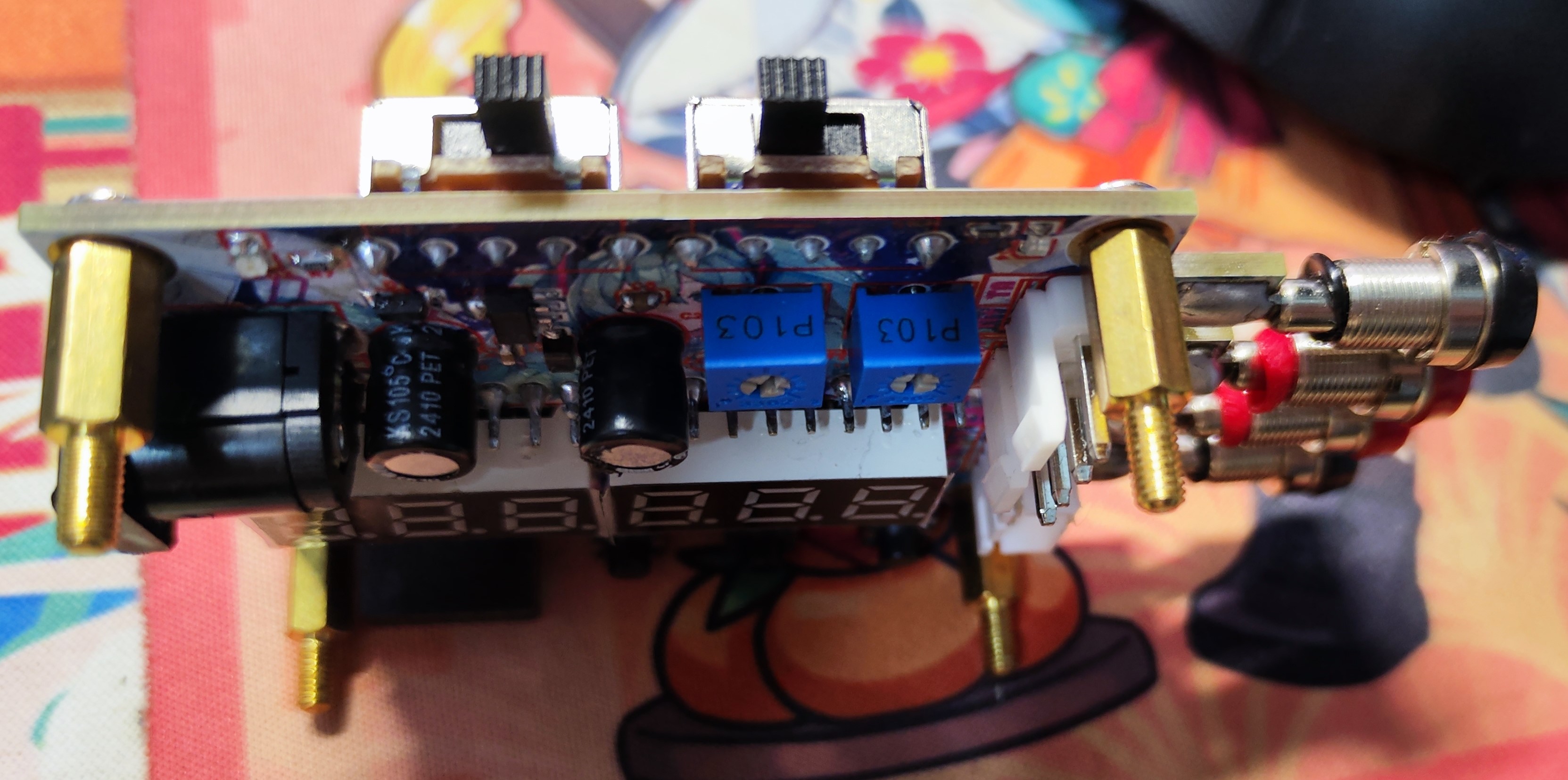

Simple Digital Voltmeter and Ammeter
This is a poor imitation of an open-source project from JLCPCB's CW voltage and current meter training camp, a shining example of domestic hardware. It has its shortcomings and problems; I would appreciate your kind advice.
Project Overview:
This project is an open-source project from the LCSC Voltage and Current Meter Training Camp. Based on the LCSC CW32 development board, it's an expansion board design for a voltage and current meter, capable of detecting externally input voltage and current. Theoretically, the voltage range is 0-100V, and the current range is 0-3A.
Project Parameters
: Voltage range: 0-100V (not recommended to exceed 30V for safety);
Current range: 0-3A; The current sensing resistor can be adjusted or replaced with an amplifier to increase the range;
6-36V input, standard DC interface, LDO power supply system, nominal value 12V;
Three buttons, events can be customized according to the program;
The design includes an adjustable reference voltage for quick testing and calibration.

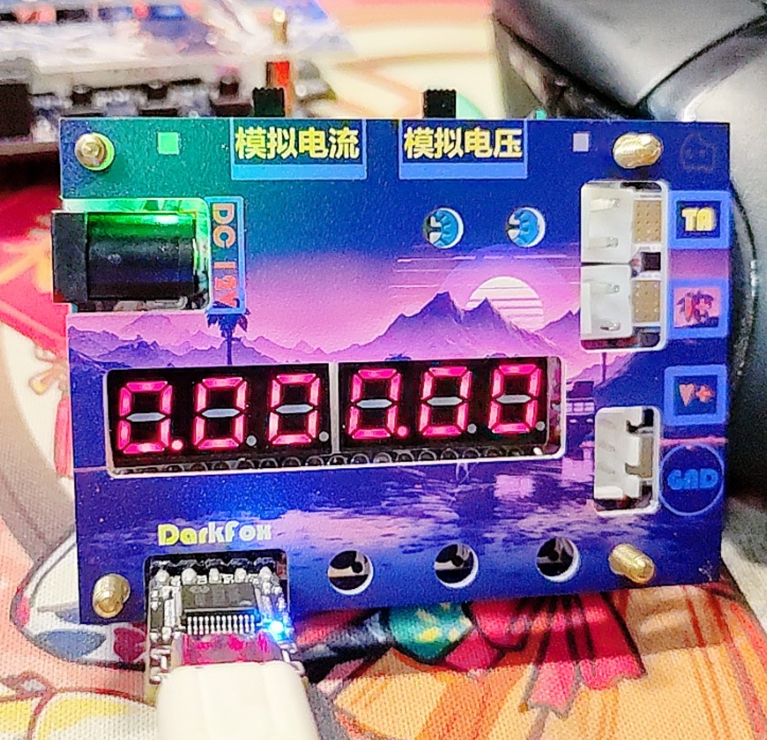

LED power indicator and operation indicator physical verification
: Voltage verification:
I only have a small USB adjustable voltage source on hand, so I used it with a power bank for testing;
because this small USB voltage source costs only a few dollars and the reading is inaccurate, we used a regular multimeter as a reference;
after connecting the cables, we can see that the readings are basically consistent;
Current verification:
I don't have a current source on hand, so I used a voltage source and an LED to form a rough constant current source; under low current conditions, the accuracy of this USB power source is slightly higher, because my cheap multimeter doesn't have a current measurement mode, so I used this as a rough reference; we can see that the parameters are basically consistent;
verification is now complete;

4. Digital Tube Display:
This project uses a digital tube as the display unit.
This project uses two 0.28-inch three-digit common-cathode LED displays as the display device. Compared to a display screen, LED displays offer better visibility in complex environments. The brightness of the LED displays can be increased by using smaller current-limiting resistors to meet the specific needs of the application environment. Furthermore, LED displays have better mechanical properties and are not as easily damaged by external forces as display screens. They are widely used in industrial applications where stability and reliability are crucial. From a development board learning perspective, this makes it easier to learn electronic measurement principles and related development in a targeted manner.
In this project, actual testing showed that a 300Ω current-limiting resistor for the LED displays resulted in good visibility for both red and blue LED displays, with a soft and non-glaring brightness.
5. LED Indicators:
This project added a power indicator and an I/O operation indicator.
Regarding LED brightness: Maximum LED brightness is very glaring, and maximum brightness output is not recommended.
After determining the required light intensity, adding a current-limiting resistor after calculation can reduce its brightness. Alternatively, PWM control can be used to control its brightness.
We can perform simple calculations based on the LED light's datasheet. According to the datasheet, we can quickly locate the forward current and forward voltage. Then, based on the current-intensity curve, we can obtain the current limiting value required for the desired brightness, and then deduce the value of the current-limiting resistor. For example, if we want the light to output with a relative intensity of 1:

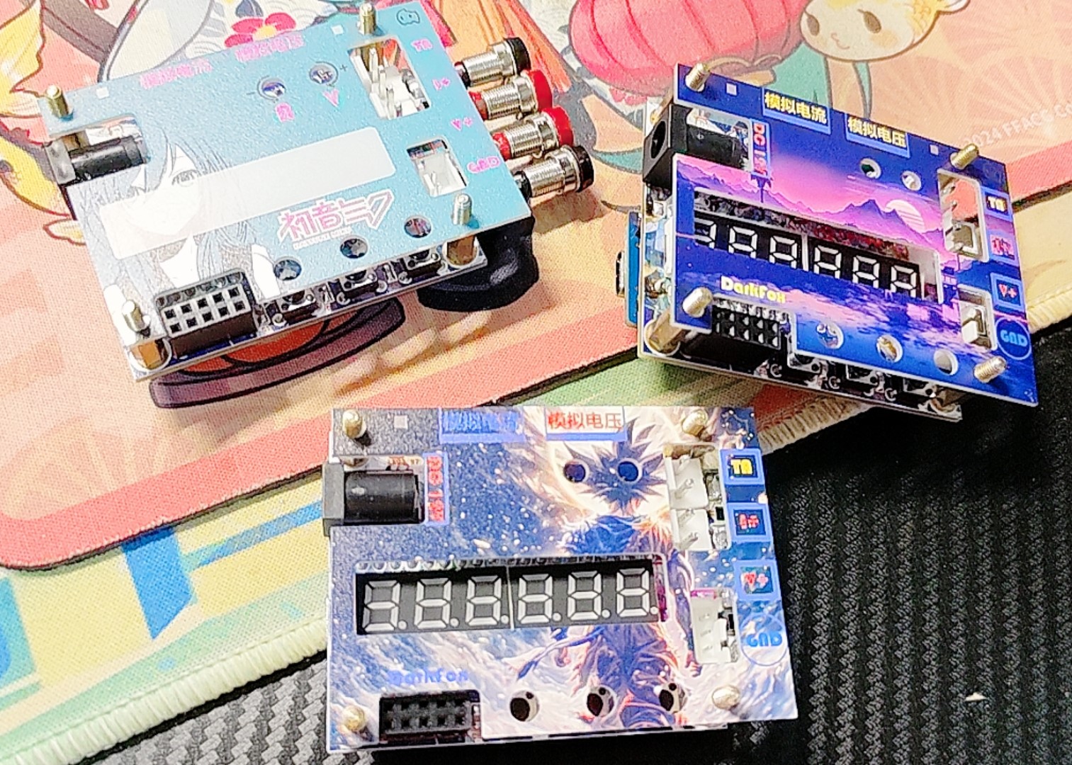

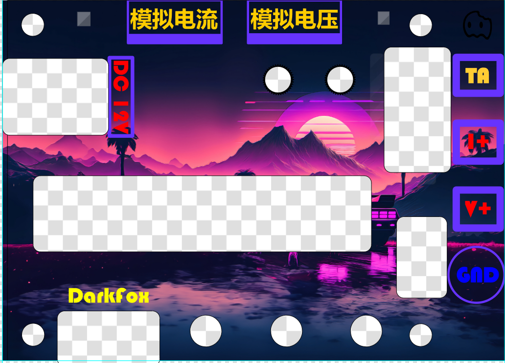

the panel design was designed
because it was my first time using JLCPCB's panel service, so there were some things I didn't understand, and therefore I designed three different panels;
the Miku and
Hatsune Miku versions were designed because I didn't quite understand the impact of the transparency parameter, so at 80.80% transparency, you need to be very close to see the display effect clearly, so it is recommended to use a more transparent or cutout panel for easier observation of the digital tube;
The WuKong version of the
Wukong version has a hollowed-out central display area. Unfortunately, I couldn't find Black Myth materials at the time, so I used Dragon Ball materials instead (not for commercial use). This version was to test the dark effect of LCSC panel printing;
Vaporwave <<<
Vaporwave style theme; the dark tone makes the warm-colored characters have high contrast. If the above two effects are not good, at least there is a usable one; fortunately, LCSC panel quality is very good, and all three can be used.

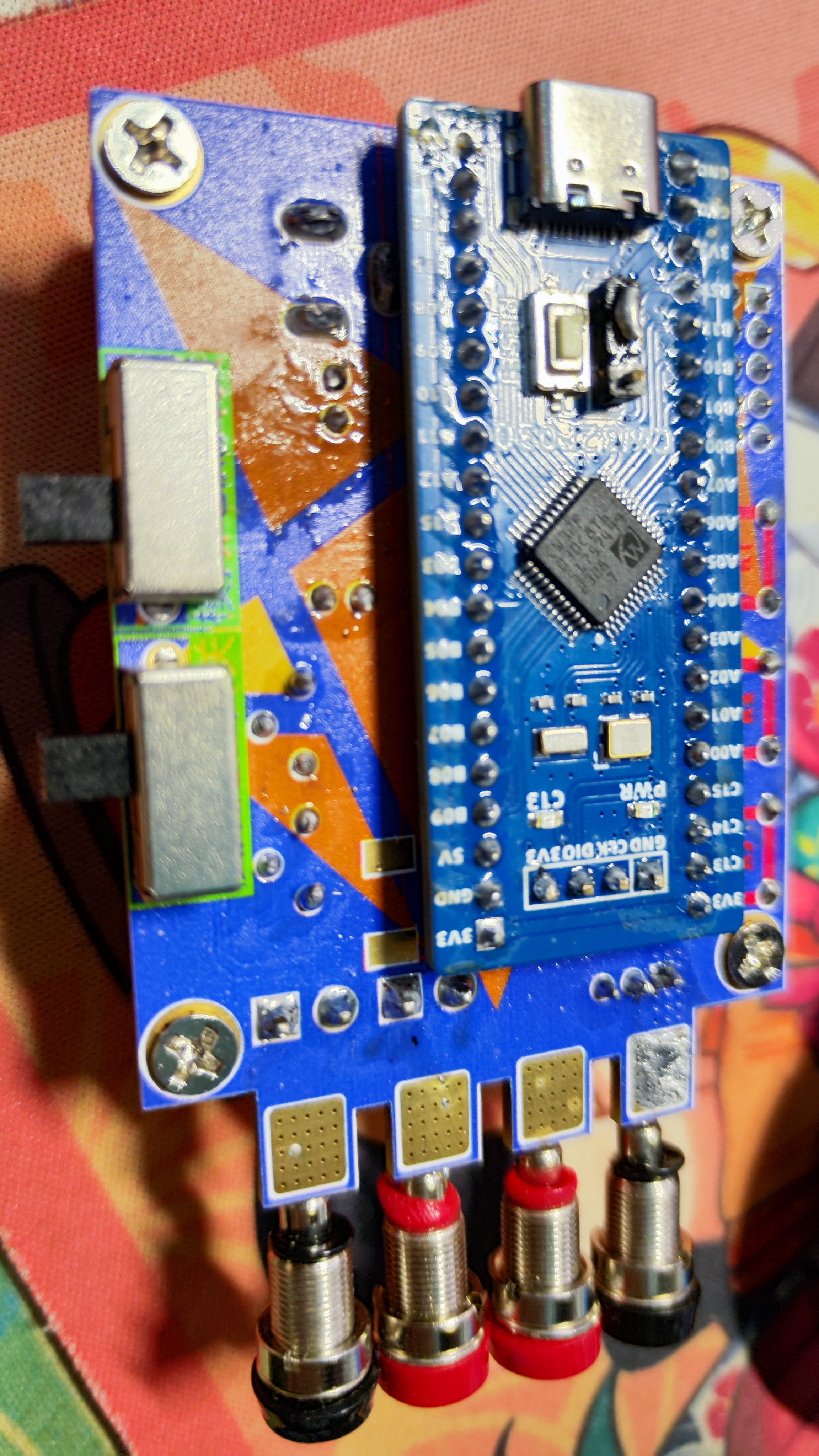

Precautions:
If you want to replicate my project, you must at least know how to solder 0603 package surface mount components;
when soldering, adhere to the principle of starting from small to large, from surface mount to through-hole, otherwise you will find that some components cannot be assembled, and some components are extremely difficult to solder;
try not to solder the development board directly to the expansion board, it is best to use female headers, otherwise subsequent maintenance and component replacement will become extremely difficult;
analog voltage and analog current switches are only for testing and calibration, and must not be opened during actual use!!!
