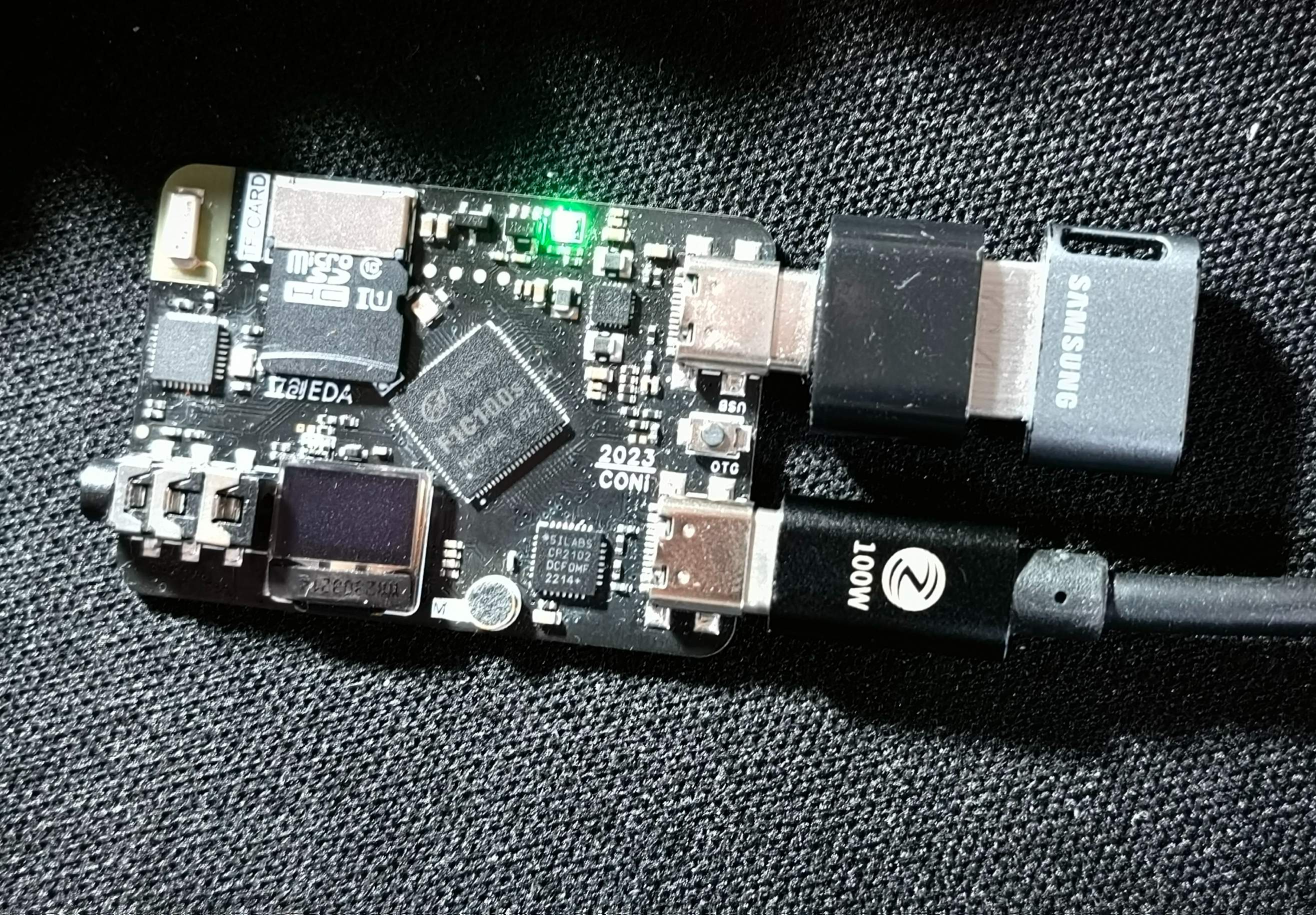

This is a small Linux board I designed as a practice project. It uses an F1C100S as the main controller and can run the official firmware for the Lychee Pi series. You can also compile and create your own image file as needed
. It has a variety of peripherals (approximately), including audio input and output, a mini screen on the front, and the back can be configured with different screen sizes (requires driver modifications in the kernel). The board is very small and looks quite refined.
CPU: Allwinner F1C100S / F1C200S;
Serial Port: CP2102;
WIFI: ESP8266 / The ESP8089
resistor-capacitor package is basically 0402, with a relatively high density, requiring considerable hands-on skill .
The TF card slot is quite low, so be careful not to bend the card forcefully when inserting or removing it, otherwise it may be easily damaged . The power supply
uses the EA3036 solution .
