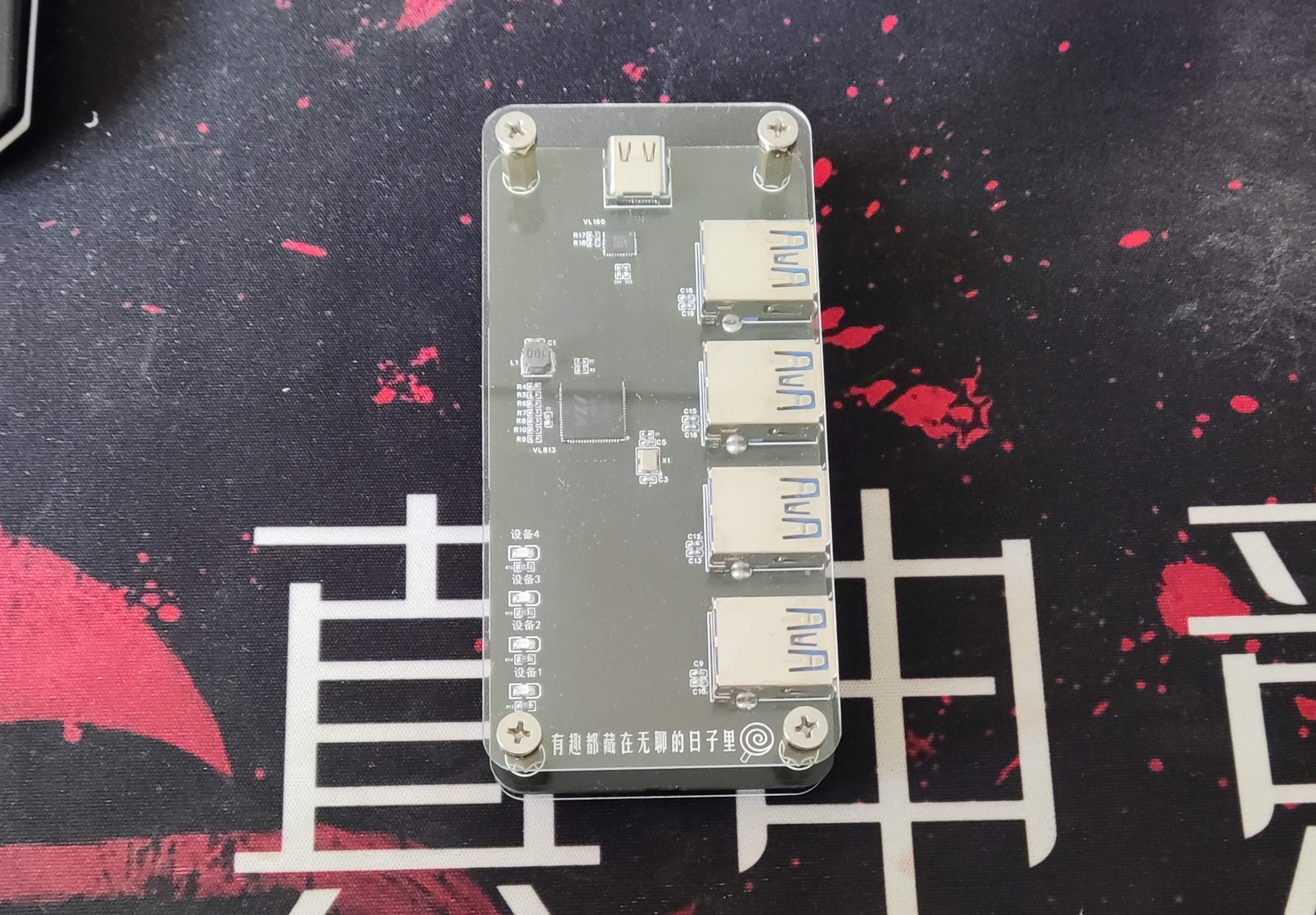

I. Design Summary:
This USB 3.0 hub based on VL813 adopts a one-to-four structure. The hub uses a Type-C interface and supports reversible insertion.
II. Design Schematic Diagram
III. PCB Diagram
(Front
and Back) IV
. Physical Display
V. Precautions:
(1) The interface uses Type-C. If you want the interface to support reversible insertion, you need to add a VL160 chip. Without adding a VL160, only one side of the interface can recognize USB 3.0, and the other side can only recognize 2.0.
(2) VL813 can be considered as a replacement for 812. The functions and circuit connections are the same, and 813 is cheaper.
VI. Function Demonstration
: Speed ​​test can run at full speed of solid-state.
