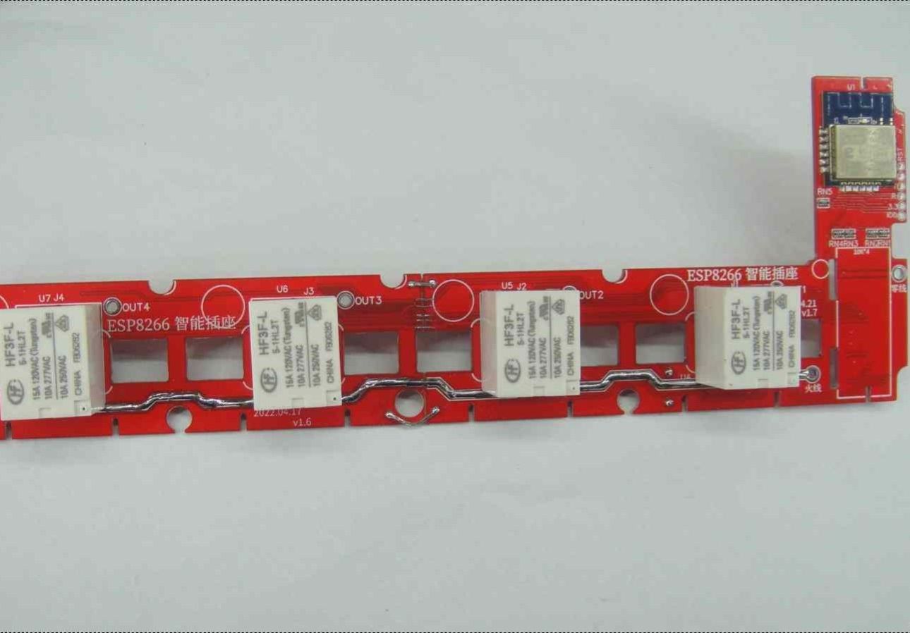

   With too many devices like printers, the standby power consumption is high, and they are not compatible with various electrical systems, making them inconvenient to use. Previously, I used a K-series smart socket to connect to a power strip and set timers for all devices. Recently, I started playing with the ESP8266 and learning Arduino, which inspired me to create my own DIY smart socket project.
     Currently implemented features include: 1. Low power consumption design: using four magnetically latched relays, the relay coils are energized only when switching on/off; otherwise, only the ESP8266 consumes power in standby mode. A USB ammeter test showed a total standby current of 0.08A for the entire PCB and 0.15A for a single relay operation.
                             2. In offline mode, the four sockets can be independently controlled by buttons, with corresponding LEDs indicating on/off status.
                             3. Utilizes MQTT protocol to connect to Home Assistant, allowing control of each switch via the Home Assistant web interface or mobile client. The socket will also provide feedback on the status of the button switches. Pressing any button sends the socket's LAN IP address to the MQTT subscription topic.
                             4. Utilizes the ESP8266 webserver service, enabling web-based switch operation (also supports POST parameter control, allowing integration with other automatic control devices or programs).
                             5. Uses the ESP8266 EEPROM to store switch states. After restarting and powering on, the status of each switch can be individually set to off/on/retain the last state (via web configuration).
                             6. The web interface allows setting 4 switch names.
                             7. Pressing and holding the third button (button 1 on the power cord end) resets the EEPROM parameters.
                             8. WIFI account and password configuration: While the WiFiManager Chinese library was used for web configuration, occasional program crashes occurred, so it was changed to web page configuration. Please complete the code yourself if needed.
                             9. Web configuration and built-in timer switch functions are under development; please stay tuned.
Note: The socket has 220V AC power; non-professionals should not disassemble or modify it! This article is for demonstration purposes only. Please be aware of safety precautions if you attempt to replicate it!
