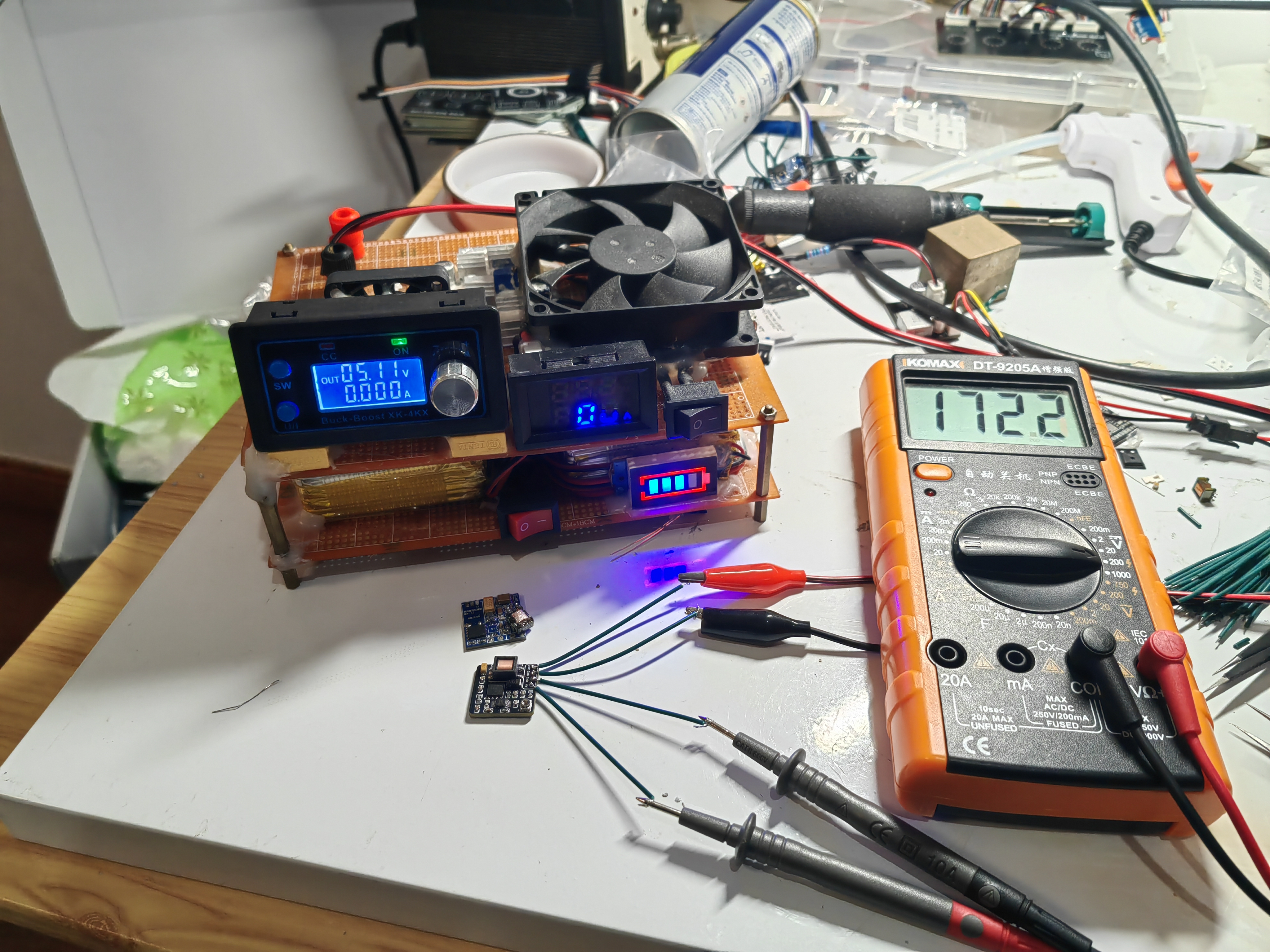

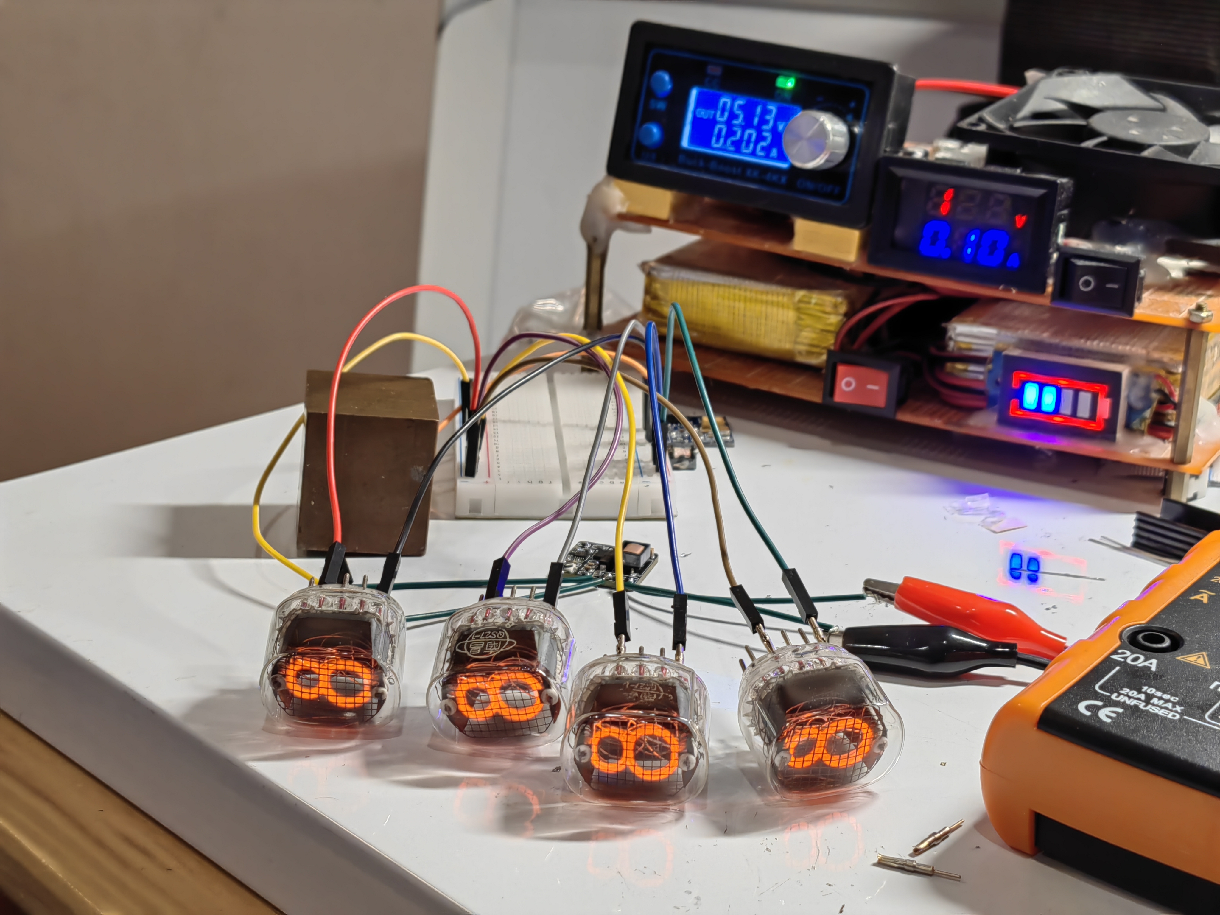

Its load-carrying capacity is decent. It can power 4 used QS27 tubes, and a brand new one should be able to power around 6.
(Load testing was not thorough; will be added later after testing.)

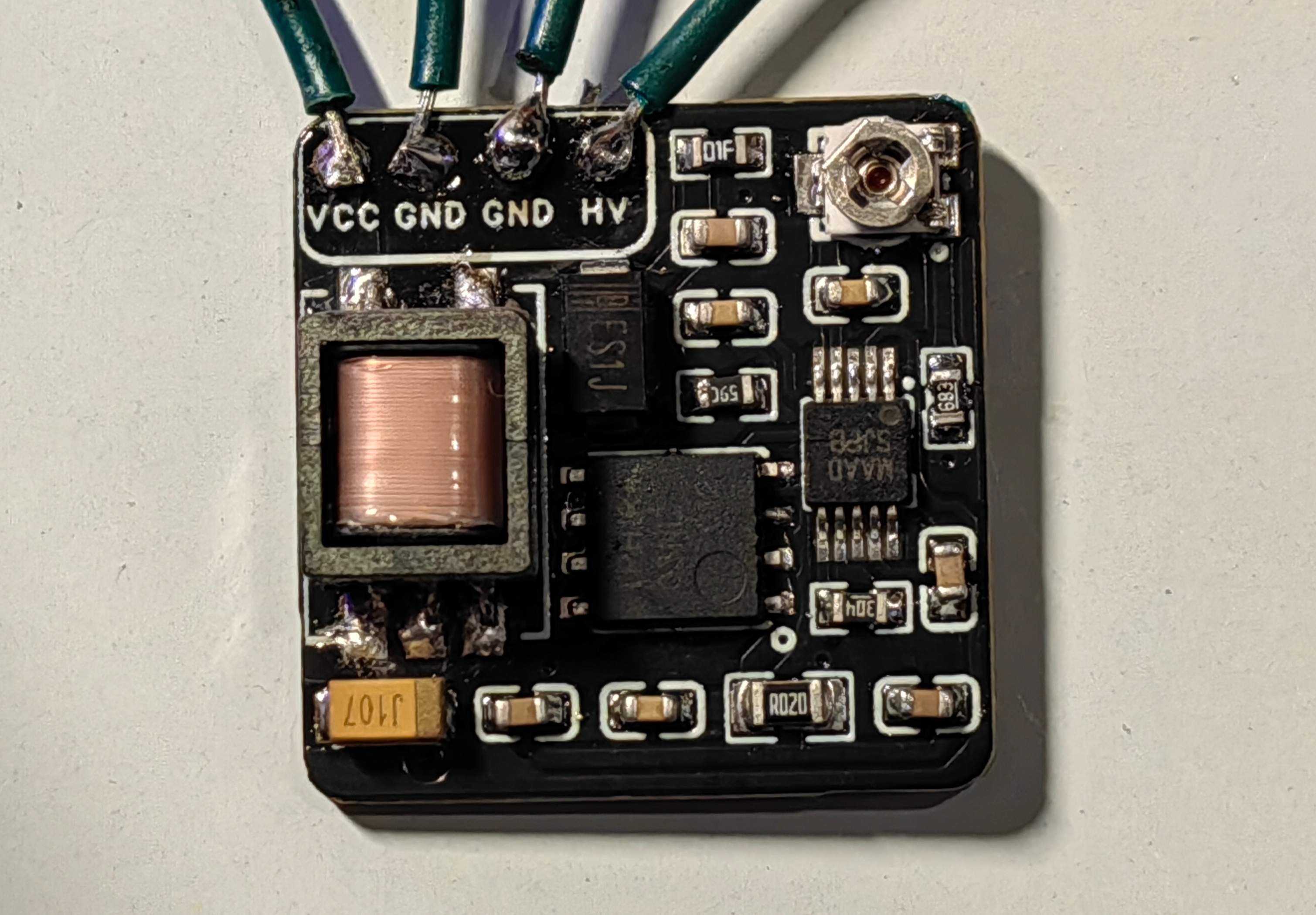

Actual Product Images
: Load testing;
Input and output voltages

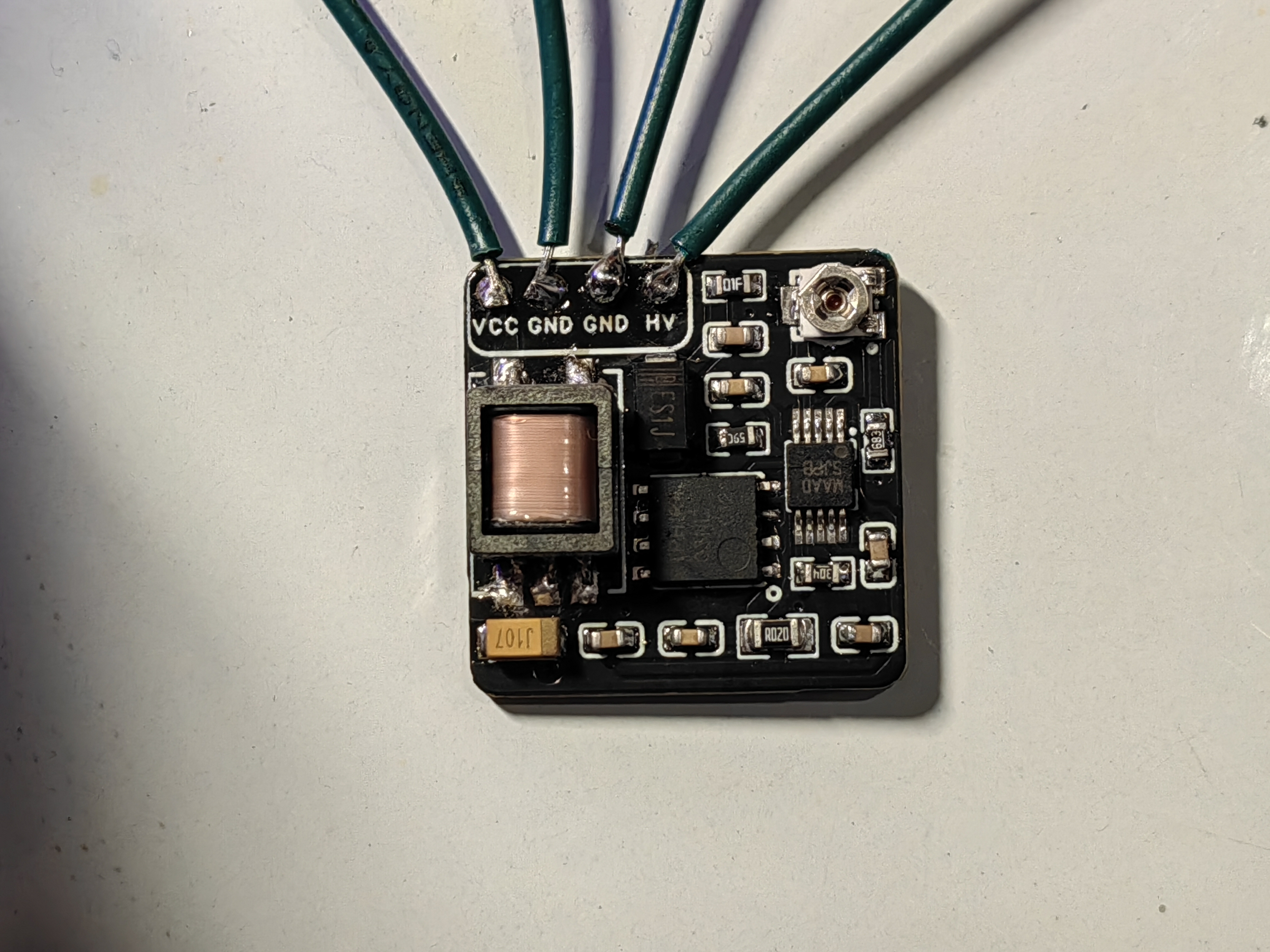

; Finished product image

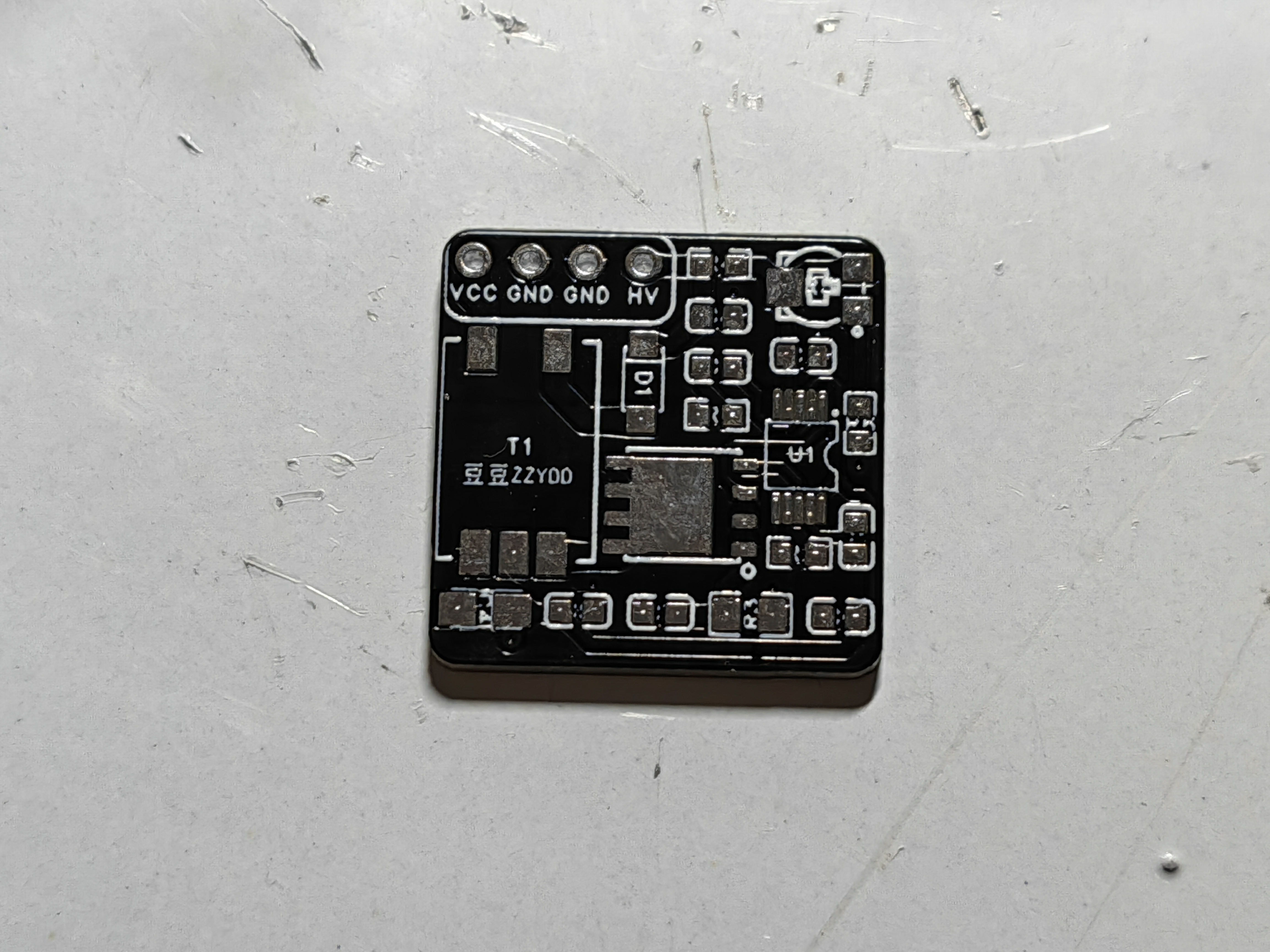

; PCB image;
PCB-3D preview image

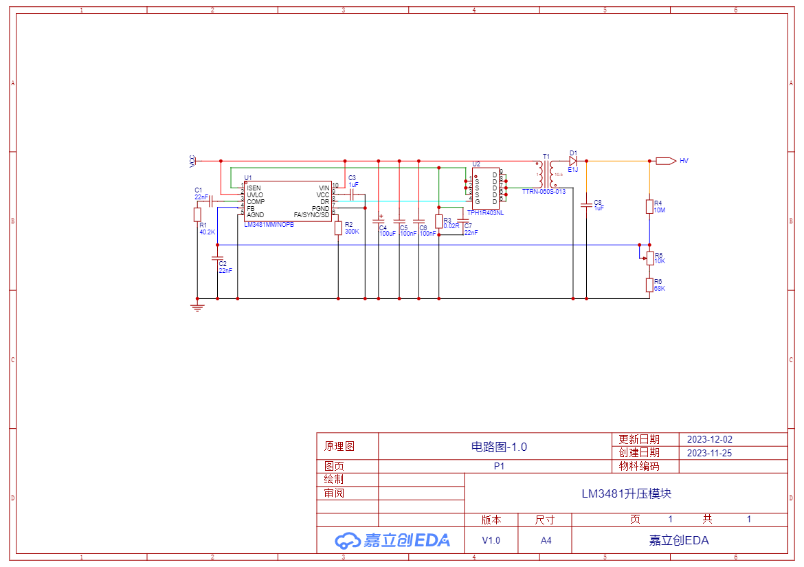

; Circuit diagram.
