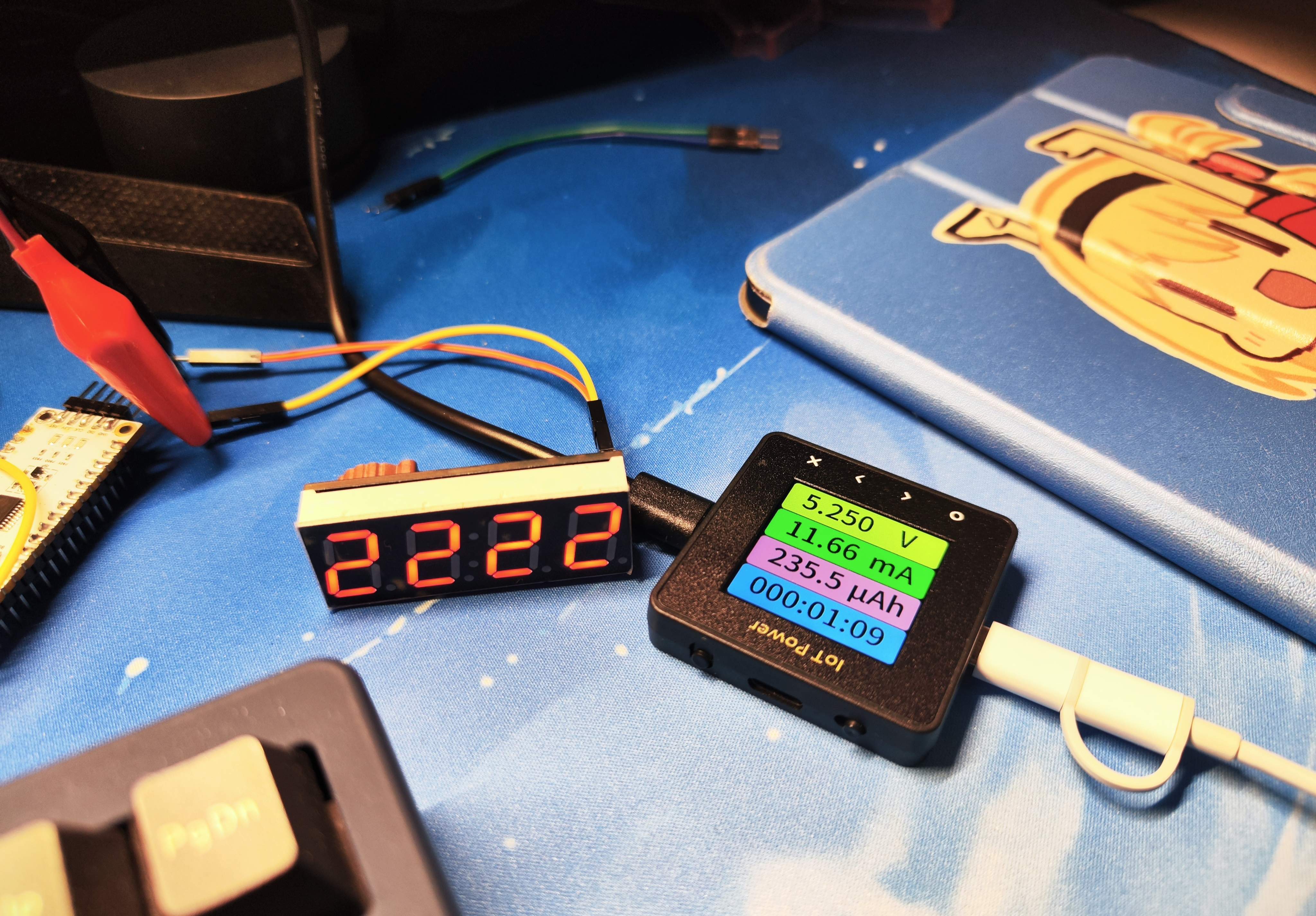

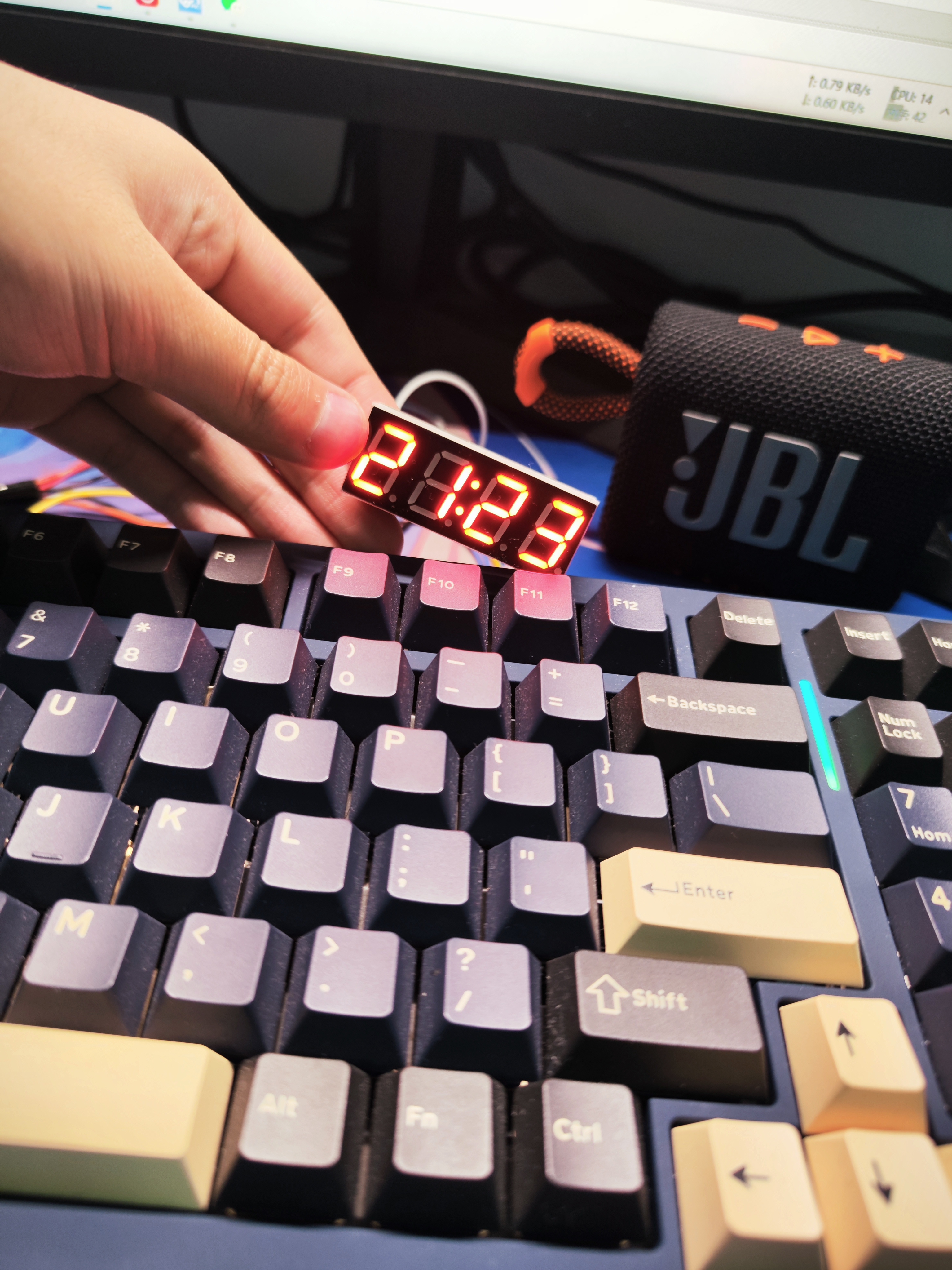

0.1v is just a prototype, emmmm, there's no way around it... Currently implemented functions
include: time display (year, month, day, hour, minute switching);
time setting (year, month, day, hour, minute setting). Why isn't there a second function? (That's a separate function; I don't have time to write it due to finals).

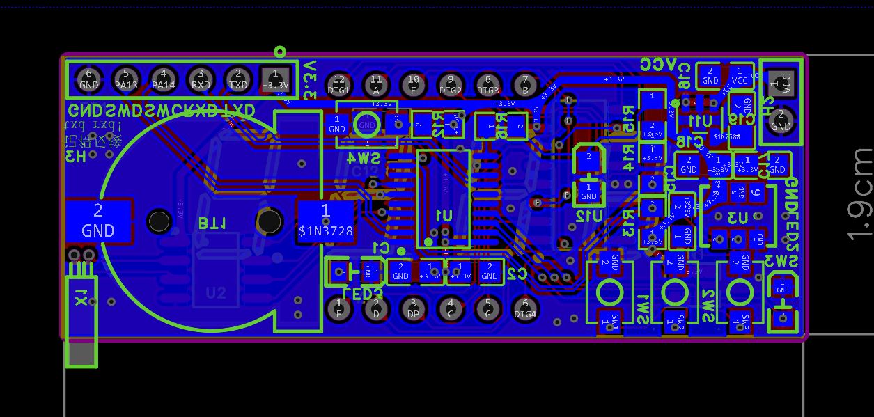

Temperature and humidity display (there's a slight issue with the PCB design; it will be revised). The current version v0.1
implements a Pomodoro timer, currently capable of counting down 30 minutes, 60 minutes, and 90 minutes. Three options
and a countdown (originally, I wanted to just modify the timestamp in the code; this function will be released later for direct
brightness switching (because the digital tube consumes too much power!).

Modify the PCB to a four-layer board,
optimize the circuit, change to a smaller LOD, and change the position of the AHT20 (if you ask me, can the temperature measured next to the LOD be accurate...).
Change the `dealy` in the code to `sleep` or something else to further reduce power consumption.

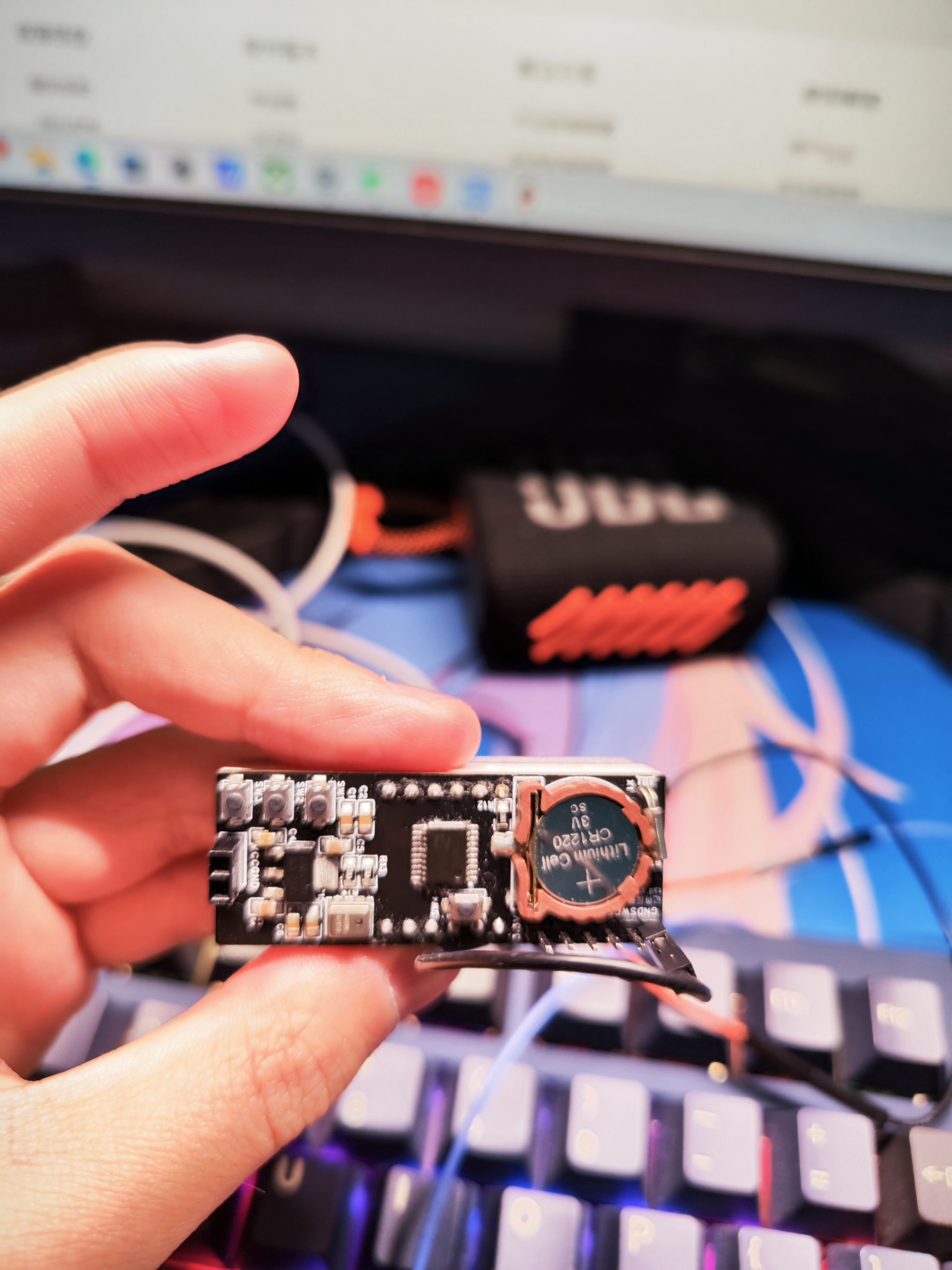

Next batch of pictures (I'm too lazy to solder them, but the board is finished).

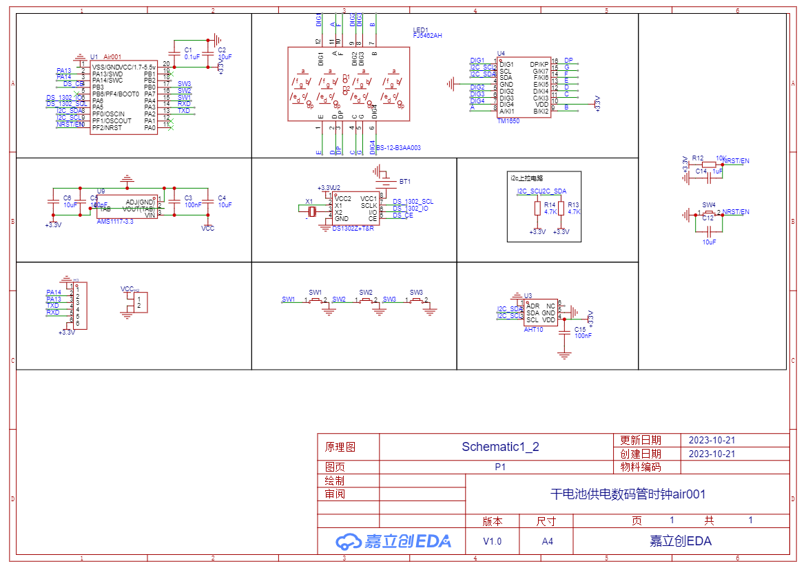

Schematic
