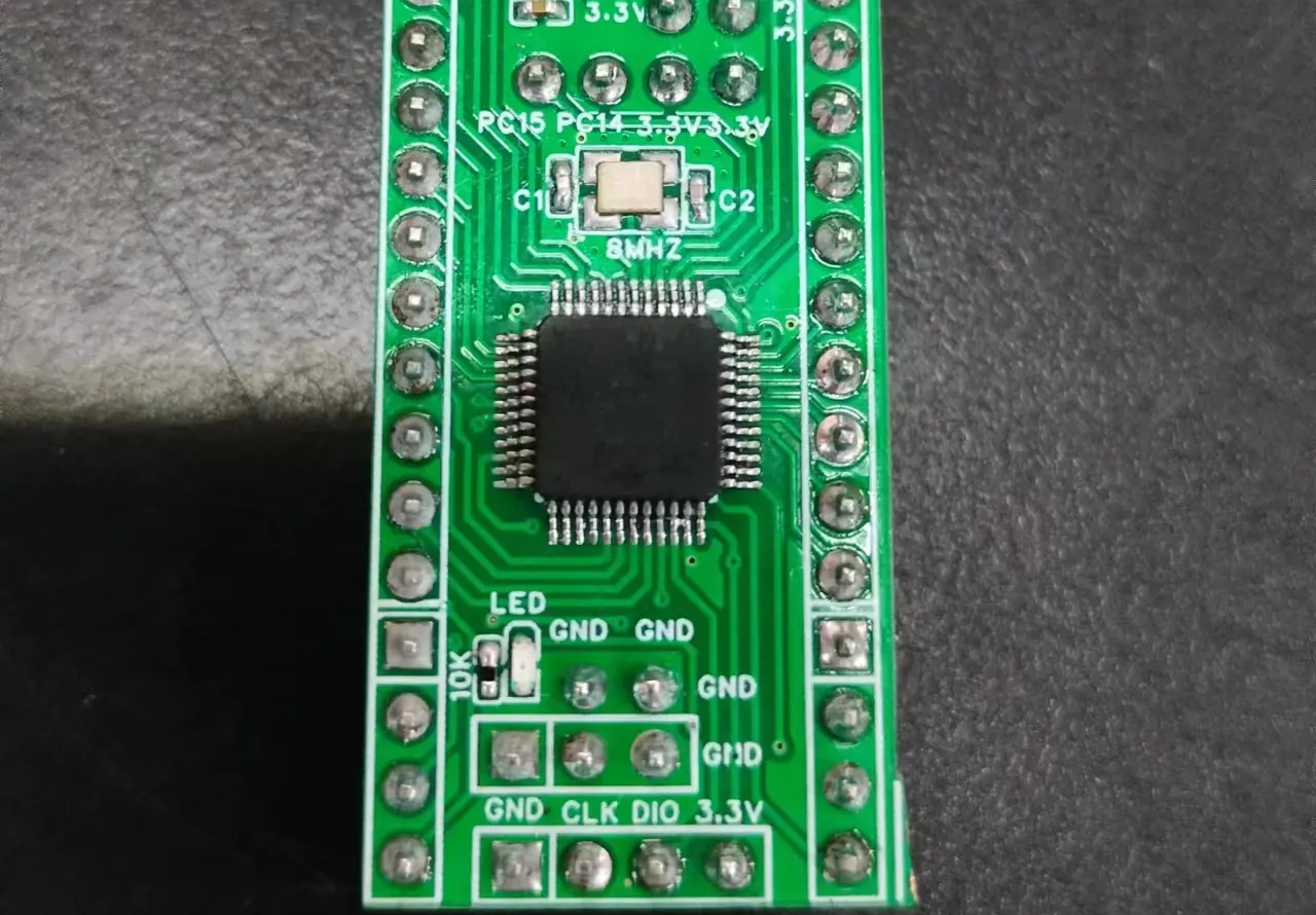

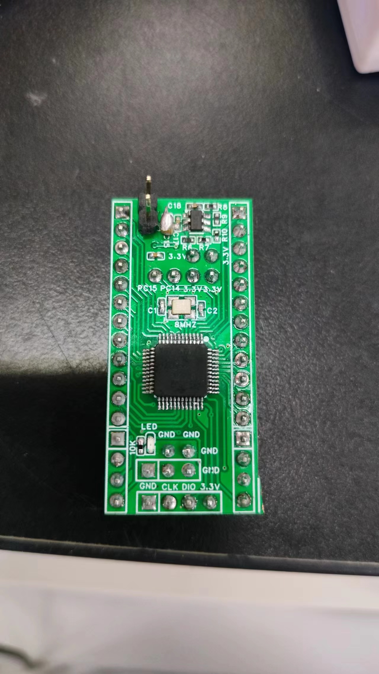

STM32 minimum system board, small size integrated switching power supply
This minimum system board uses the TPS54308 switching power supply chip to achieve a small-size switching power supply without diodes. While small, its performance is relatively poor. The system board is only 42mm long and 20mm wide, theoretically achieving a maximum input of 24V and an output of 2A (actually, the maximum measured input is 10V; increasing the voltage causes a decrease in power supply efficiency and heat generation, which is inconsistent with the datasheet, possibly indicating a problem with my board). The power chip requires 8V to start the switching power supply. After starting, it will shut down the output when the voltage drops below 7.2V. Theoretically, the switching current at this point is 2µA, essentially negligible. This suggests that using a 2s lithium battery would effectively protect the battery from over-discharge. To further reduce size, a 662k linear regulator is used to power the 32-bit microcontroller. Due to size limitations, the load power cannot be too high. Reverse connection protection and soft-start circuitry are not included; these can be designed separately if needed. I will also optimize this circuit board when I have free time. This board is for learning purposes. Note that its 5V output capability is relatively poor; do not connect it to high-power devices. The recommended operating current is below 0.5A, with an instantaneous current of around 0.8A being preferable. The power input is located at the top left corner of the board. Due to size constraints, I used 2.54mm pitch headers, and no power inductor was used. This may result in some instability. Note that this board was designed during my first year of university, and I have since optimized it. Therefore, many parts of the schematic do not correspond to the PCB. The BOM (Bill of Materials) is not suitable for this PCB. Due to space limitations, the power supply values ​​are not marked on the PCB. When soldering, you can select the appropriate resistors and capacitors based on the values ​​in the schematic.
Comparison of the board and pico:
Board images (my board is a first version; the input capacitors use advanced millimeter-level 3D stacking technology because I didn't have the same model available):

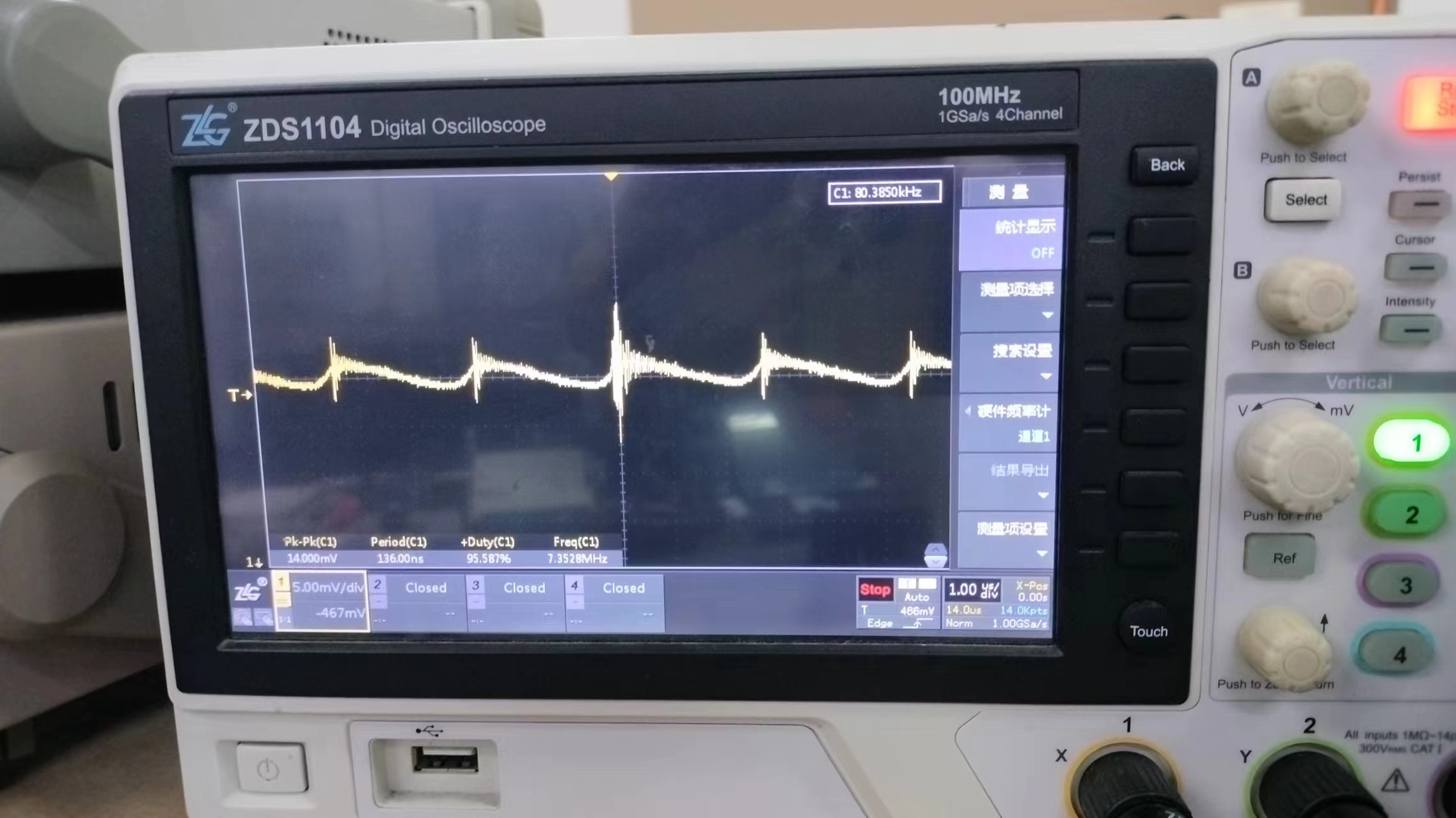

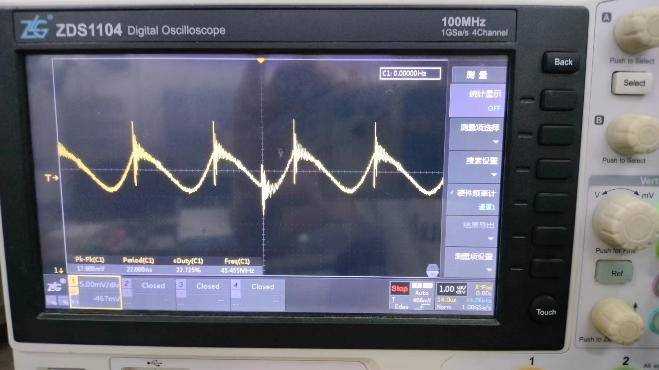

Ripple test (I didn't use the correct ripple testing method, and only later discovered that the probe used 10x attenuation, which I didn't notice during testing; I was wondering why the ripple was so good. I used alligator clips for ground return, so this only gives a rough estimate):
8V 0.2A switching power supply output ripple approximately 140mV
; 8V 0.5A switching power supply output ripple approximately
148mV; 8V 0.2A switching power supply output ripple approximately
176mV; 8V 0.2A LDO output ripple approximately 256mV; 7.4V

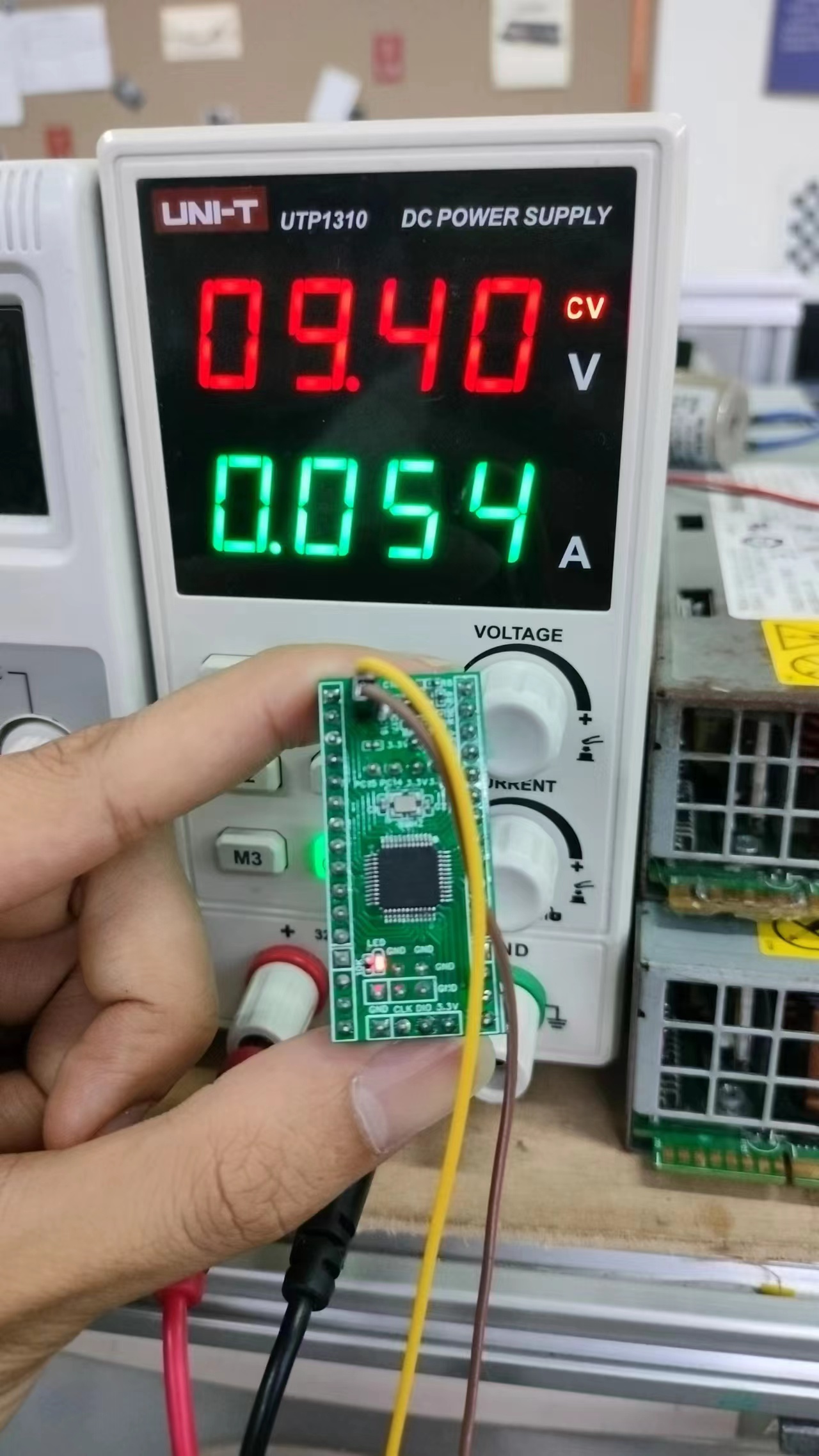

no-load current;
9.4V no-load current;

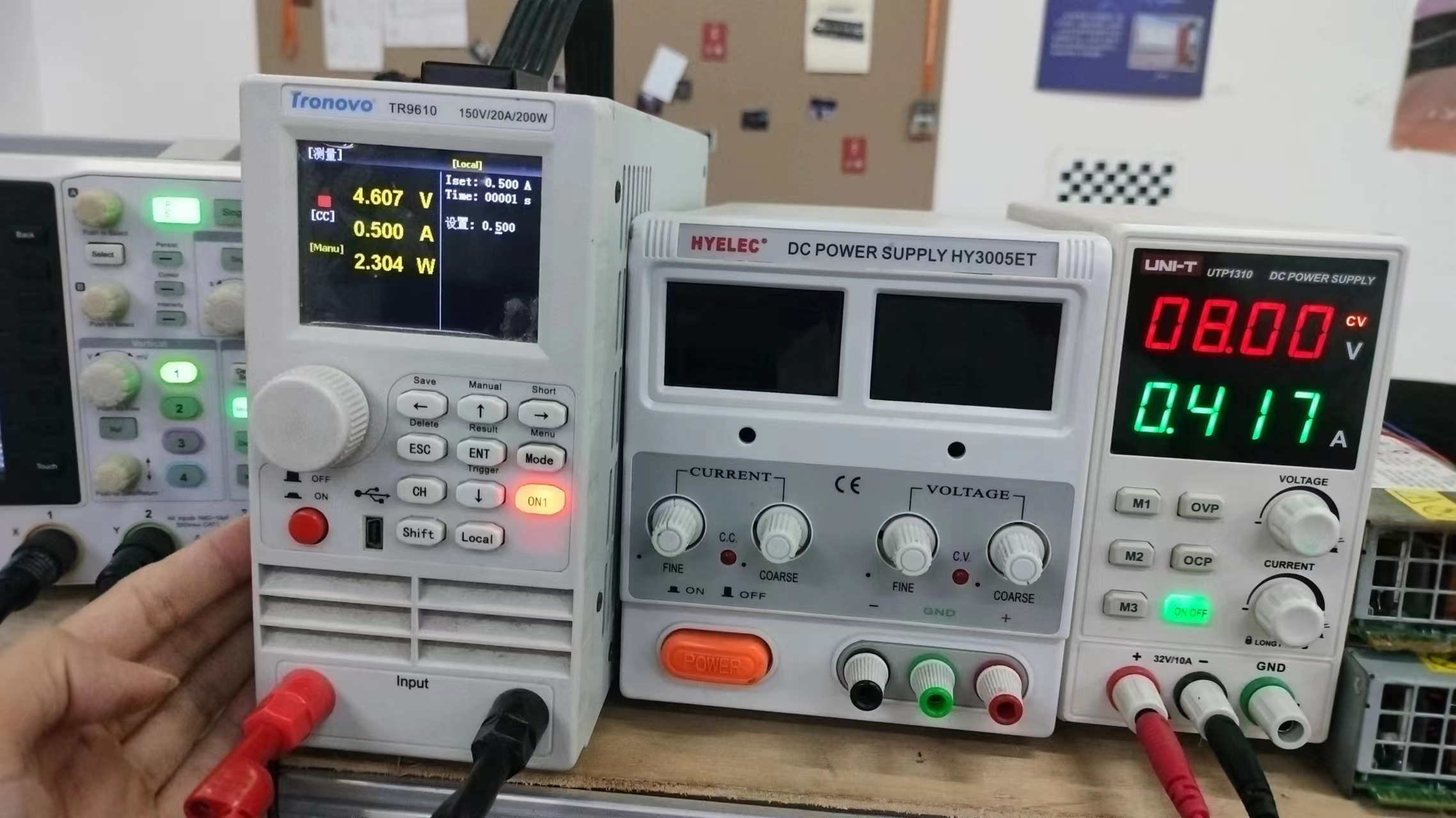

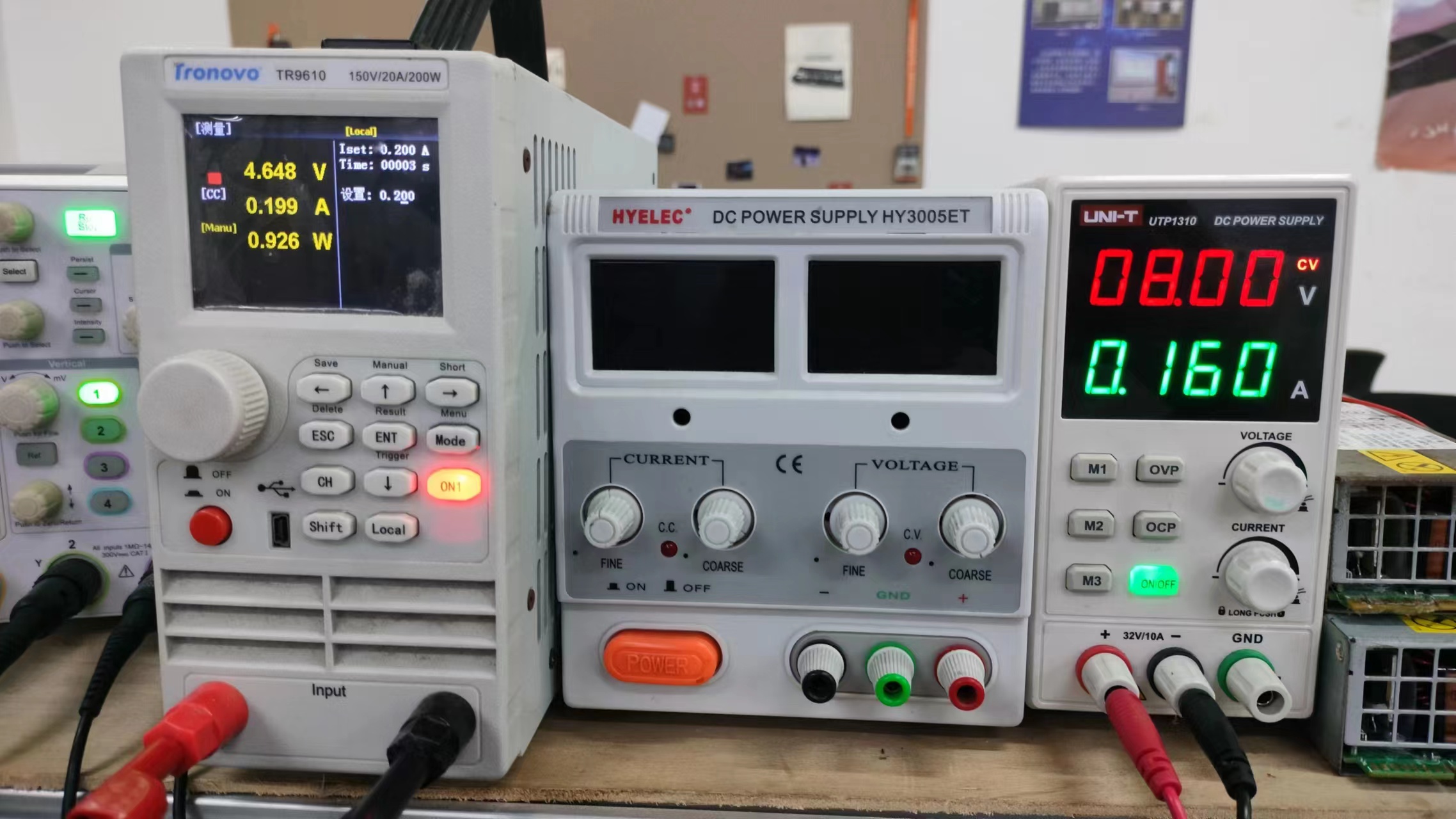

8V 0.2A load (efficiency approximately 72.3%);
8V 0.5A load (efficiency approximately 69%).

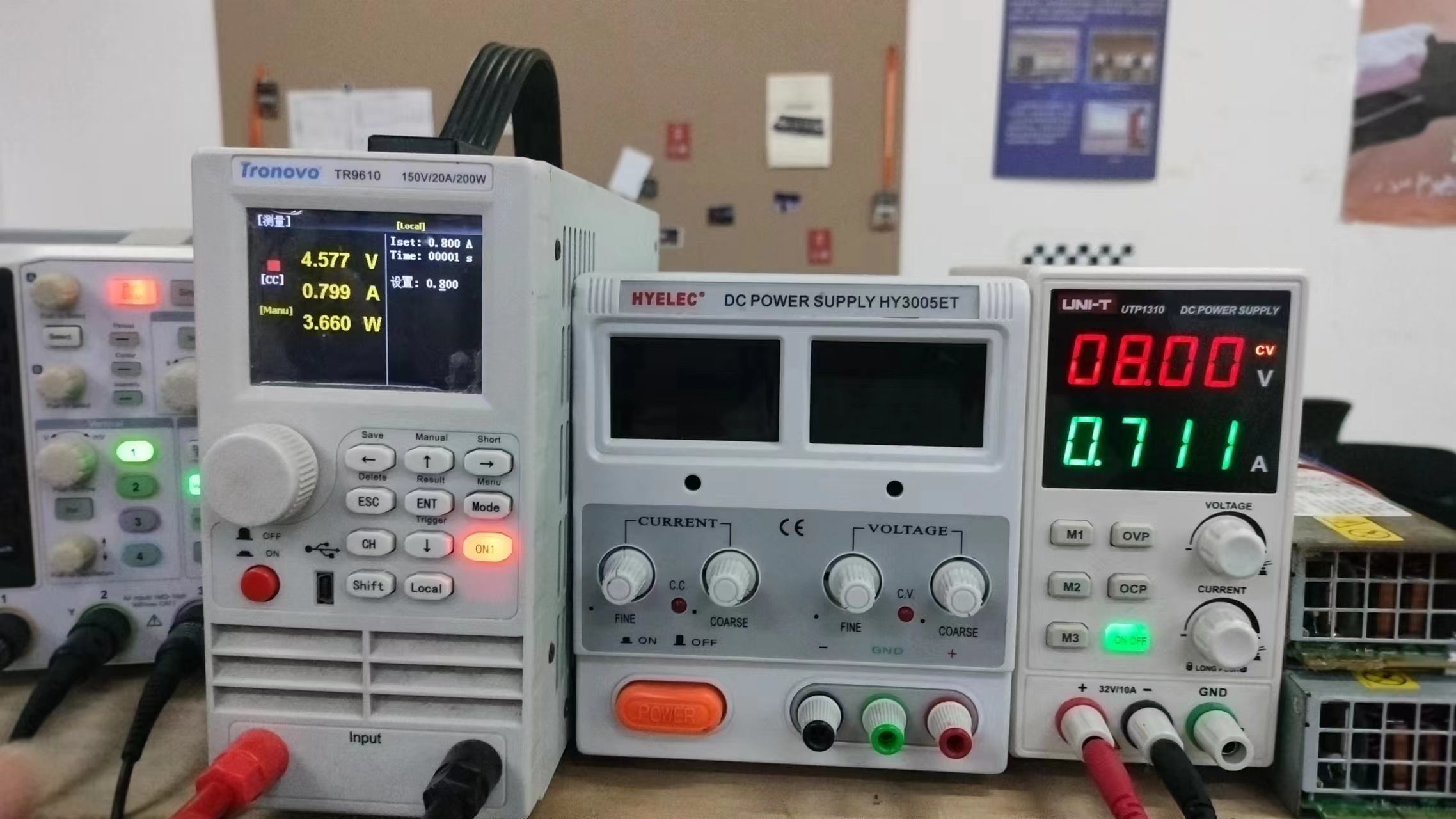

8V 0.8A load (efficiency approximately 64.6%):

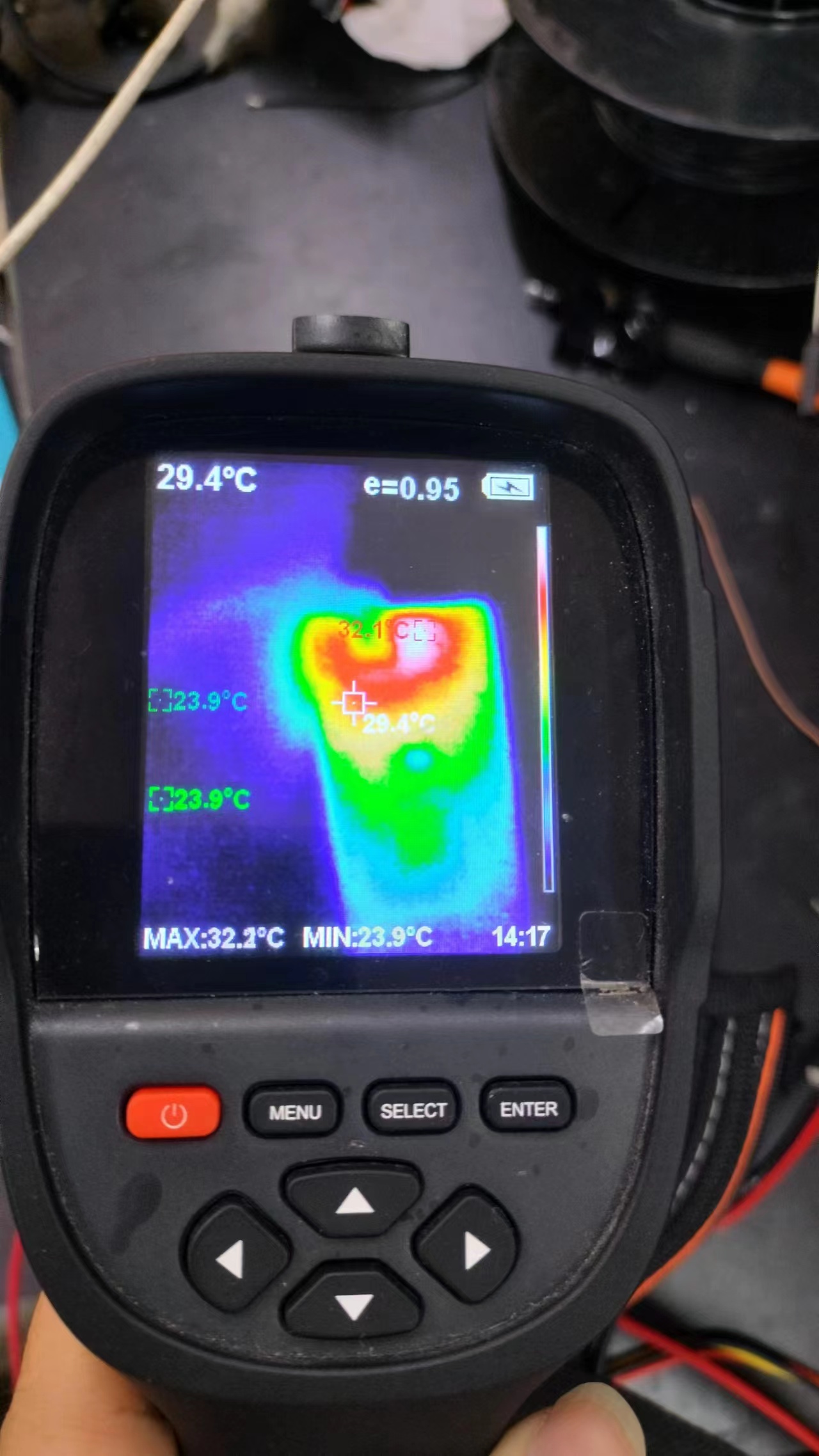

The following are the board tests (all images were tested under natural heat dissipation conditions at room temperature of 24 degrees Celsius):
First, the board's heat generation was tested. The following is a thermal image of the
board after 10 minutes of no-load operation, with a temperature of approximately 32 degrees Celsius. After 5 minutes of 0.2A load operation, the temperature was approximately 42 degrees Celsius.
After 5 minutes of 0.4A load operation, the temperature was approximately 63 degrees Celsius.

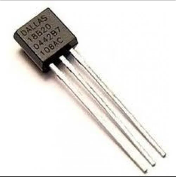

2. The DS18B20 temperature sensor is used for temperature acquisition. The DS18B20 is a single-bus digital temperature sensor with advantages such as small size, low power consumption, and high accuracy. Its working principle is to detect temperature changes by measuring the resistance change of a thermistor, and then convert the temperature value into a digital signal output. In this project, we connect the DS18B20 to the I/O port of an STC32 microcontroller, which reads and processes the temperature value.

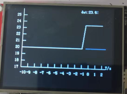

3. Temperature display uses a 2.8-inch TFT LCD screen to display the temperature value and line graph. TFT LCD screens have advantages such as vibrant colors, clear images, and wide viewing angles. Their working principle is to control the rotation angle of liquid crystal molecules through thin-film transistors to achieve image display. In this project, we connect the TFT LCD screen to the SPI interface of the STC32 microcontroller. The microcontroller reads the DS18B20 temperature data, processes and displays it according to the current time, and confirms the coordinates by sequentially marking points on the screen to obtain the line graph.
