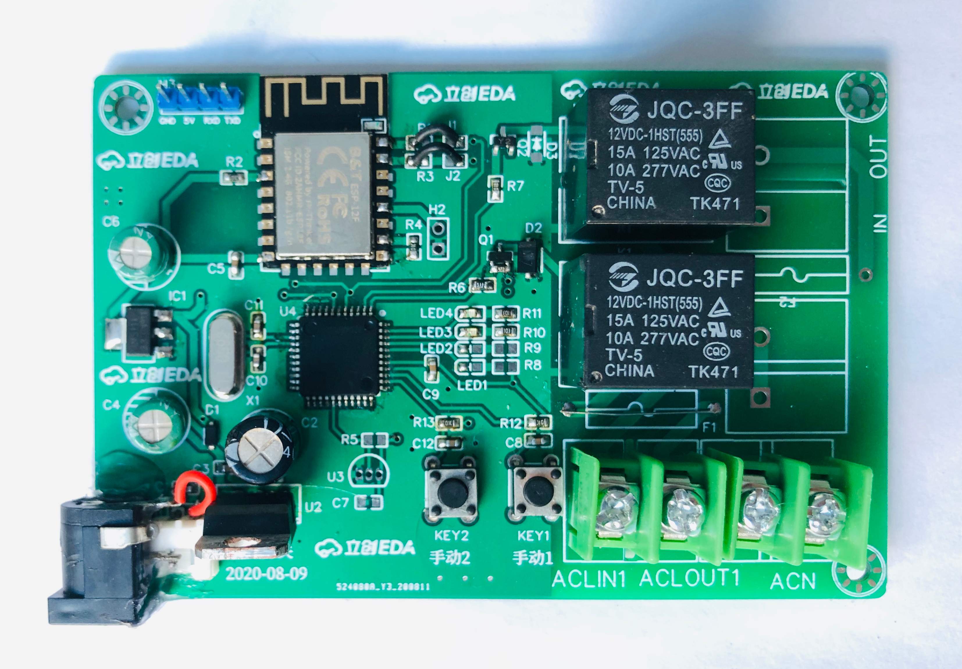

This is the latest version of the WiFi switch, which is directly connected to the mains and uses the HTTP protocol.
WiFi switch design ideas
Video demonstration address https://www.bilibili.com/video/BV1TT4y1L7Ji/
Preface
The principle of this WiFi switch is to use the microcontroller to send AT commands to the esp8266 WiFi module to initialize and connect to WiFi, and then the microcontroller continues to send commands to connect to the server. After that, the microcontroller keeps sending GET commands to read the data stream, and the microcontroller receives the data returned by the server through the serial port. flow, and then determine the data flow and whether an instruction to turn on the relay has been issued. The connection is to the onenet cloud platform, which uses the HTTP protocol . Only by continuously sending GET instructions through the microcontroller can the instruction to turn on the relay or turn off the relay be issued.
1. Use STC89C51 or STC12C5A60S2 microcontroller, which is based on the 51 core (other microcontrollers cannot use it). I just wanted to use the stc15f104w microcontroller, which has 8 pins. After searching, I found that there is no serial port register, so I gave up. Finally, I chose 12c5a60s2, which I just had on hand. one. Using an external crystal oscillator of 11.0592MHz, the baud rate communication error is 0.0%.
2. Use the esp8266 wifi module (the existing module on hand). After continuous study and research, I finally know how to download the firmware of e sp8266 (use the ch340 serial port to download, which is very convenient. Pull the GPIO0 pin low to download), and then use the serial port The software tried the AT command and it worked normally. The test can be used as an AP and can also be connected to WiFi. This circuit diagram is copied directly from the adapter board and can be used normally. It should be noted that the EN pin must be pulled up for the module to work.
3. Plan to use a relay as a control component, because the relay can be used for both DC and AC, and the drive is simple. It requires a triode, a freewheeling diode and a bias resistor. This circuit is designed to control incandescent light bulbs. If you simply control DC power, you can use high-power MOS or triode (voltage withstand issues need to be considered). Let’s talk about why PNP transistors are used. The reason is that the IO port outputs a high level when the microcontroller is powered on and reset. If NPN is used, such an instantaneous relay may cause malfunction, which is not very safe, so use PNP transistors. B The base is connected to a low level to conduct. It should be noted that the two pins of the relay coil must be added with freewheeling diodes to protect the triode ( here I used a PNP triode without adding a bias resistor at the base and used a 1K resistor. I wrote a simple program to test and found that the relay could not be turned off. Later, after constant testing, After checking, I added a 4.7K pull-up resistor and increased the base resistor to 50K to switch normally ). The following is why a freewheeling diode is added—————————————————————— This is because when the switch is turned off, the inductance ( the relay coil is an inductor ) will generate The very high voltage far exceeds the power supply voltage. Ordinary electromagnetic relays can be driven by general-purpose transistors such as 8550 or 8050. The maximum withstand voltage of the collector-emitter is only a few dozen volts. When the control switch is turned off, since the current in the inductor cannot mutate suddenly, a reverse electromotive force with upper negative and lower positive polarities will be generated. This electromotive force voltage is extremely high and will directly break down the collector-emitter of the transistor, causing the relay to fail to turn off normally. The relay uses 12v10A current, drives the relay through ss8550 ( PNP ), adds a freewheeling diode 1n4007, and adds a suitable fuse to the high current end of the relay to ensure that the overcurrent contacts of the relay are not burned.
4. The power supply plan uses a 12v external DC power supply to power the entire system ( the on-board USB power supply is not considered, because I control the light, and the relay is 12v, USB power supply is completely unusable. As for program download, use External USB to TTL module ), using the 7805 voltage regulator chip to provide a stable voltage to the microcontroller (after testing, the 7805 can work stably without adding a heat sink). A 1N5819 diode is added behind the 7805. Its function is to provide a stable voltage to the WiFi module. When testing the power supply alone, do not supply power to the superior 7805. 7805 also supplies power to AMS1117-3.3V. The purpose of this design is to reduce the voltage difference and reduce the heat generated by 1117. After all, the current of the WiFi module is also very large when working in AP mode.
5. Two buttons are reserved, which are planned to be used to manually open and close the relay when the mobile phone is away or disconnected from the network. Of course, other functions may be developed later. The buttons are designed with a hardware debounce function ( thanks to the 104 capacitor ), so that there is no need to set a delay detection in the microcontroller. This is also the first time to use hardware debouncing. The actual effect will be tested later. If the effect is not good, the software debouncing function will be added.
6. Four LED indicators are reserved, one is used as an indicator for normal operation of the microcontroller (0.5s flashing period), one is a WiFi connection indicator (always on when connected to WiFi), and the remaining two are used for relay status indication. Or if you have any new ideas in the future, please expand it (currently only one LED is used, and LED4 lights up to indicate that the program has completed sending the initialization AT command).
7. Use an 11.059MHz crystal oscillator so that the error is small when the baud rate is 115200. There will be no garbled characters during serial communication.
8. The microcontroller firmware uses the burning software stc-isp from the STC official website (upload and download method after the program is completed and tested)
9. There is also a DS8B20 temperature sensor left on the board. Consider sending the data to the mobile APP for temperature detection.

After connecting in this way, remove the serial port cable and supply 12v DC to the board. When you click the switch on the mobile phone, you will generally hear the sound of the relay closing.
At present, I have only debugged one relay.
2020-8-21
The new 5v power module I bought today has arrived, but the printed board is still being processed in the factory. Maybe the new version cannot be uploaded. Please take a look at the power module.
There is also a blueprint for a new version of the design
The latest version adopts the original double-sided design to reduce the overall size of the board and can be used directly connected to the mains power supply! It is very convenient to control electrical appliances.
