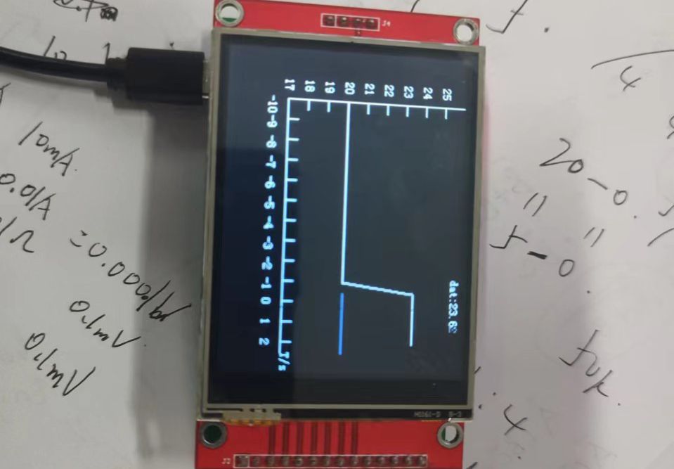

The overall system design of this project uses an STC32 microcontroller as the core controller. A DS18B20 temperature sensor detects the ambient temperature, transmits the data to the microcontroller for processing, and then displays the temperature value on a 2.8-inch TFT LCD screen, plotting a line graph of the temperature change over time. A DS1302 microcontroller records the time. For power supply, a Type-C charging interface provides direct power. Considering power outages, a lithium battery is used as a backup power source, charged by a TP4056 charging chip. A P-channel MOSFET is used for power switching, and an RT9193 converts the power to 3.3V to power subsequent circuits. A passive buzzer is also included to alert the user.
1. The main controller uses an STC32 microcontroller as the core controller. Domestic chips are relatively inexpensive, suitable for low-cost applications. They also have a relatively complete Chinese manual, with detailed explanations of virtual serial port and SPI communication used in this project, making development easy and suitable for beginners.
2. The DS18B20 temperature sensor is used for temperature acquisition. The DS18B20 is a single-bus digital temperature sensor with advantages such as small size, low power consumption, and high accuracy. Its working principle is to detect temperature changes by measuring the resistance change of a thermistor, and then convert the temperature value into a digital signal output. In this project, we connect the DS18B20 to the I/O port of an STC32 microcontroller, which reads and processes the temperature value.
3. Temperature display uses a 2.8-inch TFT LCD screen to display the temperature value and line graph. TFT LCD screens have advantages such as vibrant colors, clear images, and wide viewing angles. Their working principle is to control the rotation angle of liquid crystal molecules through thin-film transistors to achieve image display. In this project, we connect the TFT LCD screen to the SPI interface of the STC32 microcontroller. The microcontroller reads the DS18B20 temperature data, processes and displays it according to the current time, and confirms the coordinates by sequentially marking points on the screen to obtain the line graph.
4. Time is achieved using a DS1302 clock chip. The DS1302 is a trickle-charged clock chip from Dallas Semiconductor. It contains a real-time clock/calendar and 31 bytes of static RAM, and can communicate with a microcontroller via a simple serial interface. It features a simple 3-wire interface, and the real-time clock calculates seconds, minutes, hours, date, month, day, week, year, and leap year compensation valid until 2100. It supports battery-powered general-purpose RAM, operating from 2.0V to 5.5V, using less than 300nA of current at 2.0V. The end-of-month date is automatically adjusted for months with fewer than 31 days, including leap year corrections. The clock runs in 24-hour or 12-hour format, and the AM/PM indicator uses synchronous serial communication, simplifying the interface between the DS1302 and the microprocessor. Alternatively, the internal RTC real-time clock of the STC32 can be used, requiring an external 32.768kHz crystal oscillator.
While a Type-C power supply is used directly, a lithium battery is added as a backup power source to prevent power outages that would disable the entire system and lose time data on the DS1302. A TP4056 charging chip is used for charging, and a P-channel MOSFET is used for power switching. The output voltage is converted to 3.3V by an RT9193 power conversion chip to power the subsequent circuitry.
The RT9193 is an LDO linear regulator with a 300mA output current, ultra-low noise, and fast adjustment. At full power (300mA) output, the voltage drop can be as low as 220mV. Its input voltage range is 2.2V to 5.5V, and its output voltage is 3.3V. It features overcurrent and short-circuit protection. The RT9193 uses an SOT23-5 package.
Circuit Design Summary: In this project, we used advanced components such as a temperature sensor, LCD display, clock chip, and power management chip. Through reasonable circuit design and software programming, we achieved the functionality and coordinated operation of each component. Specifically, we used a DS18B20 temperature sensor to detect the ambient temperature, a 2.8-inch TFT LCD screen to display the temperature values ​​and line graphs, a DS1302 clock chip to record time, and a lithium battery for power supply and a TP4056 charging chip for charging management. Through the coordinated operation of these components, we successfully implemented the functions of detecting, displaying, and recording ambient temperature.

1. Designed and implemented an ambient temperature detector capable of accurately detecting the surrounding ambient temperature, displaying the temperature value, plotting a line graph, and recording time.

Final Product Showcase:
Code is attached.
