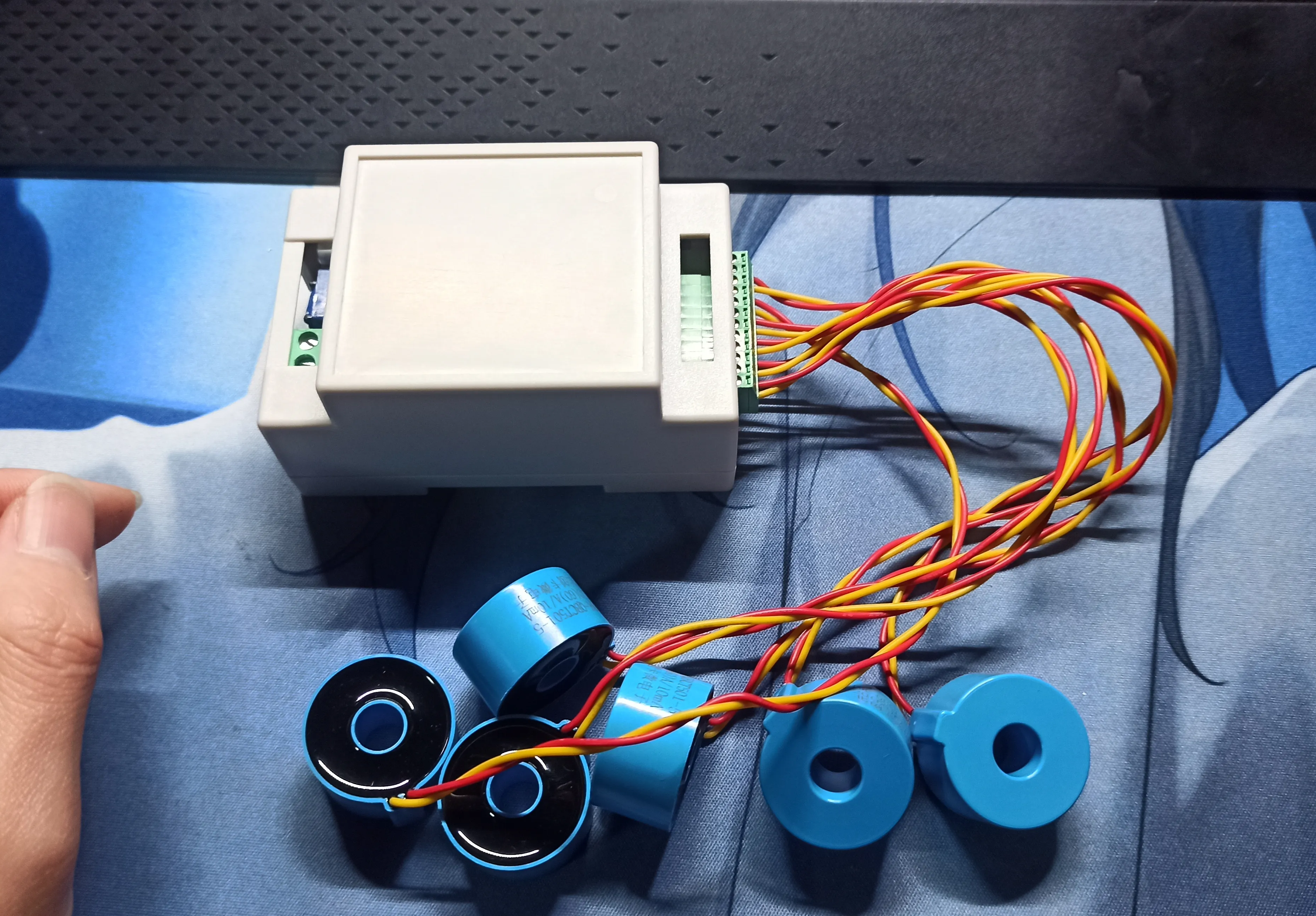

WIFI Multi-channel Power Meter (bl0906+esp8266) All-in-one Version
Modify the original project to directly integrate the 8266, requiring only one board and making it easier to use for free.
Considering space constraints after integration, replace the power module with a Prida one. Since
I had a Prida 5V module on hand, I added an LDO circuit. If you purchased a 3.3V module, you can remove the LDO section.
Change the voltage transformer divider resistor from 2010 to 0805; testing showed no problems.
You can replace the 8266-12F with a C3-12F for potentially better performance and Bluetooth support. If you're concerned about signal strength, you can add an IPX connector to the C3F to connect an external antenna.
The ESP8266-12F can be replaced with an ESP07s;
the procedure for connecting an external antenna is the same as the original project, but please modify the serial port to tx:5, rx:4.
