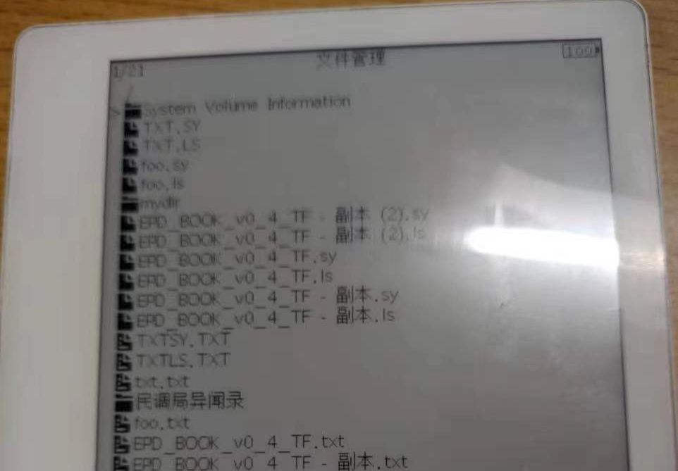

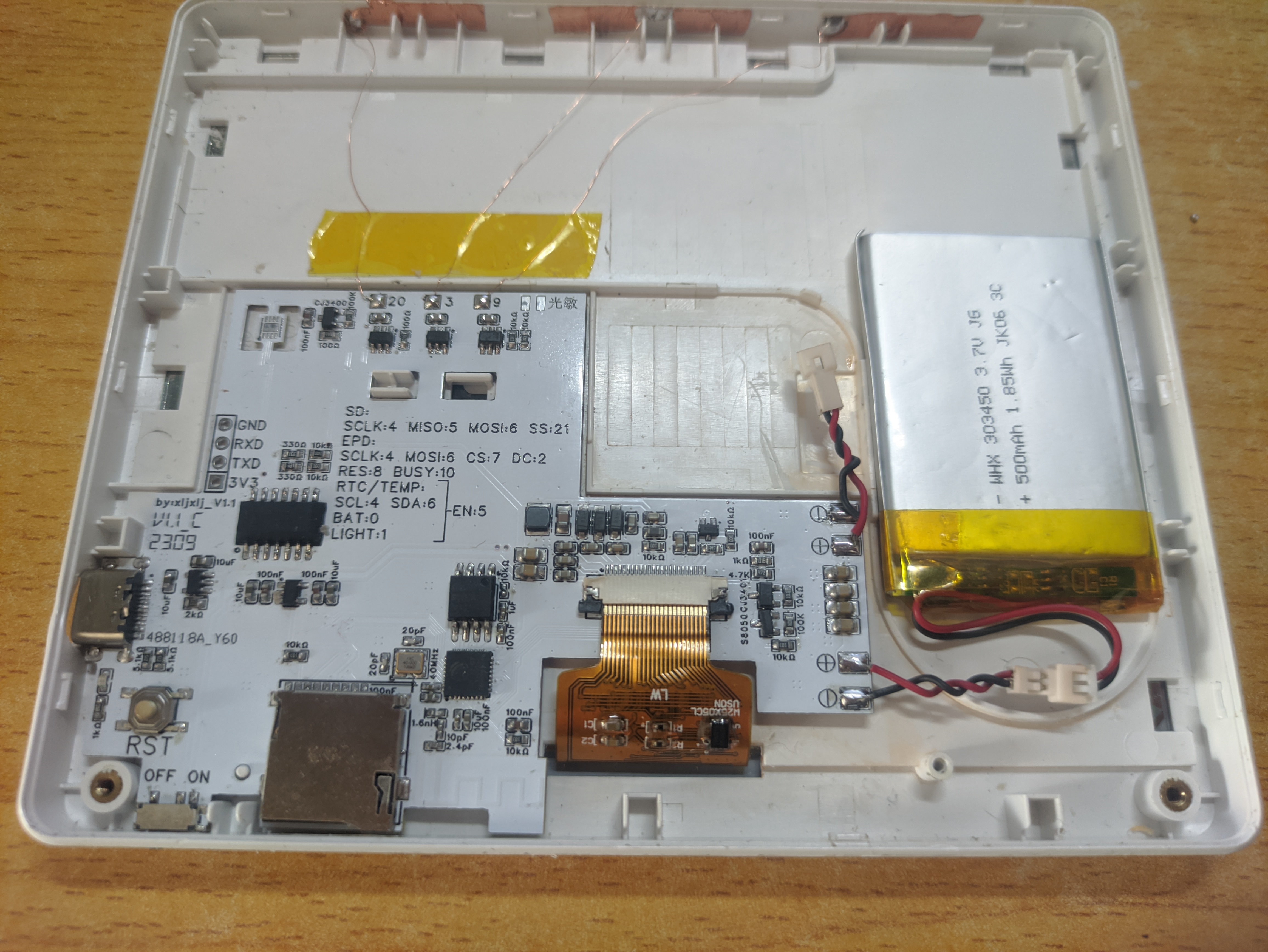

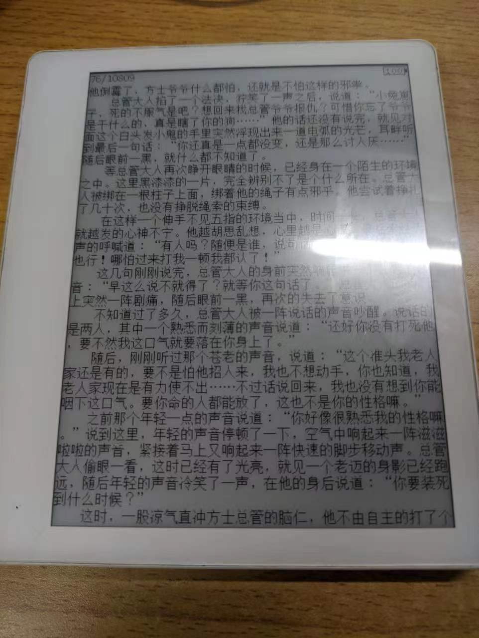

5.83-inch E-ink screen driver board

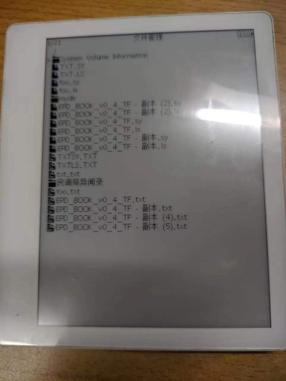

The 5.83-inch monochrome e-ink screen driver board, priced at 20 yuan
, is based on the ESP32 C3. The I/O multiplexing is based on
two versions of an e-ink reader: one is a module, and the other is a bare chip,
including the RX8025T RTC, SHT40 temperature and humidity sensors, SD card and battery level detection, and a photoresistor.
Components without silkscreened parameters in the e-ink driver area need to be removed from the original driver board; they are in their corresponding positions and can be directly moved over.
Currently, it seems to work without problems; the e-ink screen drives normally. Other peripherals cannot be tested yet because there is no program, but since they are connected to the e-ink screen, they should theoretically not have any issues.
To save costs, the C3's built-in USB is used to download the program.

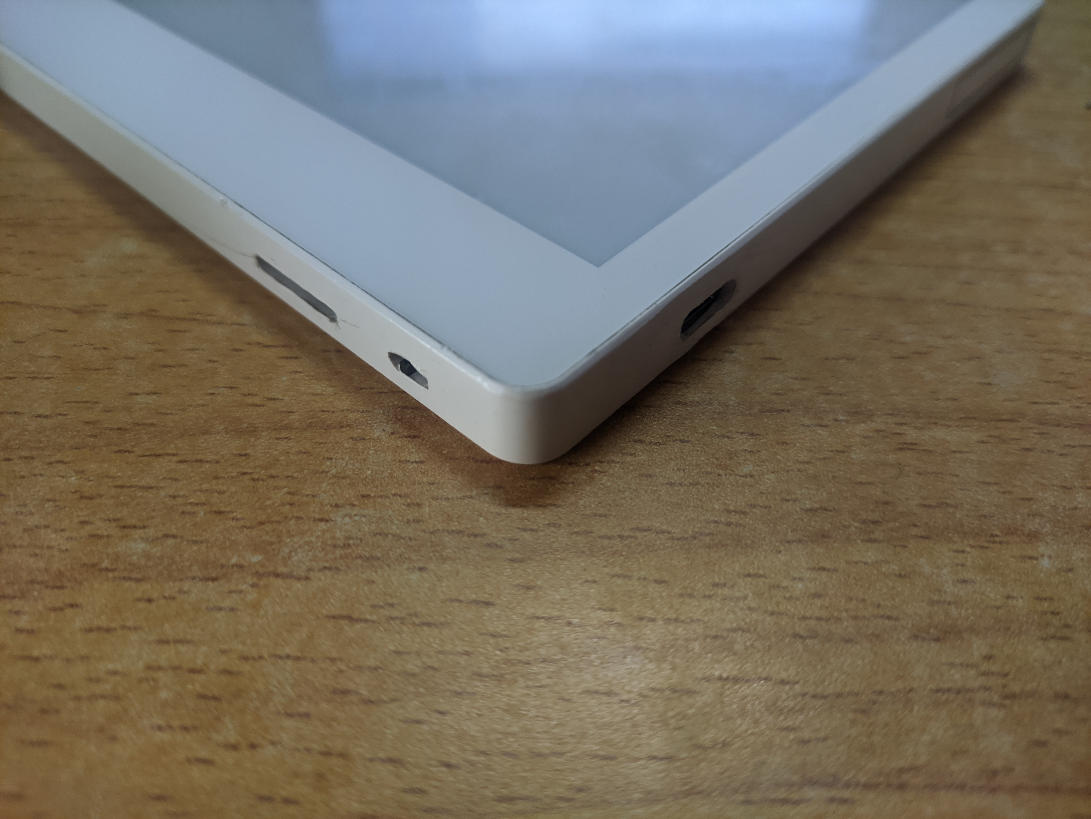

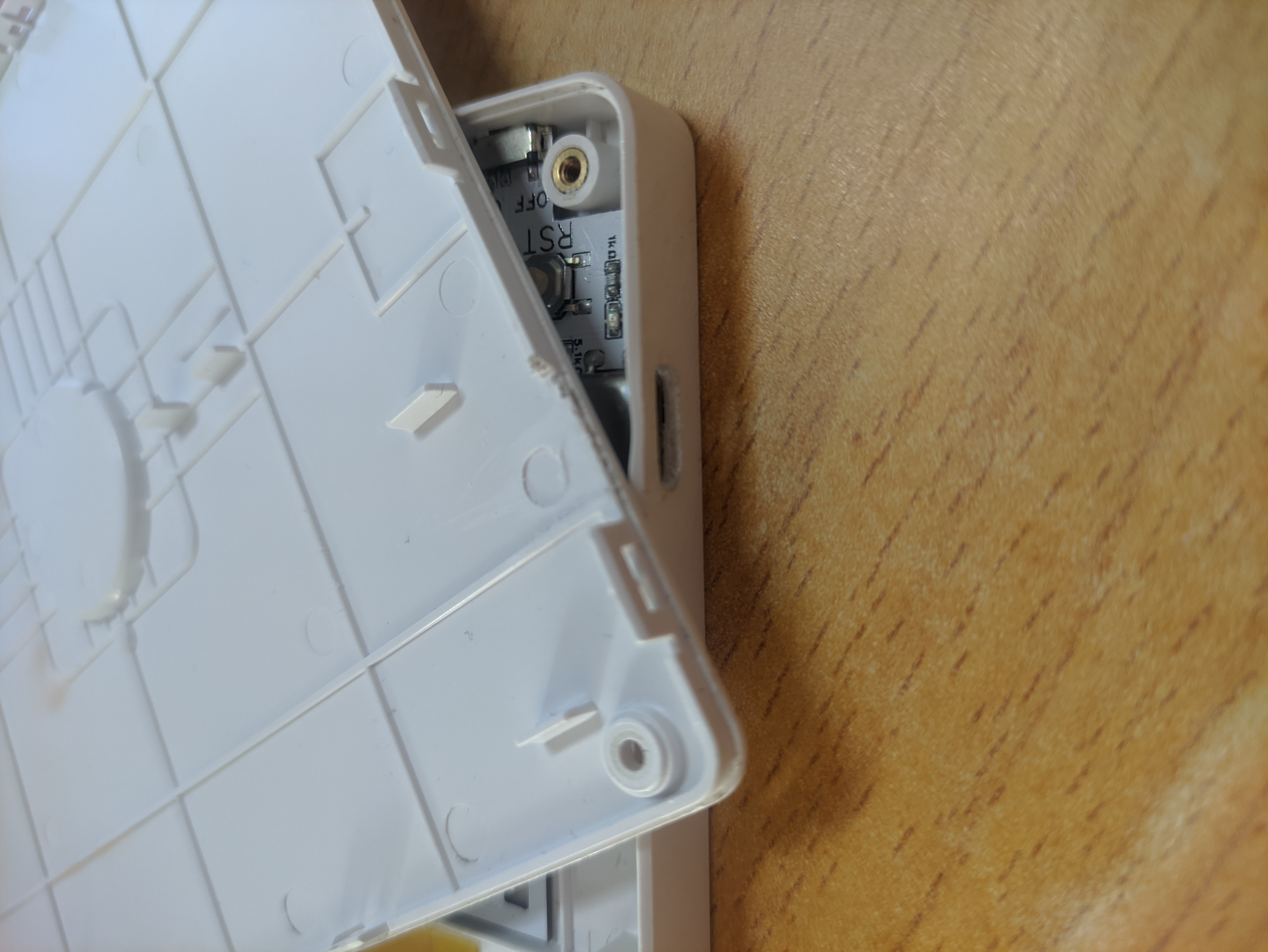

Drilling holes in the casing requires care (since you can't replace the casing if you break it). For the Type-C port, you can use a spare Type-C female connector; heat it with a soldering iron to create the hole (it's recommended to practice with spare plastic first).
The top cover of the USB-C port needs to be cut off slightly, otherwise the USB-C port will block it (see picture).
See the picture for the touch button handling.
The e-ink screen driver uses copper foil tape
. The board thickness is 0.8mm, and the RX8025 is installed by pressing it in, making sure its feet are parallel to the PCB, essentially sinking it slightly to prevent it from hitting the top.

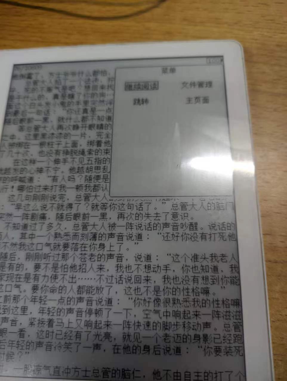

I'm currently writing the program, so my skill level is low and it will be very slow (I'm strongly hinting to the experts to adapt it quickly). The attachment contains an Arduino local flash library. The screen doesn't natively support local flashing; it's simulated. However, aside from using a little more RAM, the local flashing effect is almost the same as a screen that natively supports local flashing.
// 2023-05-07: Based on a heavily modified version of the workshop director's engineering e-ink screen TF card e-book source code, I've modified the open-source code to create a program that can read e-books. Compared to the original open-source code, it adds:
1. Battery percentage display (using a lookup table).
2. File manager.
3. Line breaks based on character width, ensuring no blank spaces at the end of even English lines.
4. Direct reading upon opening, with indexing built as you read (indexing progress is not saved; if the index is not complete before closing, it will return to the first page the next time you open it).
5. Updated index file format; no need to locate the index file, it reads directly (similar to the method used by Gancao).
6. Reading history is saved on the SD card, just like the index file (ebook filename.ls). (File), opening other files will not lose history (actually, I don't know how to use a wear leveling library like the one for licorice, and I'm afraid of writing to the internal flash, so I just put it on the card and let it level itself).
The program is in the attachment, and there may be a lot of bugs. You can send me a private message for feedback.
Tip: In version v1.1, the hardware cannot display the battery level. This has been fixed in v1.2. In version v1.1, some TF cards may not be able to display the battery level temporarily, but it doesn't matter. The program does not have a low-battery shutdown function. You can use a battery protection board for protection, or if you are skilled, you can add a 100R resistor to the PCB jumper wire of v1.2. (It is strange that on the same card, using a third-party SD library to set the SD MISO pin to output when the SD is not reading or writing can output a high level, but this library does not support Chinese file names. However, when I switch to the SD library in the ESP32 library, the TF card's MISO pin is pulled low, and the ESP32 output high level is limited by the TF card.)

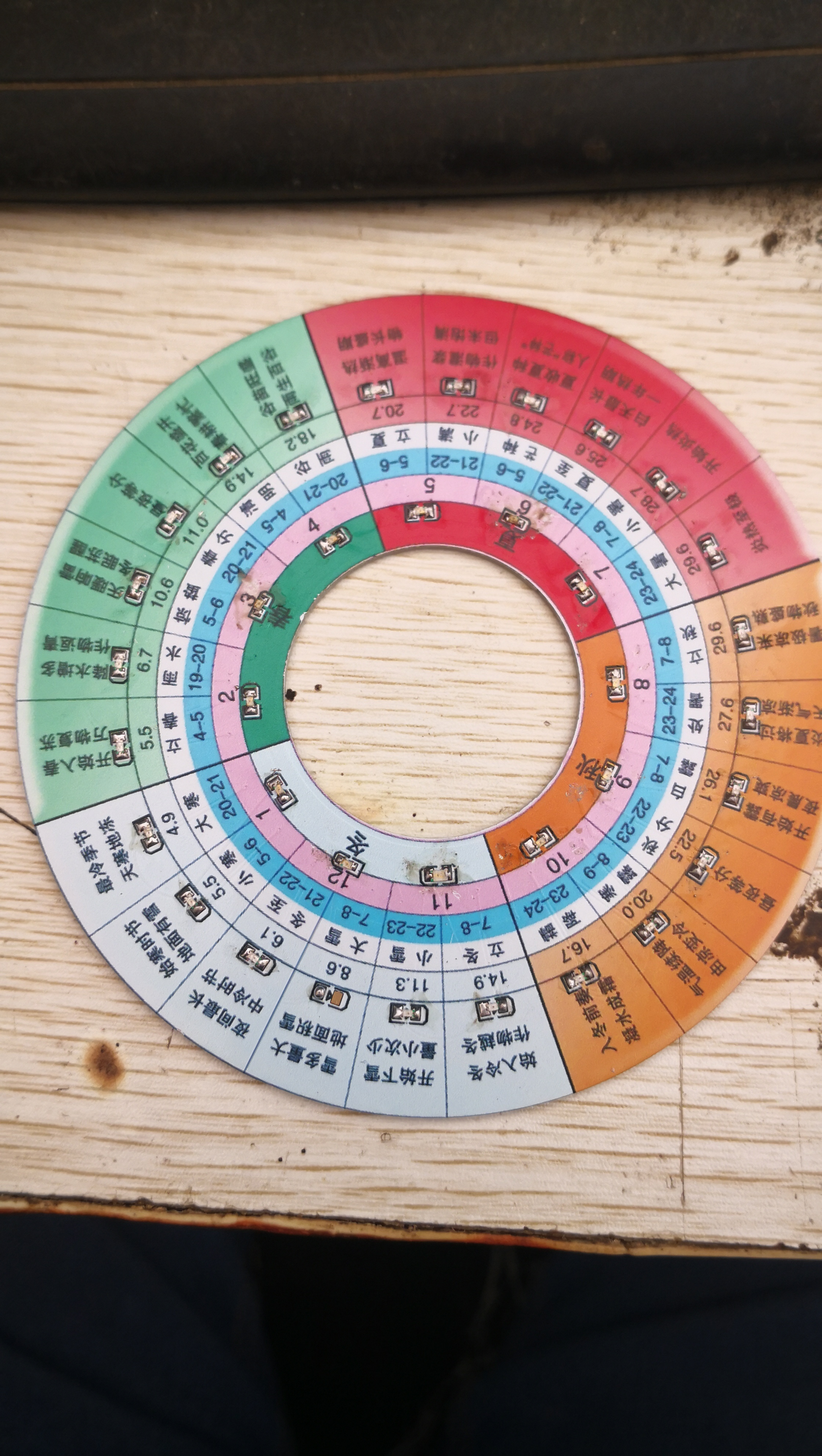

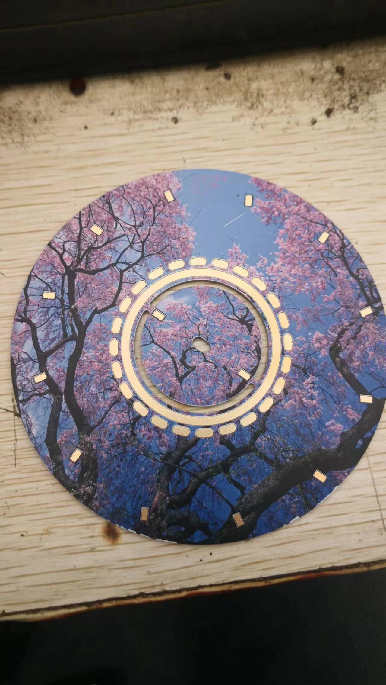

Solar Terms Spinner

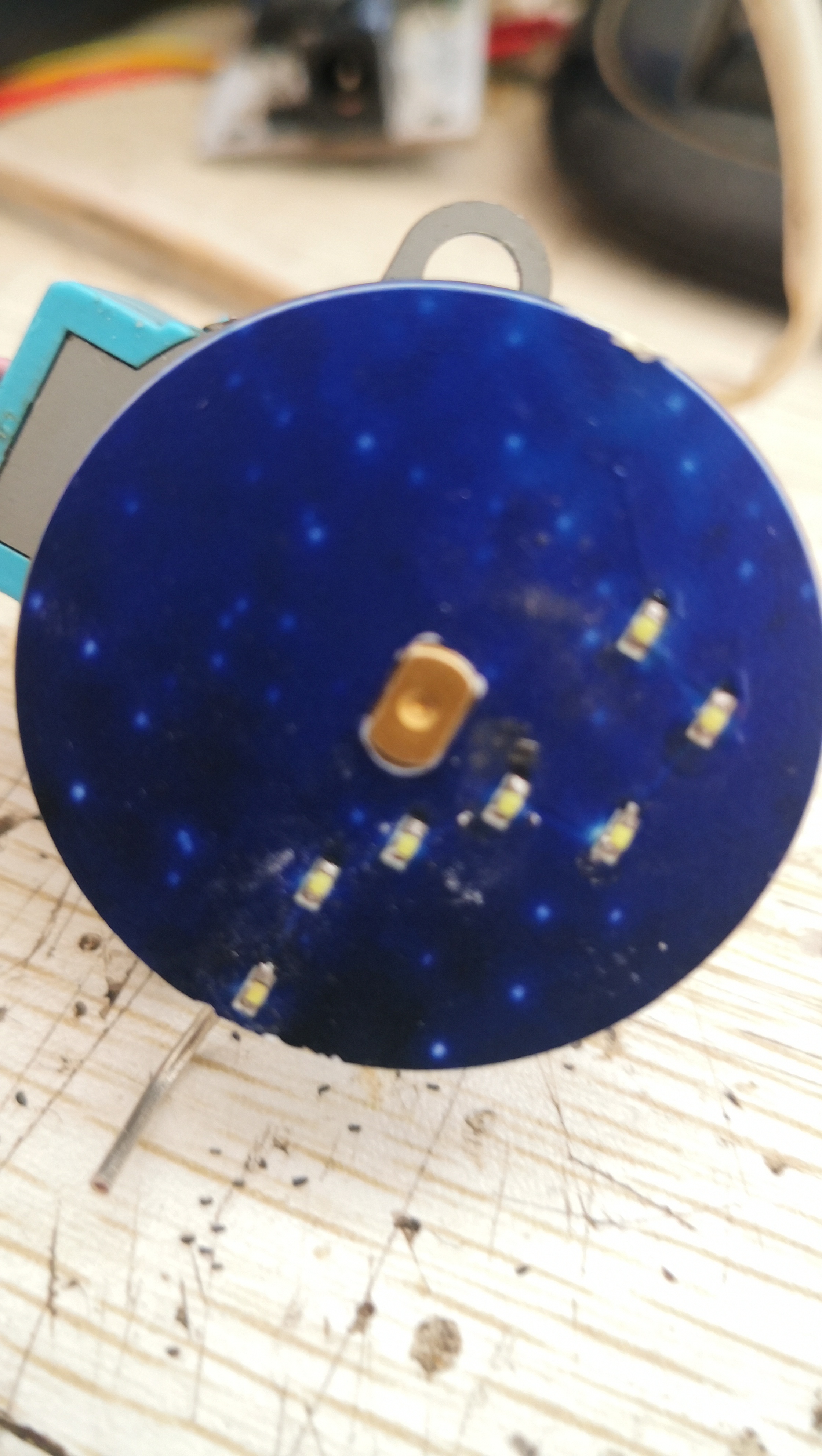

I was making a 24 solar terms chart. I originally planned to use a control panel, but I happened to see a color printing promotion from XILCIC, so I made a 100mm diameter circle to test the waters first.
I was making a 24-solar-term clock. I initially planned to use a panel, but then I saw a color printing promotion from SICHUAN, so I made a 100mm diameter circle to test the waters.
This is just a modular panel,
cut in the middle. A stepper motor drives the middle section, connecting it to the outside. The central circular plate connects to the outer circle via spring contacts, forming a circuit loop that illuminates the LEDs.
This first version uses nine LEDs connected in series; later versions will use parallel connections to reduce voltage.
