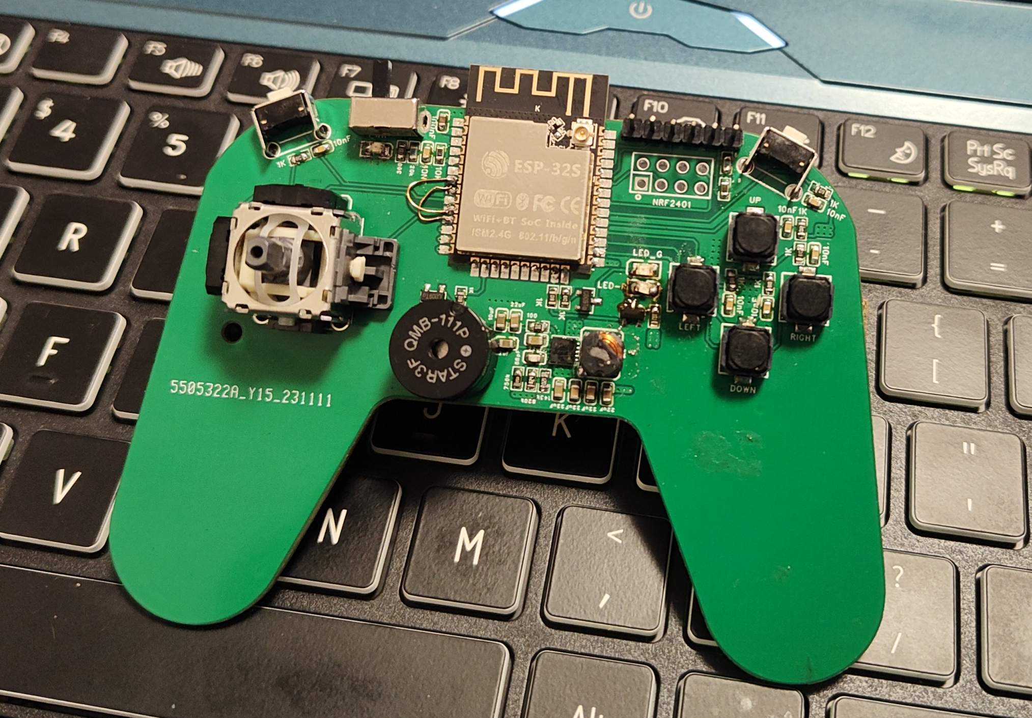

I made my own remote control with ESP-NOW communication and expandable NRF2401 communication. It will be convenient for making remote control cars, boats, or model airplanes in the future.
It's relatively simple, and the size is kept under 10cm, so you can easily build it at home with a free PCB. It
uses an 18650 power supply and a buck-boost chip to ensure a stable 3.3V power supply.
It has been successfully tested and a few minor issues have been fixed.
Feel free to leave a message if you have any questions.
