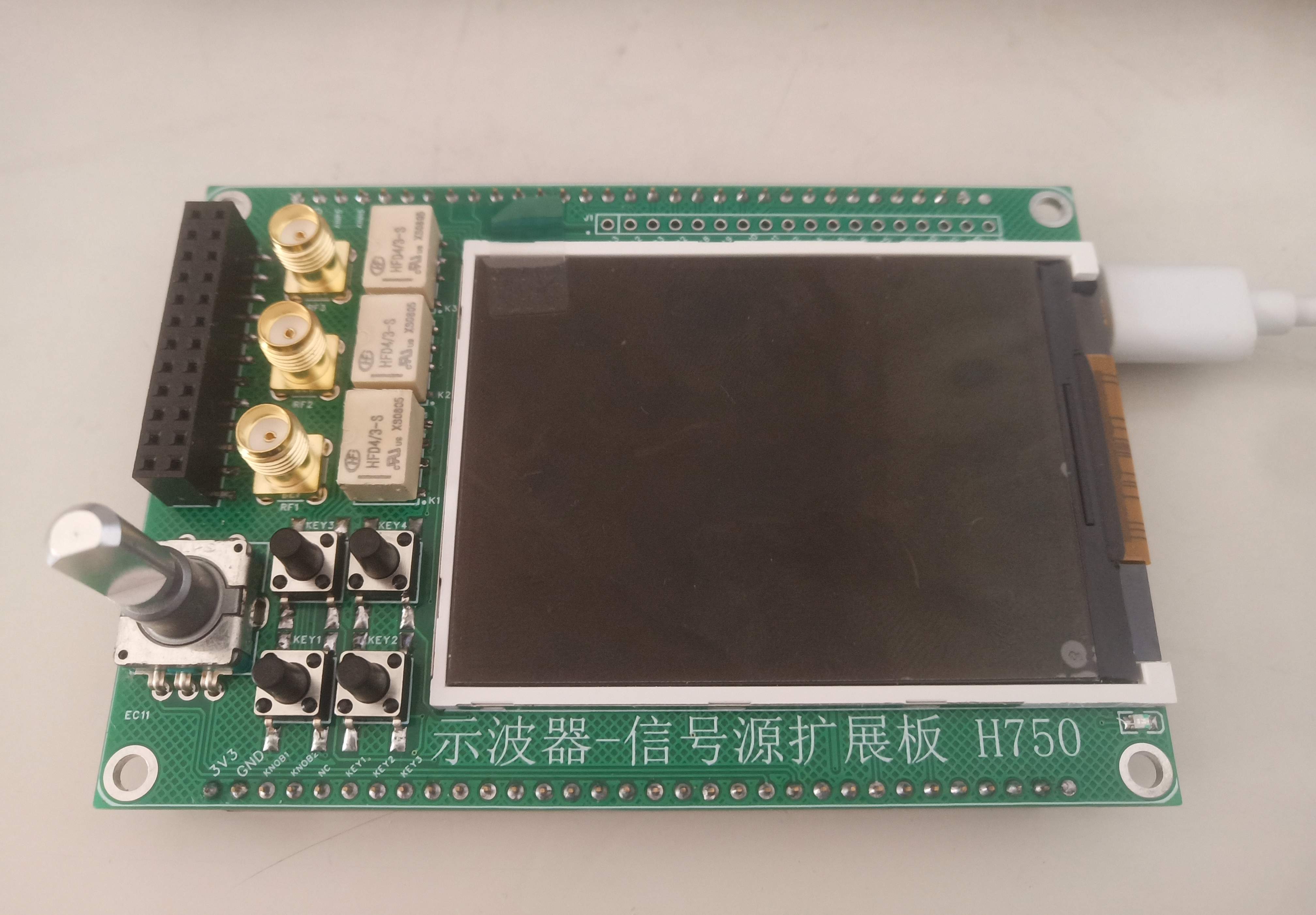

Oscilloscope - Signal Source Expansion Board (Hardwood Classroom AFE03)

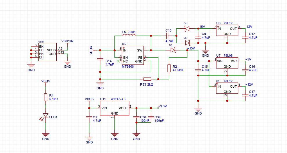

1. System Power Supply
: This project requires four voltage values: +5V, +3.3V, +12V, and -12V. The power supply uses a Type-C data line as the input and employs a boost converter chip MT3608 (input voltage 2V~24V, output current up to 2A) to convert the input voltage to +15V and -15V. The +15V is processed by a 78L12 to obtain +12V, and by a 78L05 to obtain +5V. The -15V is processed by a 79L12 to obtain -12V. As for the +3.3V, the classic AMS1117 is used to obtain it. (VBUS is +5V)

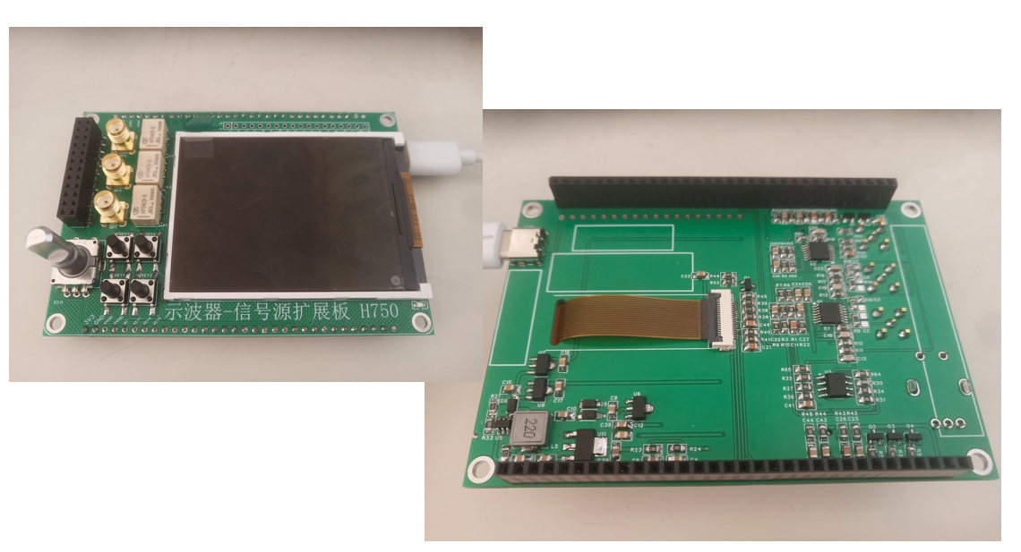

creating the physical prototype : https://www.bilibili.com/video/BV11Q4y1b7Ri]
参考设计图片
