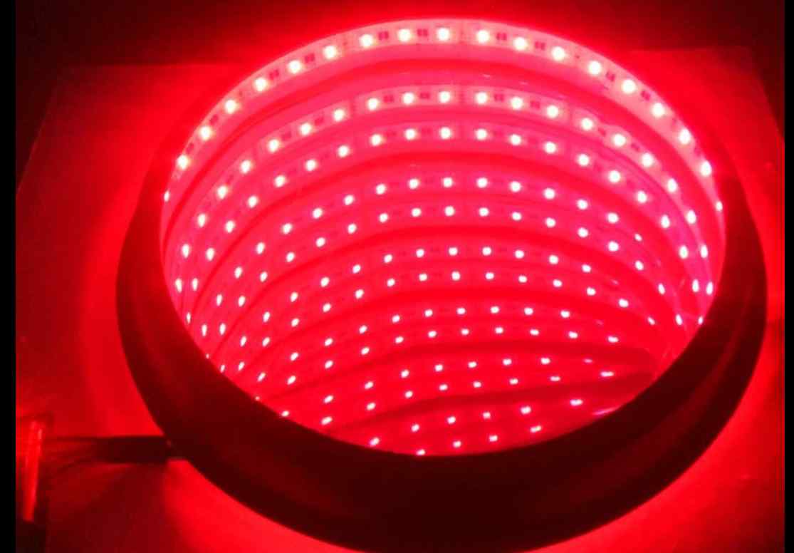

The making process of the infinity mirror
The infinity mirror is composed of a semi-lens and a mirror. The two mirrors are opposed to each other and repeatedly reflect each other to create the effect of countless lamp beads. There are many searches for tutorials on Bilibili, so I won’t describe them too much here.
WeChat picture_20201205215323.jpg I bought a set of round lenses and made a smaller one first, and then a larger one to use as a ceiling lamp in the living room.
WeChat picture_20201205215304.jpg The bottom of the flower pot is used as a light frame, and it will fit perfectly after digging holes.
WeChat picture_20201205215345.jpg The light strips were secured with a hot glue stick.
Take a look at the renderings
WeChat picture_20201206100534.jpg APPPCB WeChat picture_20201206101514.jpgWeChat picture_20201206101529.jpg
Finally, the buck voltage and PWM waveforms of each channel were measured, and a 12-hour aging test was conducted. Meet your pre-determined needs. submit homework! Video demonstration
