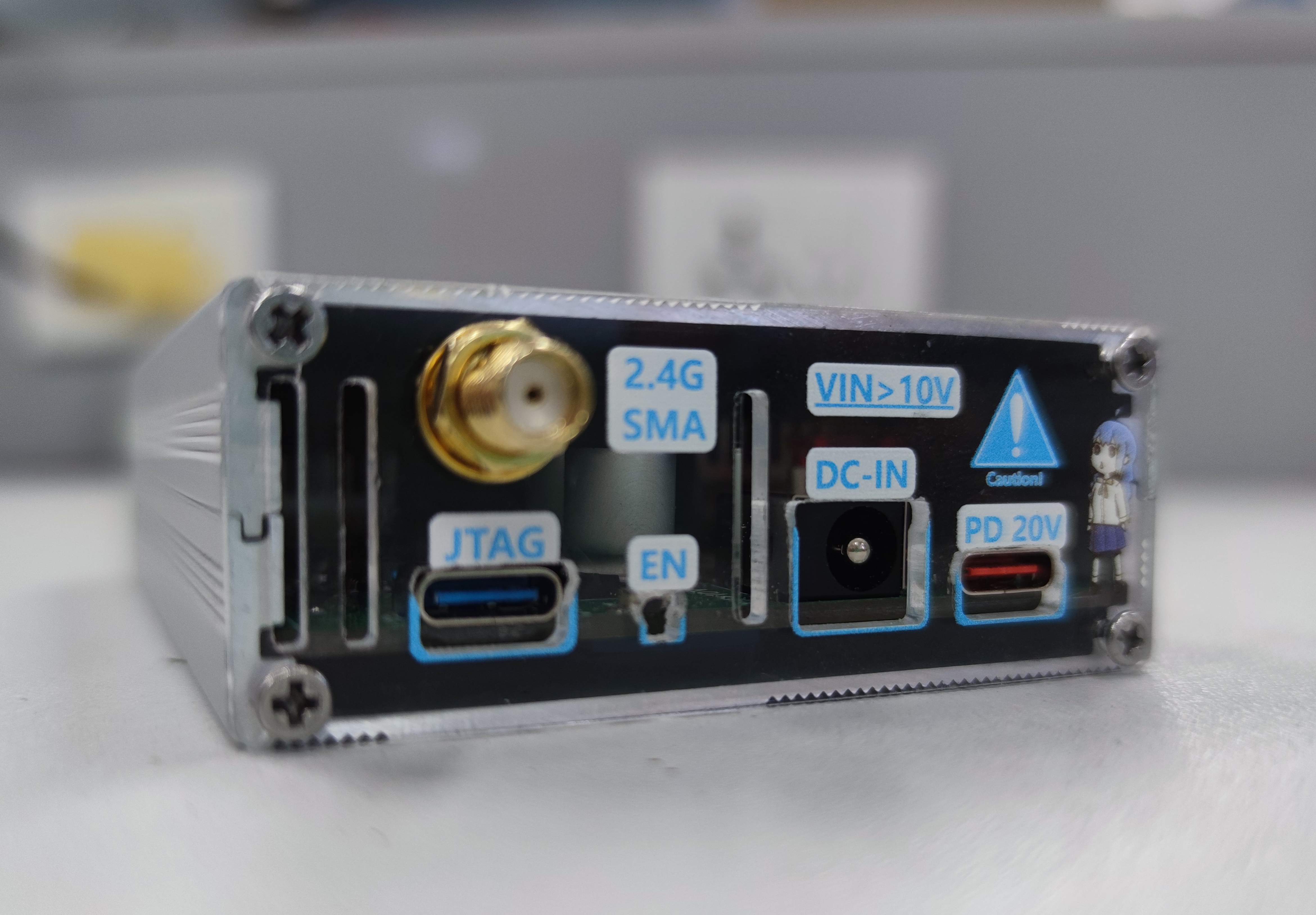

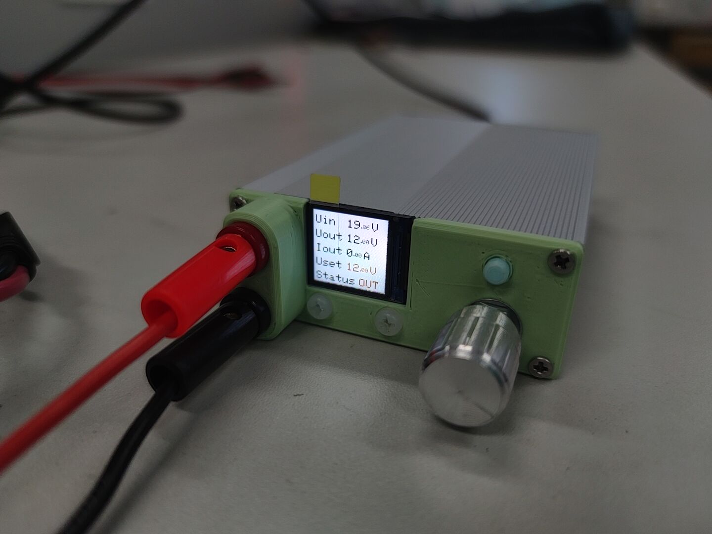

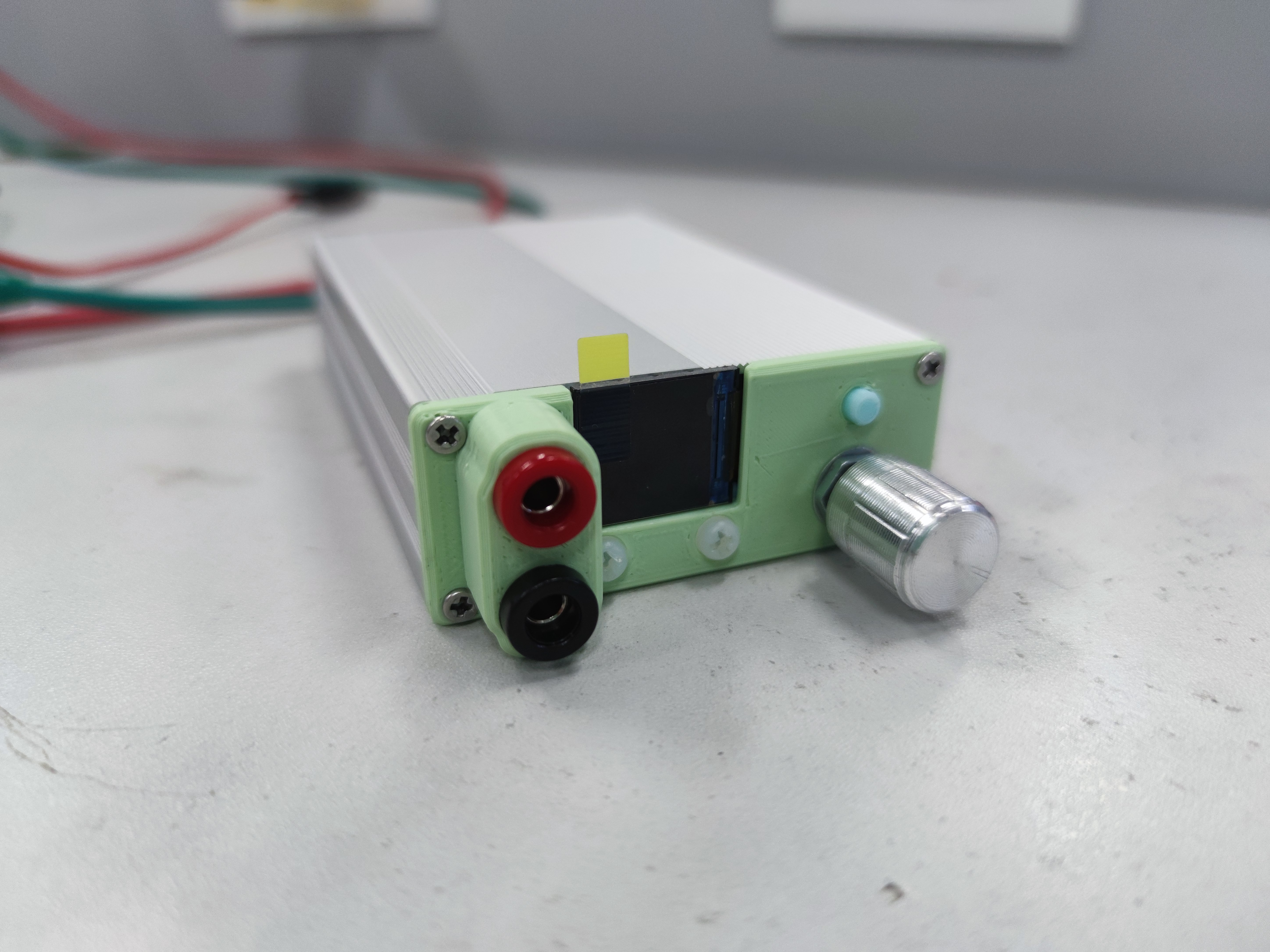

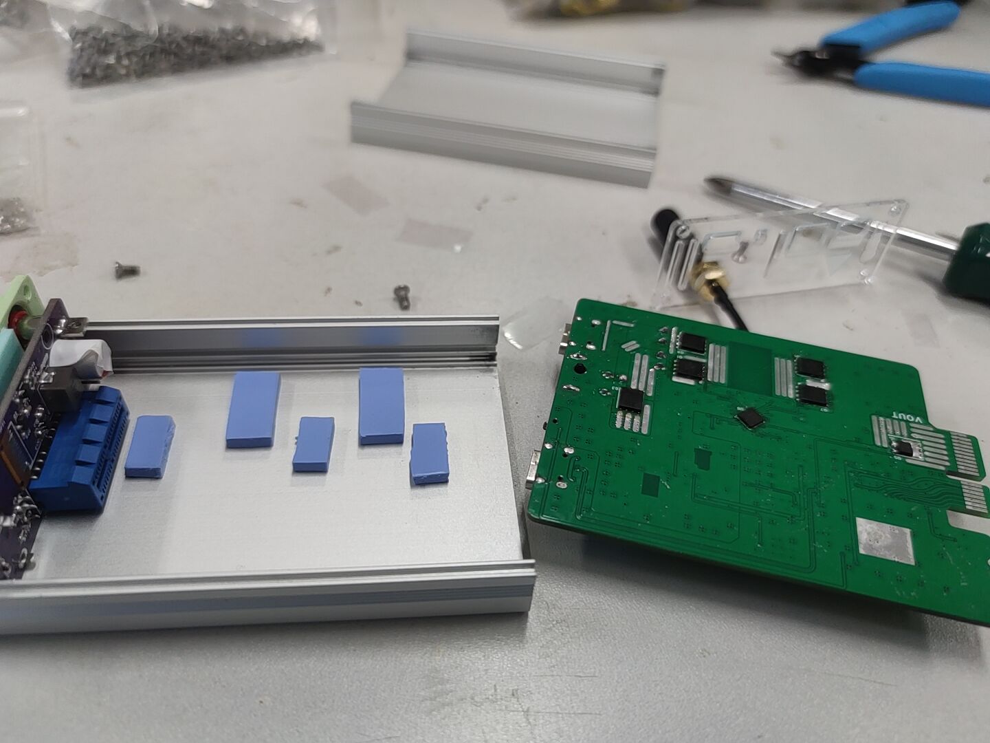

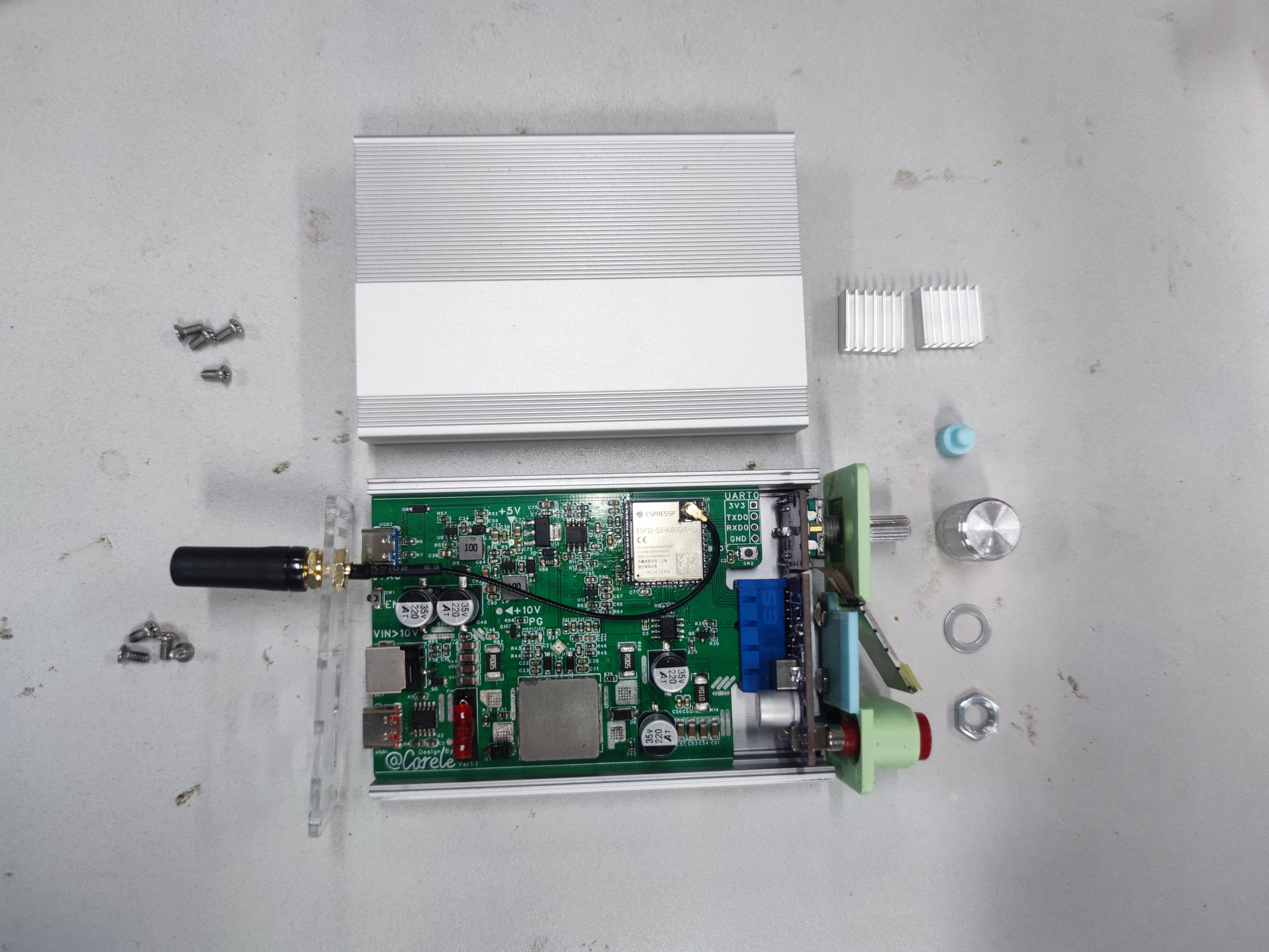

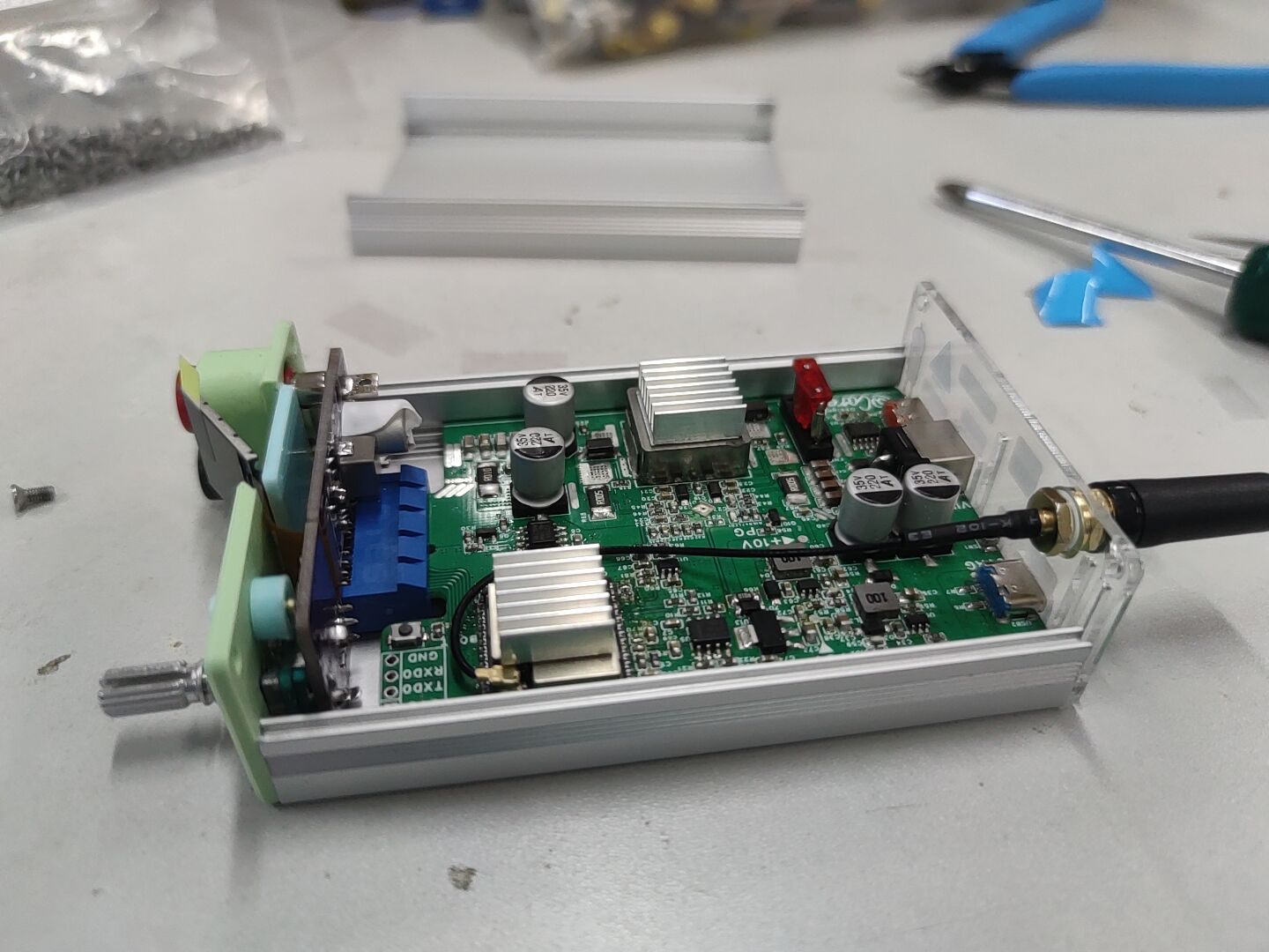

0.1 Actual Product Images

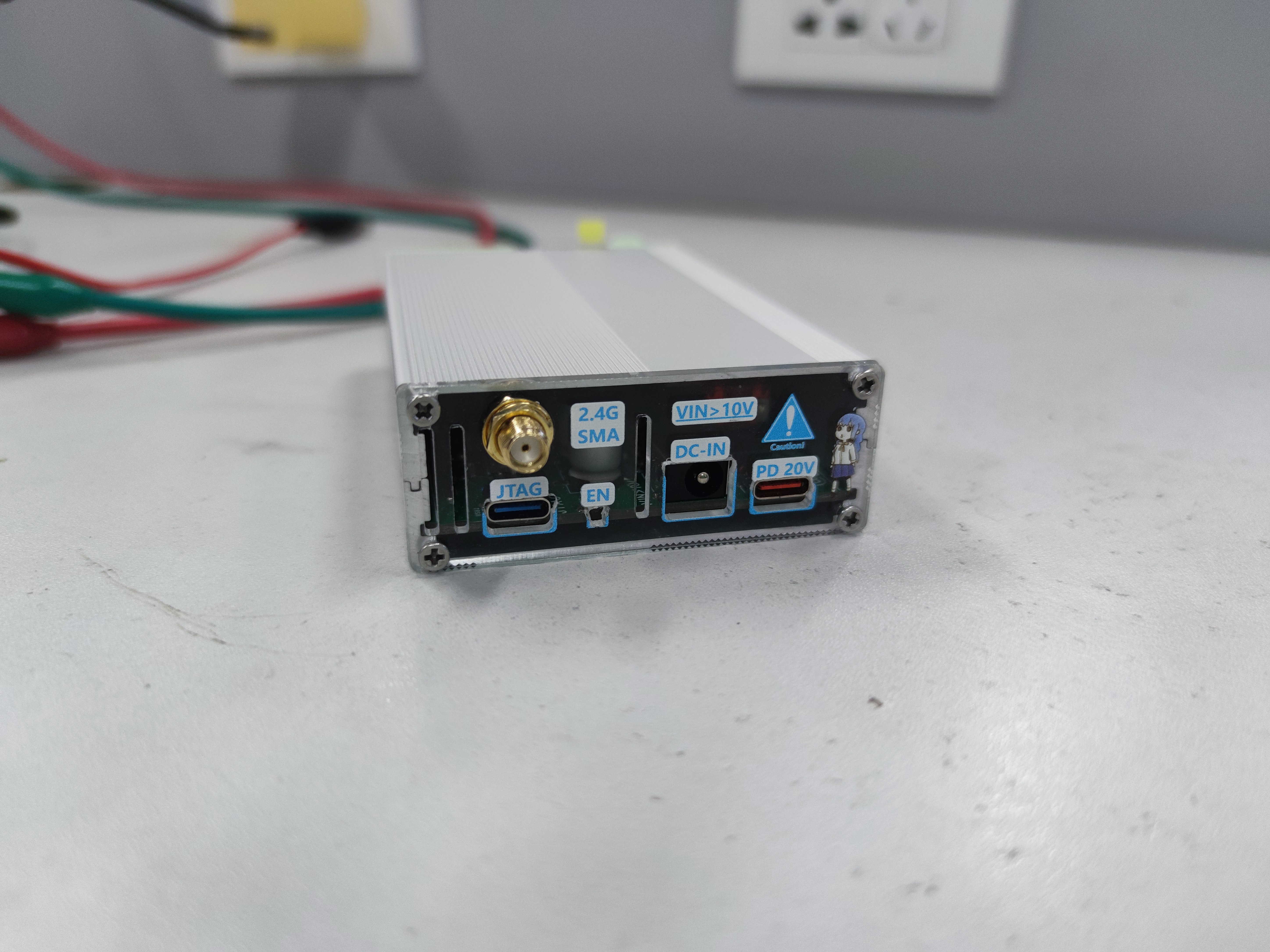

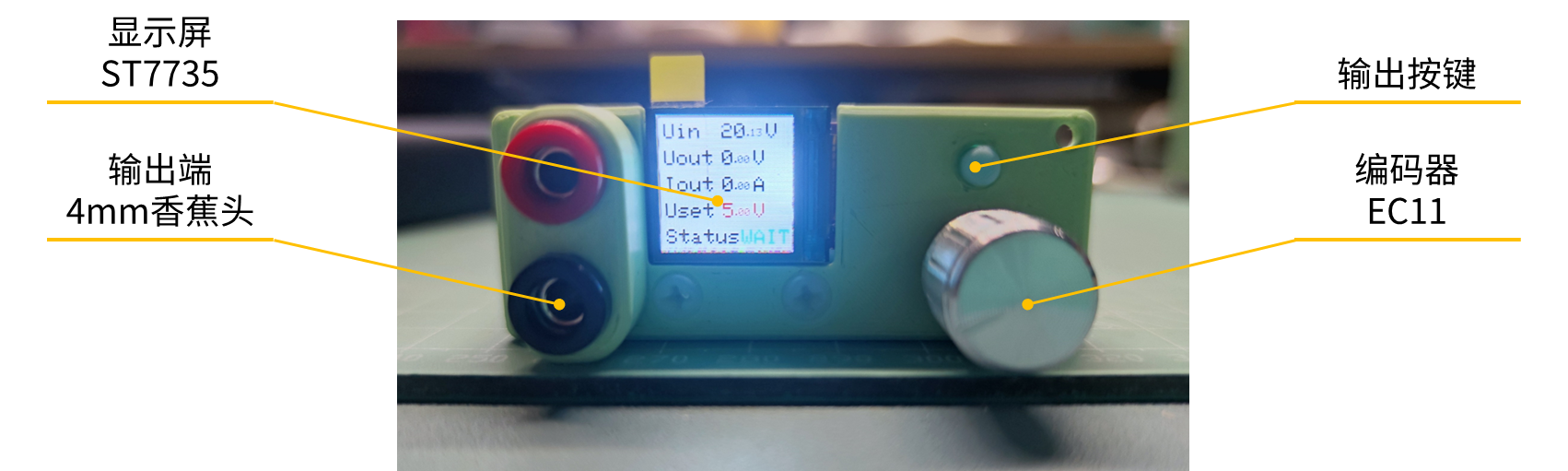

Figure 1 Front of the Power Supply
Figure 2 Back of the Power Supply
* Small Panel · Masterfully Made - Purely Handcrafted (Some idiot forgot to calculate the board thickness offset of 1.6mm) *

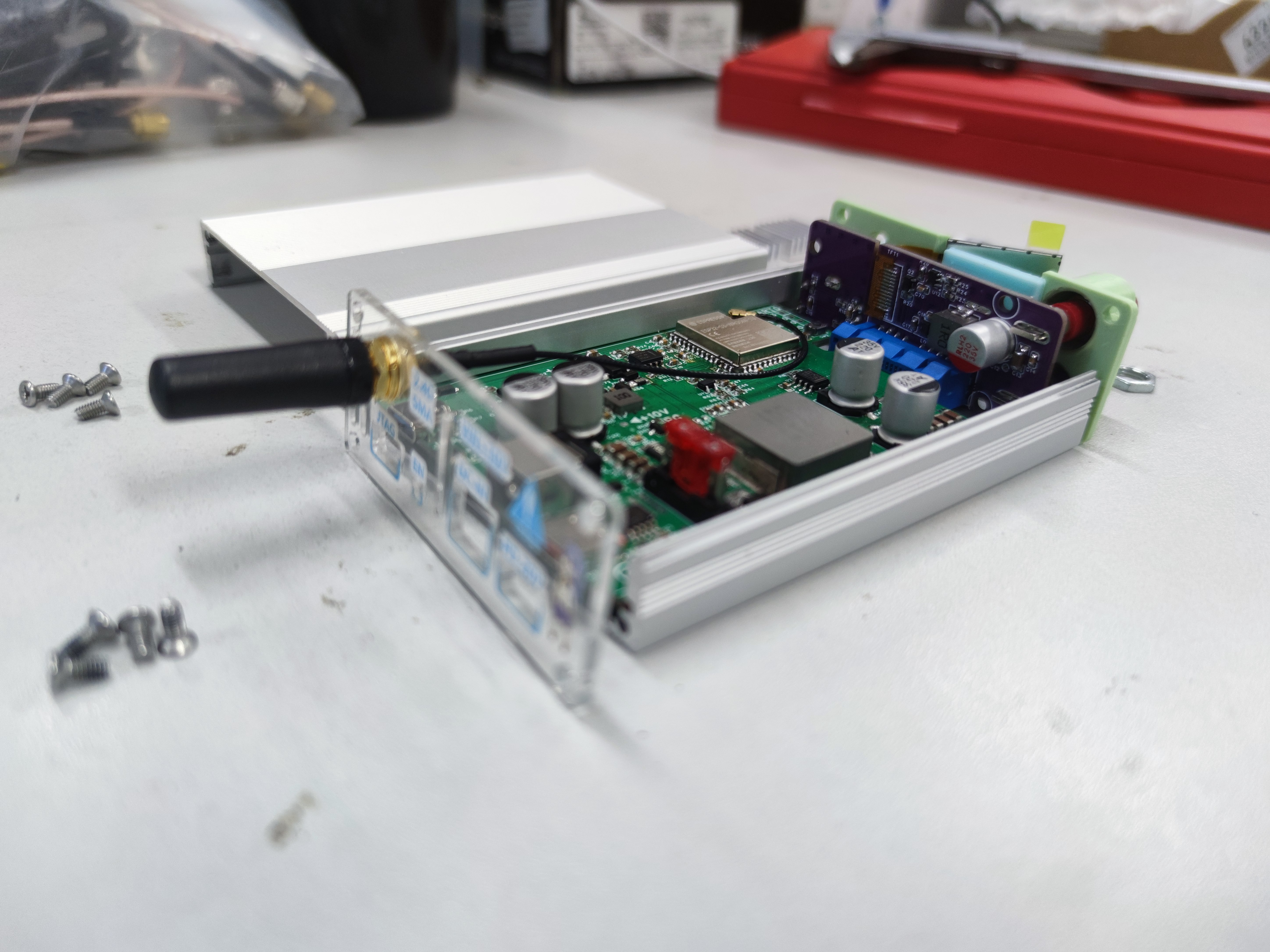

Figure 3 Exploded View of the Power Supply (weird)

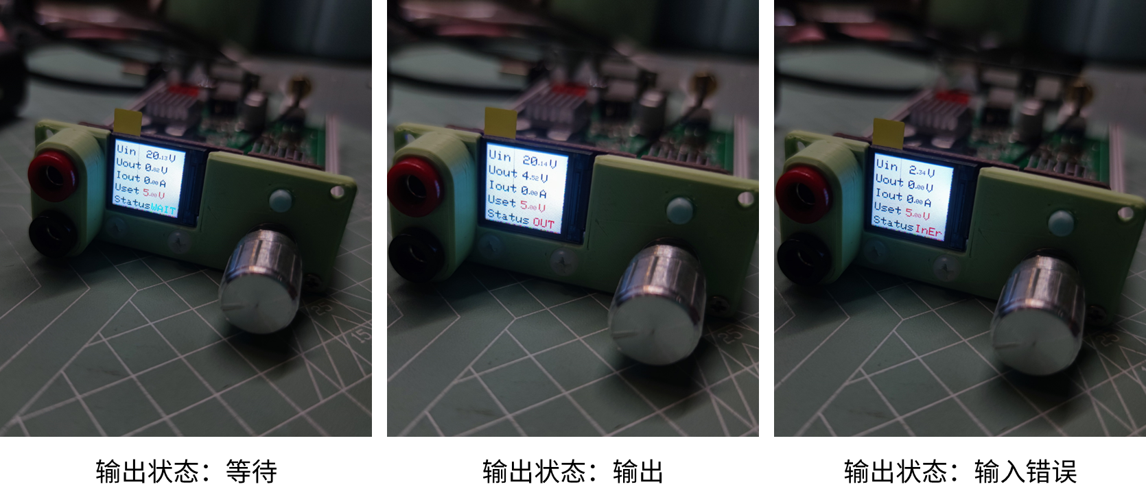

TFT information display and key encoder interaction
JTAG-serial port host computer interaction
Reserved Bluetooth and WIFI functions to be developed

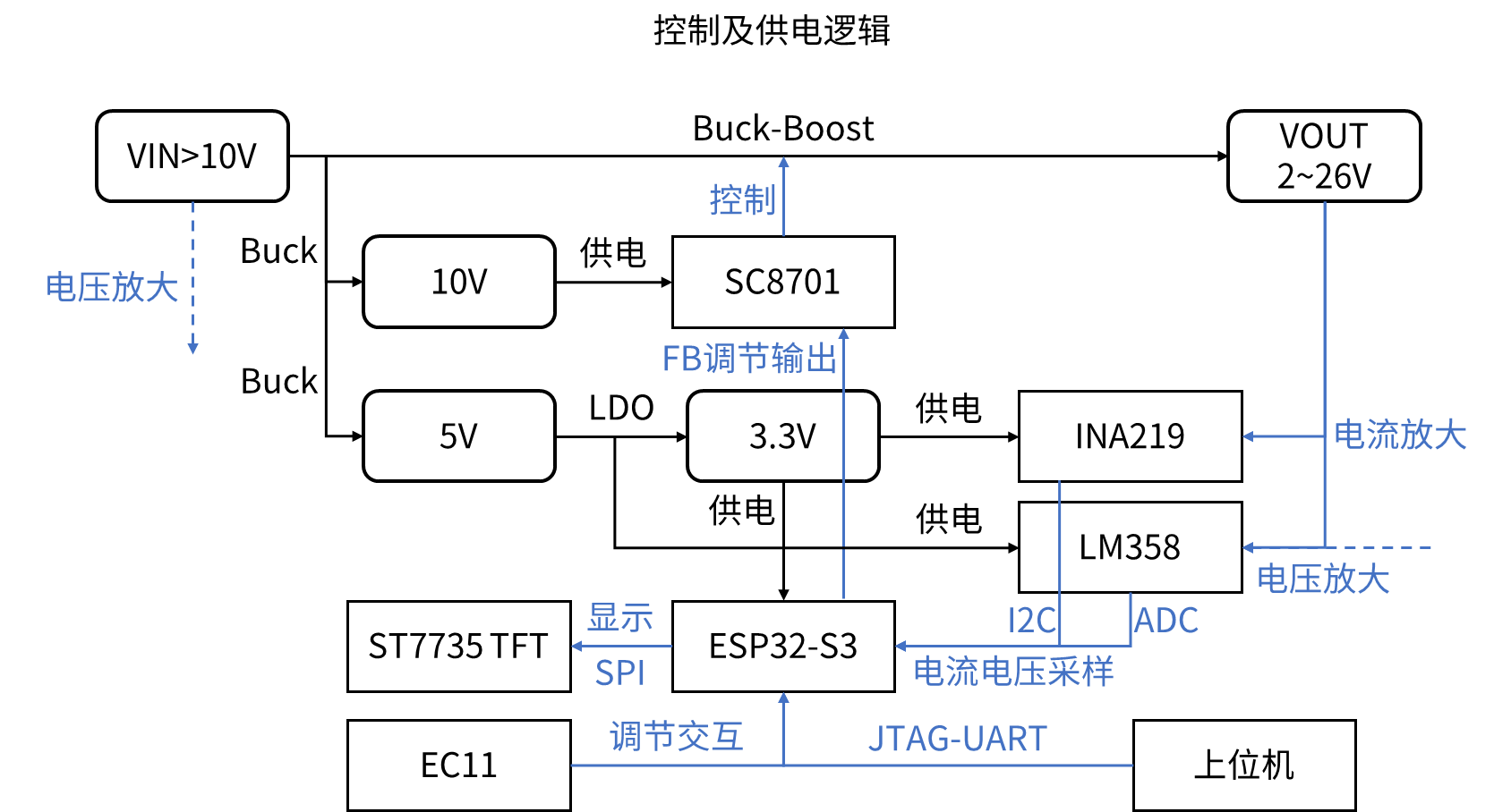

II. System Framework
2.1 Main System Framework
Figure 4 Main System Framework Diagram

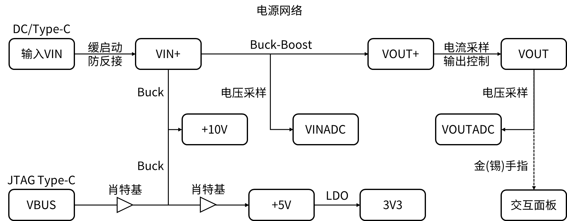

2.2 Power Network Framework
Figure 5 Power Network Framework Diagram

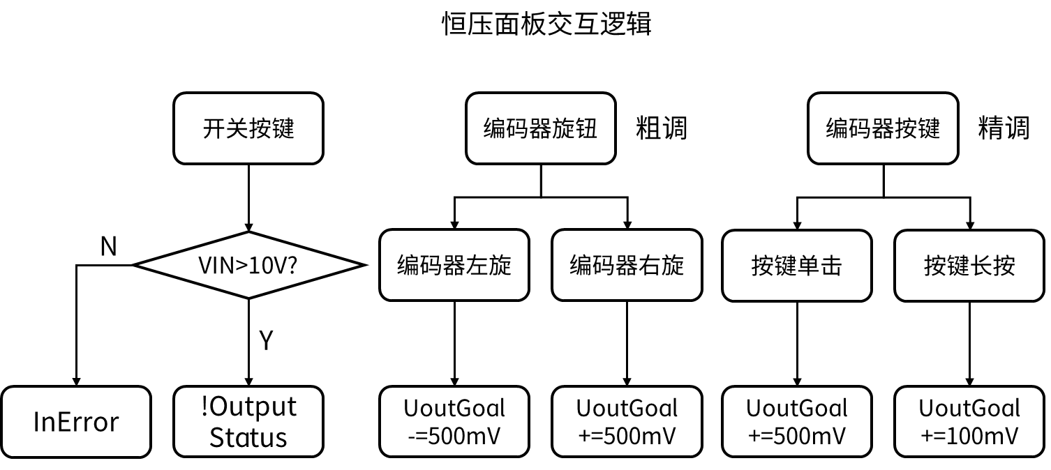

2.3 Panel Interaction Logic (For Constant Voltage Output)
Figure 6 Panel Interaction Logic Diagram (For Constant Voltage Output)

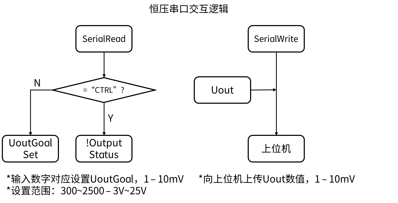

2.4 Serial Port Interaction Logic (For Constant Voltage Output)
Figure 7 Serial Port Interaction Logic Diagram (For Constant Voltage Output)

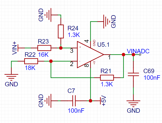

3.4.1 Voltage Sampling
Circuit Figure 8 Voltage Sampling Circuit Schematic
Here I use a combination of on-chip ADC and operational amplifier circuit, where the sampling operational amplifier circuit focuses on range scaling transformation.
The ESP32-S3 has two 12-bit ADCs with a total of 10 channels, a reference voltage of 3.3V, and a sampling value of 0~4095.
To make the sampled value more intuitive and establish a clearer relationship between the sampled value and the actual voltage, scaling transformation is required. As follows:

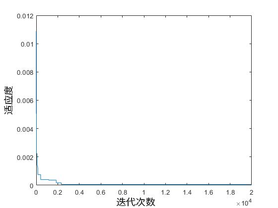

Considering DC-DC power output, control accuracy, and feasibility, I transformed the scale to 0~4095 - 0~40.95V, i.e., 10mV per LSB.

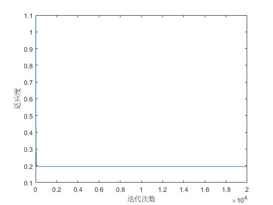

To reduce costs, I used E24 series resistors to configure the op-amp amplification factor and considered the impedance matching factor at both ends of the op-amp input for the solution.
I used a genetic algorithm for multi-objective optimization, constructing a fitness function with the absolute value of the amplification factor error as the primary optimization objective and the absolute value of the impedance deviation as the secondary optimization objective. The results are as follows:
Figure 9 Voltage sampling circuit configuration resistor optimization solution
R1 = 18K; R2 = 1.3K; R3 = 16K; R4 = 1.3K
Amplification factor deviation: 7.0199e-05
Input matching deviation: 0.0195
This completes the parameter design of the voltage sampling circuit. (See attached program)

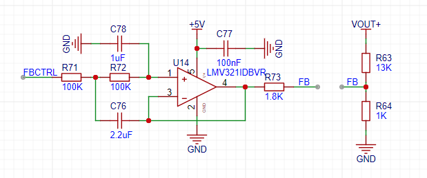

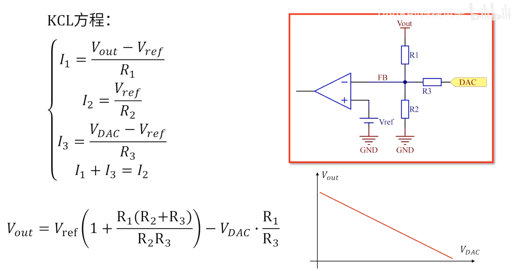

3.4.2 Output control
circuit Figure 10 Output control circuit schematic
I used a resistor network to control the output voltage, and the input voltage at the control terminal will be inversely proportional to the output voltage in a first-order linear relationship.
Figure 11 shows the resistor network control (@BV1oC4y1V7k1).
Originally, the plan was to use an on-chip DAC for output control. However! The ESP32-S3 does not have a DAC (ESP32 → ESP32-S3 reverse upgrade).
Therefore, a PWM output combined with a second-order low-pass filter was used to simulate a DAC for control.
The resistance values ​​of each component of the feedback resistor network jointly determine the output voltage range.
As derived from the power supply range analysis and device limitations in Figure 3: 2V ≤ Uout ≤ 26V
. Similarly, a fitness function was constructed using the absolute value of the output voltage deviation, and a genetic algorithm was used for optimization. The results are as follows:
Figure 12 shows the optimized output resistor network configuration:
R1 = 13K; R2 = 1K; R3 = 1.8K;
Uout_max = 25.3911V
; Uout_min = 2.1667V
. This completes the parameter design of the output control circuit. (See attached program)

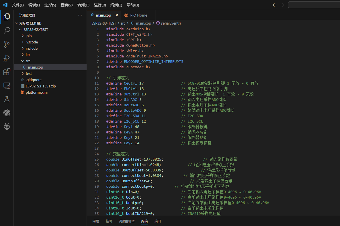

4.0 Development Environment
This project program is developed based on VSCode PlatformIO and the Arduino framework.
Figure 13 Development Environment

Serial communication with the host computer is now complete. This is divided into two parts: uploading data and receiving control.
Output voltage information is uploaded to the host computer using Serial.println(); instructions from the host computer are read using Serial.read(), and corresponding control or adjustments are made.

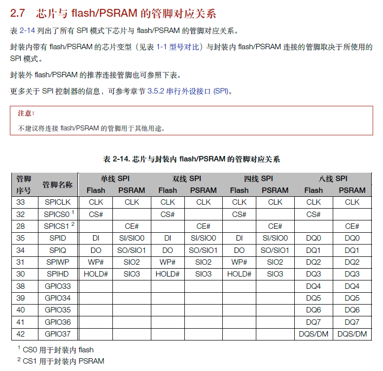

5.1 Flash/PSRAM
To be honest, I am not very interested in this thing, and I don't know how much optimization and improvement it can bring.
But! It occupies IO extra!
Figure 14 PSRAM pin correspondence table [4]
As shown in Figure 13, the Flash/PSRAM driven by the eight-wire SPI will occupy GPIO33-37 extra.
In the design, I used some of these pins to drive ST7735 and enabled the PSRAM function.
At this time, the high blood pressure comes. Every time it starts, ST7735 SPI and PSRAM are fighting for GPIO. Whether it can start normally depends entirely on luck. One reset may cause it to fail.
I reread the datasheet and found the problem, which was solved by disabling the PSRAM function. (So, xdm, memorize the entire datasheet!)
The main issue was my lack of clarity regarding the ESP32-S3, so I hope everyone will learn from this and pay attention to the important details mentioned in the datasheet.

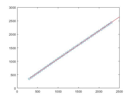

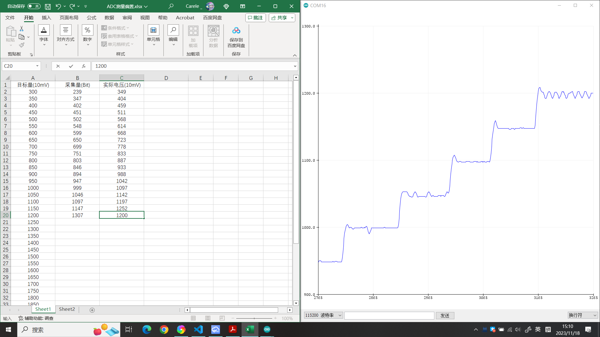

5.2 ADC Calibration

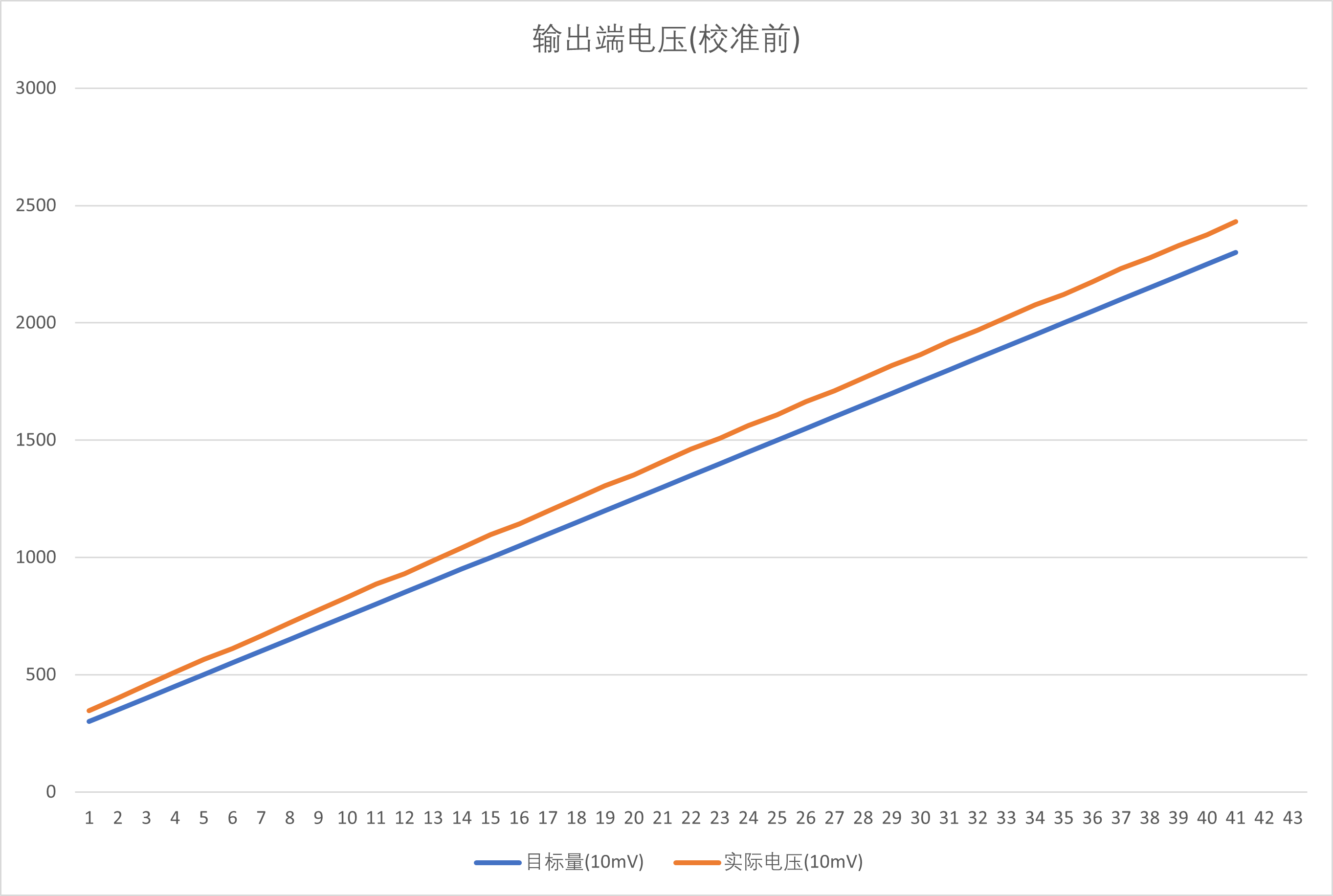

After completing the main function program, I started testing the output. At this time, I found that the output/input voltage was inconsistent with the values ​​of the multimeter and ammeter.
Therefore, I compared the measured value with the output value and obtained the following results:
Figure 15 Output value-measured value comparison (before calibration)
As shown in the figure above, it can be seen that the slope and height of the two lines between the actual voltage measurement value and the output value are different, and there is a deviation in slope and intercept.
It is easy to see that the error value mainly follows a first-order linear distribution.
Therefore, I defined CorrectUout (slope calibration) and UoutOffest (intercept calibration) to calibrate the ADC.
I imported the measured values ​​into Matlab and performed a first-order linear fit between the actual control quantity and the actual measured value. The results are as follows:
Figure 16 shows the linear fitting results:
CorrectUout = 1.0384,
UoutOffest = 50.8339.
These results are then used in the program to calibrate the ADC.

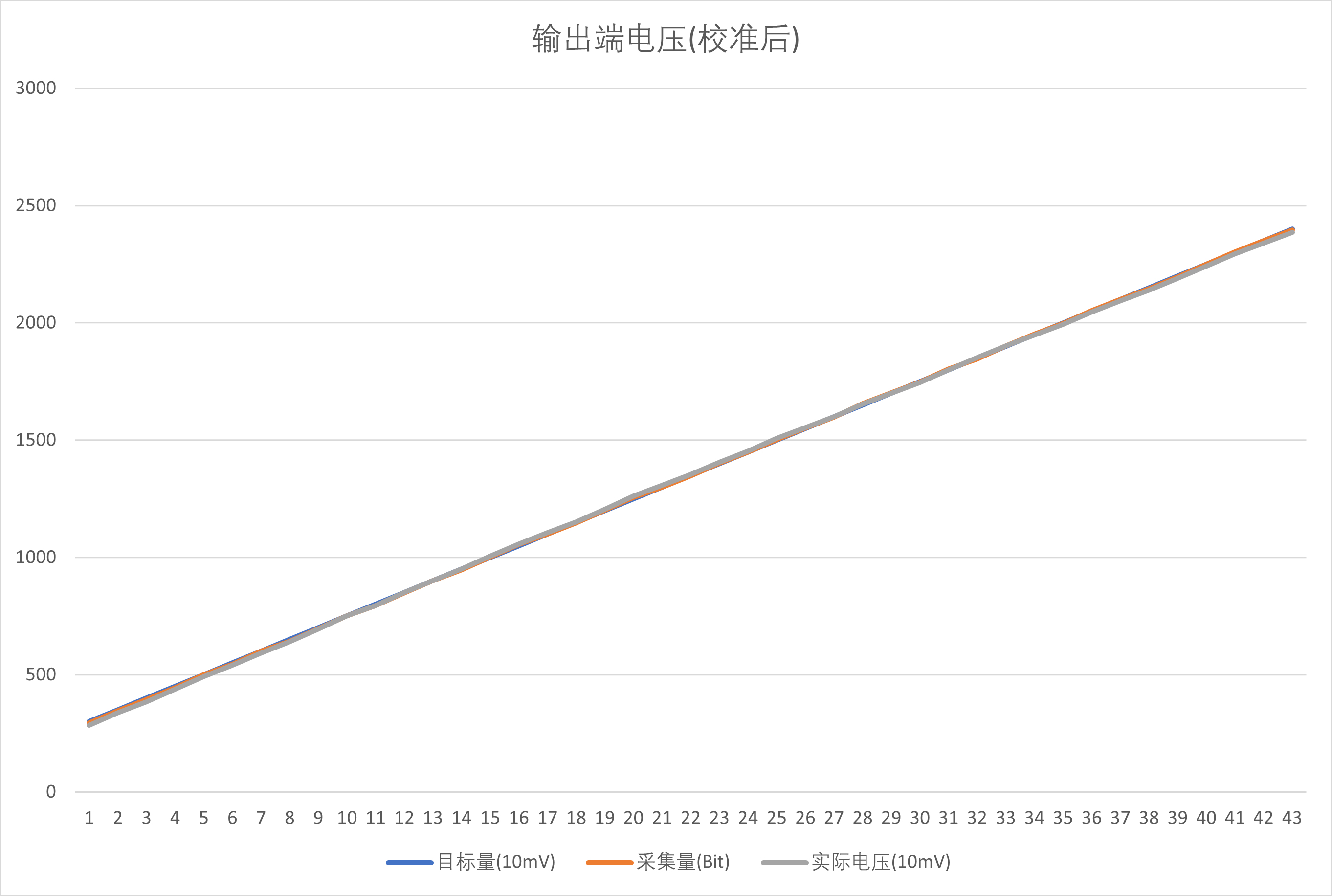

Figure 17 shows the comparison between the output value and the measured value (after calibration).
As shown in the figure above, the actual control value and the actual measured value are well consistent after calibration, with a small deviation, which may be caused by measurement error or control error.
It is speculated that the slope difference comes from the amplification error of the sampling operational amplifier circuit, possibly caused by resistance error, etc.;
the intercept error comes from the on-chip ADC's own reference drift (speculation).
The ADC calibration is now complete, and the calibration effect is good. (Program and documentation are attached.)

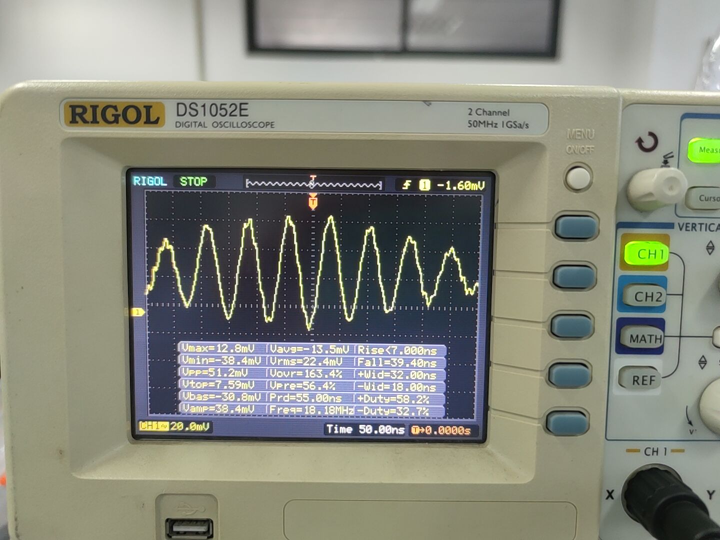

The accuracy of the output voltage and power supply ripple are greatly affected by the MCU control; therefore, the suitability of the PID parameters will significantly affect the power output quality.
Figure 18 shows the PID parameter tuning and debugging.
Currently, there are still some problems with the PID parameter settings, such as static error, large overshoot, and oscillation.
Therefore, further parameter tuning is still needed.

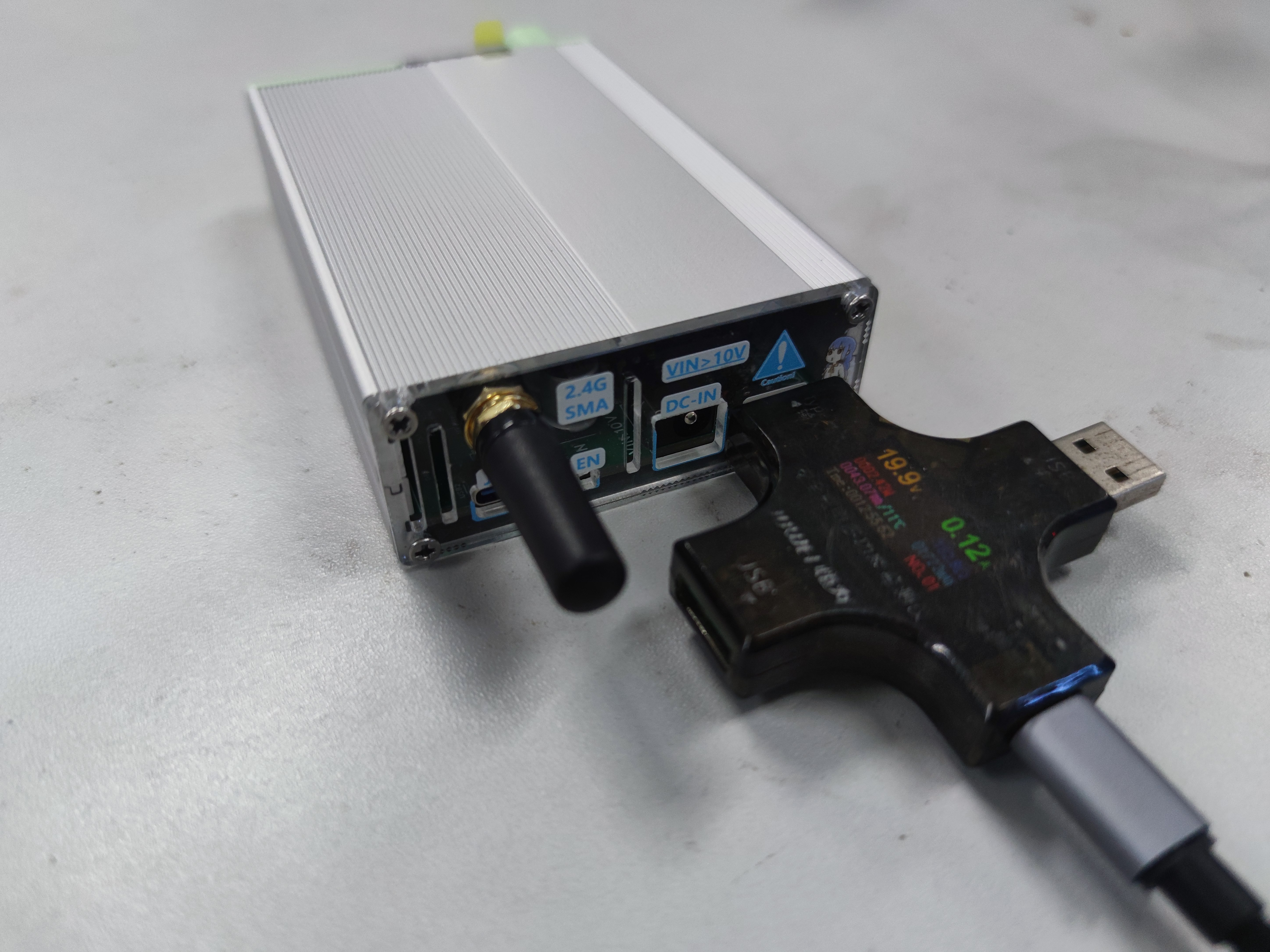

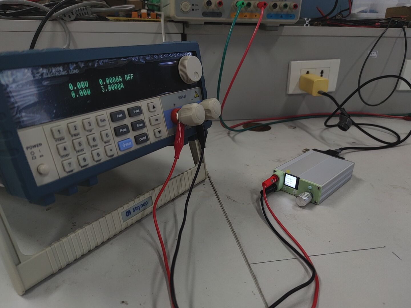

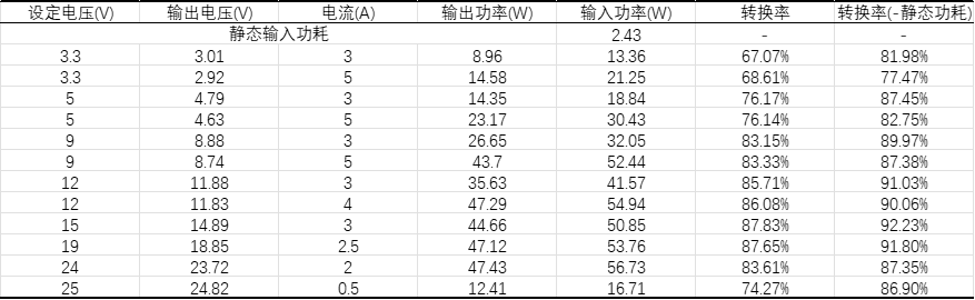

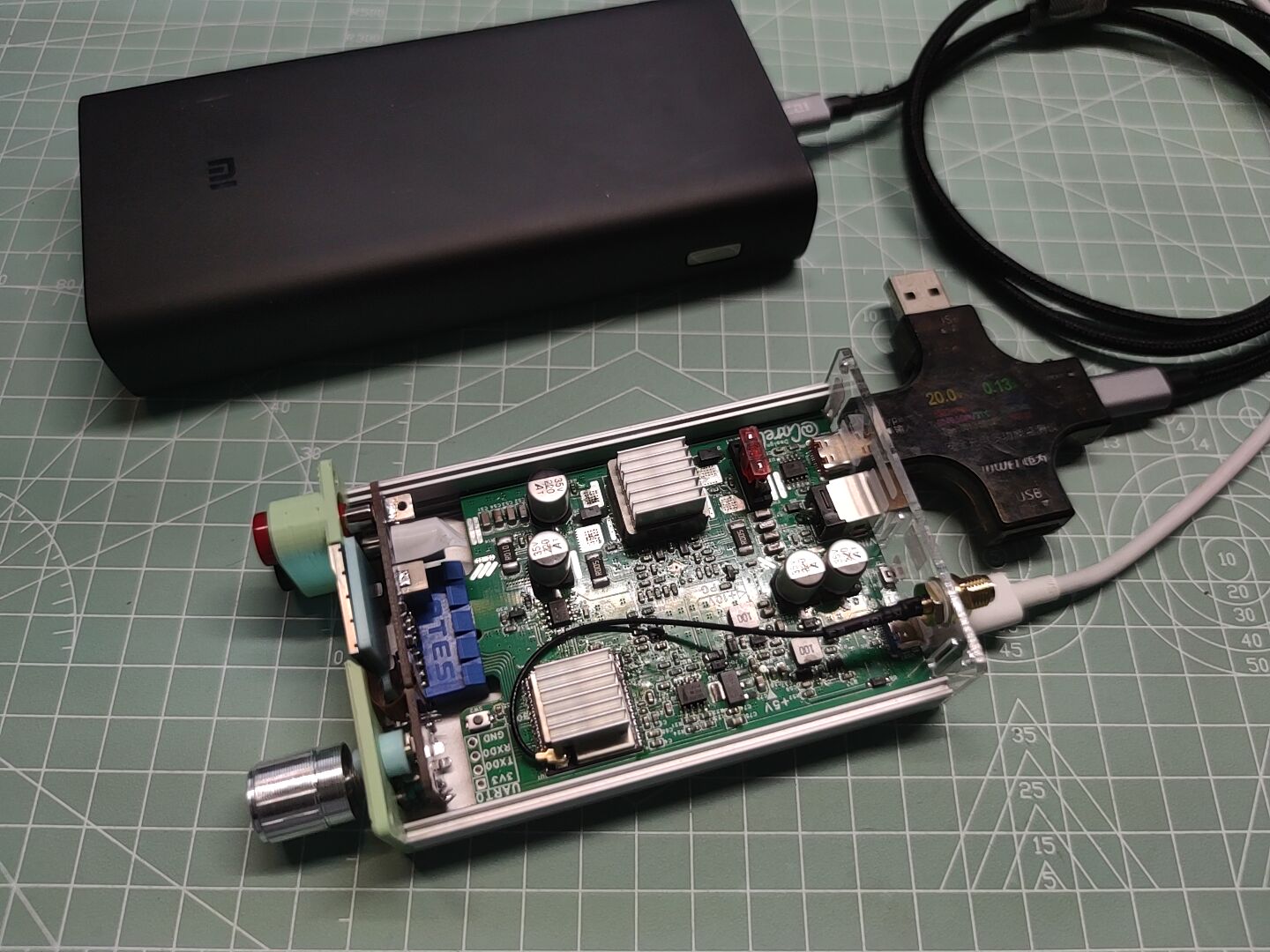

6.1 Conversion Rate Test
To test the power supply performance, I used an electronic load.
Figure 19 Performance Testing Environment
* Load borrowed from the teacher *
Input Conditions: Nubia GaN Gallium Nitride Single-Port 65W Charger @ 20V 3.25A max
Input Information: Juwei Safe Charging Multifunctional Tester (USB Current and Voltage Meter)
Output Information: Electronic Load
Test results are shown below:
Table 1 Test Results
As shown in the table above, the power supply has a low conversion rate under high current load conditions, presumably due to a large MOS/inductor internal resistance.
6.2 Ripple Test
The AC coupling mode of an oscilloscope was used for testing, and the following results were obtained:
Figure 20 Ripple Test Results
Hmm, not bad? But something feels off.
*The above results are not entirely accurate and are for reference only.
VII. Power Supply Assembly
Diagram 21 Power Supply Assembly Diagram 1 (Use a 3mm thermal pad to conduct heat from MOS and chip to the casing)
Figure 22 Power Supply Assembly Diagram 2 (Add a 14x14x5 heat sink to assist inductor and MCU module heat dissipation)
Figure 23 Power Supply Assembly Diagram 3 (Use M2.5x6 screws to fix the front and rear panels)
Figure 24 Power Supply Assembly Diagram 4
VIII. Power Supply Effect
Diagram Figure 25 Power Supply Effect Diagram 1 (Front Panel) Figure 26 Power Supply Effect Diagram
2 (Rear Panel - The hole position deviation of the panel in the project has been corrected)
Figure 27 Power Supply Effect Diagram 2 (Output Status: Wait | Output | Input Error)
Figure 28 Power Supply Effect Diagram 4 (Use a 4mm banana plug to connect the output end)

I. Source Code (Project is in the attached compressed file) #include
#include
#include
#include #include #include #define ENCODER_OPTIMIZE_INTERRUPTS #include // Pin Definitions #define CeCtrl 17 // SC8701 Enable Control Pin 1 Invalid - 0 Valid #define FbCtrl 18 // Voltage Feedback Control Network Pin #define OutCtrl 13 // Output MOS Control Pin 1 Valid - 0 Invalid #define UinADC 5 // Input Voltage Sampling ADC Pin #define UoutADC 6 // Output Voltage Sampling ADC Pin #define UoutpADC 9 // Terminal Output Voltage Sampling ADC Pin #define I2C_SDA 11 // I2C SDA #define I2C_SCL 12 // I2C SCL #define Key1 48 // Encoder Button #define KeyA 47 // Encoder A Terminal #define KeyB 21 // Encoder B end #define Key2 14 // Output control button // Variable definition double UinOffset=137.3825; // Input sampling offset double correctUin=1.0248; // Input voltage sampling correction coefficient double UoutOffset=50.8339; // Output sampling offset double correctUout=1.0384; // Output voltage sampling correction coefficient double UoutpOffset=0; // Terminal output sampling offset double correctUoutp=0; // Terminal output voltage sampling correction coefficient uint16_t Uin=0; // Current input voltage sampling value 0-4096 ~ 0-40.96V uint16_t Uout=0; // Current output voltage sampling value 0-4096 ~ 0-40.96V
uint16_t Uoutp=0; // Current terminal output voltage sample value 0-4096 ~ 0-40.96V
uint16_t Iout=0; // Current output current sample value
uint16_t UoutINA219=0; // INA219 sampled voltage value
uint16_t IoutINA219=0; // INA219 sampled current value
uint16_t PoutINA219=0; // INA219 power calculation value
const unsigned char sampleTimes=4; // Average sampling count
uint16_t UoutTemp[sampleTimes]; // Output voltage sampling queue
uint16_t IoutTemp[sampleTimes]; // Output voltage sampling queue
int UoutError0=0; // Current output voltage error
int IoutError0=0; // Current output current error
int UoutError1=0; // Previous output voltage error
int IoutError1=0; Previous output current error
int UoutError2=0; // Previous output voltage error
int IoutError2=0; // Previous output current error in
uint16_t UoutGoal=500; // Output voltage target - default 5V
uint16_t IoutLim=5000; // Output current limit - default 5A
unsigned char UoutCtrlValue; // Output voltage feedback control quantity
boolean SelectStatues=0; // Selected status
boolean OutputStaus=0; // Output status flag
boolean InError=0; // Power input status
uint16_t Ts=200; // Sampling, upload, and control cycle settings
unsigned char FPS=16; // TFT frame rate

// Encoder button click - Select UoutGoal Edit
void button1click1(){
SelectStatues=!SelectStatues;
// Encoder button double click - UoutGoal increments by 50mV, becomes 300 if it exceeds 2500
void button1click2(){
UoutGoal+=50;
if(UoutGoal>=2550){
UoutGoal=300;
// Encoder long press - UoutGoal increments by 10mV, becomes 300 if it exceeds 2500
void button1LongPress(){
UoutGoal+=10;
if(UoutGoal>=2510){
UoutGoal=300;
// Button click-out switch
void button2click1(){
if(Uin>=950){
InError=0;
OutputStaus=!OutputStaus;
digitalWrite(OutCtrl,OutputStaus);
else{
InError=1;

String inputString = "";
boolean stringComplete;
void serialEvent() {
while (Serial.available()) {
// get the new byte:
char inChar = (char)Serial.read();
// add it to the inputString:
inputString += inChar;
// if the incoming character is a newline, set a flag so the main loop can
// do something about it:
if (inChar == '
stringComplete = true;
if (stringComplete) {
if(inputString=="CTRL
button2click1();
else{
if(inputString.toInt() >= 300 | inputString.toInt() <= 2500){
UoutGoal=inputString.toInt(); // Serial port voltage setting
// clear the string:
inputString = "";
stringComplete = false;
// PID control
boolean outputMode=0; // Output mode 0 - constant voltage control; 1 - constant current control
uint16_t UoutCtrlValueTemp=UoutGoal;
double Kp=0.1, Ti=125, Td=5; // Constant voltage PID parameter settings
double KIp=1, TIi=1, TId=1; // Constant current PID parameter settings
int Pterm=0, Itrem=0, Dterm=0;
void PidCtrl(){
// Incremental PID
Pterm=(UoutError0 - UoutError1);
Itrem=UoutError0;
Dterm=( UoutError0 - 2*UoutError1 +UoutError2);
UoutCtrlValueTemp=UoutCtrlValueTemp + Kp*( Pterm + Ts/Ti*Itrem + Td/Ts*Dterm );
if(UoutCtrlValueTemp>2540){
UoutCtrlValueTemp=2540;
else if(UoutCtrlValueTemp<220){
UoutCtrlValueTemp=220;
// Serial.println(UoutCtrlValueTemp);
UoutCtrlValue=255-(UoutCtrlValueTemp-220)*0.11;
//Serial.println(UoutCtrlValue);
analogWrite(FbCtrl,UoutCtrlValue);
//Record error
UoutError2=UoutError1;
IoutError2=IoutError1;
UoutError1=UoutError0;
IoutError1=IoutError0;
UoutError0=UoutGoal-Uout;
IoutError0 = IoutLim - Iout;

void setup() {
// Put your setup code here, to run once:
// Serial port initialization
Serial.begin(115200);
delay(500);
// TFT initialization
tft.init(); // Initialize
delay(500);
tft.setRotation(1); // Screen orientation - rotate 270°
tft.fillScreen(TFT_BLACK); // Screen all black
tft.setTextColor(TFT_WHITE,TFT_BLACK); // Set font color to white, background to black, and text size multiplier to 1
tft.setTextSize(2); // Font size
tft.setCursor(5, FirstLinePos)
; tft.println("Uin");
tft.setCursor(5, FirstLinePos+LineSpace);
tft.println("Uout");
tft.setCursor(5, FirstLinePos+2*LineSpace);
tft.println("Iout");
tft.setCursor(5, FirstLinePos+3*LineSpace);
tft.println("Uset");
tft.setCursor(5, FirstLinePos+4*LineSpace);
tft.println("Status");
// Pin initialization
pinMode(CeCtrl,OUTPUT); // SC8701 enable pin mode setting - output
digitalWrite(CeCtrl,0); // SC8701 enable setting - valid
pinMode(OutCtrl,OUTPUT); // Output control pin mode setting - output
digitalWrite(OutCtrl,0); // Default output status - no output
pinMode(FbCtrl,OutCtrl); // Voltage feedback control network pin mode setting - output
UoutCtrlValue=255-(UoutGoal-250)*0.1;
// INA219 initialization
Wire.begin(I2C_SDA, I2C_SCL);
delay(500);
//initINA219();
Wire.begin();
if (!INA219.begin()){
// while (1){
// Serial.println("could not connect. Fix and Reboot");
// delay(1000);
// Onebutton initialization
button1.attachClick(button1click1);
button1.attachDoubleClick(button1click2);
button1.attachLongPressStart(button1LongPress);
button2.attachClick(button2click1);
// Timer initialization
// Timer 1
timer1 = timerBegin(1,80,true); // Initialize timer - use timer1
timerAttachInterrupt(timer1,onTimer1,true); // Bind timer interrupt service function
timerAlarmWrite(timer1,Ts*1000,true); // Set the interrupt interval to the sampling period.
`timerAlarmEnable(timer1);` // Start the timer
. // Timer 2
`timer2 = timerBegin(2, 80, true);` // Initialize the timer - use timer 2 `
timerAttachInterrupt(timer2, onTimer2, true);` // Bind the timer interrupt service function
`timerAlarmWrite(timer2, 1000000/FPS, true);` // Set the interrupt `
timerAlarmEnable(timer2);` // Start the timer.
void loop() {`
// Put your main code here, to run repeatedly: `
button1.tick();`
`button2.tick();`
dataGetINA219();
EncoderRead(); // Encoder reads
data
