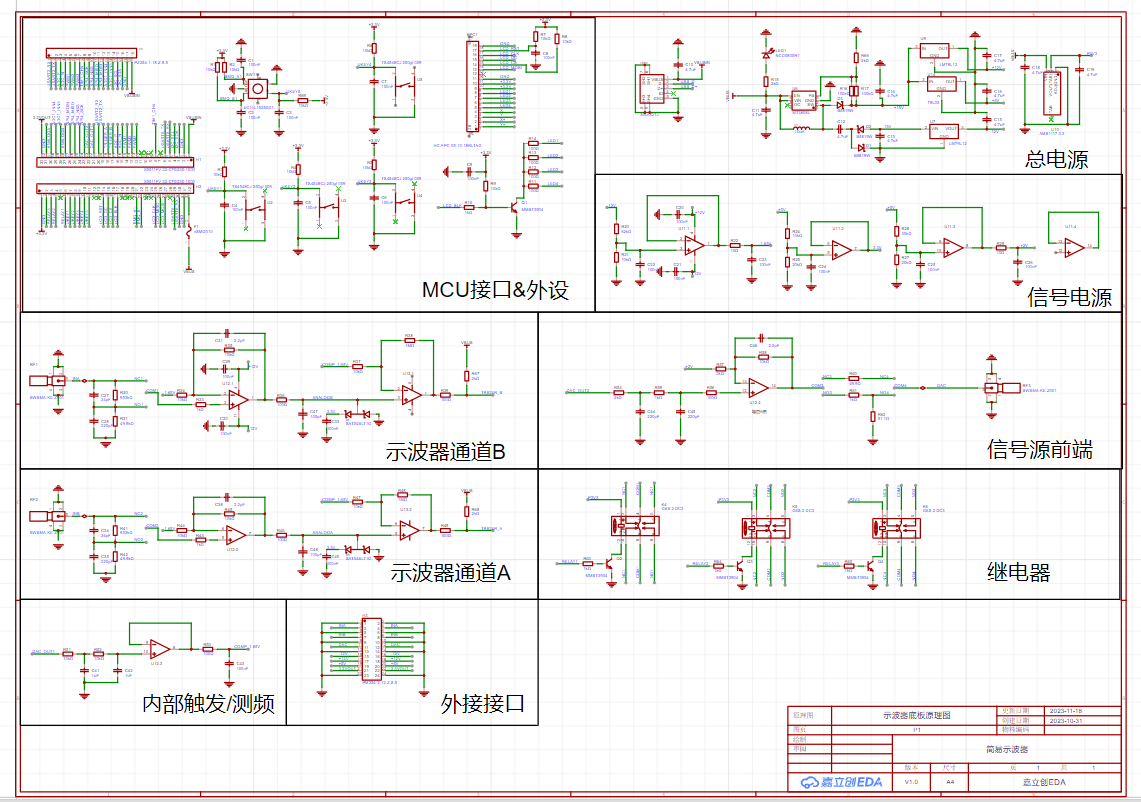

This is a complete replica of the oscilloscope shown in the course, with only minor component modifications to reduce costs. The original open-source project is: https://oshwhub.com/damihuang/AFE03.
A fuse has been added to prevent accidental smoke.

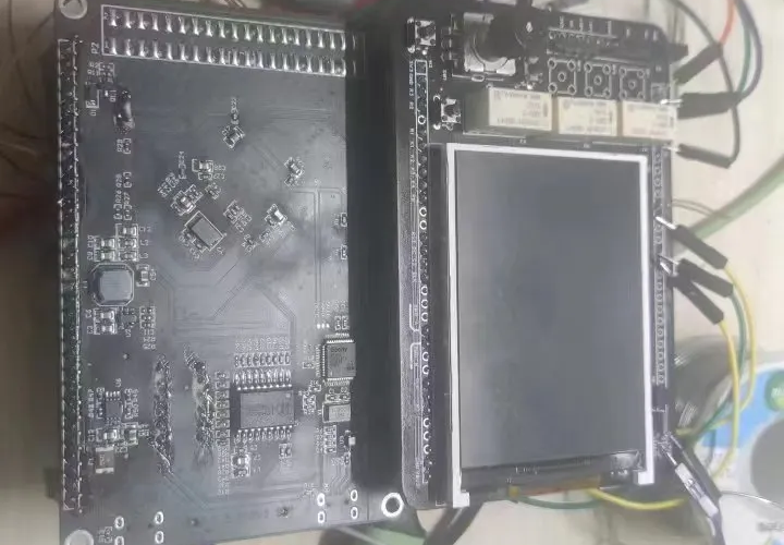

Additionally: Pay close attention to the shape parameters during design, otherwise only flying wires can handle it... That's why my core board is at the bottom...
PPS: Component selection is crucial! The 5V relay I used before couldn't be driven by 3.3V, so only one relatively good one worked and could switch gears...

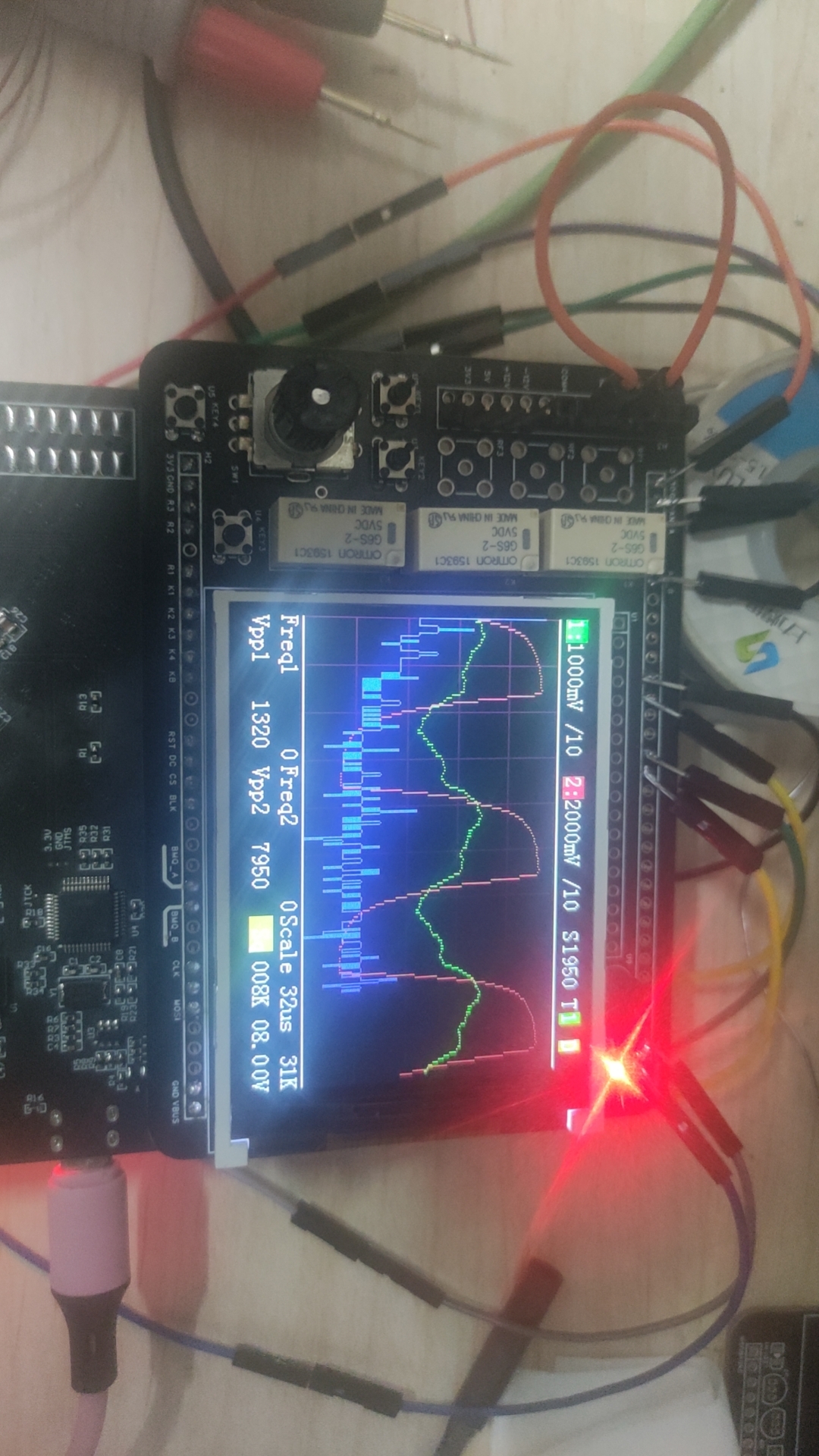

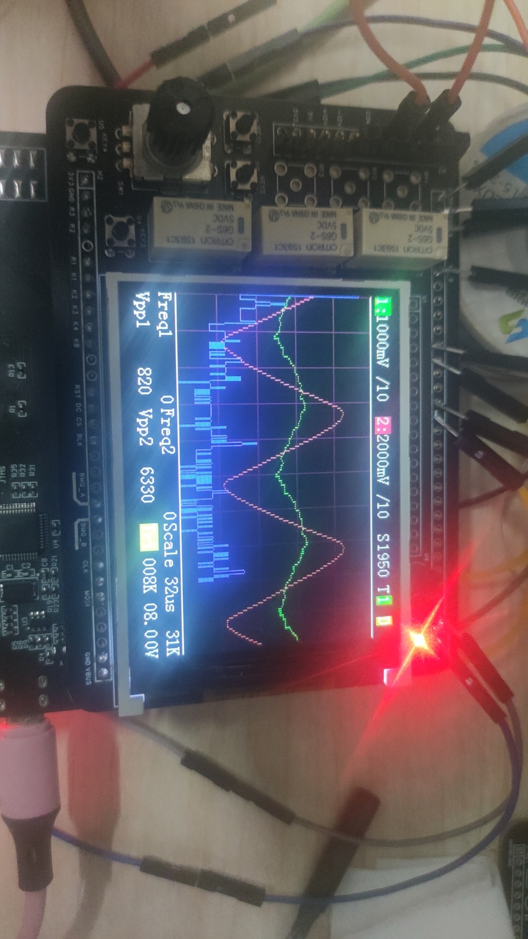

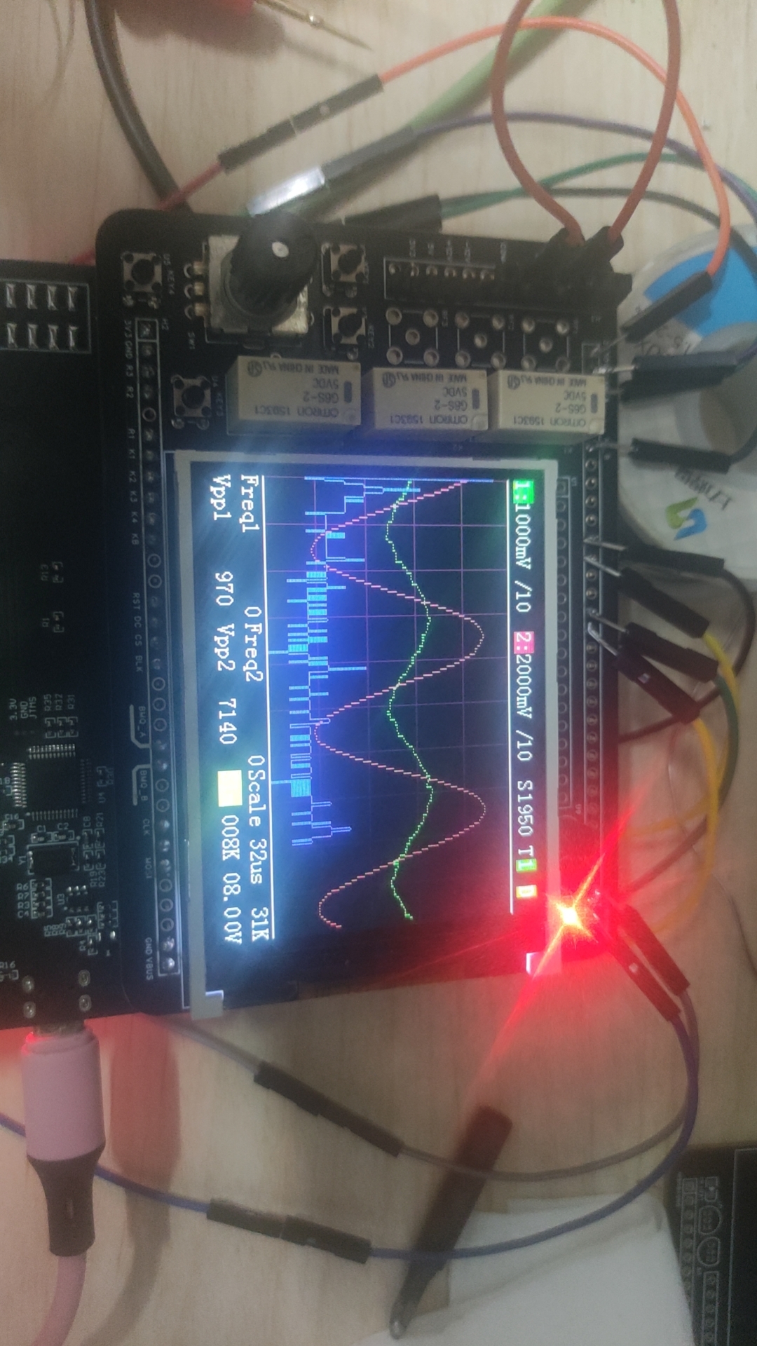

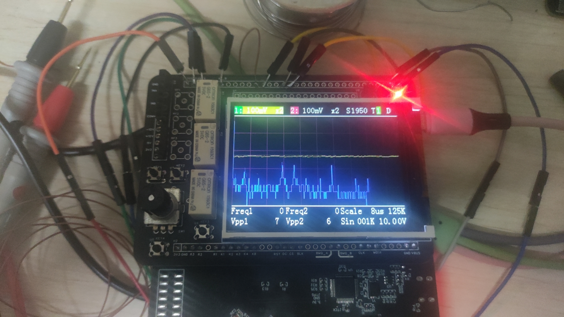

. Finally, let me show you the results:
First, powering on:
Perhaps a closer input would be better? I'm not sure. If any experts are willing to help, please point out the problem. I would be very grateful...
Also, I'm going crazy from hand-soldering the FPC socket... Sitting with a soldering iron all day...
Summary: A high-EQ perspective: The board needs to be redesigned; it might be better.
