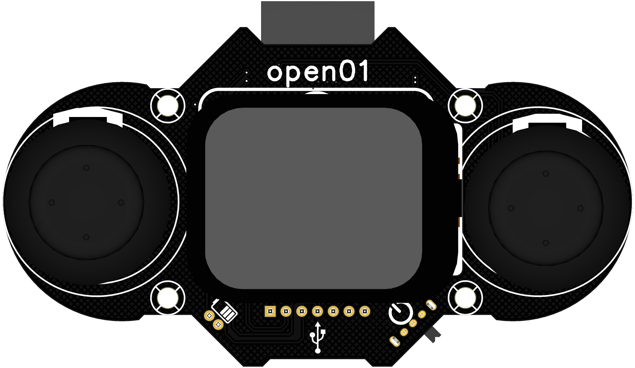

1. Separate the flashing module and charging module;
2. Optimize minor issues with the screen FPC connector hole
; 3. The screen is a bit too small to fit, so the left and right joysticks have been moved to the side;

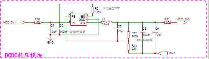

4. The LDO-ams1117 cannot meet the 1S lithium battery voltage reduction to 3.3V, so it has been replaced with a DC-DC module.

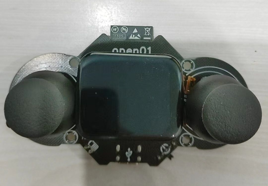

1. This remote control is used with the XCar car and can also be used for other purposes.
2. The flashing module and charging module are separated to reduce costs and increase efficiency. With the flashing board and charging board, it can be used for flashing and charging.
3. Main controller: ESP32.
4. Touch screen: 1.69 inch, screen interface SPI; touch interface IIC.

II. Effect Diagram
III. Functional Modules

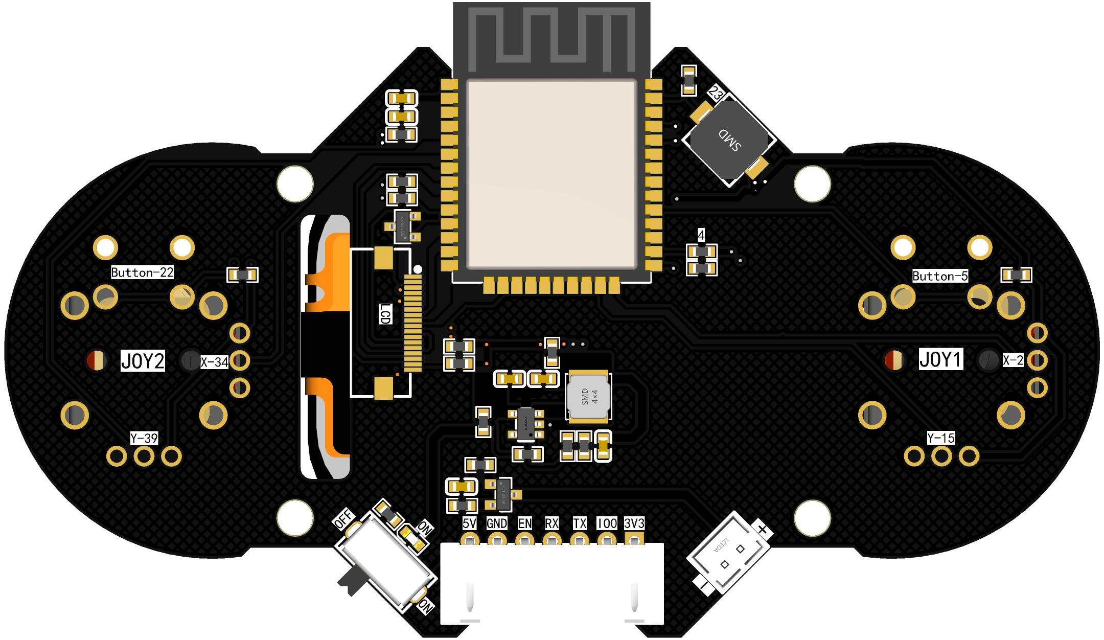

2. The flashing interface
is used with the flashing board; pay attention to the wiring sequence.
3. The power selection module's
5V-IN power comes from the USB. When the USB is plugged in, Q3 is off, and AUX_VCC equals 5V_IN. When the USB is not plugged in, Q3 is on, and AUX_VCC equals VBAT. This module allows for automatic selection of two power sources.
4. The power switch module has
a pre-installed switch on the board, which is almost a standard feature and very convenient. The indicator light shows the board's power status.
5.
The DC-DC step-down module - ETA3409S2F - has an input voltage of 2.4-7.3V and an output current of up to 3A. This module is also used on the 01-RTC and flashing board, increasing efficiency.

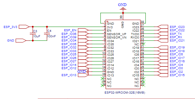

6. The main control module
uses an ESP32 microcontroller with built-in Wi-Fi and Bluetooth. It's a dual-core MCU, versatile and powerful.

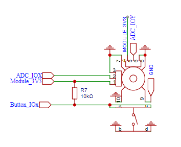

9. Joystick Module
: Two 1313 joysticks. Standard ADC and button design, no further explanation needed. Note that the linked version does not include automatic centering. If you need automatic centering, please find it yourself; this shop also sells
joysticks .

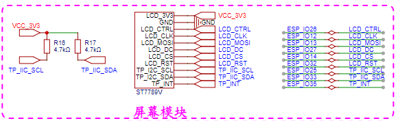

10. Screen Module:
The screen chosen is the capacitive touchscreen recommended by 01-RTC; this screen offers good value for money. The screen protocol is SPI, and the touch protocol is IIC.
