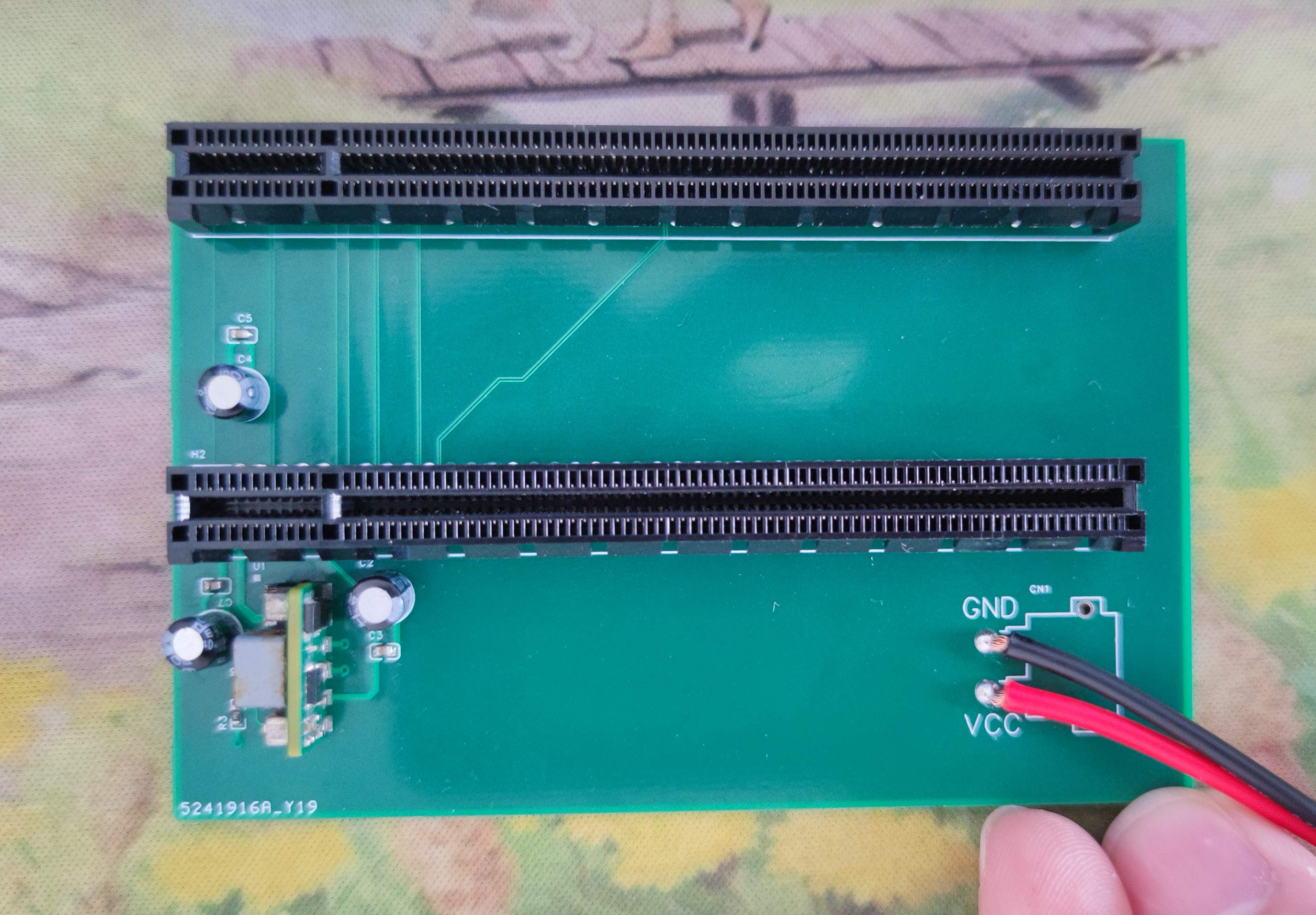

Panda B3 Adapter Card!
12V input for PCIe devices and control cards (the original 6-pin connector can be discarded), then stepped down to 3.3V via a ZXDN10S1205SAW converter for PCIe devices.
I'm not entirely sure if a 3.3V input is mandatory for PCIe network cards; please test it yourself.
Required components:
ZXDN10S1205SAW DC-DC module
100NF 0603 16V
, 5*7 100uF 16V surface mount capacitors,
390Ω 0603 through-hole capacitors, surface mount resistors (make sure you buy the correct ones! These are for the ZXDN10S1205SAW, 390Ω for 3.3V output!)
, XT30 connector (optional, you can directly solder wires).
