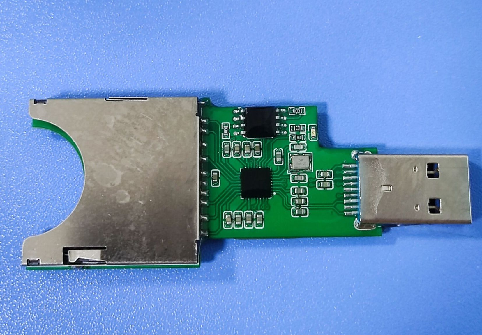

GL3224 USB 3.0 Card Reader
1. GL3224 Chip Introduction:
The GL3224 is a USB 3.0 card reader controller with a maximum capacity of up to 2TB.
The theoretical read/write speed of the GL3224 is 100MB/s. Actual read/write speeds depend on the quality of the memory card and whether the computer has a USB 3.0 port (blue); USB 2.0 ports are black.
2. Schematic Design Considerations
: External Flash: Required because the GL3224 chip's firmware is generally "1532" and needs to be upgraded to the latest version "1536". However, testing showed no significant change in read/write speed after the upgrade, so it can still be used normally without adding external flash.
Flash Model: The commonly used model is W25Q80, with a flash size of 8MB (this is sufficient, but when upgrading firmware, you need to add the flash model to the config.ini file; see the following introduction for details).
External Crystal Oscillator: An external crystal oscillator is recommended for stability. Specifically, it allows for faster and more stable USB drive recognition when plugged into a card reader on the computer.
It's best to connect a 0.1uF capacitor in series between the TX and RX pins (as close to the TX pin as possible) to isolate DC signals and filter out DC components. A TX pin typically generates an AC signal, but the RX pin may not be able to handle or require a DC signal, so the series capacitor filters it out.
GL3224 Pin 16 (RTERM): According to the datasheet, this pin controls the USB signal level. It is recommended to place a 680-ohm, 1% resistor between RTERM and GND.
GL3224 Pin 28 (SD_WP): SD card write protection, connected to GND to enable write. Write protection is not used in this project.
GL3224 Pin 29 (SD_CDZ): SD card detection pin, needs to be connected to the CD pin of the SD card slot and TF card slot.
3. PCB Routing Precautions:
Place filter capacitors close to the power supply.
Differential traces: D+ and D-, TX and RX.
4. Firmware Upgrade Method:
Upgrading the GL3224 firmware to version 1536 requires an external flash chip.
The W25Q80 is not listed in config.ini; you need to add the flash model to this file yourself. The attached file has already been added and can be used directly without modification. If using other flash models, you can refer to the following modifications.
The third line indicates the 6th chip supported by Winbond; the number can be changed, but cannot be repeated. The eighth line is crucial; it describes the address ID of the W25Q16 device, which is a target address for access. If it's incorrect, the other party will not respond. This address is mentioned in section 10.2.1 of its chip manual. For example, it's EF 13 for W25Q80, EF 15 for W25Q32, and EF 14 for W25Q16. The rest can be written according to the other Winbond chips. The GD25Q16 follows a similar principle; first, determine its target address, which is C8 14 according to the chip manual, while C8 12 for GD25Q40.
If the flash model is not added correctly, the following error will occur during the upgrade:
The message after a correct upgrade:
