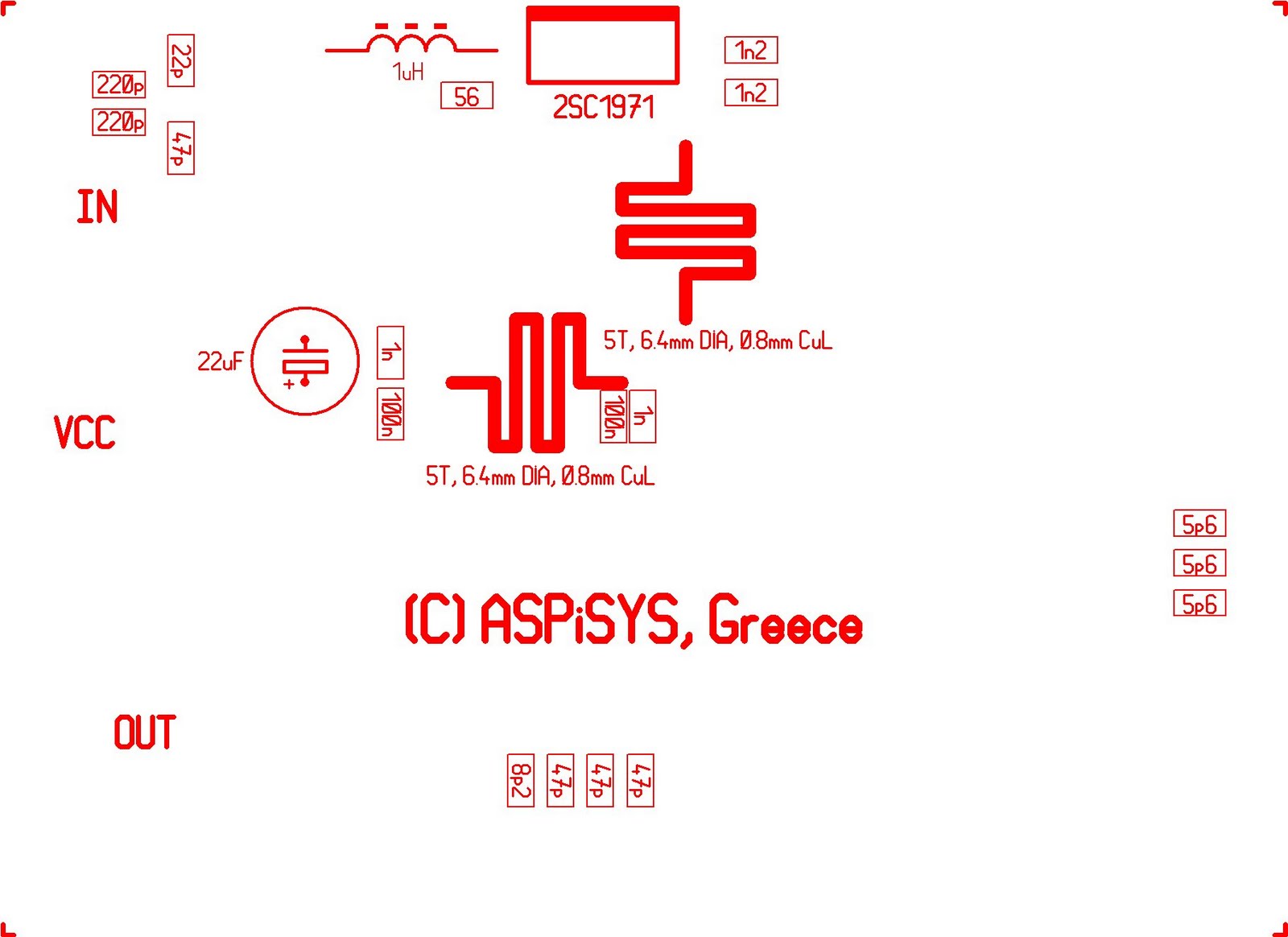

This is an 8W broadband FM RF amplifier using the 2SC1971 VHF power transistor. The RF amplifier PCB layout employs microstrip line technology and is designed for 88-108 MHz broadband FM transmitters. This 8W RF amplifier circuit provides a suitable power boost for transmitters with an input power of 500 mW.

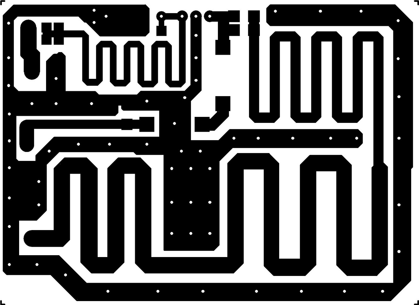

RF amplifier PCB

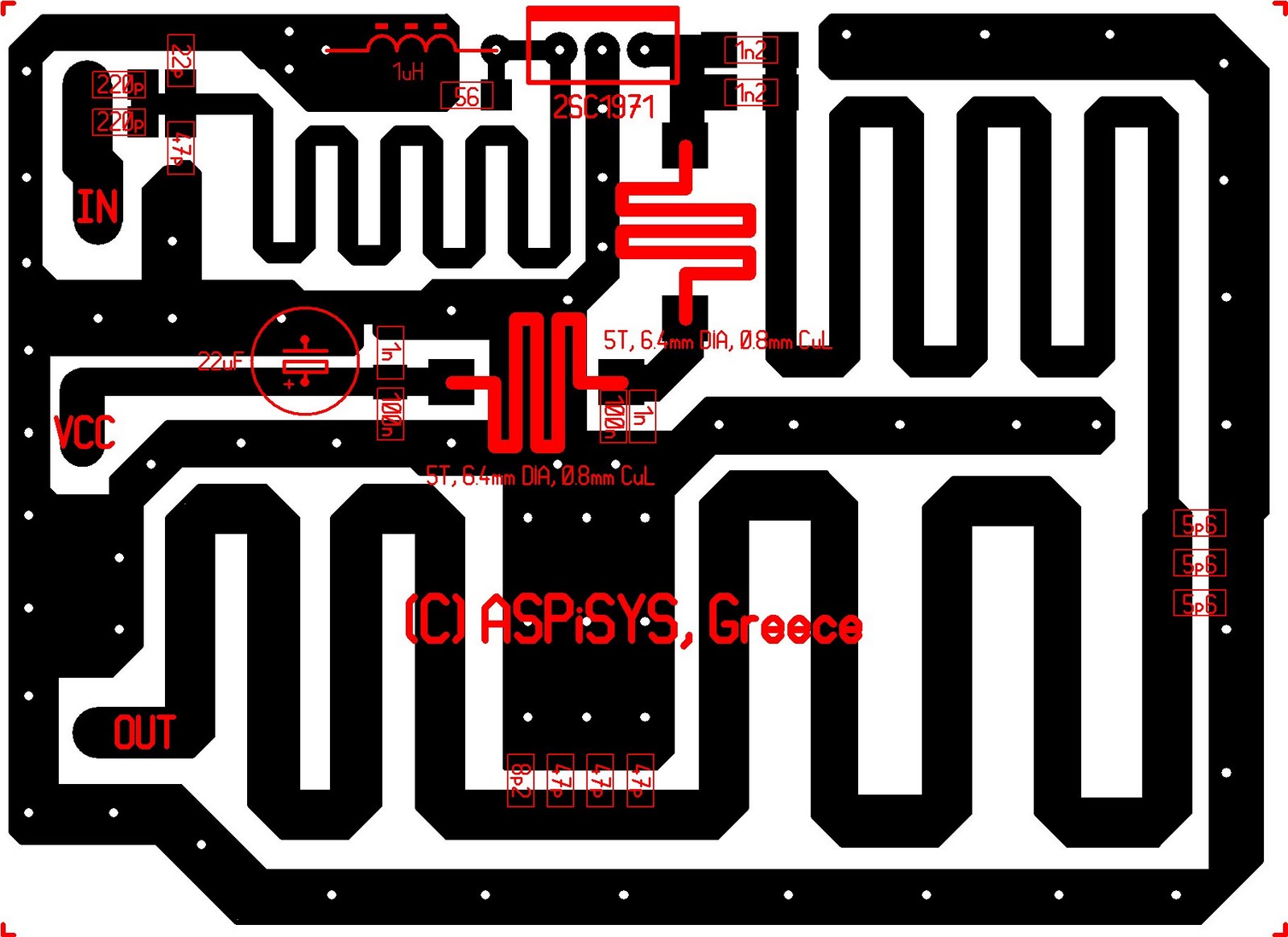

The PCB has a profile of 77 x 56 mm and uses FR-4 double-sided photoresist epoxy PCB material for best results.
[RF Amplifier 2SC1971 Silkscreen Layer] [RF Amplifier 2SC1971 Component Layout] [RF Amplifier 2SC1971 PCB]

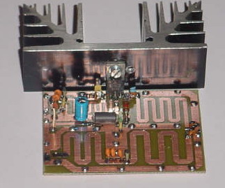

RF amplifier construction
All SMD components are of type 1206. The bottom layer (ground layer) is connected to the top layer of the PCB at multiple points (through vias).
Notice:
CuL = magnetic wire, enameled copper wire
- 1 mm is approximately equal to #18 US gauge wire.
- 0.8 mm is approximately equal to #20 US gauge wire.
- 0.3 mm is approximately equal to #28 US gauge wire.
All diameters are measured from inside the coil, i.e., the 'inner diameter'.
Ensure the RF transistor is mounted on a suitable heatsink and apply some thermal paste between the transistor flange and the heatsink! (The heatsink's thermal resistance should be at least 6°C/W.)
All components are soldered directly onto the top layer of the PCB.
