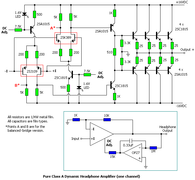

The schematic of the standard (non-bridged output) version of the headphone amplifier is shown in Figure 1. The amplifier's open-loop gain is approximately 35. Even with feedback removed, the THD is less than 0.01%. This is significant because the more linear the amplifier is without feedback, the more the THD, IM, and TIM distortion decrease to immeasurable levels after adding feedback.
The first stage is a dual-FET fully differential, fully balanced front end. The quiescent current is a total of 2mA for each dual FET (1mA per FET), and 4mA for the entire front end stage (including the two dual FETs). The dual FETs generate the bias, driving the second stage and keeping it and the resulting output stage always in Class A. The FETs are ultra-low noise dual units designed specifically for audio applications. The total voltage gain of the first stage is 50.
The second stage is the driver stage. It is a standard Class A voltage amplifier—used as a voltage shifter in this case. The voltage gain is 0.5, and the quiescent current is 4.3mA.
The push-pull Class A output stage is a series of emitter follower current buffers connected in parallel. The voltage gain is 0.9, and the current gain is 75. The quiescent current is 15mA per transistor (or 60mA for the eight transistors on the +16VDC rail and 60mA for the eight transistors on the -16VDC rail). I designed the output stage to operate in the sweet spot region of these transistors, i.e., 15mA each. Yes, it will get hot; it's meant to get hot (but not hot enough to require a heatsink). It's impossible to build an amplifier with an output impedance of less than 0.1 ohms without consuming a considerable amount of current.
The servo circuitry is new: most servo designs (such as Mark Levinson and Krell) feed the DC servo output back to the amplifier's output. I don't like that. This introduces operational amplifier noise and nonlinearity into the audio loop.
My servo feeds back to a first-stage dual-FET current source. Like all servos, it's an integrator. Due to the relatively large integrating capacitor and 1 megohm resistor, the filter operates at a frequency of 0.05 Hz. Even using a standard operational amplifier, the servo's noise is in the tens of microvolts range and doesn't significantly affect the operation of the current source.
The servo operational amplifier in this amplifier measures any DC at the output, integrates it, and applies it to the midpoint between the two LEDs. The voltage of the LEDs does change slightly relative to the current, about 3% or 4%, which is sufficient for the servo to operate. Note that if the transistors or resistors are poorly matched, the servo will not work because its total control range is at most 10%. Most standard servos (such as Mark Levinson or Krell servos) have a wider range.
For high-impedance headphones, a small amount of DC will not damage them. For low-impedance Grados, even 0.1VDC for an extended period will certainly damage and/or alter the sound. If all parts are manually matched, the power supply is identical, and all resistors are of high quality, the amplifier should be stable and not drift. In this case, the servo can be omitted or replaced with a 20K trimmer potentiometer wired from +16VDC to -16VDC, with the slider connected to the DC adjustment pin. The prototype used 0.05% tolerance resistors, and I manually matched the transistors. The output DC was less than 6mV and remained perfectly stable for several months after I owned the unit.

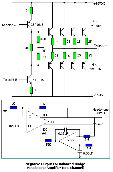

Schematic diagram of the output of the bridged version amplifier.
Figure 2
This amplifier delivers approximately 0.5W of power to a 32-ohm load. In the classic Class A definition, the top transistor would source 120mA and the bottom transistor would sink 0mA. However, the two 3k resistors in the second stage effectively prevent either transistor group from completely shutting off by keeping the relative stages at an absolute minimum of 5mA. In any case, the sound is incredibly loud when outputting 0.5W of power to the Grados.
The balanced bridged output version of the amplifier (Figure 2) is suitable for headphones that can be wired as dual-mono (see the appendix for instructions on converting standard Grado SR-80 headphones to dual-mono). It features twice the voltage swing, twice the slew rate, and four times the output power (competing with the $2,600 HeadRoom balanced Max amplifier).

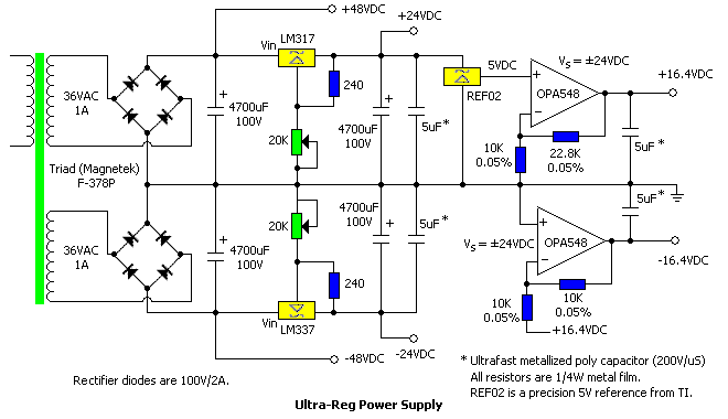

Power supply schematic diagram.
The power supply overshoot regulation (Figure 3) is so excessive and unnecessary that most, if not all, builders of this amplifier wouldn't even notice the difference. However, this design offers several advantages. First, it's a dual-track design. Due to the amplifier's low open-loop gain, its common-mode rejection of the power supply is poor. However, if the + and - voltage rails move up and down by the same amount, there is no bias drift.
Thanks to the pre-regulator, total line/load variation is less than 0.0001%. Fast capacitors allow the power supply to respond quickly and in a controlled manner to highly reactive loads like Grados. The operational amplifier outputs are active in both directions; they can push or pull to keep the power supply just at the right point. The power supply design is an attempt to produce the best I could. It's even quieter than a battery.

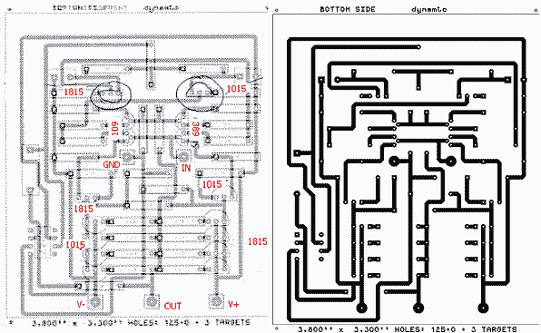

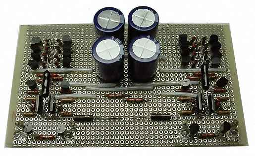

The prototype was built using point-to-point wiring to keep it compact and small. The layout is exactly the same as shown in the schematic, which is why the board only has one layer. Although the amplifier is easy to build without a PCB, I designed a board for it. Each board (two are needed for the standard amplifier, four for the bridged version) measures 3.3 inches x 3.8 inches. In a few months, I may redesign the board for one of the systems and send the files and retrieve the board via the internet (e.g., expresspcb.com).
The total control range of the servo is at most 10%, therefore some servo-related components must be closely matched to achieve optimal servo operation. The 500-ohm resistor, 1.6V LED, bias transistor, and second-stage transistor must be matched to within 0.5% or even 0.25% for optimal servo operation (dual FETs are already matched). To match the LED, connect one in series with a 10kΩ resistor to 15VDC and measure the voltage across it. Perform this operation on several LEDs and select the closest match.

The assembled PC board.
The high-speed 5uF capacitors in the power supply are not critical. They satisfy the "enthusiasts" in audio. These capacitors have a slew rate (dv/dt) that is about four times that of standard capacitors. They were purchased from the Illinois Capacitor Company for $7.50. Similarly, the operational amplifiers in the power supply are not critical. In the prototype power supply, I used Apex PA09s with a slew rate of 400V/μS, each costing $167 (remember, I'm crazy). The average person should use Texas Instruments OPA549s (10V/μS), each costing $11. LM3xx regulators are used for cooling (each dissipating at least 3W, 6W for the bridged version of the amplifier).

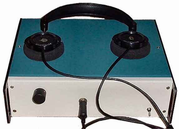

The housing is a Mod.U.Line (part number 03-1209-BW) from Precision Fabrication Technologies Inc., available from Newark Electronics. They cost around $85 each now. The aluminum housing is easy to use, easy to punch, and maintains a good paint finish. The headphone jack is a cheap Radio Shack product. Although it works fine, I later acquired some Neutrik connectors, which I will install at some point. Theoretically, there is a ground loop between the RCA jack on the rear panel and the headphone jack on the front panel. Although the 60 Hz hum is below approximately 110 dB, the Neutrik jack is isolated, which will eliminate this issue.

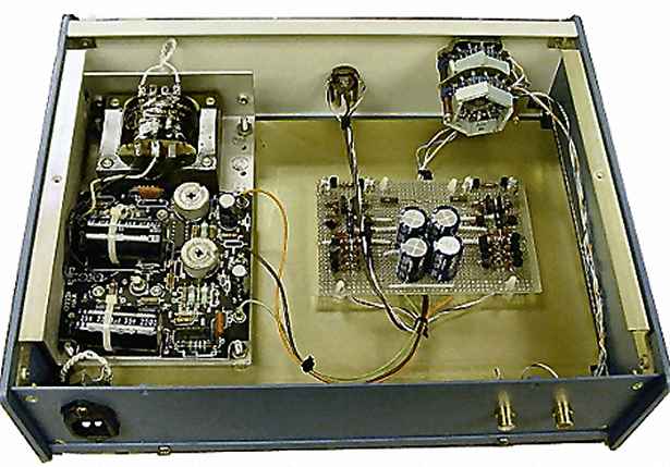

Inside the amplifier chassis.
The amplifier's output is voltage-limited (not current-limited) because the second stage exhausts the voltage swing—typically around 6V rms. For a 32-ohm load, the maximum output power is 1.125W (0.1875A). For a 300-ohm load, such as the Sennheiser HD600, the maximum output power is 0.125W (0.02A). To increase the maximum output voltage to, for example, 10V rms, try increasing the supply to ±20VDC and changing the 500-ohm resistor in the current source/sink to 600 ohms (or ±24VDC and 700 ohms—but be careful not to burn out the output transistors).
The bridged version will output 4.5W to the 32-ohm Grados and 0.5W to the 300-ohm Sennheiser HD600. At full power, the amplifier does indeed exit Class A, but at levels that will burn your ears anyway.

Adjustment: In the power supply, adjust the top 20K trimmer potentiometer to +24V at the tap after LM317. Then adjust the bottom 20K trimmer potentiometer to -24V at the tap after LM337. (Note: ±48V taps are for reference only; they are not actually used by the amplifier.) If the servo has been replaced with a 20K trimmer potentiometer, adjust the trimmer to make the output measurement 0VDC. Any value below 25mV is acceptable.
