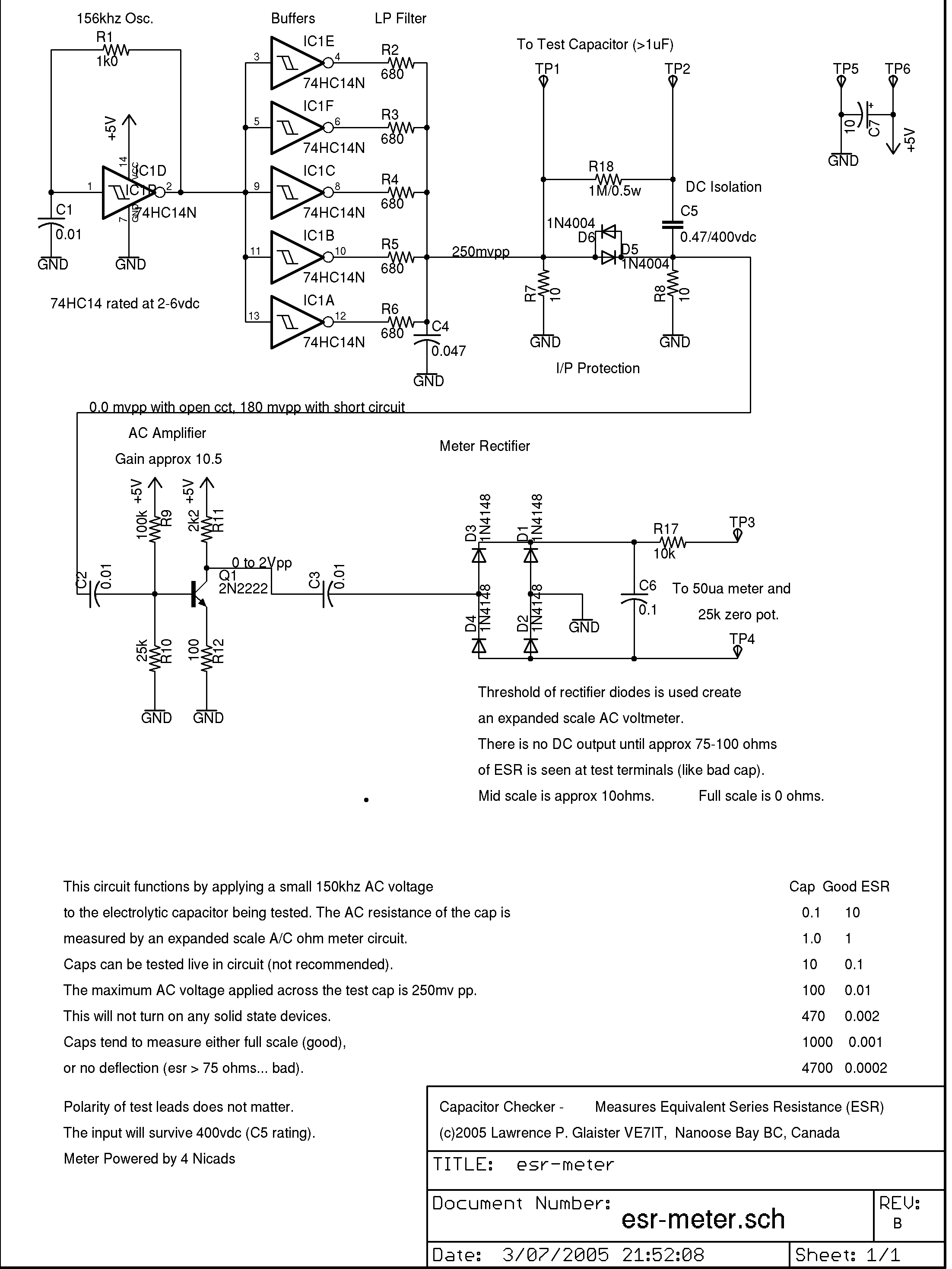

Typical capacitor testers measure the capacitance of a test capacitor (usually measured in microfarads). Some advanced units also test leakage current. Most of these testers require the capacitor to be removed from the circuit. They will not detect a high ESR value unless the capacitor is completely failed. In a typical circuit, there may be 10 or 100 capacitors. Removing them one by one for testing is tedious and carries a significant risk of damaging the circuit board. The tester uses a low-voltage (250mV) high-frequency (150kHz) AC current to read the ESR of capacitors in the circuit. In-circuit testing is possible because of the low voltage used for measurement. The voltage is low enough that solid-state devices in the surrounding circuitry will not be activated and will not affect the low resistance reading we are trying to obtain. Many capacitor testers will be damaged if they test charged capacitors. The circuit is AC-coupled and can withstand up to 400VDC of charge on the capacitor (but watch your fingers!). ESR testers will not detect short-circuited capacitors because they will read very low ESR values. If you're troubleshooting circuit faults, you'll have to use a variety of instruments, including your nose, voltmeter, and oscilloscope, to pinpoint all possible fault modes. In my experience, an ESR tester can detect about 95% of capacitor problems and potential issues.

See component labels in the schematic. The circuit begins with a 150kHz oscillator, using one gate of a 74HC14. The remaining gates act as buffers to increase the current drive to the low-pass filter. A single-pole low-pass filter is necessary because the square wave signal contains a significant amount of high-frequency odd harmonic energy. The filter output is applied across a 10-ohm load resistor, which provides a low-impedance drive signal to the test capacitor. Diodes D5 and D6 protect the circuit from discharge spikes if you are testing charged capacitors. R18 is used to discharge C5 so that nothing blows up if you are alternating between testing high-voltage and low-voltage charged capacitors. C5 isolates the test circuit from DC voltages up to 400 volts.
If you are testing high-voltage capacitors, be careful... The safest way to do it is to ensure that the capacitor is discharged before testing. Note that high-voltage capacitors can retain a lethal charge for days, depending on the circuit design. I learned this in my high school electronics class. Students (anonymous!) used to charge capacitors and put them back on the shelf for the next unsuspecting victim to pick up.
The rest of the circuit is a very straightforward transistor amplifier with a gain of approximately 10.5. This amplifies the AC signal from the test capacitor to a few volts. The signal is then coupled to a full-wave bridge rectifier, which uses the meter as a load. The threshold voltage of the bridge rectifier is utilized, providing extended scale functionality for the ohmmeter. The amplified voltage from the test capacitor must be large enough to overcome the voltage drop across the two diodes for the meter to begin responding. This sets the meter's high resistance threshold somewhere between 75 and 100 ohms. The meter is zeroed by shorting the test leads and adjusting a potentiometer in the meter circuit to obtain a full-scale (0 ohm) reading. Proper circuit operation can be verified by checking several resistance values with the meter. Shorting the leads should indicate full scale, a 1-ohm resistor should read approximately 90% of full scale, a 10-ohm resistor should read approximately 40% of full scale, and a 47-ohm resistor should barely move the pointer to approximately 10% of FSD. Absolute readings will vary with temperature and battery voltage, but the idea is that most ESR values should be well less than 10 ohms, meaning that a good capacitor test is very close to full scale, while a bad capacitor test has little or no deflection.

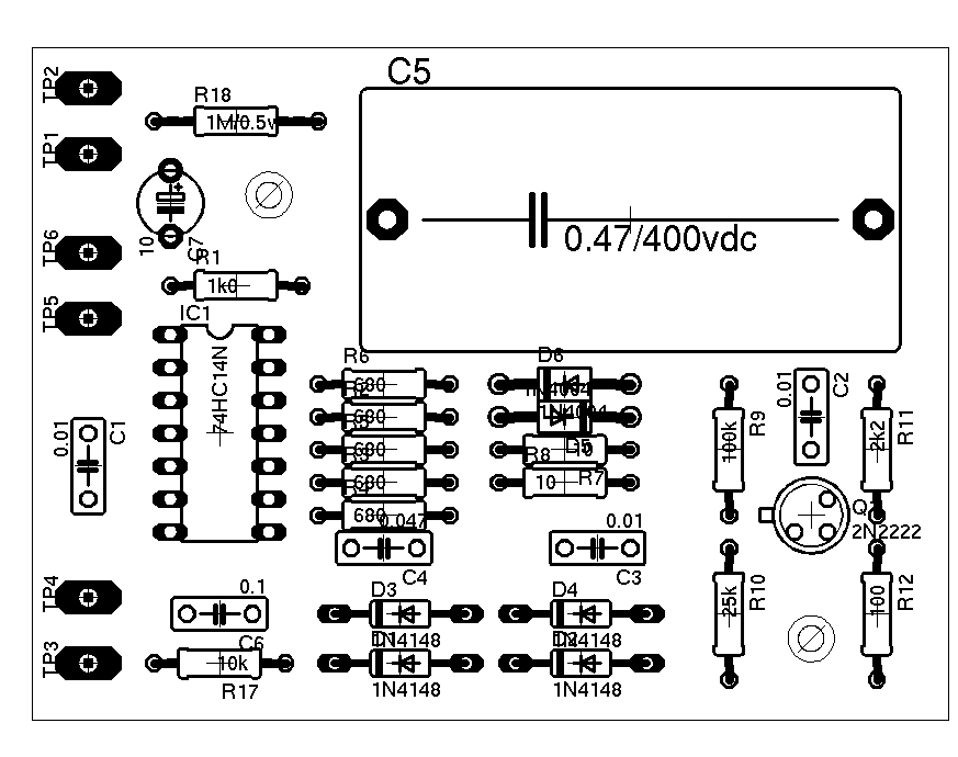

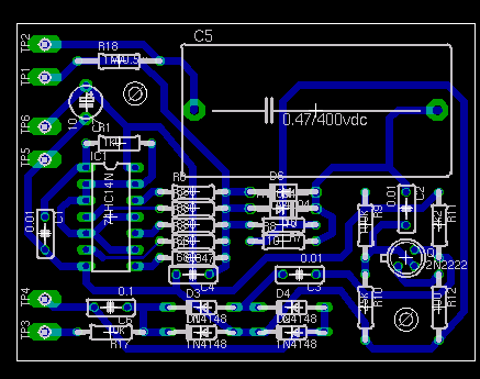

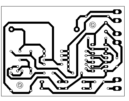

The board below shows my second prototype. The top two wires connect to the banana test jack on the front panel, the middle two wires are the 5-volt switch input from four AA NiCd batteries, and the bottom two wires connect to the series combination of the zero-position adjustment potentiometer and the meter on the front panel.
