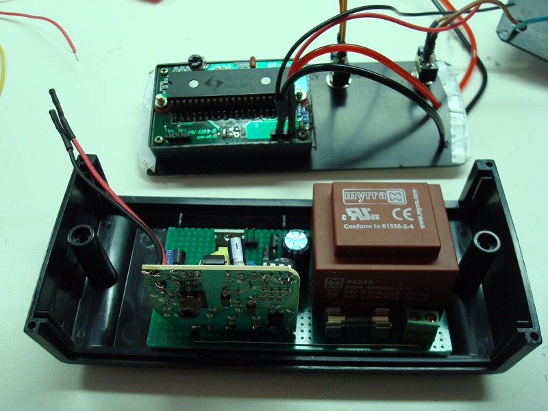

Photo of the assembled circuit boards of the prototype
characteristic
Prototype assembly board.

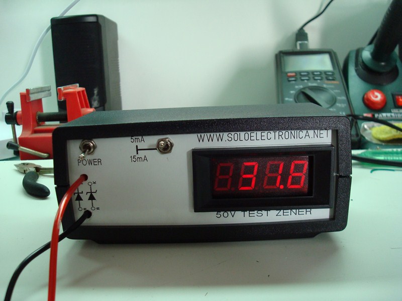

Read the numerical value Vz
Zener diode tester 1V to 50V
Two measurement ranges: 5mA and 15mA testing.
Zener Test

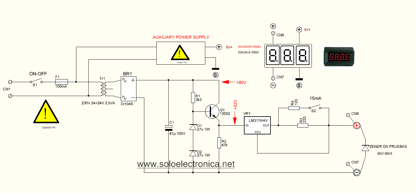

As you can see, the circuit is very simple. It starts with a transformer with two 24V secondary windings, which is rectified and filtered to obtain a voltage of about 80V. Then, a voltage regulator circuit consisting of (R1, R2, D1, D2 and Q1) reduces the voltage to about 52V to avoid exceeding the maximum voltage limit of the LM317AHV integrated controller.
The LM317AHV is a high-voltage version of the LM317T, capable of reaching up to 57V. The LM317T, however, can only reach 37V. We must not confuse these components, otherwise the circuit may not be able to operate sustainably.
This setup is based on the LM317AHV constant current generator, with the addition of a switching circuit (S2) in series with a resistor (R4) to select two test ranges (5mA and 15mA) as the power of the Zener diode under test.

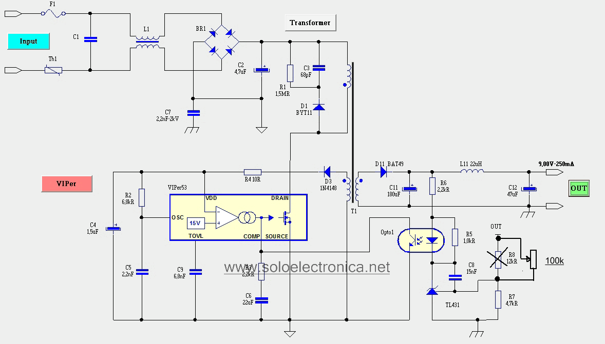

Modified photo of the switch adapter used to power digital panel meters, changed from 12V to 9V.
I changed the voltage from 12V to 9V to power the panel meter using a small 0.2A switching adapter, which was really easy; I only needed to modify the voltage divider value of the TL431 pre-regulator.
The resistor to be replaced is the one that connects directly to the positive output terminal and the source of the TL431. I used a 100K LIN resistor because it's rare to calculate a new value for a resistor with a 9V output, so this is fair and ready.
